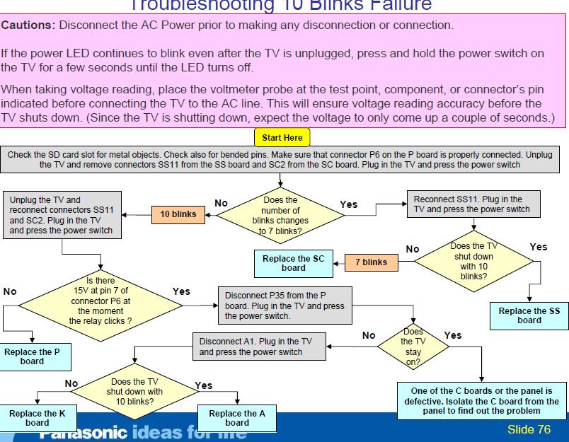

    The attached diagram I found in another post and when using it I get all the way to one of the last steps that says:
    'Disconnect A1. Plug in the TV and press the Power switch'.
    When I do this I get nothing, I mean nothing at all, no clicking no lights no flashing.
    The next question states: 'Does the TV shut down with 10 blinks'.
    But when it doesn't even turn on of course it can't shut down. But if forced to choose an answer I guess it would be No since there is no shut-down of any kind.
    It then indicates that I need to replace the K board, is that the tiny one by the power switch that has the remote sensor on it too? Is that really the problem?
    I'm not really convinced, and I cannot find that board anywhere...
    Help :-)
    Dan
    PS: I switched the a-board cuz I had one sitting but that didn't change anything.

    After reconnecting everything and turning it on, did you have 15v at pin 7 like it asks?

      Thanks, yes I found 15v at pin 7.

          Is the "K" board the one with buttons on it? Or does it have IR too -- maybe you need to use remote control...

            10 blinks Condition Troubleshooting
            1.
            Missing/Shorted F_STB_15V, SUB9V, SUB5V, and BT30V
            2.
            Wrong diagnostic by the A board
            Since the Sub voltages are only present after the power has been turned on, there will not be a 10 blinks condition at plug-in for the 2009 models.
            These 3 conditions can cause the TV to shutdown and the power LED to blink 10 times
            To troubleshoot a PDP TV that is shutting down and the power LED blinks 10 times:
             Find out if 15V is output at pin 7,8,or 9 of connector P6 of the P board. If no voltage is output, the P board may be defective.
             If the F_STB_15V voltage is OK, it’s likely that the A board is bad
            have you checked step one for all the proper voltages? if not check them. last one i had with 10 blinks was missing the sub 9v and sub 5v.
