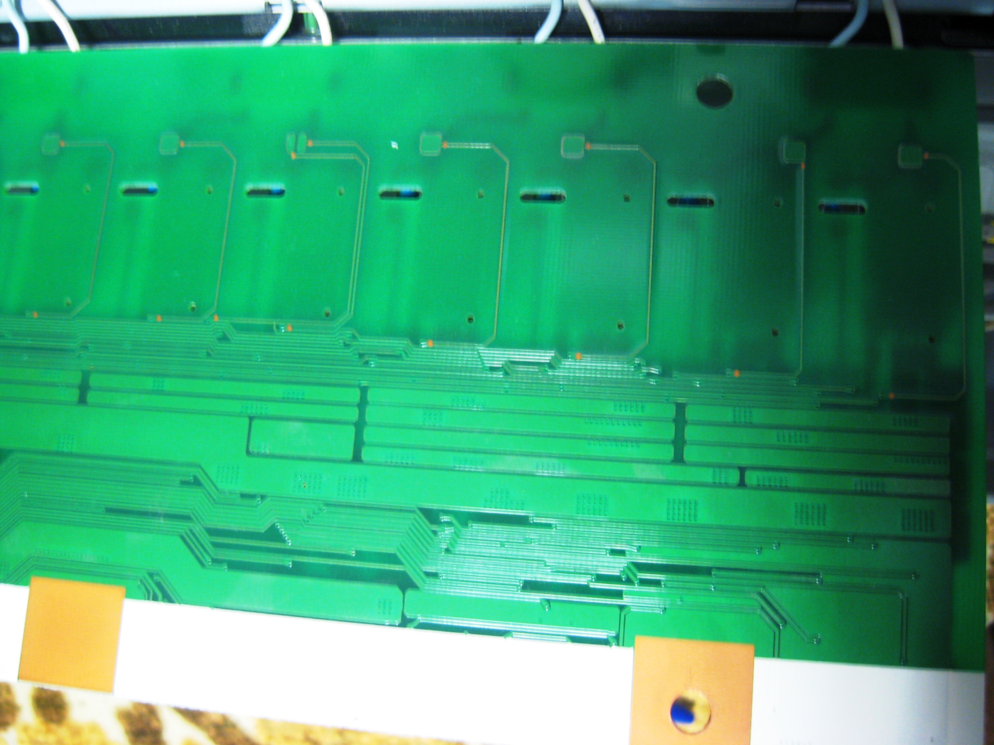

    Hi everyone,
    I have searched the forum but couldn't find a thread with my exact model and problem. Please forgive my language errors.
    Without any other worrying sign, after 5 years of impeccable service, my TV stopped showing picture.
    The pattern is this: TV being in standby (red light), after turning it on by the remote or the panel buttons, the light flashes 3 times, and turns white-green (as normal). The panel shows fine for 3 to 4 seconds and then blacks-out. Nevertheless, sound goes on. If I put it in standby, I can replay the previous pattern as many times.
    At the LG service center they asked for 180 euros to change every board in the set. As this is too much for me right now, I thought I should try to fix it by myself.

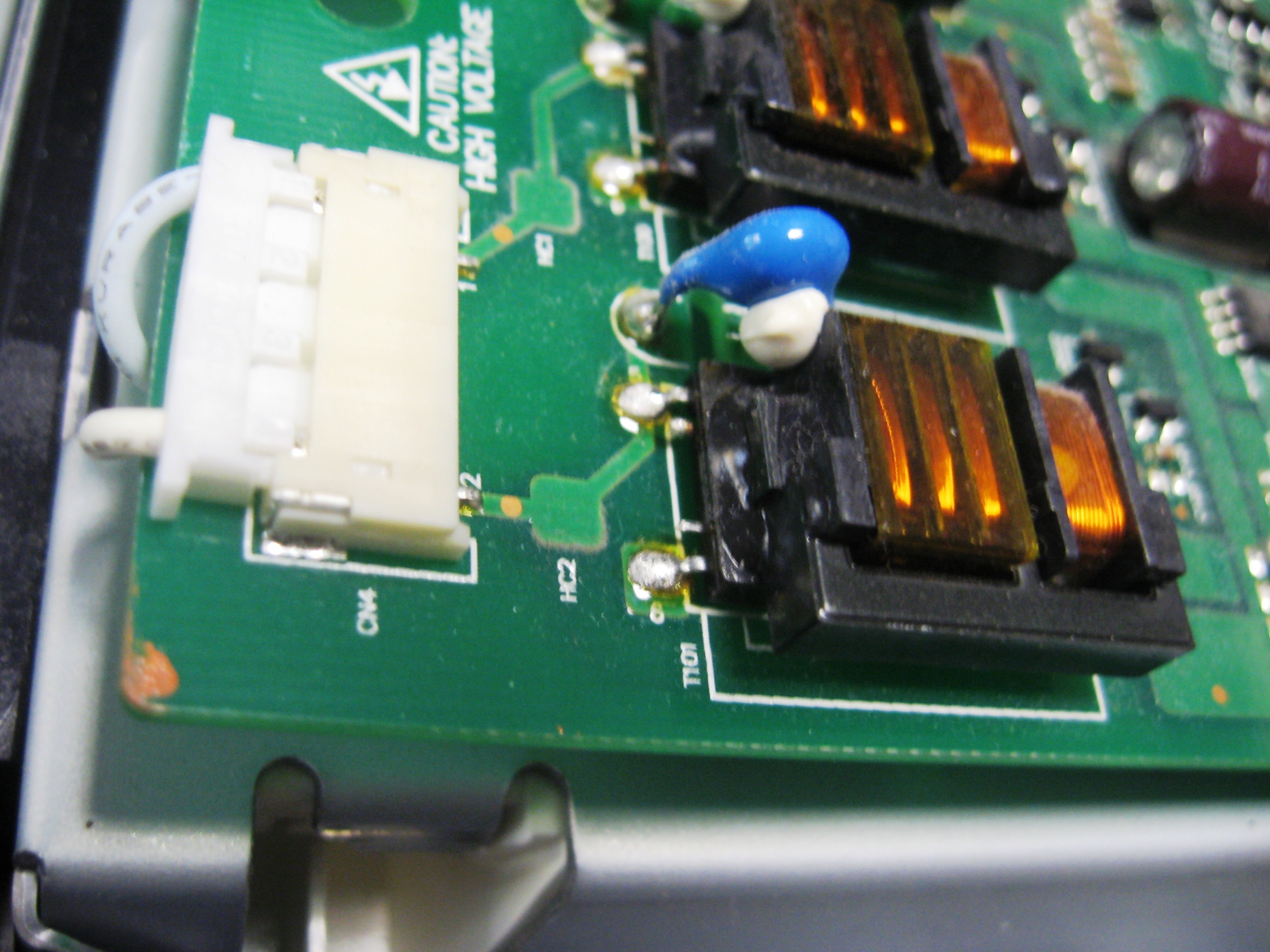

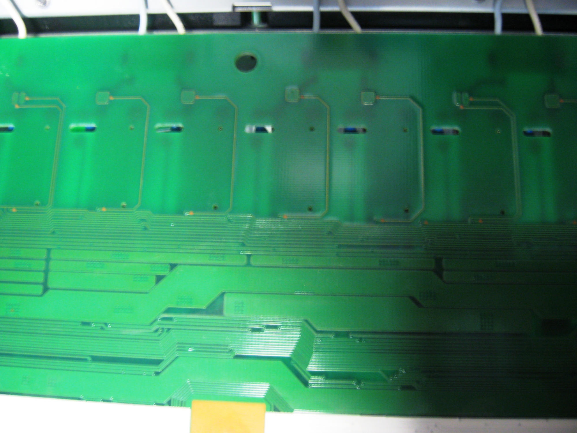

    I started with capacitors.
    Opening up my TV set, in the quest for bulged caps, I didn't find any. As seen on the first photo, here are 3 boards: the main logic, the power supply and the inverter. The PSU board (photos 2-7) uses SAMXON caps which, as I understand from this forum, are of poor quality, but I miss an ESR meter to test them.

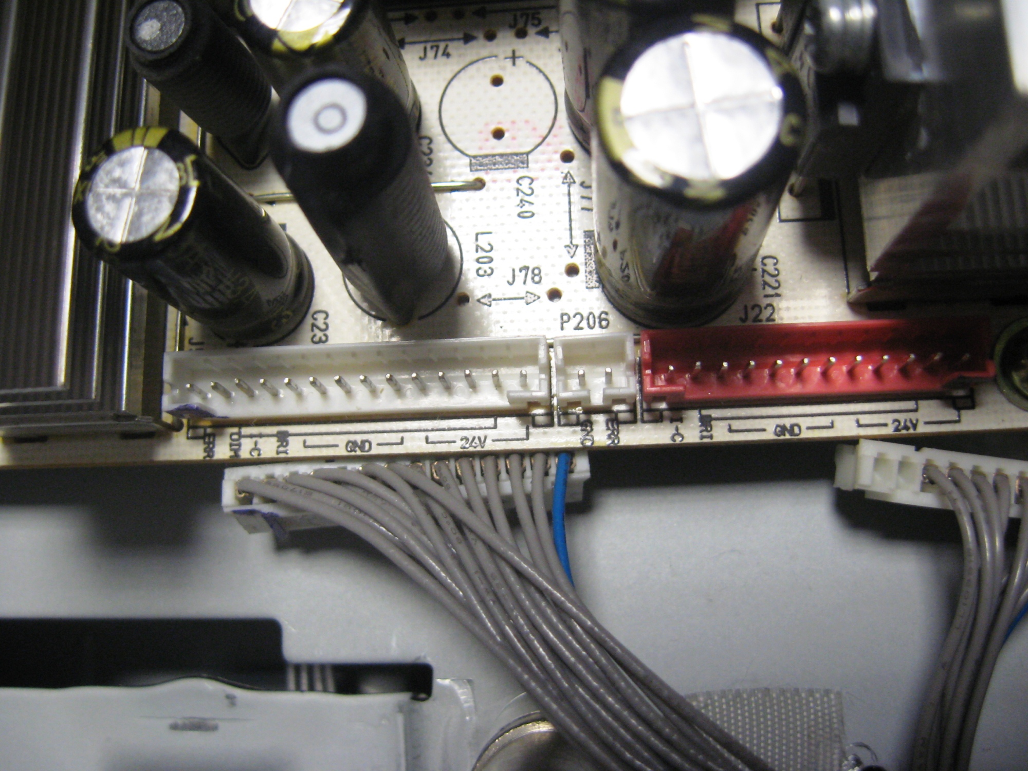

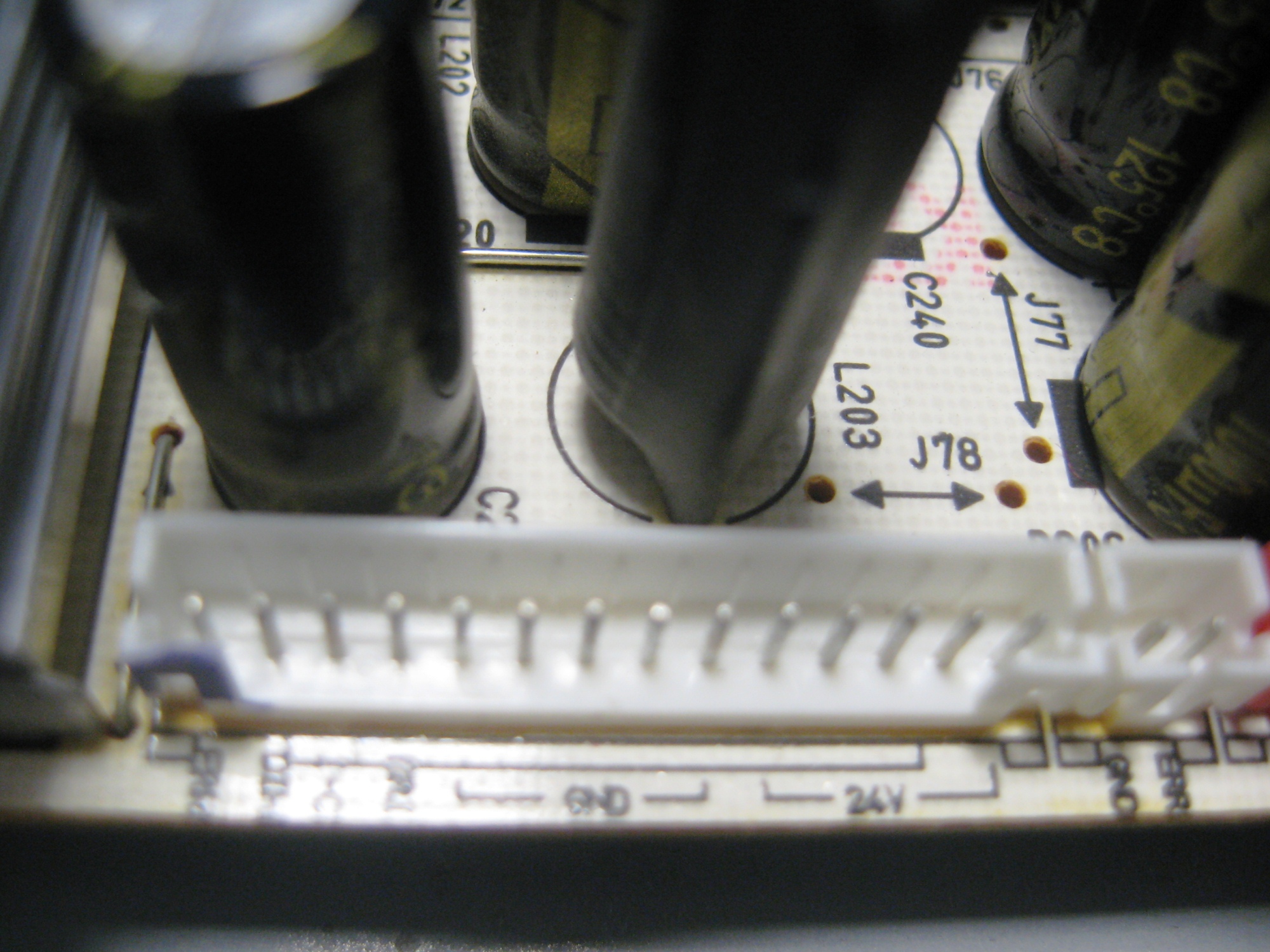

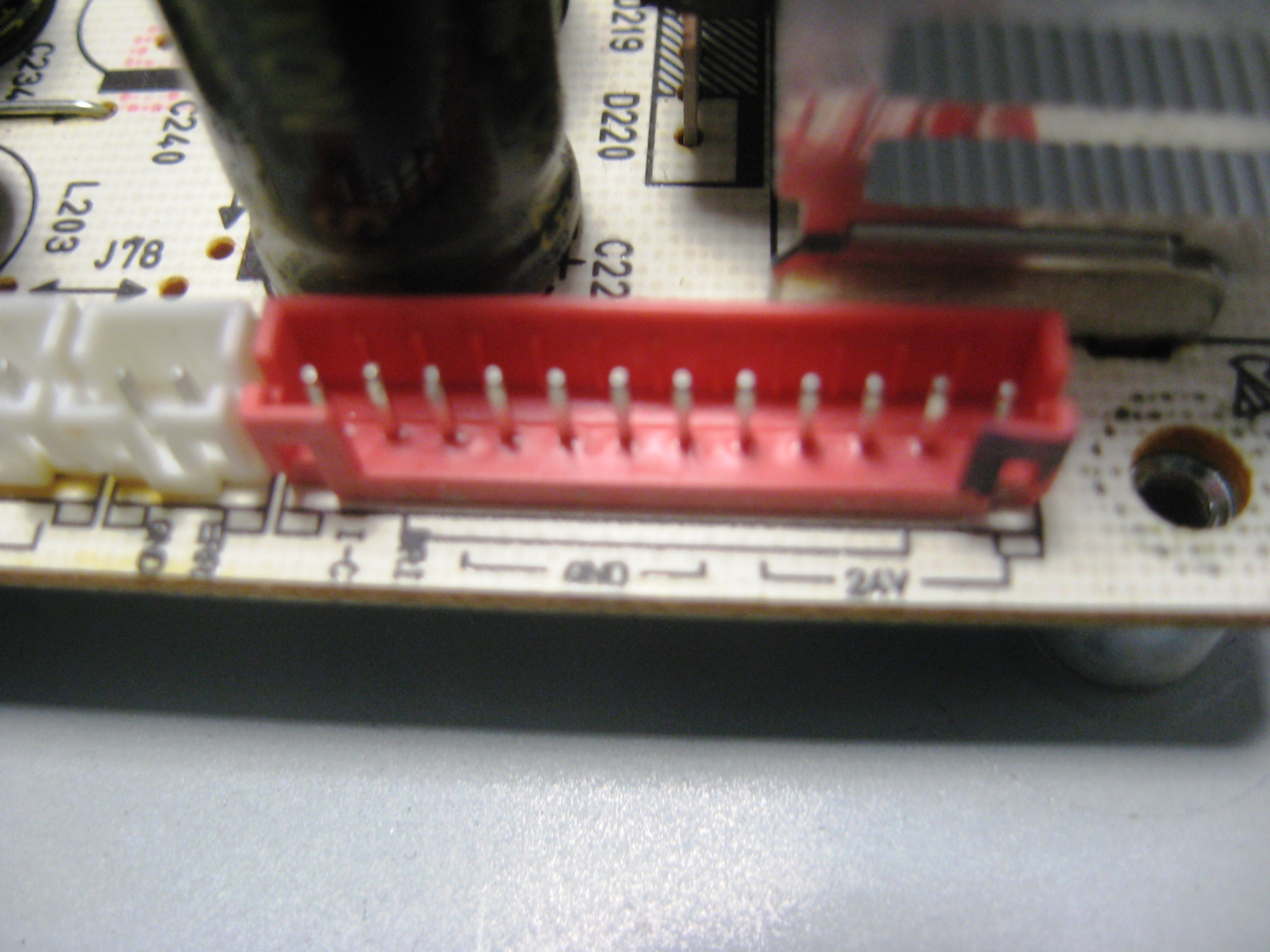

    With my DMM, I checked the voltages on the both connectors to the inverter.
    (Tv set is on, connectors unplugged, black probe on a Gnd pin)
    connector socket P205
    24V -> 24,93
    I-C -> 4,94
    BRI -> 3,31
    connector socket P204
    ERR -> 0
    DIM -> 0
    I-C -> 4,94
    BRI -> 3,31
    Does this prove PSU board to be OK, so that I can move on to the inverter?
    Or should I recheck with connectors plugged-in?
    I'd appreciate your help.

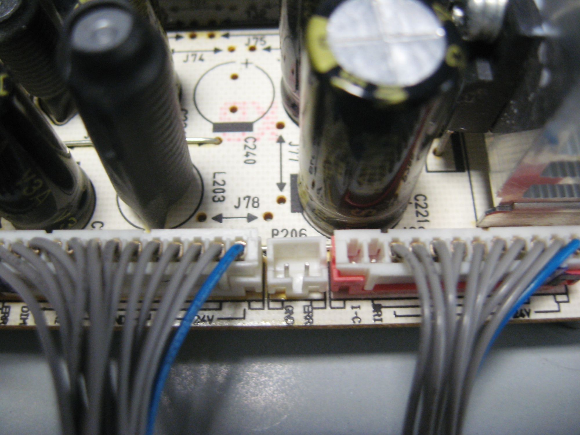

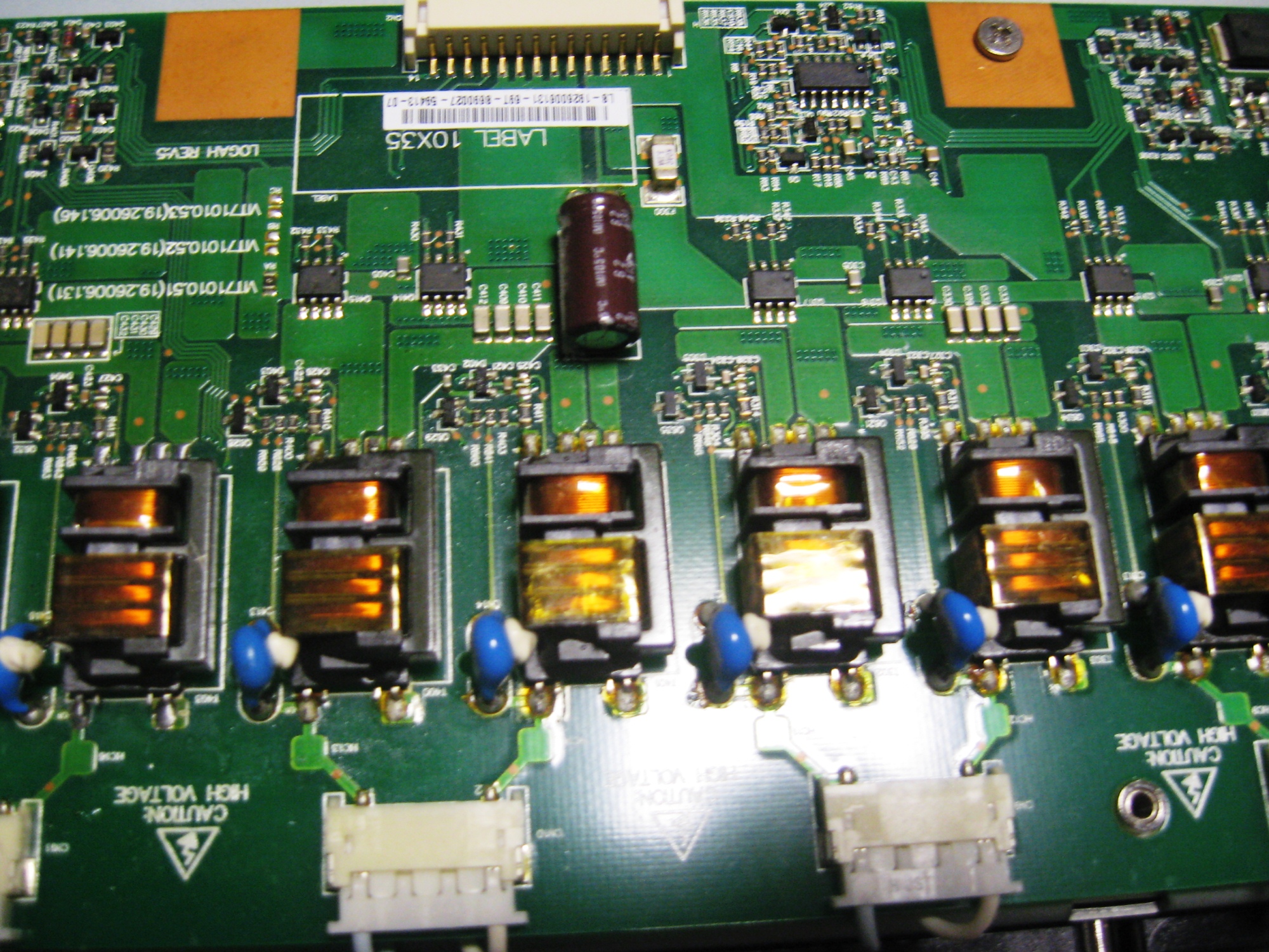

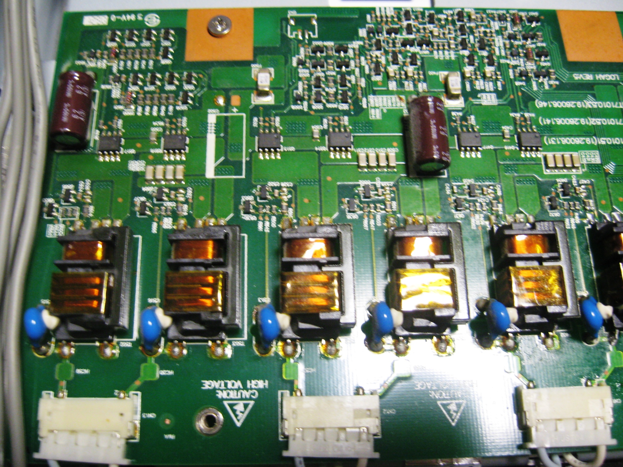

        Can I see the pictures of theses two connectors and the whole Inverter board? So far it looks like you are getting all the correct voltages and signals to the inverter board. Make sure to use Managed Attachment to up load the pictures.

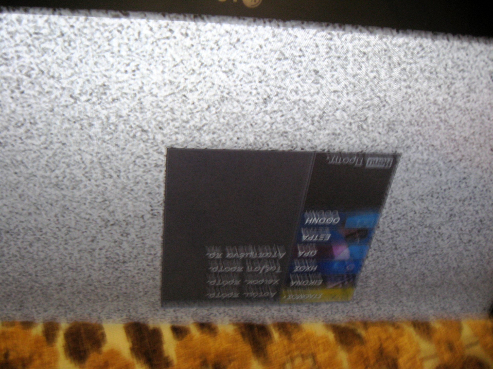

          This means picture is also good, i.e. if you have a menu up in this time, or channel indicators, volume control etc., it shows?
            Everything works as normal besides back-lights. Look at first picture.

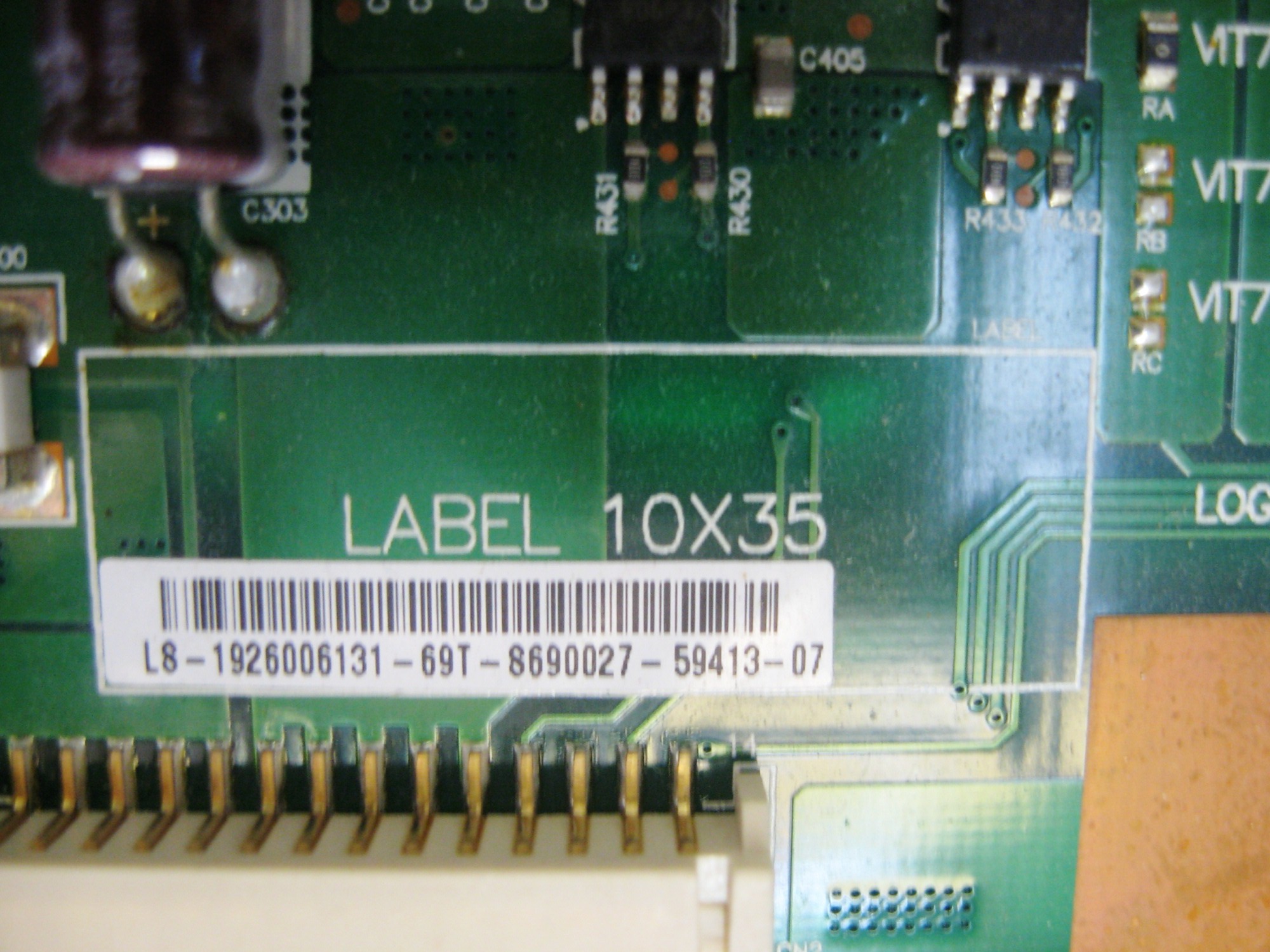

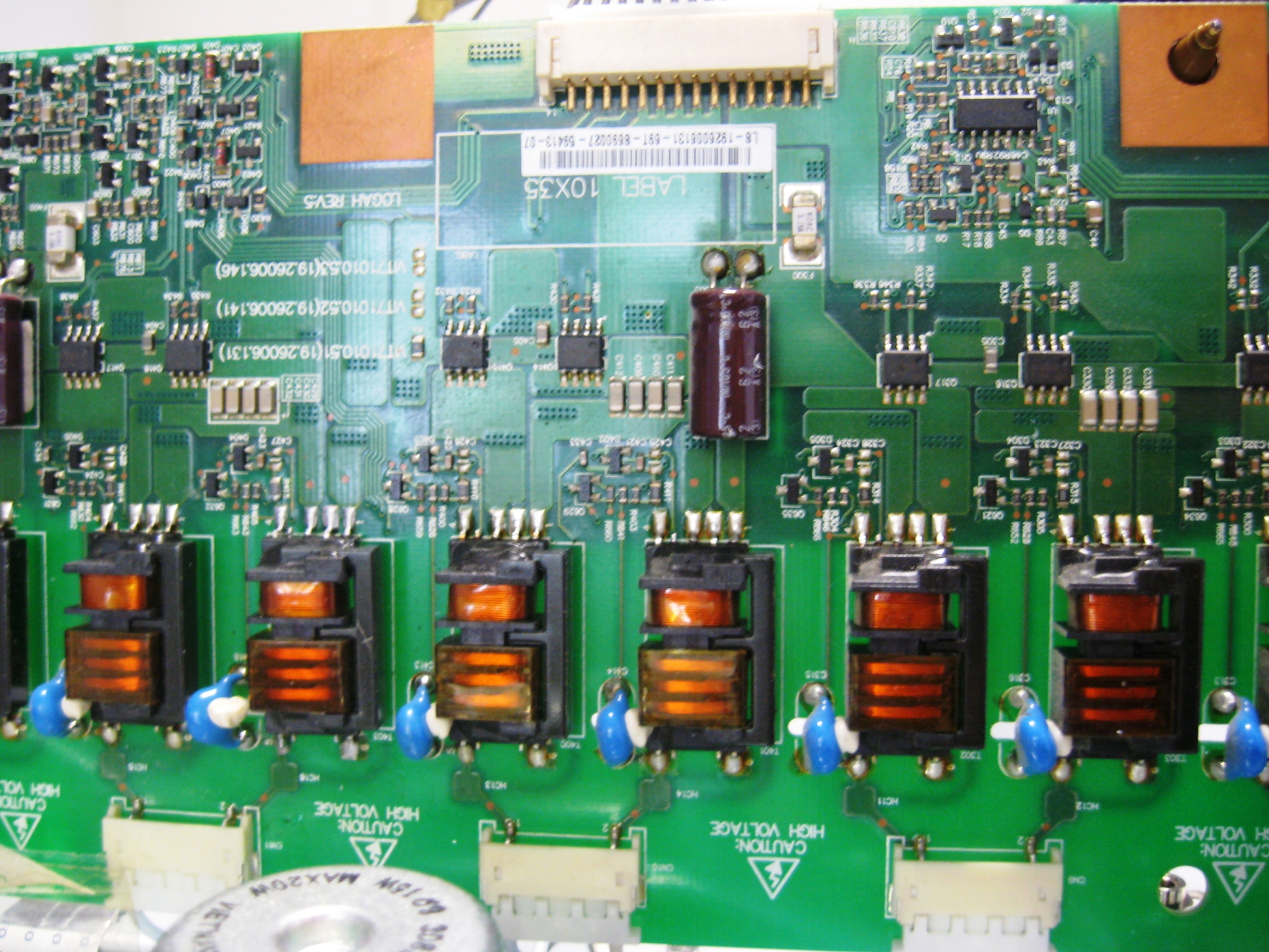

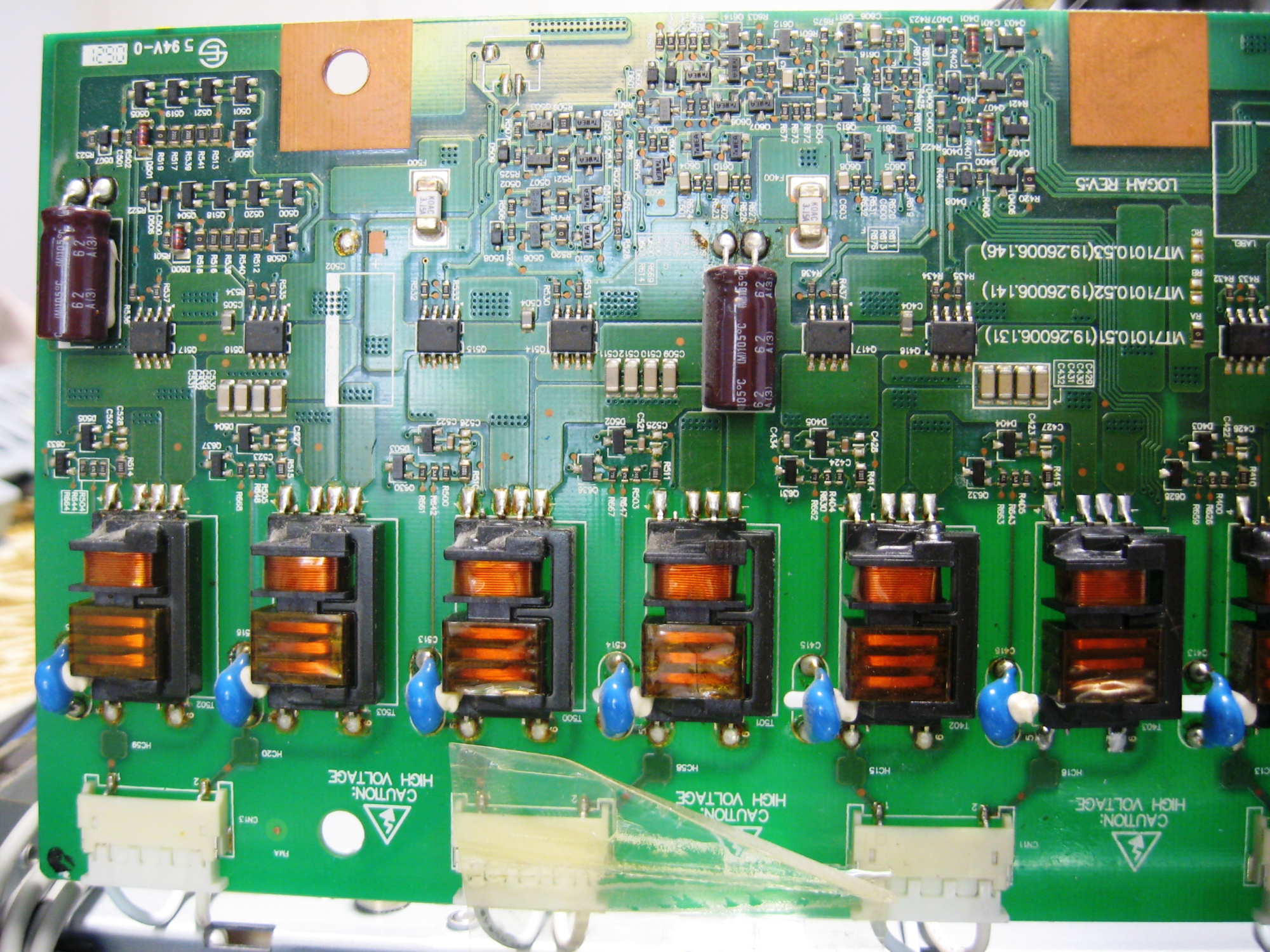

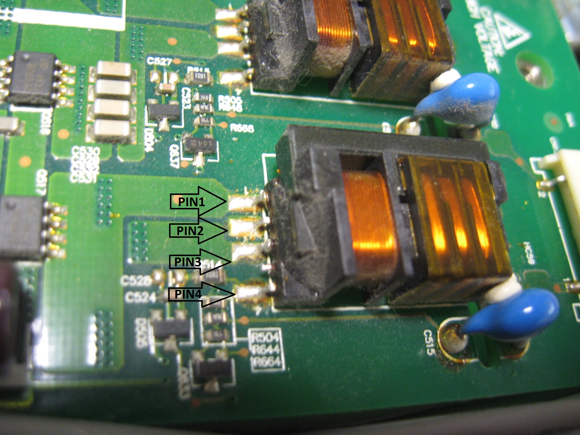

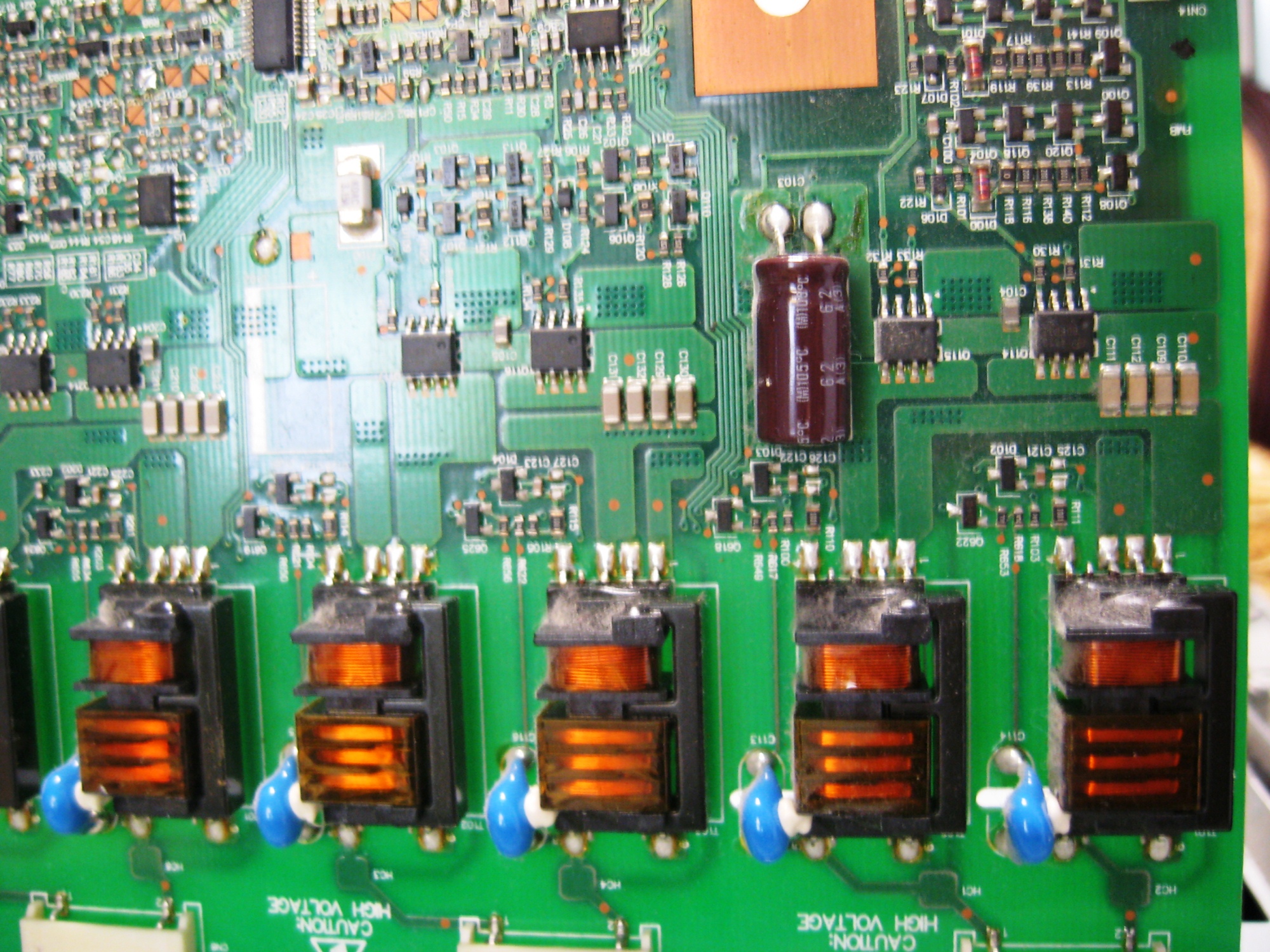

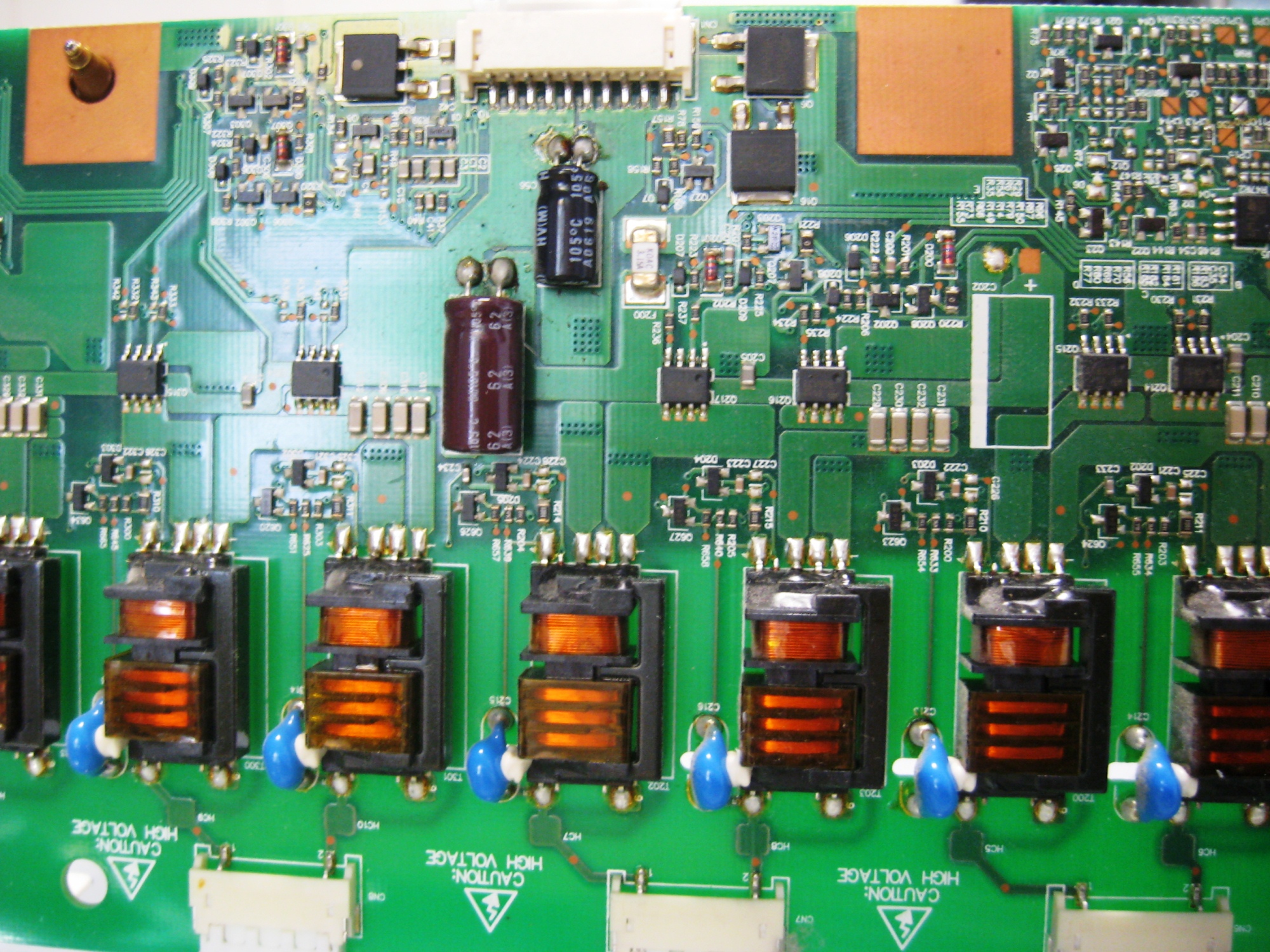

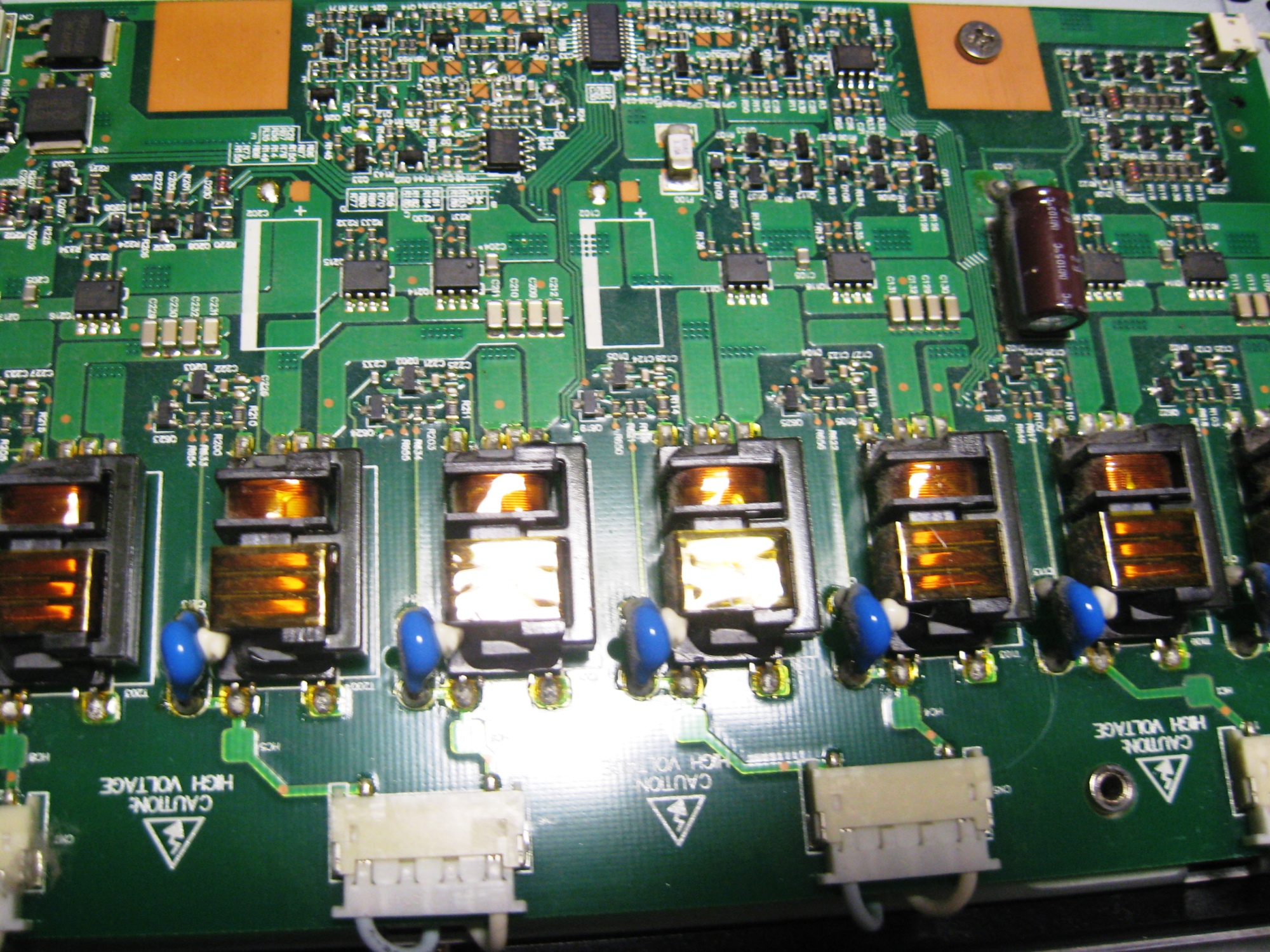

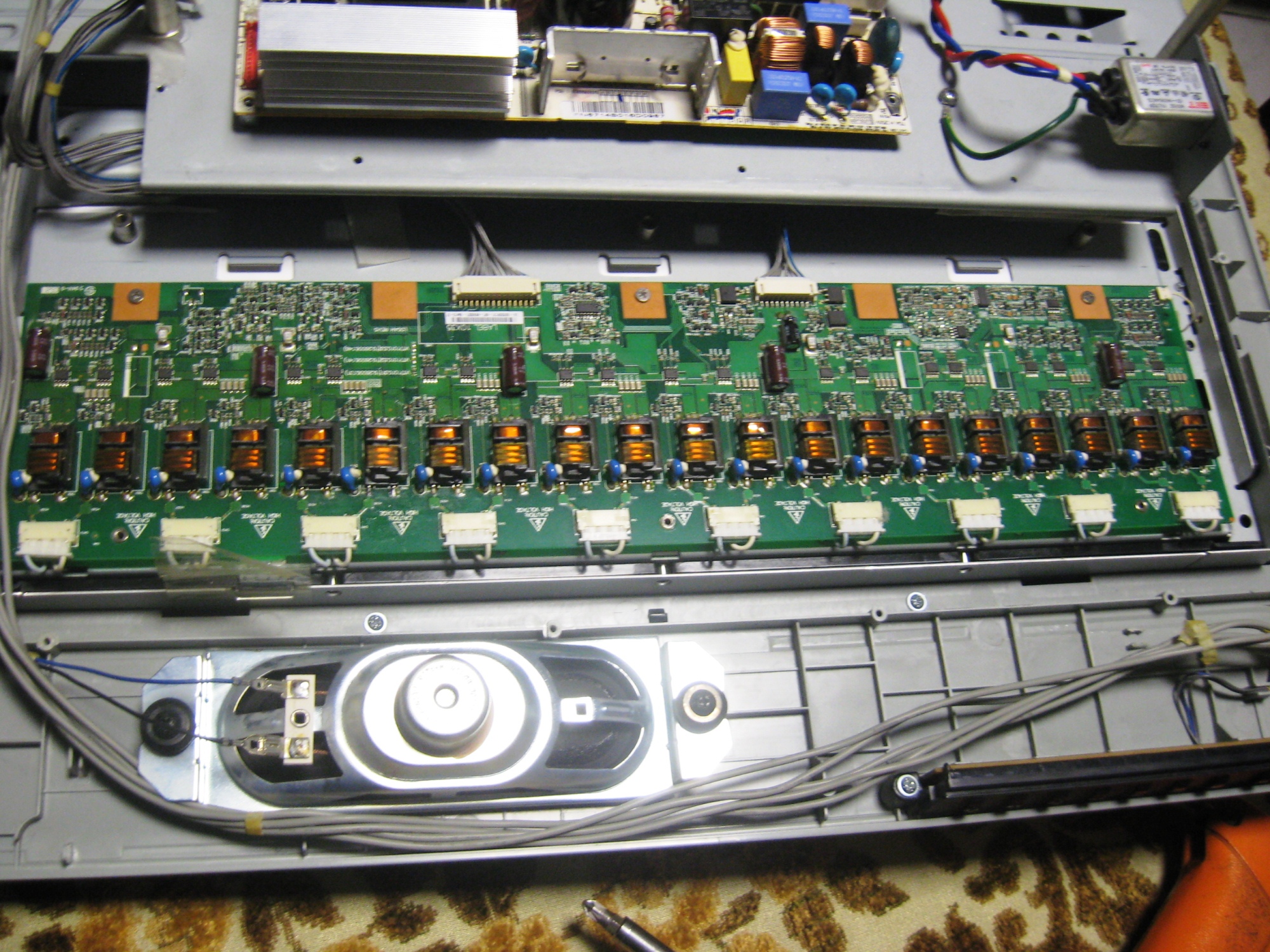

            I had attached a few pictures on my original post via "manage attachments" which originally showed up fine, but I can't see them anymore. Perhaps web server rejected them, later, on a second thought, as bigger than expected (2592x1944).
            New ones reattached (pics 2 to 5).
            I rechecked the 24V line to inverter, on the PSU socket and got 24.8V with lamps off and 24.2V lamps on. The I-C line (sense back to SMPS controller?) stays on 3.575V regardless of lamps.

            I have already mention reading this thread. Sorry about the quality of some of the attached photos, this is the best I can do with my compact camera.

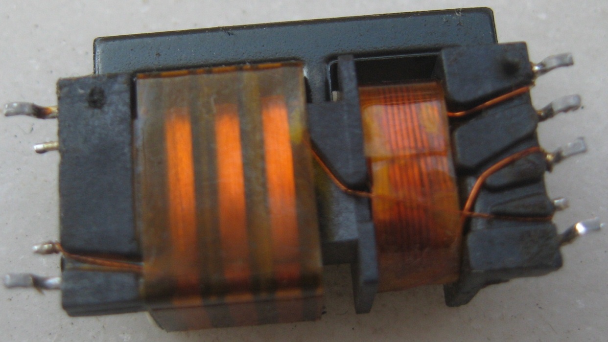

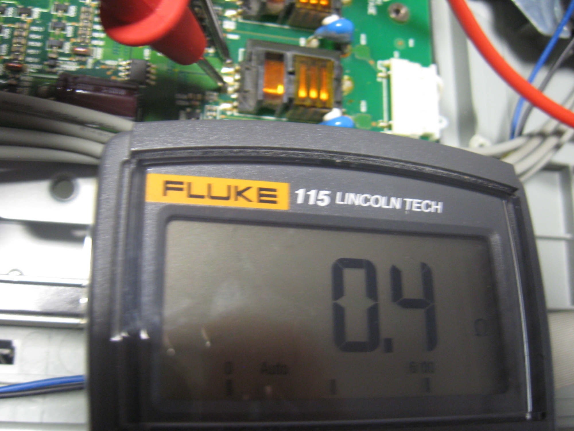

            I checked resistance on one of the 20 HV transformers. Pin numbered as on pictures 10 to 12.
            (pin,pin)->reading
            (1,2)->0L
            (1,3)->0.2-0.3 Ohm
            (1,4)->3.25 MOhm
            (1,5)->3.25 MOhm
            (1,6)->0L
            (2,x)->0L
            (3,4)->3.2 MOhm
            (3,5)->3.2 MOhm
            (3,6)->0L
            (4,5)->0L
            (4,6)->0L
            (5,6)->0L
            Which pins correspond to the secondary?
            I have also checked the 5 white SMD fuses on inverter board and they pass for continuity.

                What baffles me is that I take 0L (auto-scale or manual Ohm) on every single of the 20 transformers secondaries, that is pins (5,6) on my prev post.
                  Re: LG 37LC2R, backlight shuts down after 4 seconds
                  Hmm. Can you try removing one of them so we can see how the transformer is wired up.

                    Are you sure that is not 3.25k (kilo) ohm?
                    A picture of your multimeter might help as well.

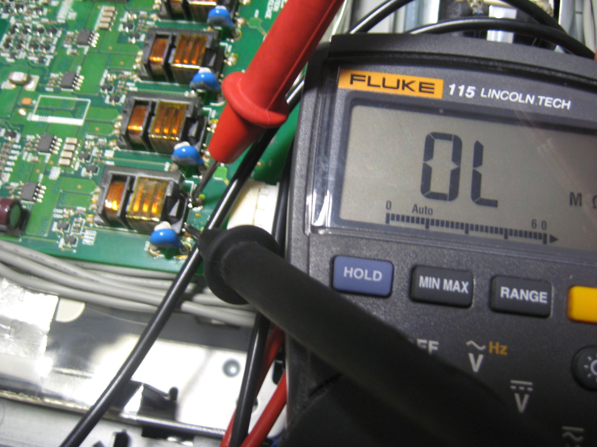

                      Auto-ranging, even tried manual.
                      I'll try remove one of them, if there is no alternative.

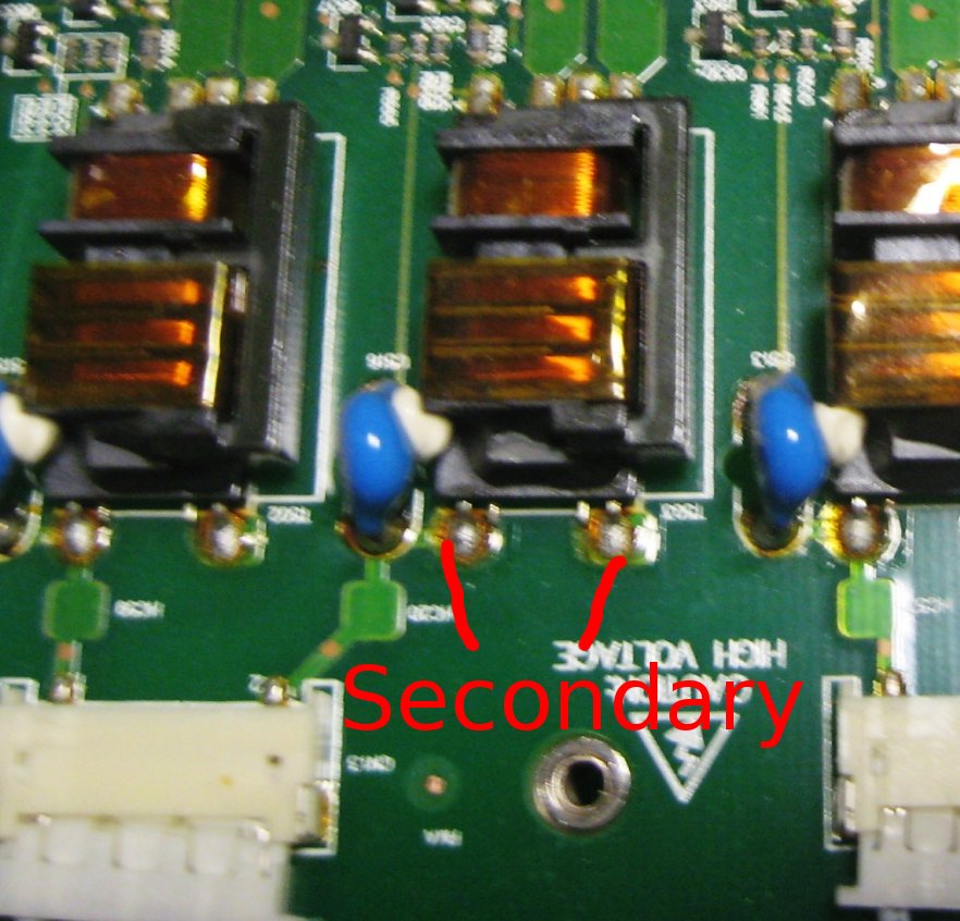

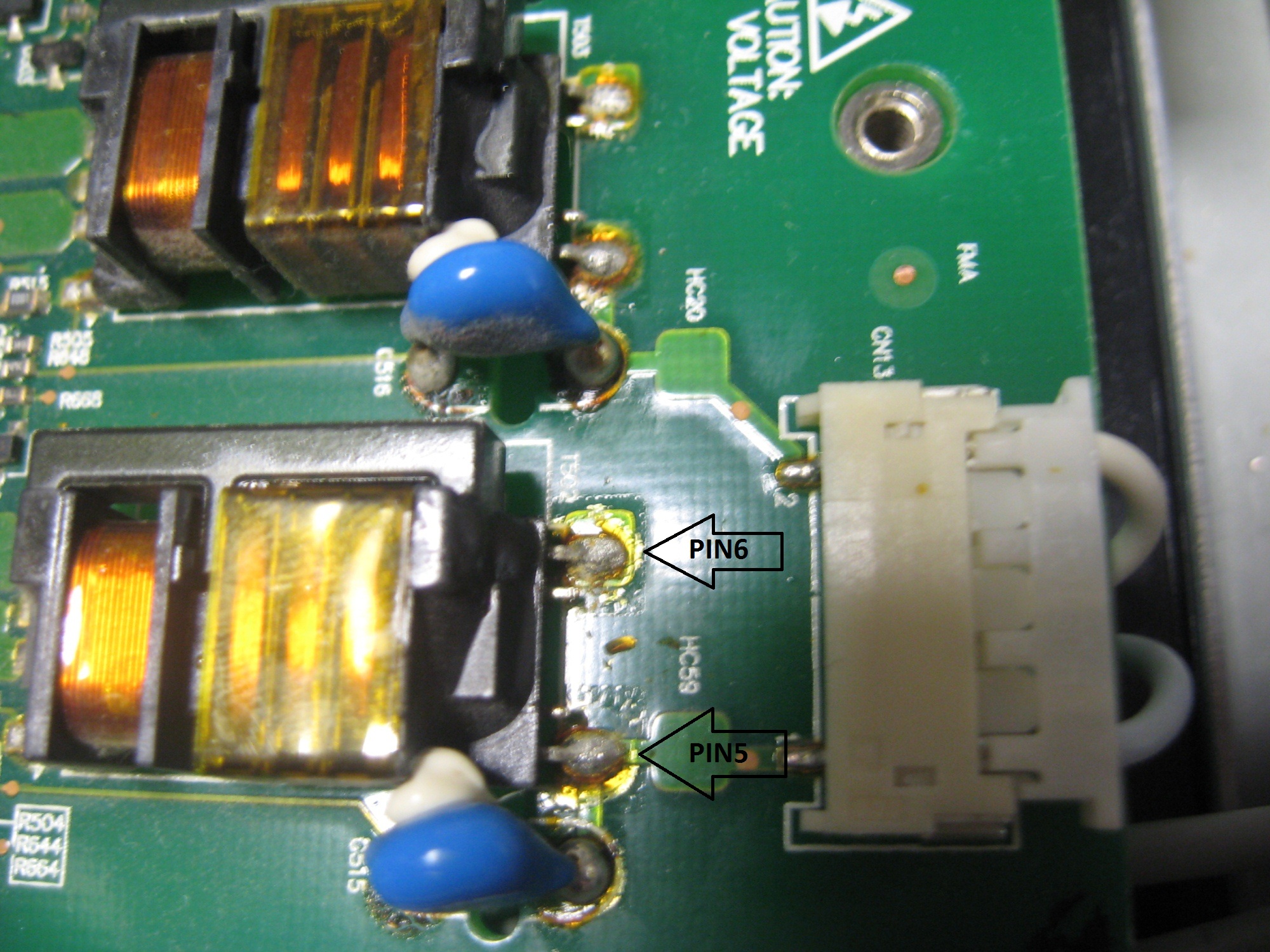

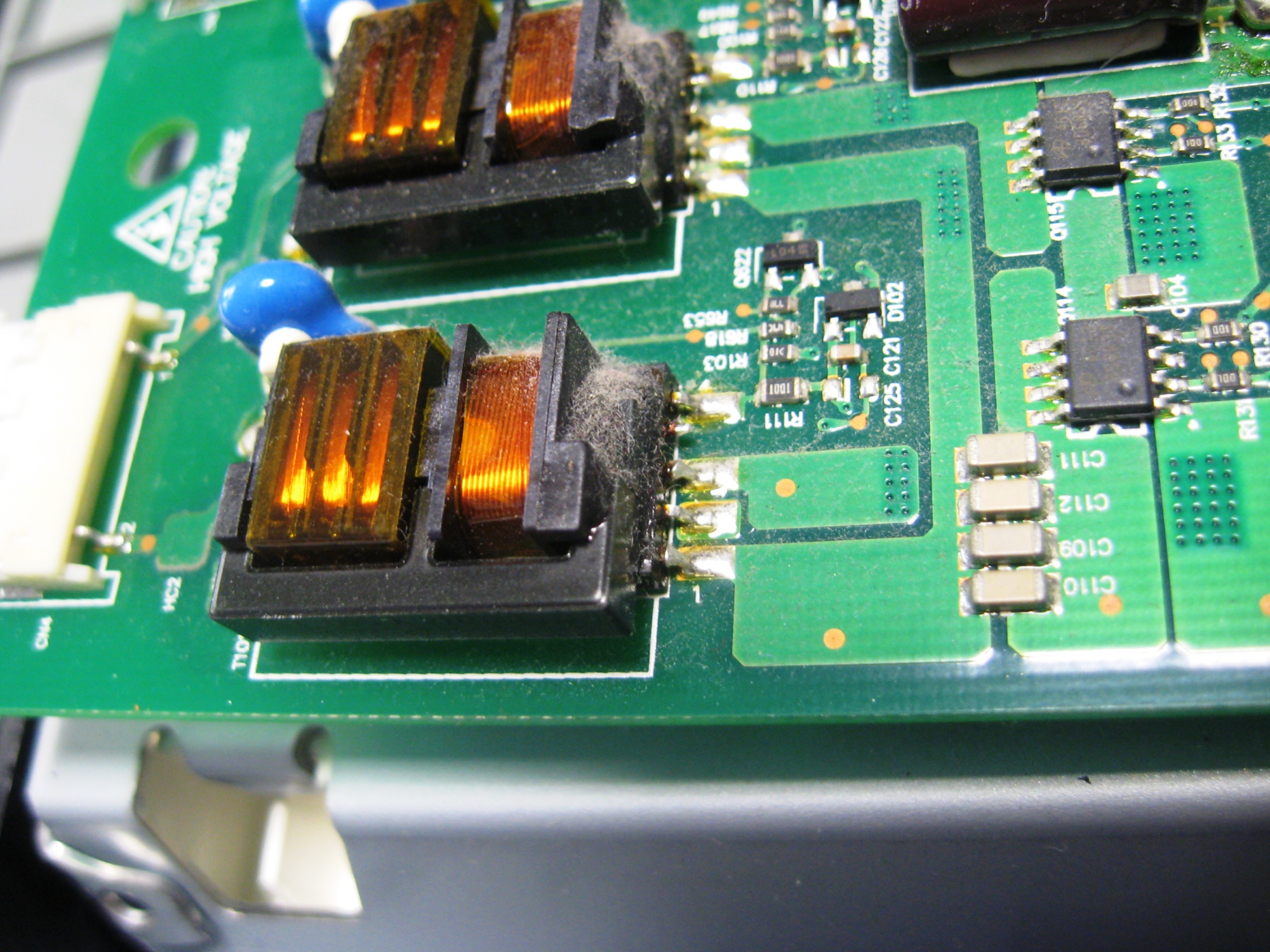

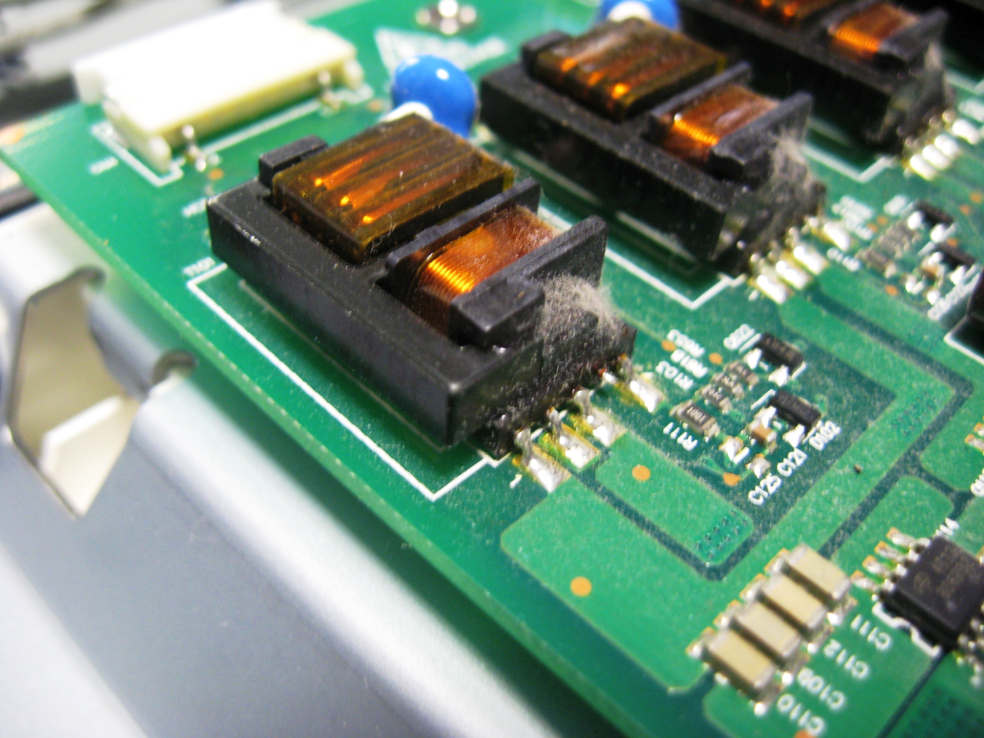

                      First picture shows transformer's primary(?), with my indications of the board pin numbers. Second pic the secondary(?) pins.
                      Next 3 pics the results at pins (5,6), (1,3) & (1,4).
                        If I remember right, this transformer high voltage winding is on pin 4 and 5, you may want to remove the transfromer so you can see the bottom side. 1 and 3 are for sure is the primary as you can see that they are connected to large pads and to the MOSFETS. You can also see pin 4 is connected to the detection network for lamp open/short detector circuits. You may also want to clean off the flux on the pins that may prevent you from making contact.
                        • amach
                          • Dec 2012
                          • 25
                          • Greece
                          My god, you are absolutely correct! Thank you very much. Pair (1,3) is the primary and (4,5) the secondary. Pin 4 seem to connect also to sense circuit. Pins 2 & 6 seem to stand unconnected.
                          Sorry, I had been careless on my previous measuring between (4,5) due to surface flux. Now ratings are far from 0L. Here they are for each quad of transformers:
                          1.737, 1.742, 1.743, 1.728 kΩ
                          1.742, 1.760, 1.764, 1.757 kΩ
                          1.745, 1.760, 1.736, 1.753 kΩ
                          1.750, 1.763, 559, 1.751 kΩ
                          1.756, 1.756, 1.754, 1.734 kΩ
                          We are making progress. I'll desolder the faulty part.
                          Then where can I find a substitute?
                            Good call. I do remember, now, there was a similar case in the past.
                              The above is bad.
                              Is there a part number one the transformer?
                              You might find it in the service manual?
                              PS. One retiredcaps' bonus point for a picture of your Fluke 115.
                                @amach, Do you mind if I post the pictures of your board in my album at Photobucket?

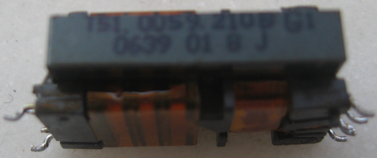

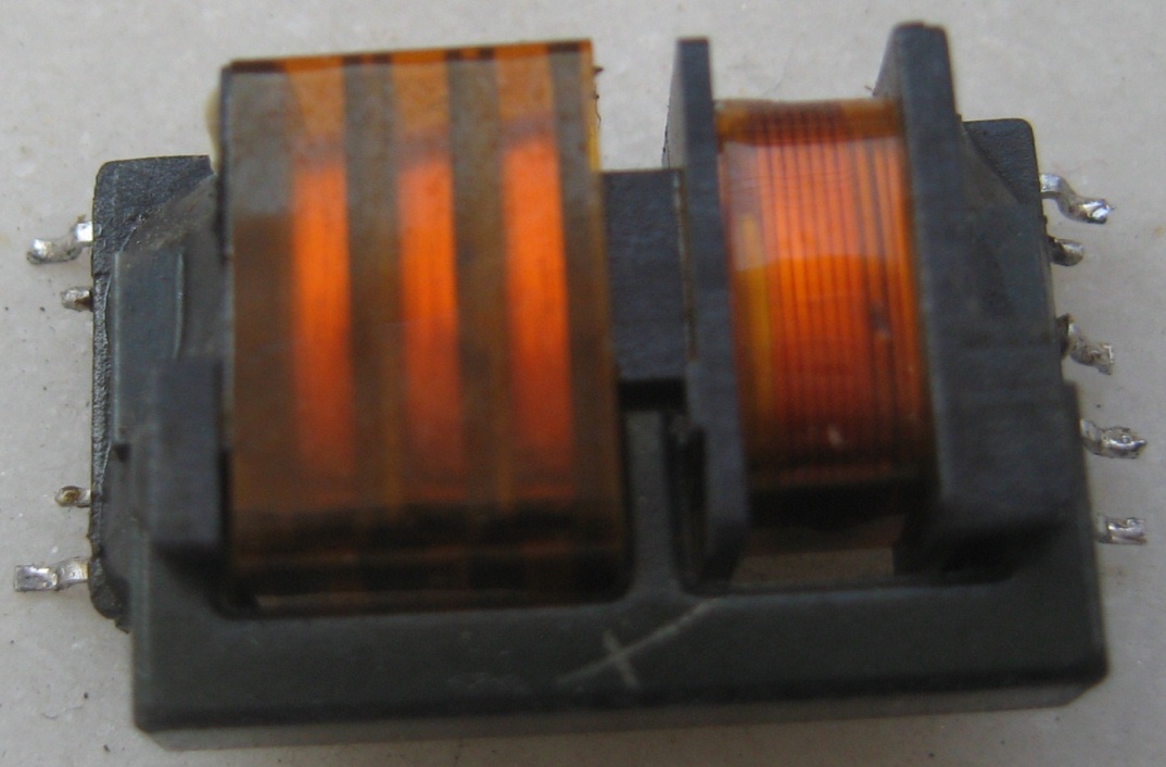

                                  I already have a service manual (which I attach), but I cannot find the HV transformers. Part number on board is T403.
                                  The prints on it is:
                                  "T51.0059.2108 G1"
                                  "0639 01 8 J"
                                  The inverter board model is vit71010.53 .52 .51

                                      The actual part is T51.0059.210B and not .2108. The print is vage but google search had the final word.
                                      I have found it on eBay, 16€ incl. shipping, pricy considering the whole inverter lists for 18€ plus shipping. I am searching and considering my options.

                                        Just to inform the fellow-forumers that I couldn't find the transformer, anywhere on the internet.
                                        Instead, I purchased form ebay (32 euros incl. ship.) the whole inverter board extracted from a SAMSUNG LE37R74BD or 37WLT66.
                                        My tv now works flawlessly.
