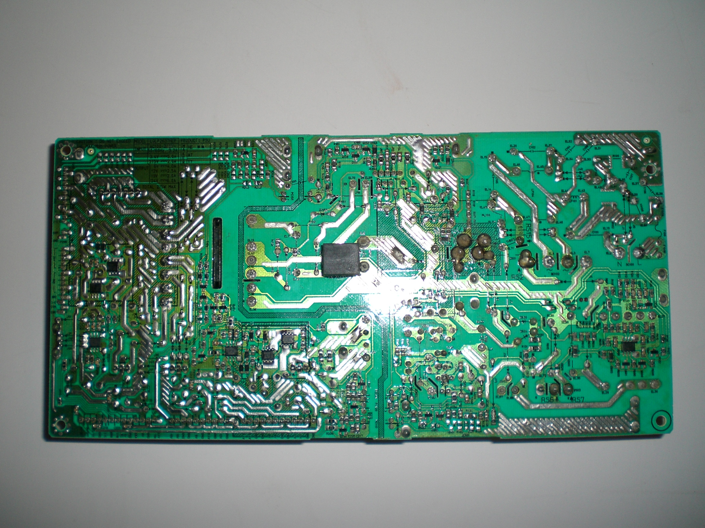

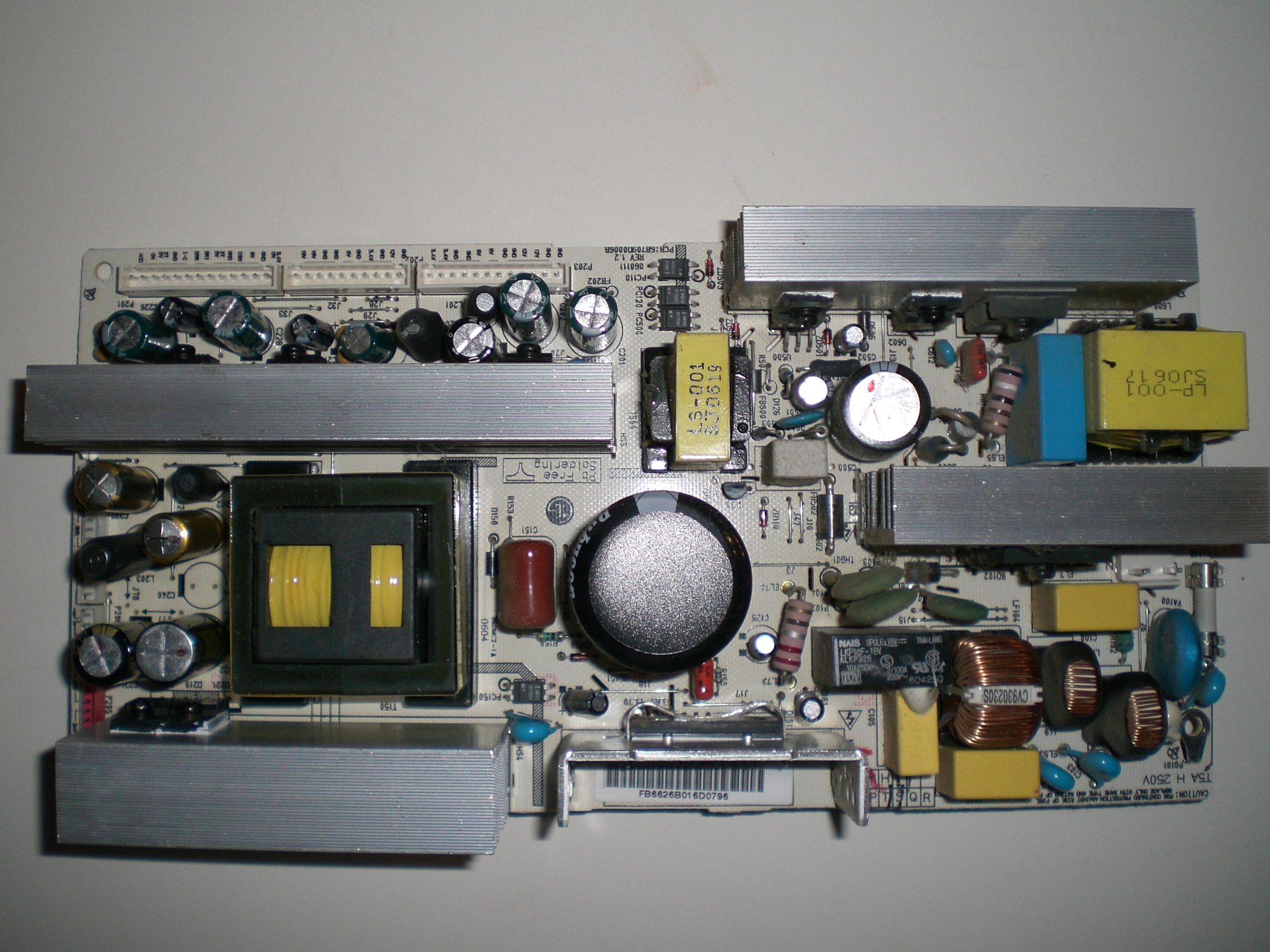

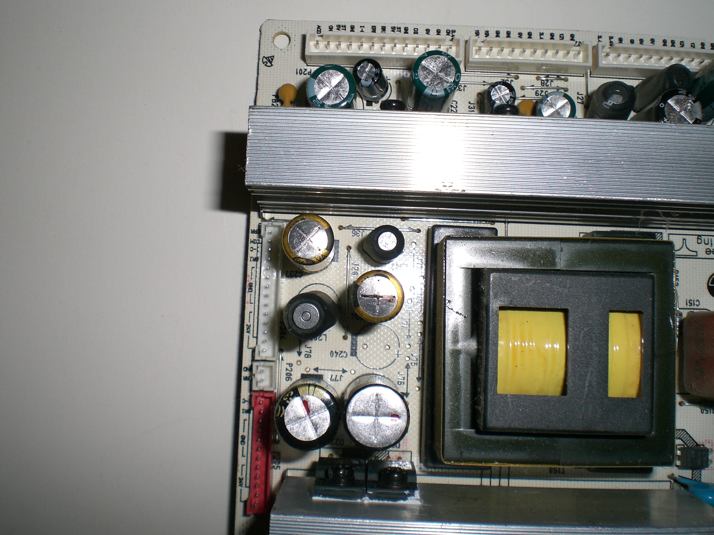

    A co-worker brought me an LG 37LC2D that stopped working. Plugged it in and saw the red LED light. Pushed the PWR button and LED went green, but no picture or sound. Stripped the covers off to expose the MB, PS and other boards. Immediately notice that there were two bulging capacitors in the secondary side of the PS. Replaced both and she fired right up. Not positive, but the make of these caps were SANWAH (?) 1000uf @25 VDC. Circuit component numbers were C237 and C234.

      I recapped them all in the secondary side and it has been working fine, I believe TOM66 found bad 3.3V power supply section on this power supply board that burnt up due to bad caps also.
