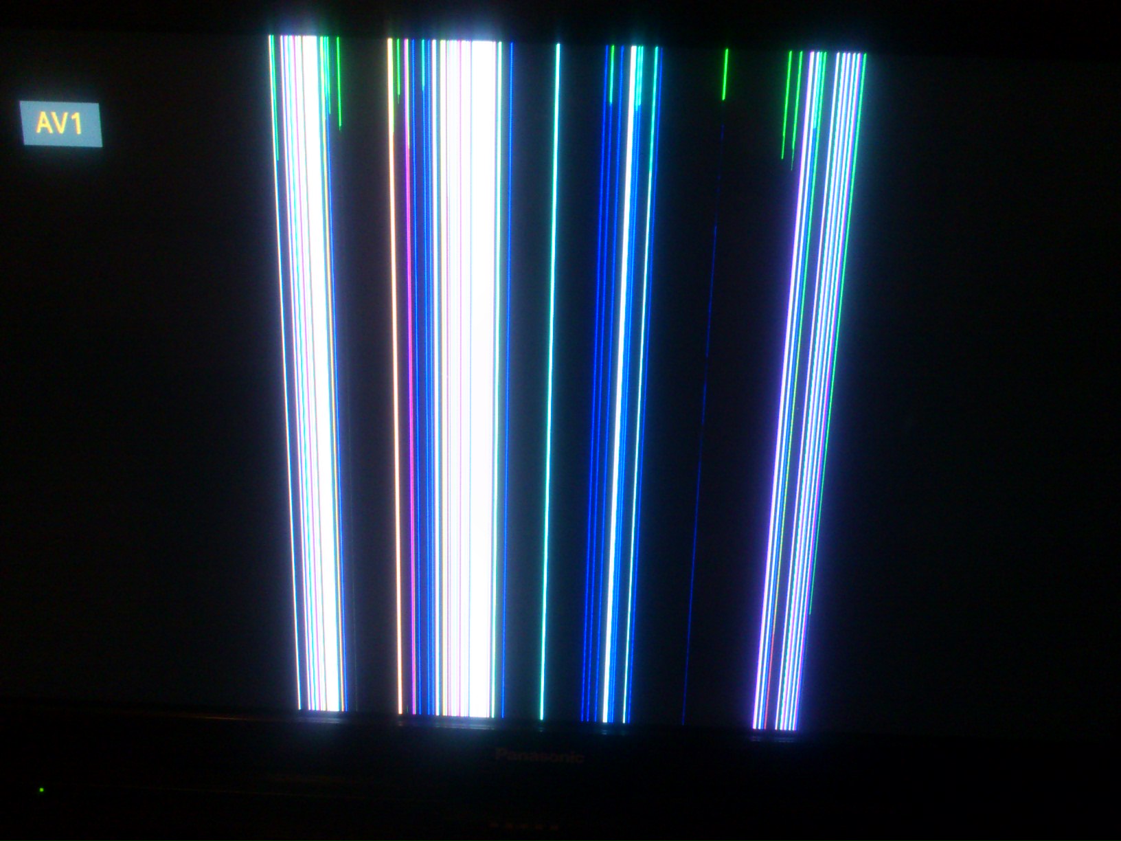

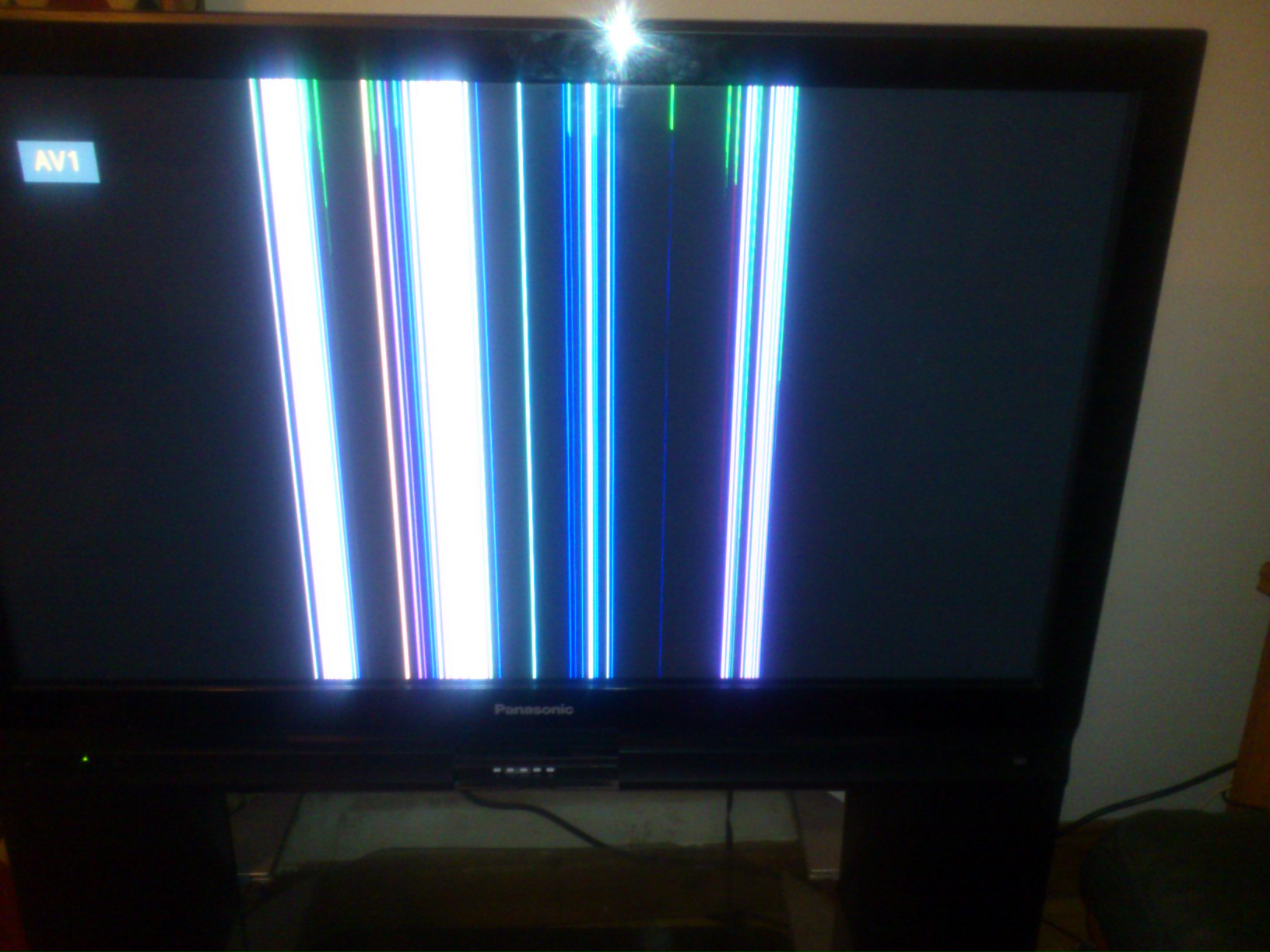

    Panasonic plasma lines th-42px70b
    Iv got a panasonic 42" plasma with vertical thin colour lines. Iv never fixed a plasma before only lcds. Should i replace the buffers and if so what ones
    Re: Panasonic plasma lines th-42px70b
    This is almost certainly a bad plasma panel and cannot be repaired.
    • stevieh2o
      • Dec 2012
      • 28
      • United Kingdom
      Heres pics
        Yes, that is most likely a bad plasma panel unfortunately. I do not know how so many lines could fail at once though. You can try replacing the C1/C2/C3 etc boards (horizontal buffer boards) but I highly doubt it will solve the issue.
        Sorry to be the bearer of bad news!
        • stevieh2o
          • Dec 2012
          • 28
          • United Kingdom
          No probs just gona break it. Thanks tom
