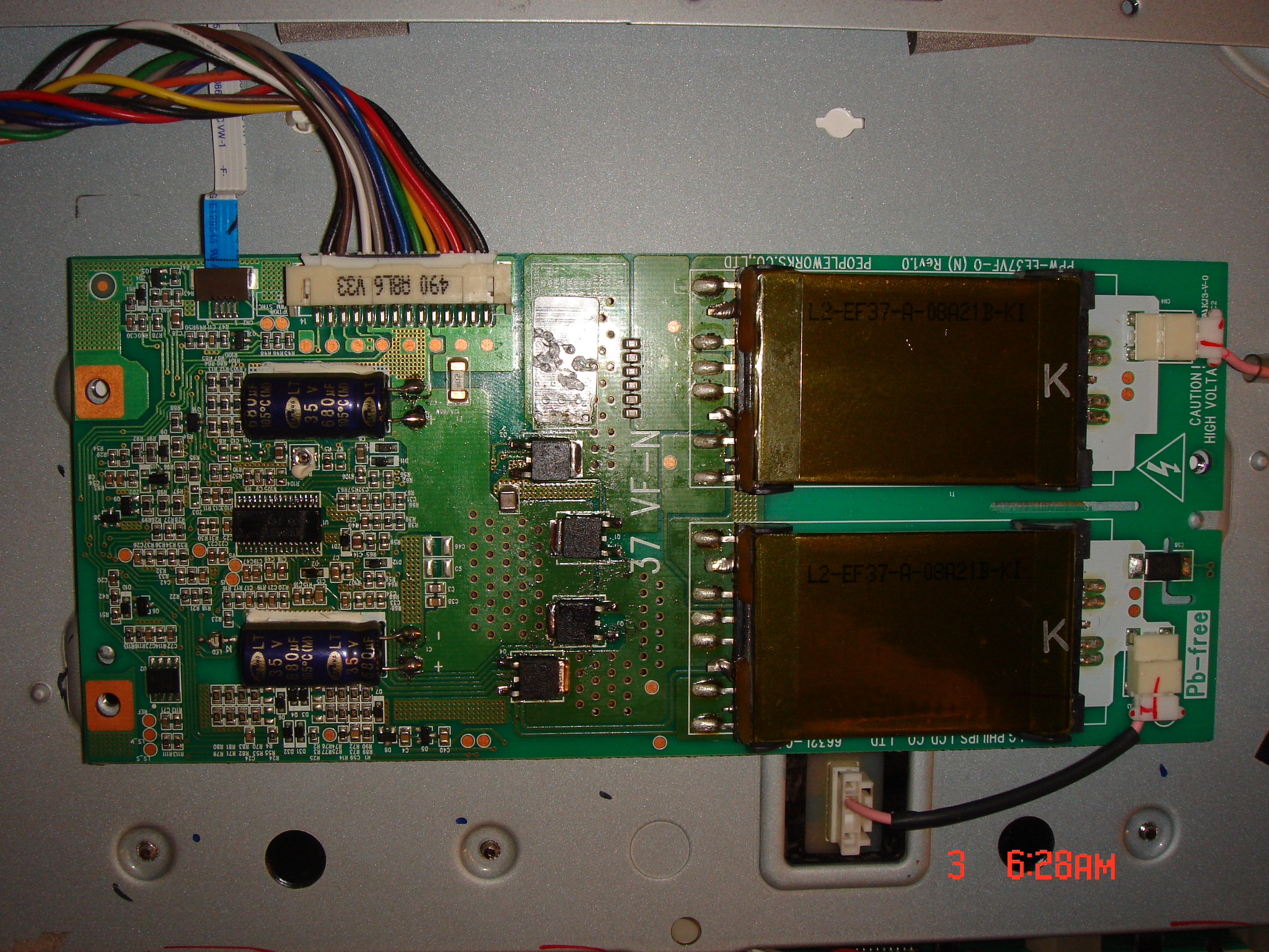

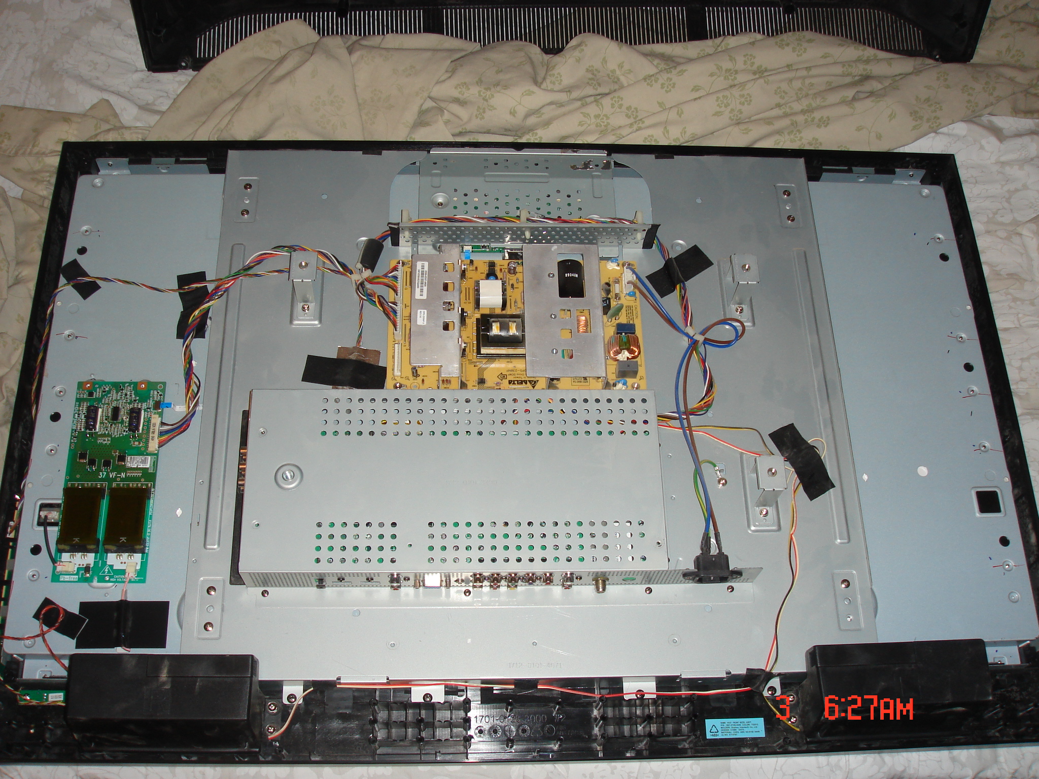

    VIZIO VO37LFHDTV10A no backlight
    Hi Guys, this inverter has all the necessary voltages required to turn on. The blue led on the board flashes briefly and no backlight. The fets never get biased and yes the 12 amp 24v fuse is good and I got 24volts on both sides of the fuse. The 5v and the dim adj I think 1.8 or 2.8 I don't remember. So I replaced the fets and the bd9897 control chip and the same thing blue led flashes and no backlight
    Re: VIZIO VO37LFHDTV10A no backlight
    What is the voltage for the BL_ON (ON/OFF, INV_ON)?
      5volts steady the whole time the power is on. there is a little blue surface mount led on the inverter that comes on and shuts off a second later.
        I think Something on the inverter board besides the commonly sold repair kit of 4 fets and a control chip. I just don't know hot to trouble shoot the control circuit on the inverter.
          It might be cheaper and easier to just get the new board instead of trying to fix the old one down to component level.
              To do component level will need diagram. you can first get the spec of the ICs, the pinout of the transformer so you can at least check the high voltage winding resistance of the transformer, the voltages on the ICs. After that is done, then you can trace out the copper traces on the board to see how all the components are connected together and then you can see how it works, I have done it many times and very time consuming.
