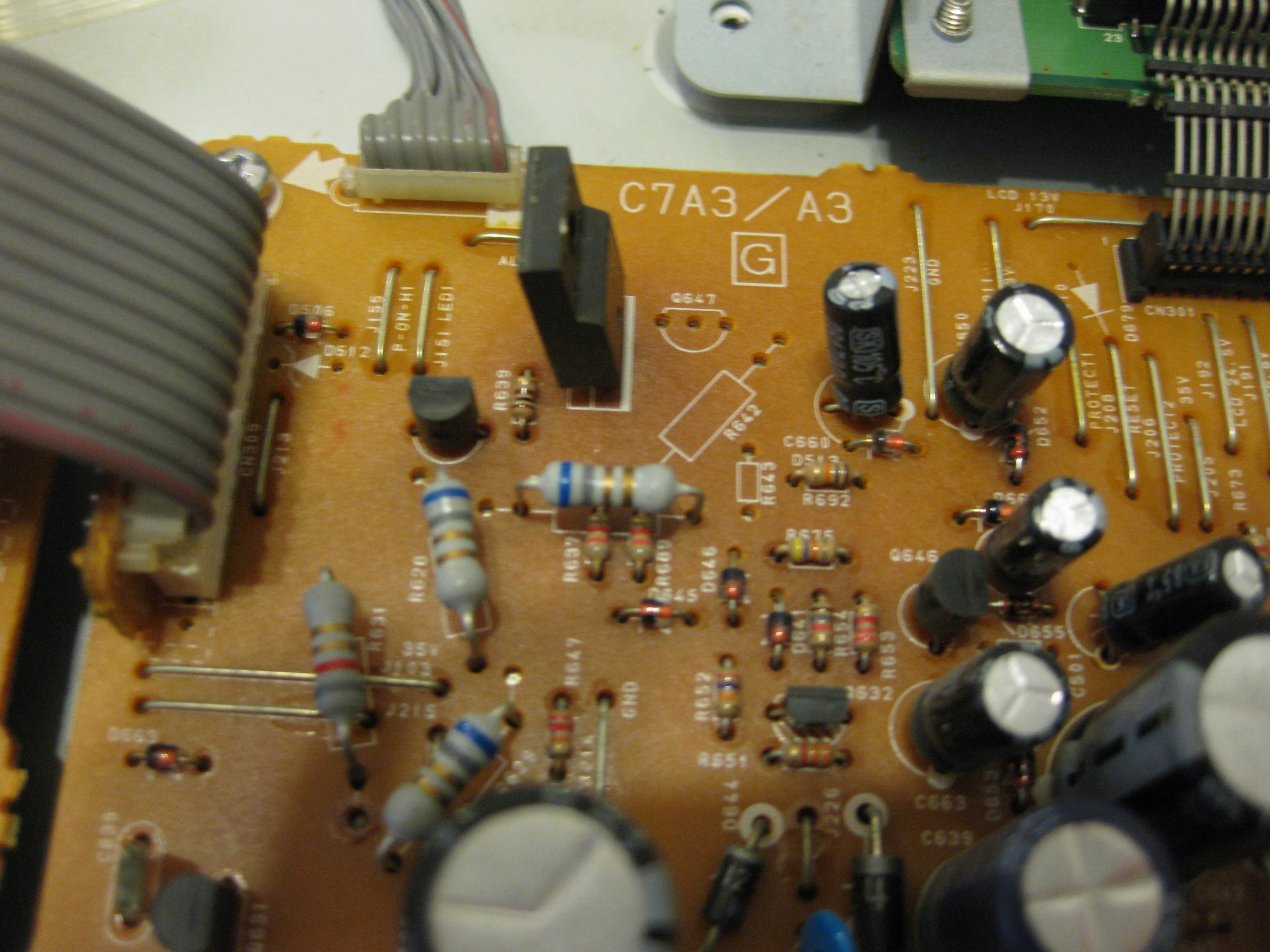

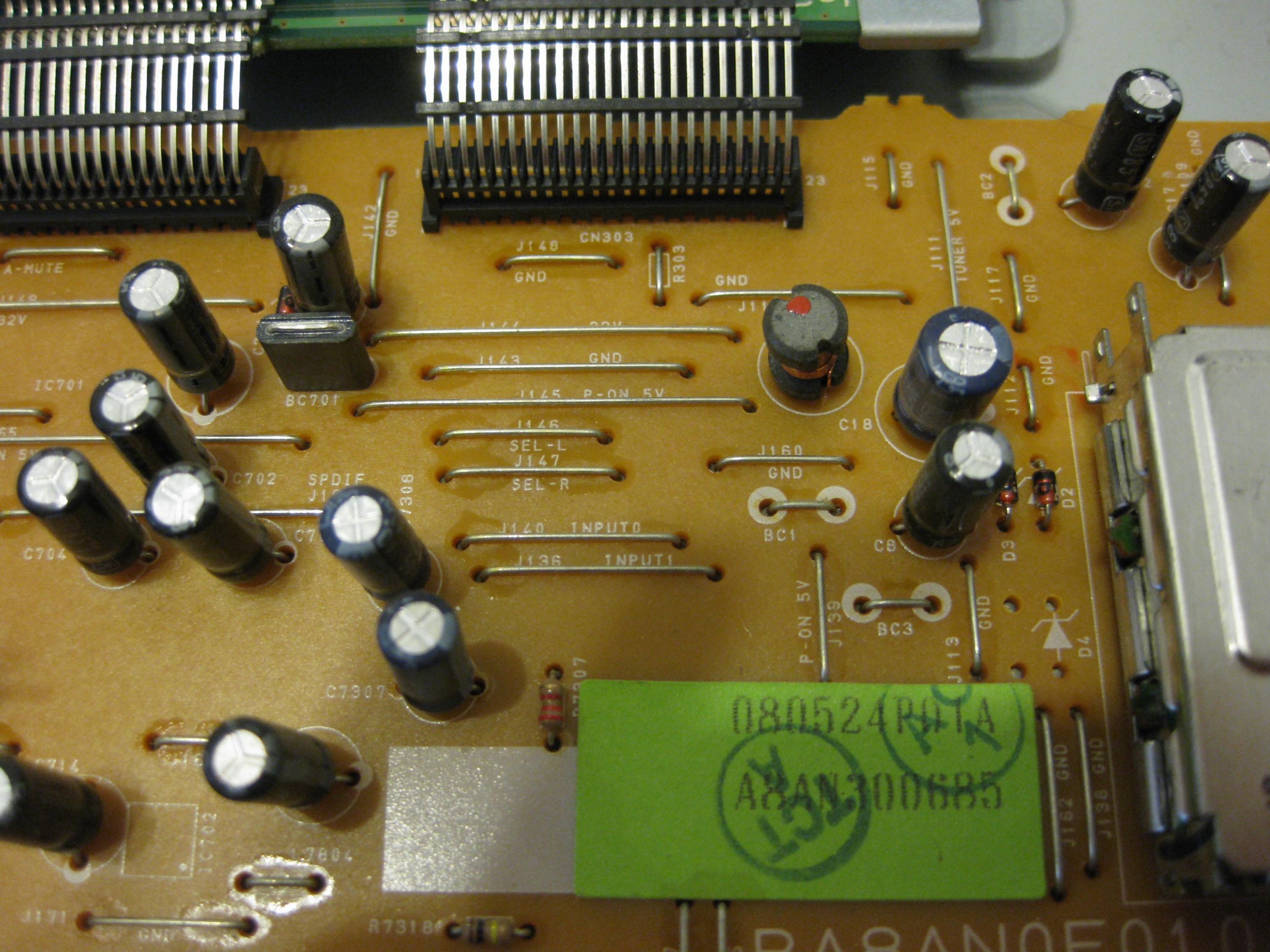

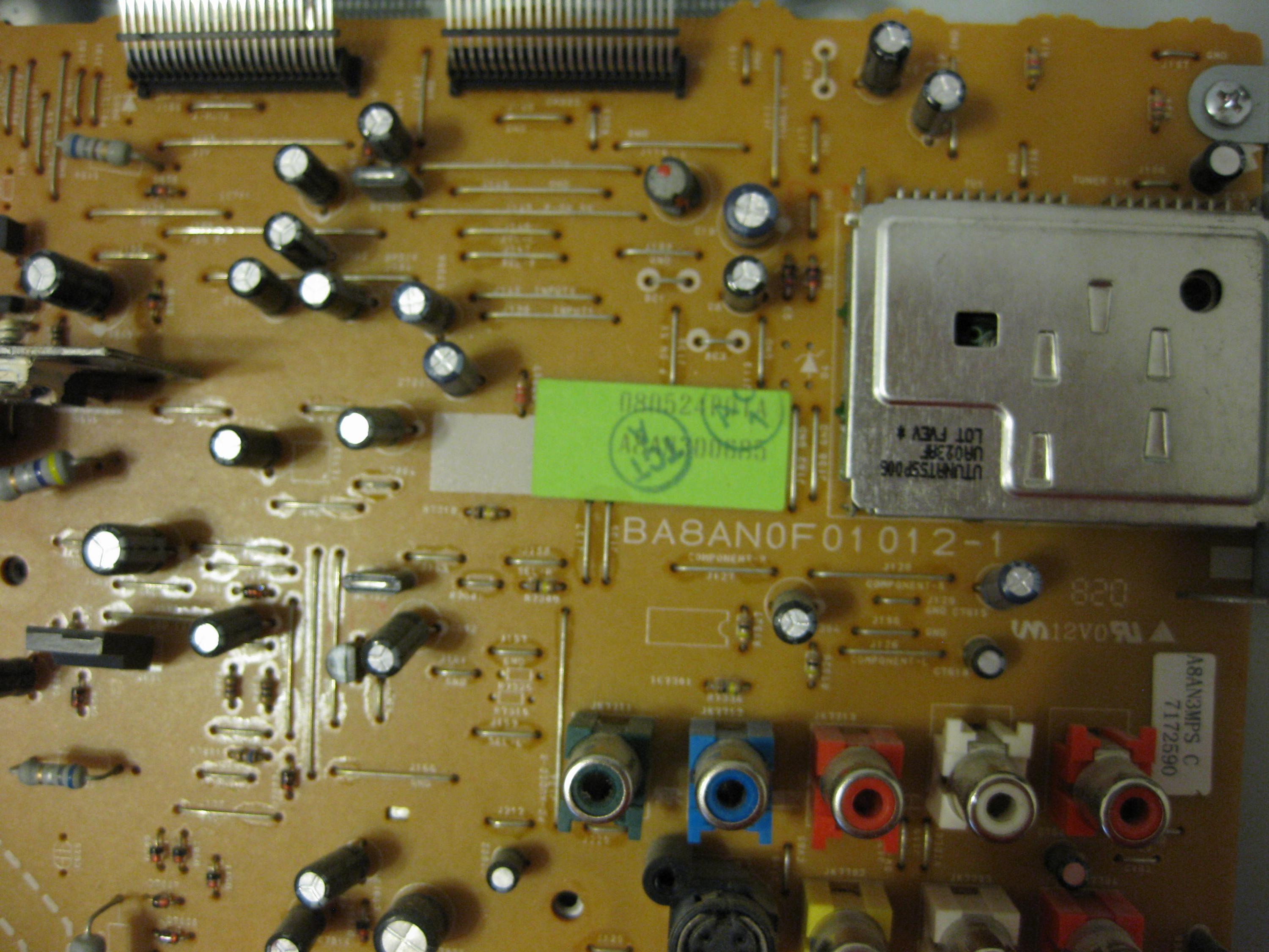

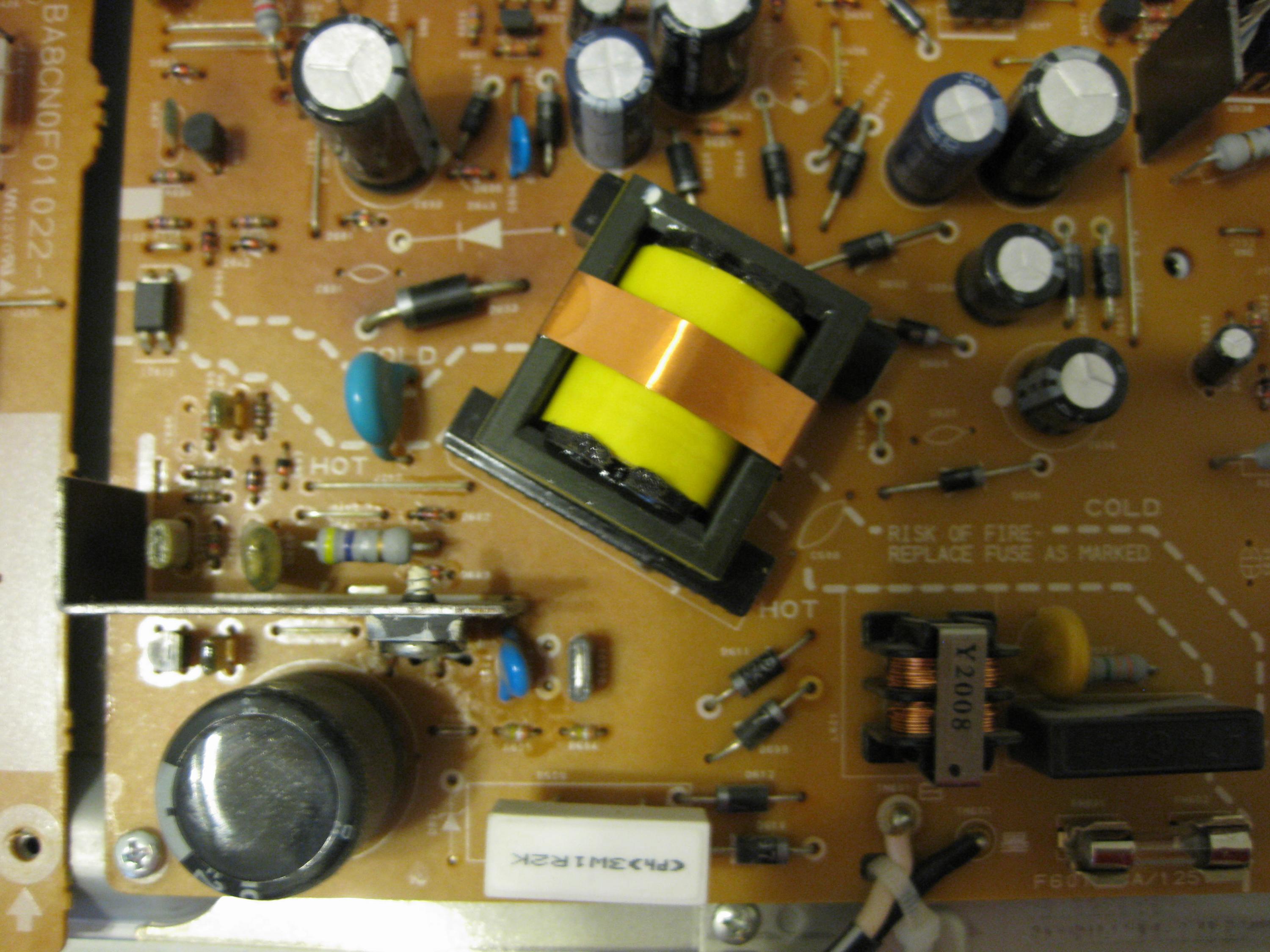

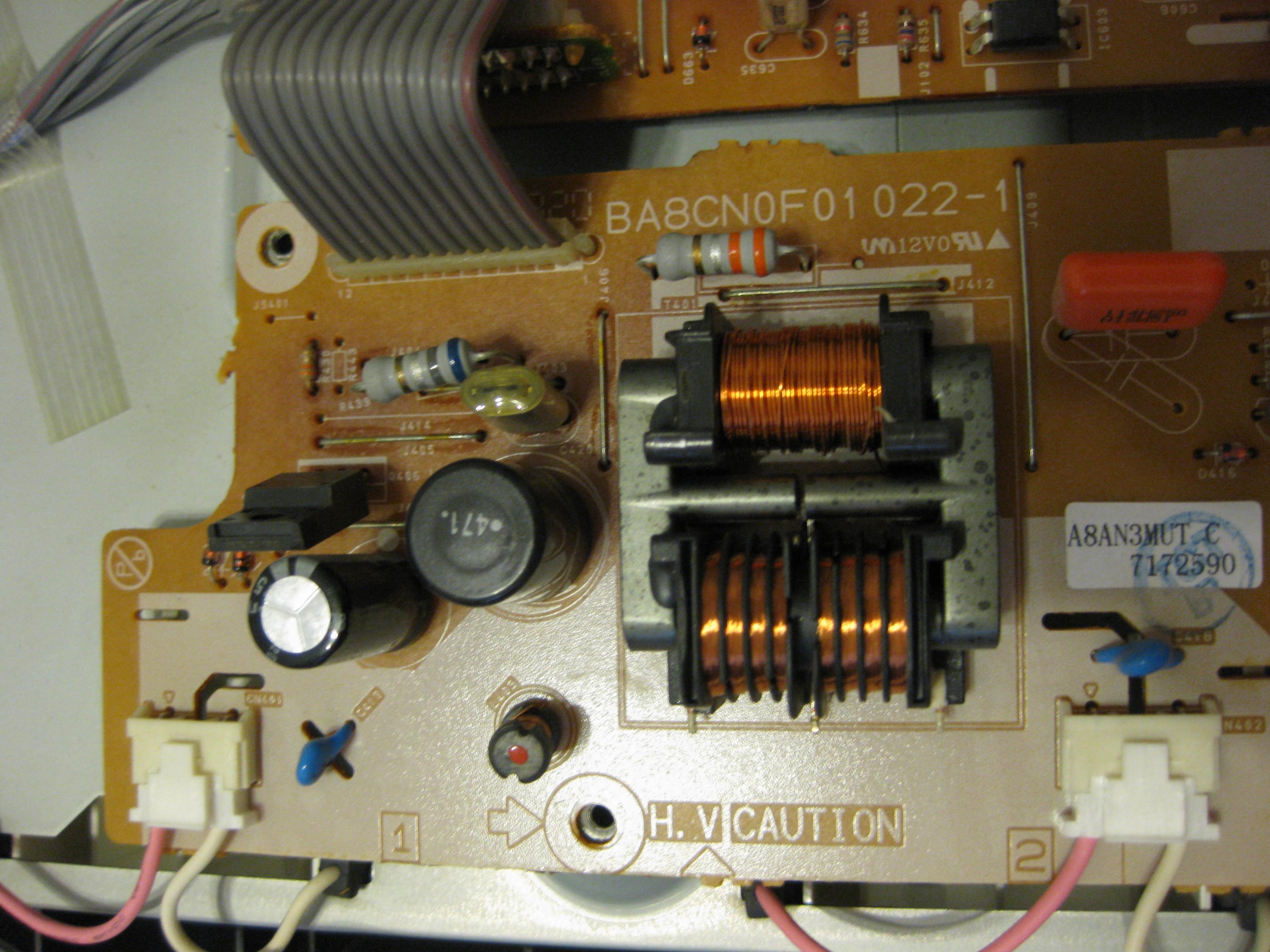

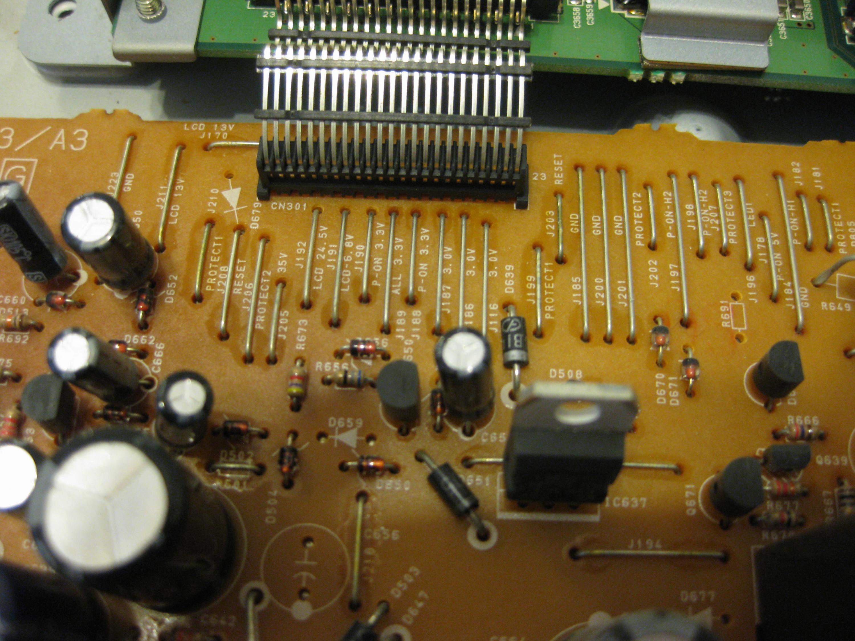

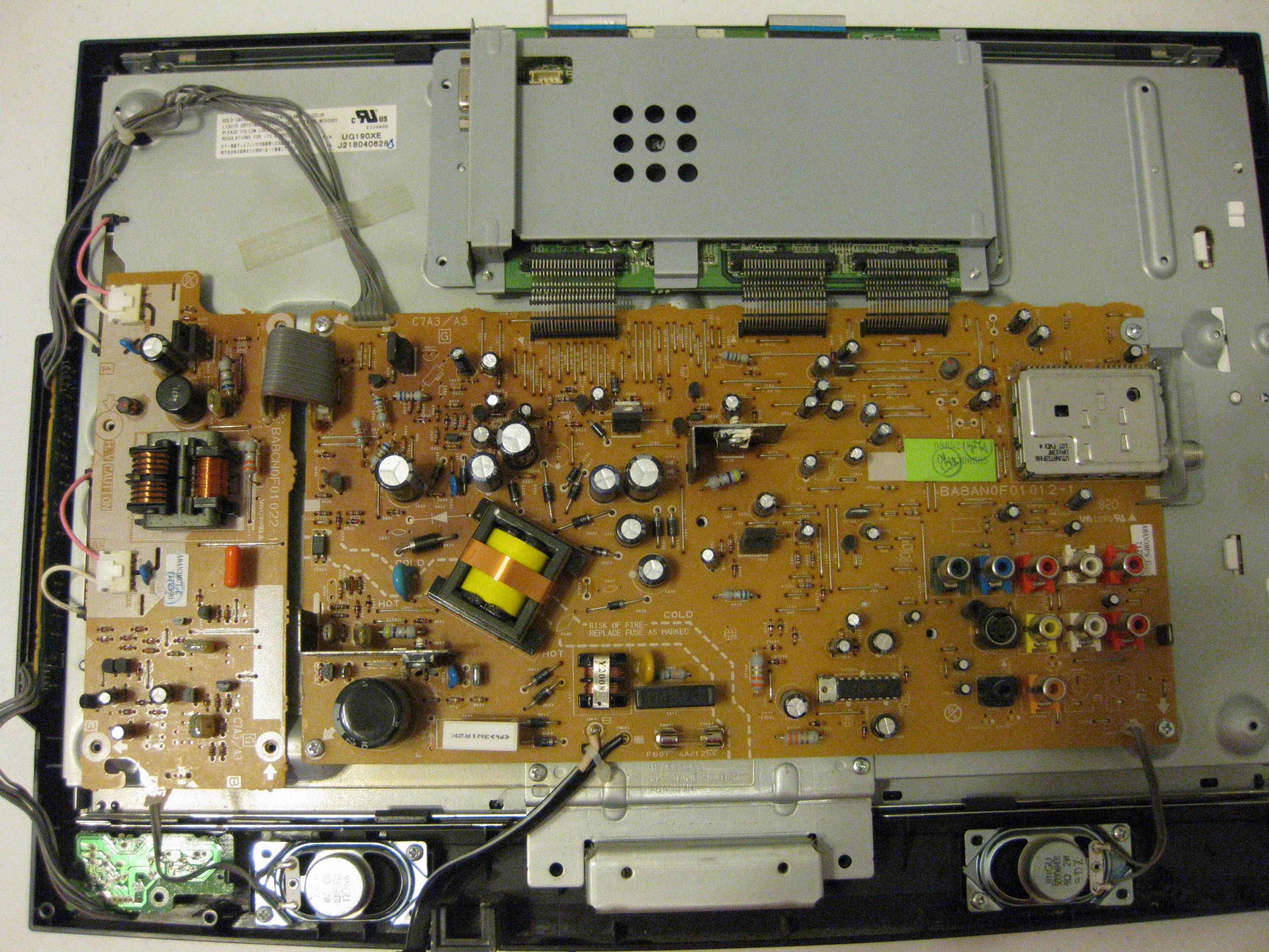

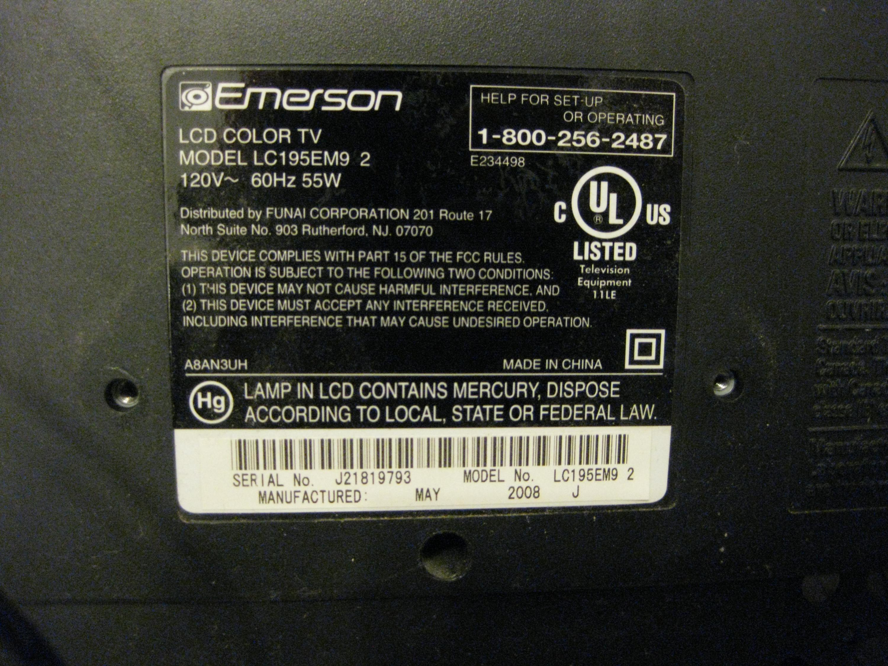

    Issues: Power and sound but no display.

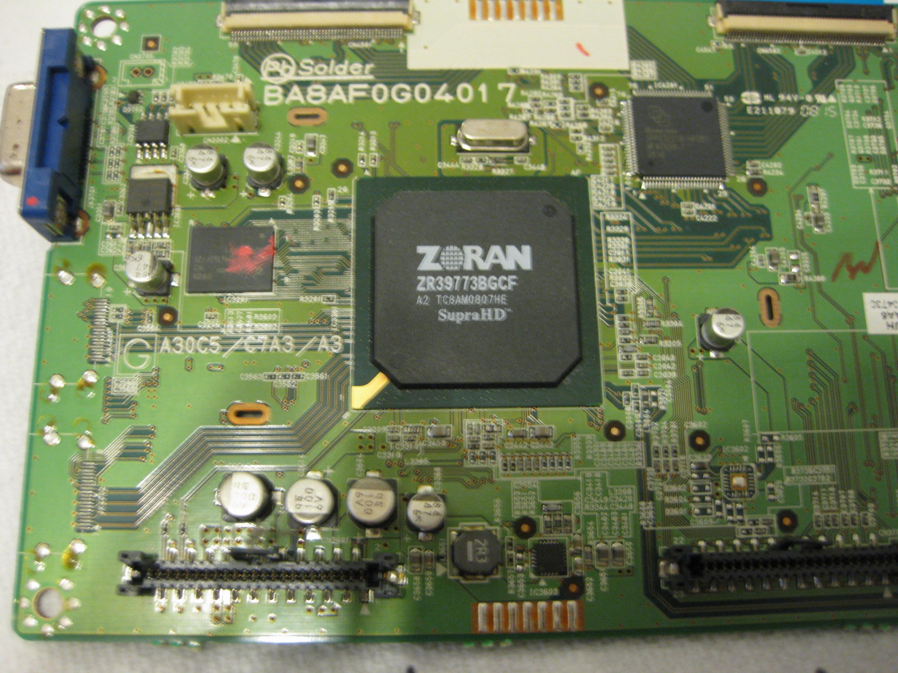

    When powered, the power light blinks 15 times then stays on solid. The backlight does not glow and when I shinned a flashlight on it I could not see any image. There are currently no inputs going to the TV. After looking on ElektroTanya I found a manual for an Emerson LC195EM82/EM87. This manual has been downloaded. This manual does NOT appear to be β€œclose enough”.

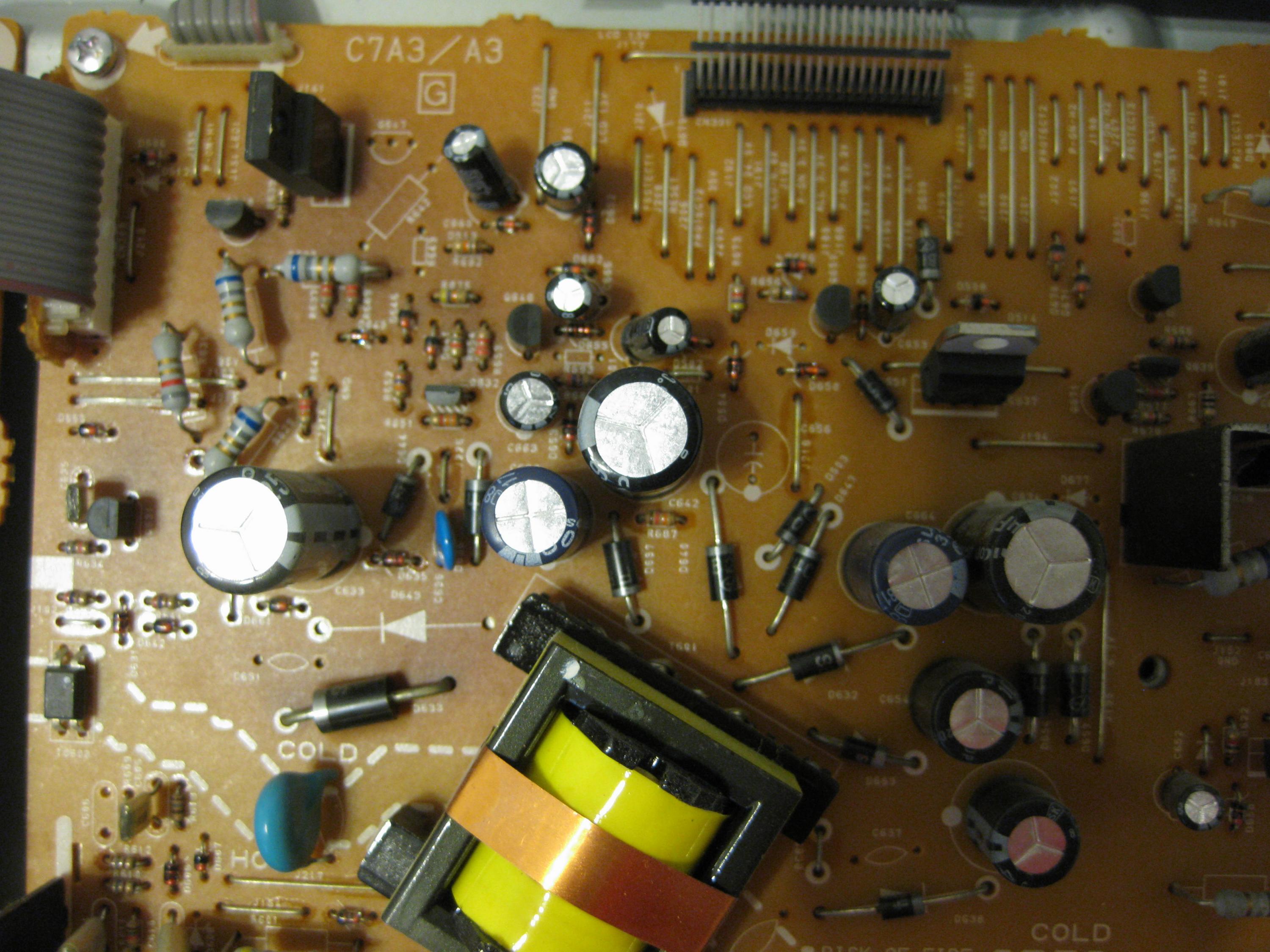

    When using a meter, all of the jumpers on the main board (the large board) have the voltages listed on the PCB board.
    Sorry about the inferior pictures, its snowing outside and I don't have access to any other natural light.
    If better pictures are required, please be specific.
    Does anyone have access to a manual?

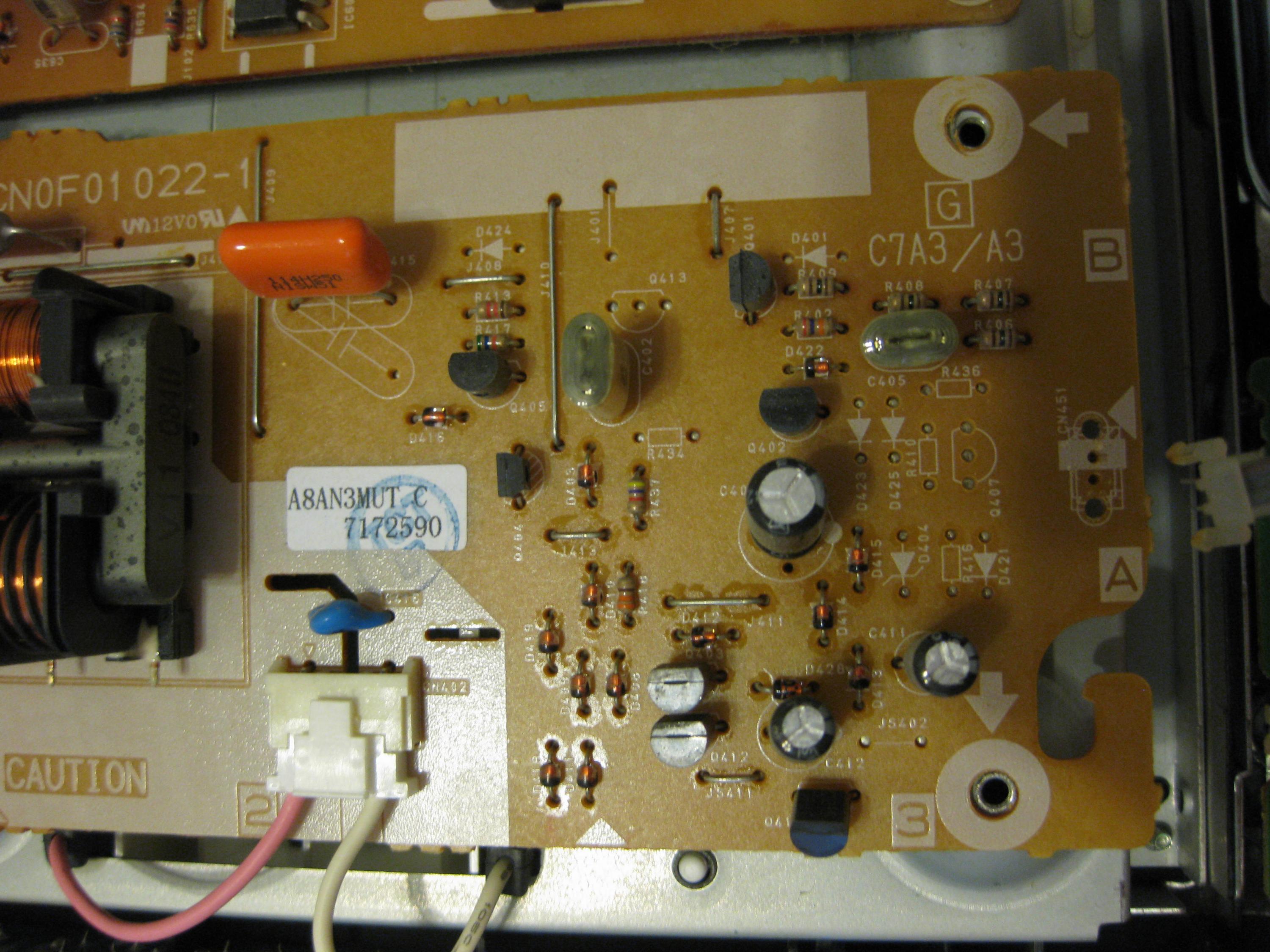

    Any thoughts if this may be an inverter board, the backlight, another overlooked power supply, etc, etc?
    I don't mind buying a board and replacing I would just like to verify that im purchasing the right part(s).
    Any feedback, thoughts would be appreciated.

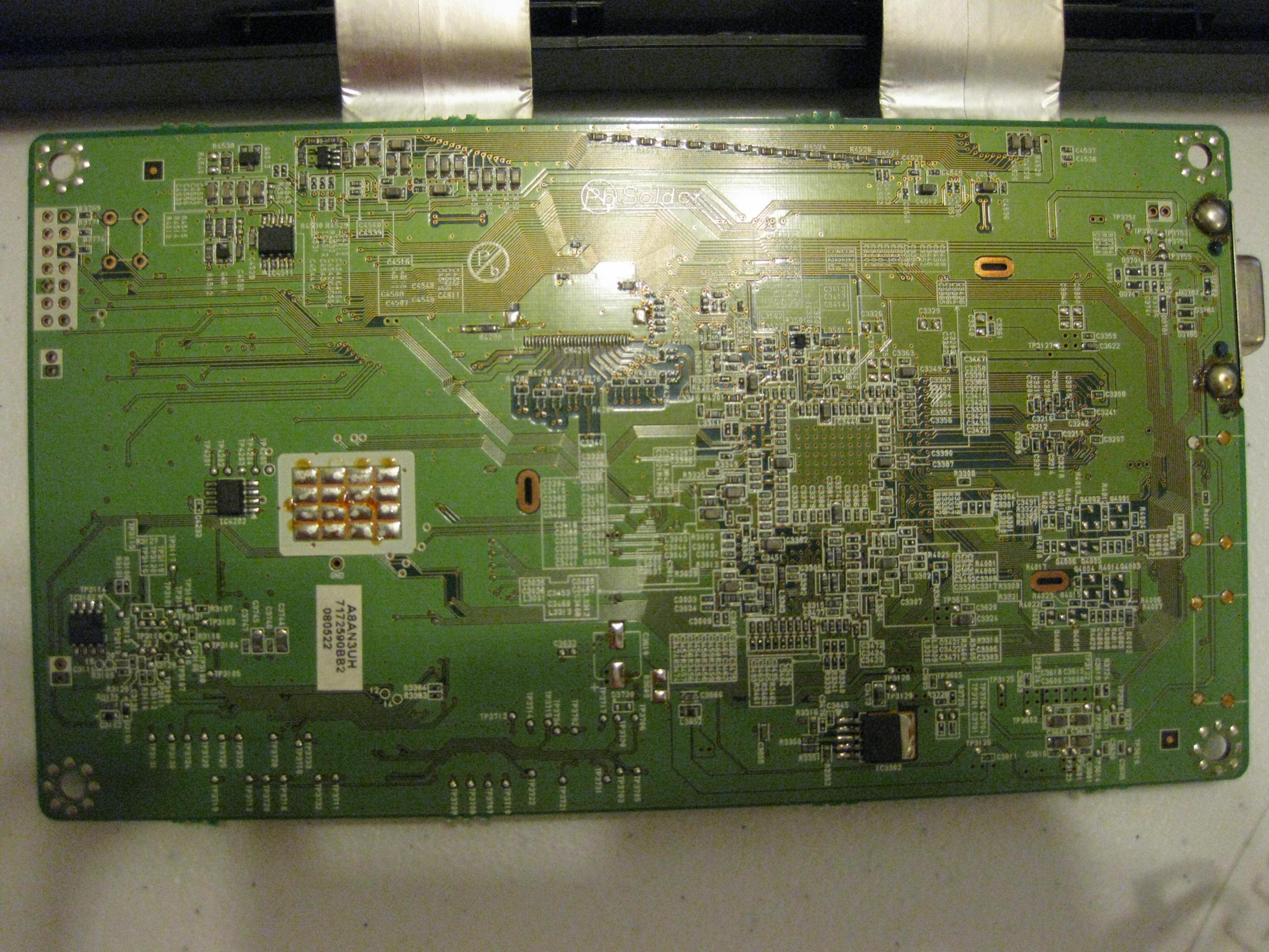

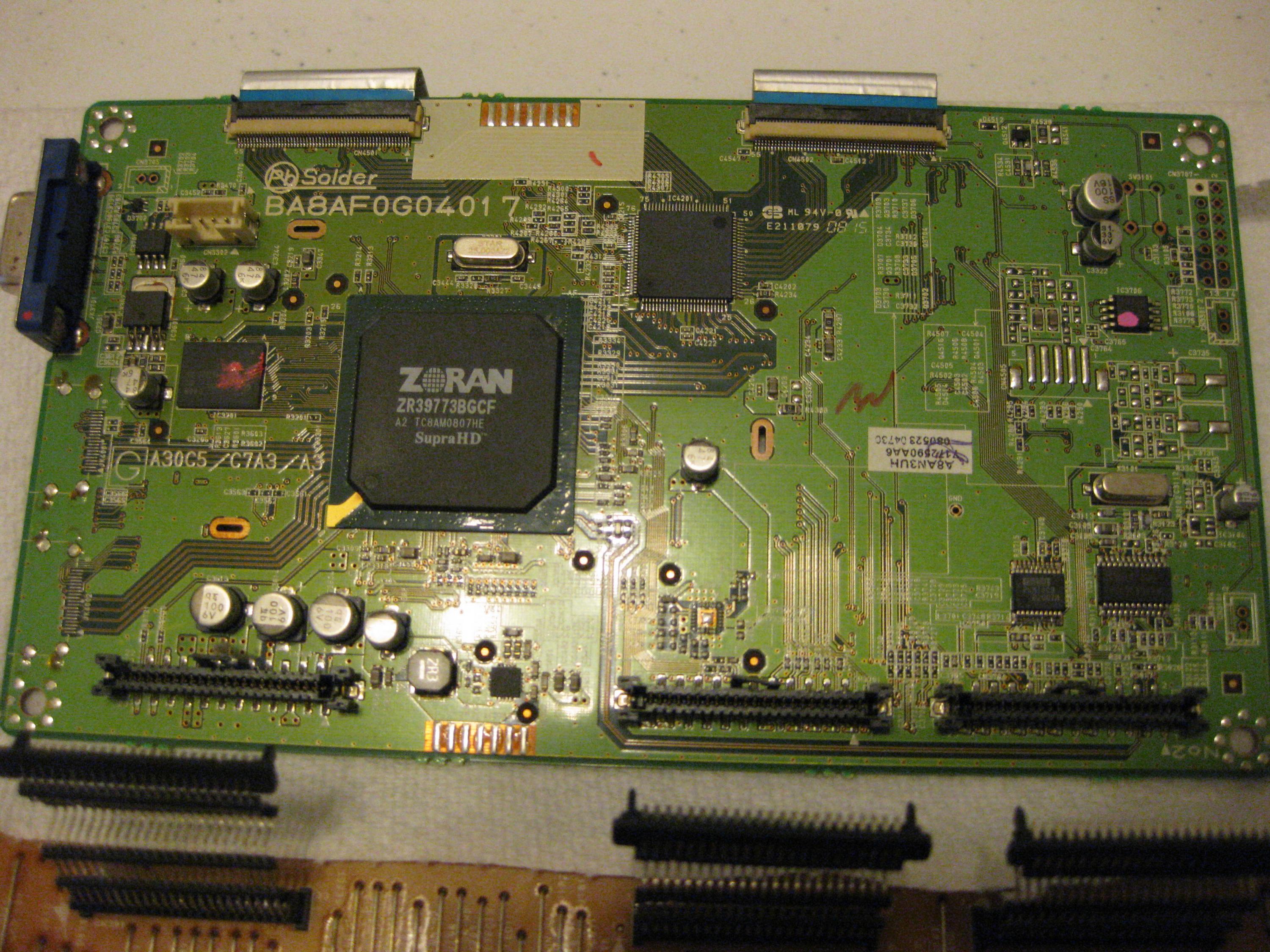

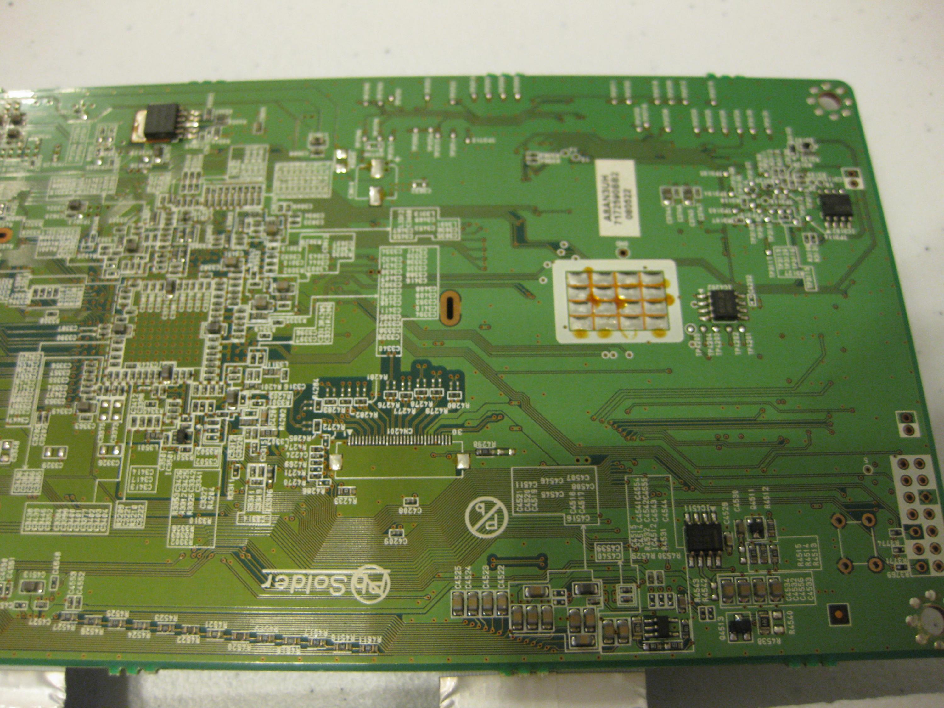

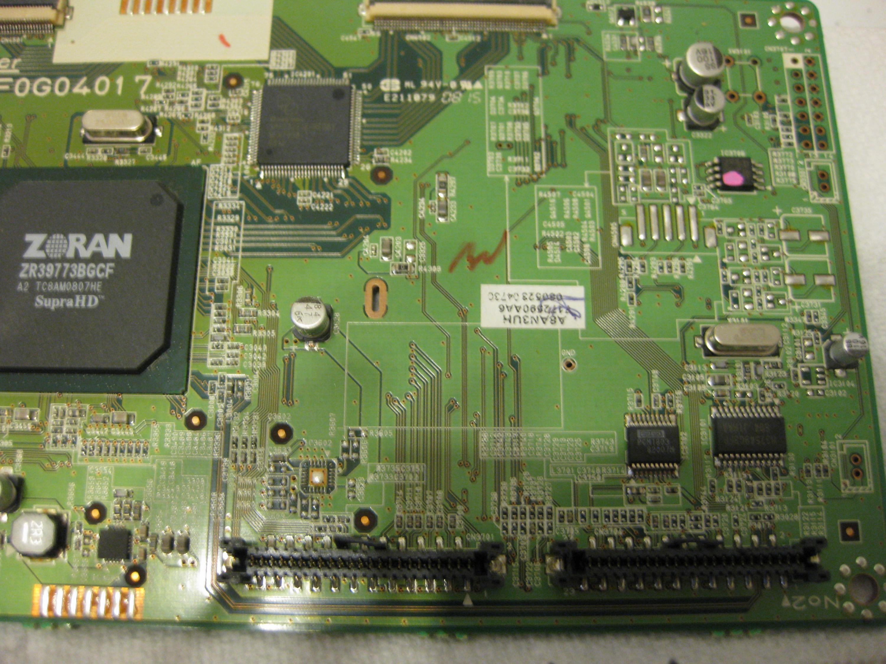

    We will probably need a good in focus picture of the Tcon - The Green Board under the
    metal casing -top of picture two.
    Do you have a multimeter and soldering equipment.

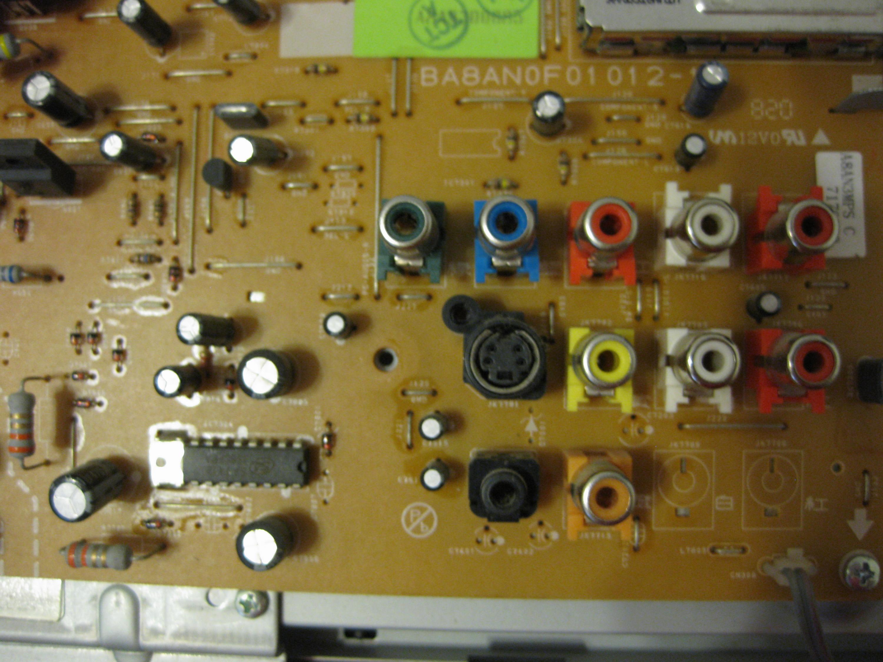

      See if these pictures help.
      I have a meter and limited soldering equipment/skill.

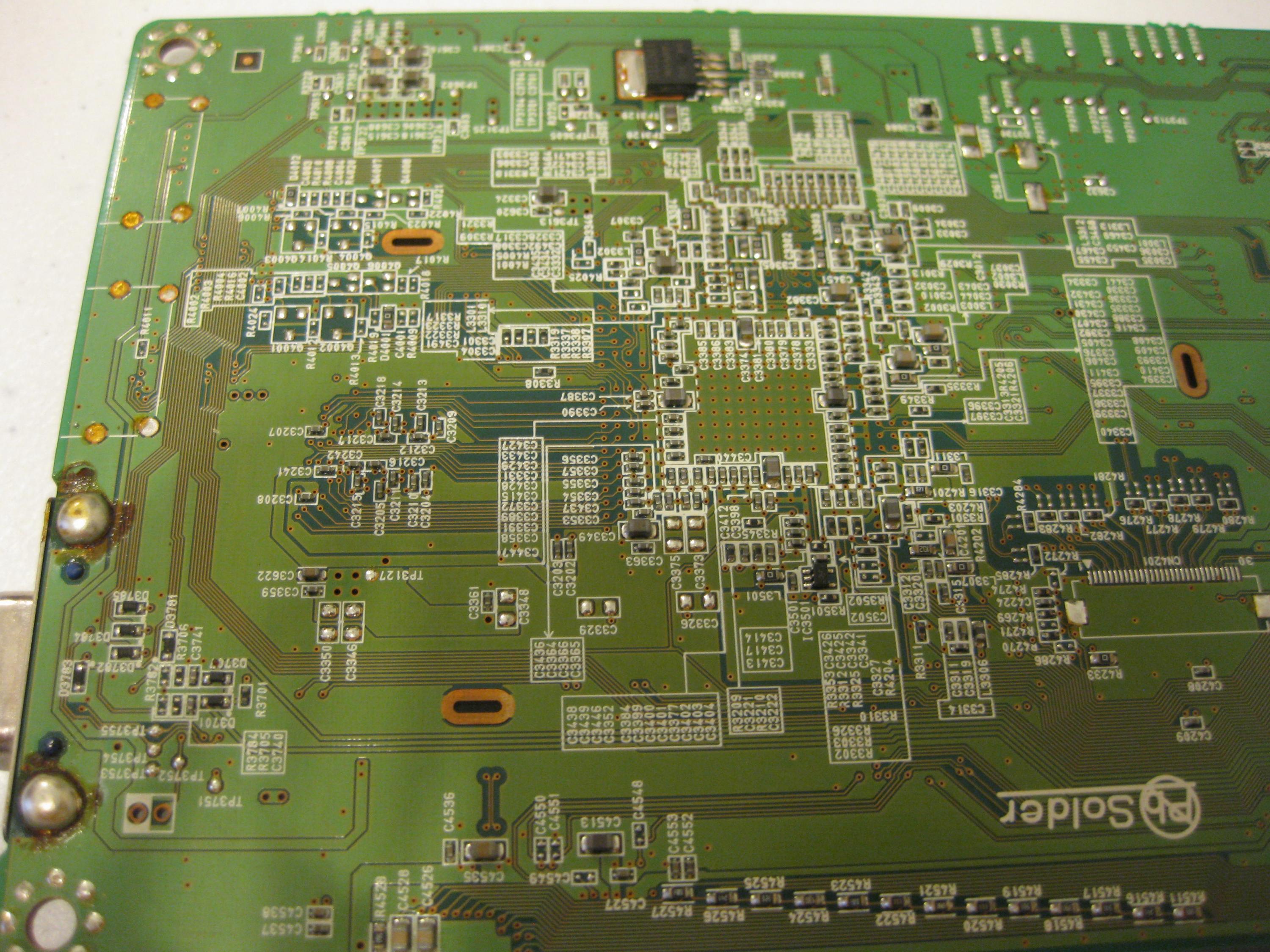

            Re: Emerson LC195EM9 Sound, but no picture
            Pictures are a little blurry ( I know you have apologised-But they need to be sharper)
            Anyway all I can spot so far is a now you see it now you dont episode on the back of the tcon near the blue( vga socket?)
            In one picture there is a blob of solder on the traces near the socket anchor pin but in another it has gone?
            It looks to me like the second trace is broken - can you clean the flux off the area and
            check with a magnifying glass or camera on macro.
