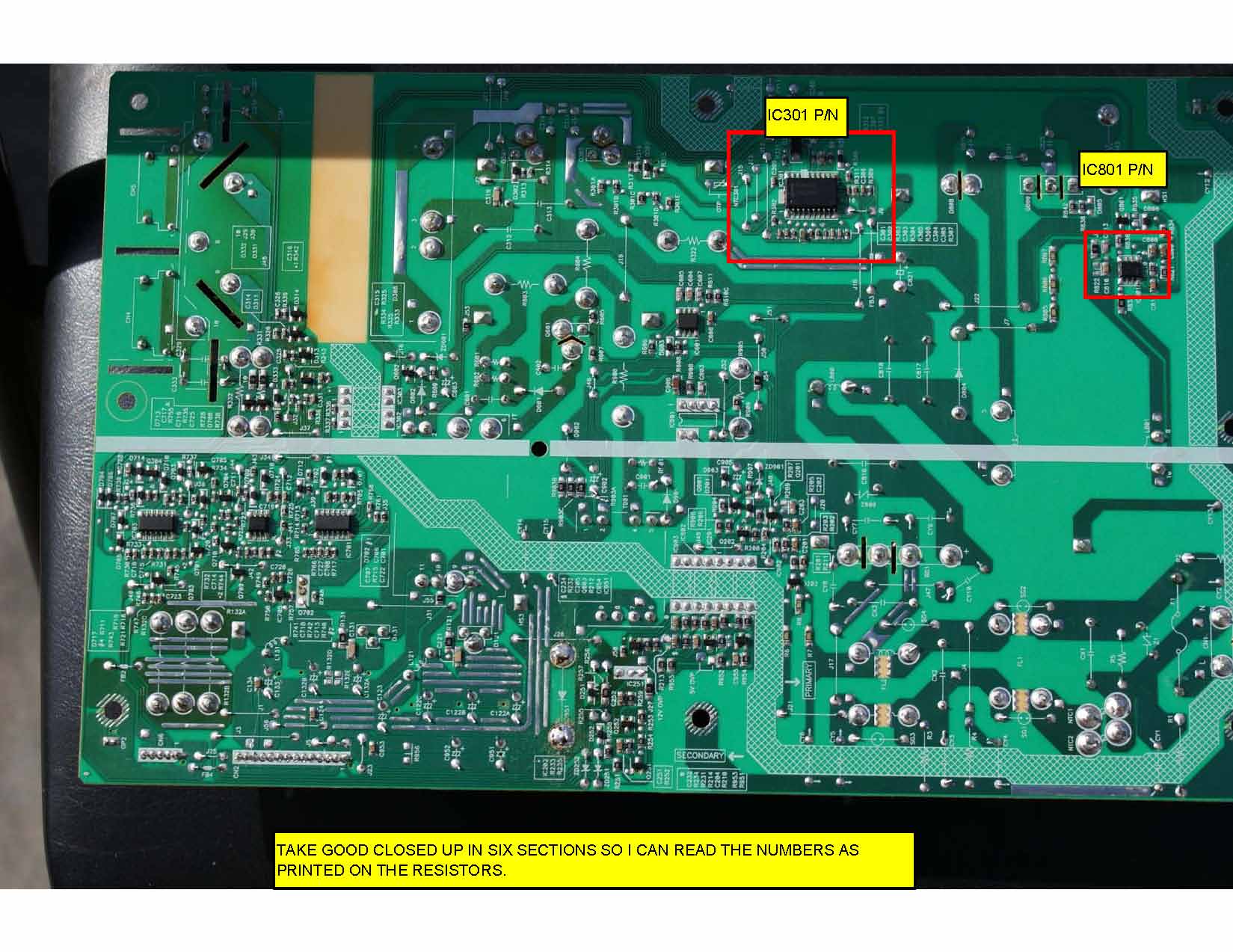

    Off topic a bit - I have a question for Budm Or Tom66. On the bottom of the board (Pic post 70) Pan along the bottom edge t the midpoint hole then up slightly there are two points marked OVP 12v and OVP 5v - OVP means Over voltage protection? but are those actual components or what? Cant see anything to correspond on the top of the board.

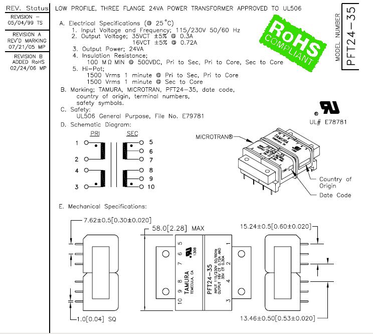

      I attach a datasheet for the transformer I am not sure what you can test on it
      Start with the primaries - Power off - meter on 2000 ohms check and post result. Budm or Tom may be able to suggest further tests ( How to check the secondaries)

                #147
                Re: sanyo no back ligth
                That datasheet for the transformer doesn't look like the correct part. It looks like a conventional 50/60 Hz transformer, not an SMPS one.

                  #148
                  GOOD CATCH Tom - I am now fairly sure you are correct (again )
                  I have checked and re googled under the part number PFT24-35 It is even available on Digikey cant think why anyone would save it on a pdf with the part number of this transformer MP-130B. I thought it was a bit easy to find and it did look the same shape/pins etc and the 1500Vrms threw me .
                  The one on the board is probably proprietory and unobtainable.

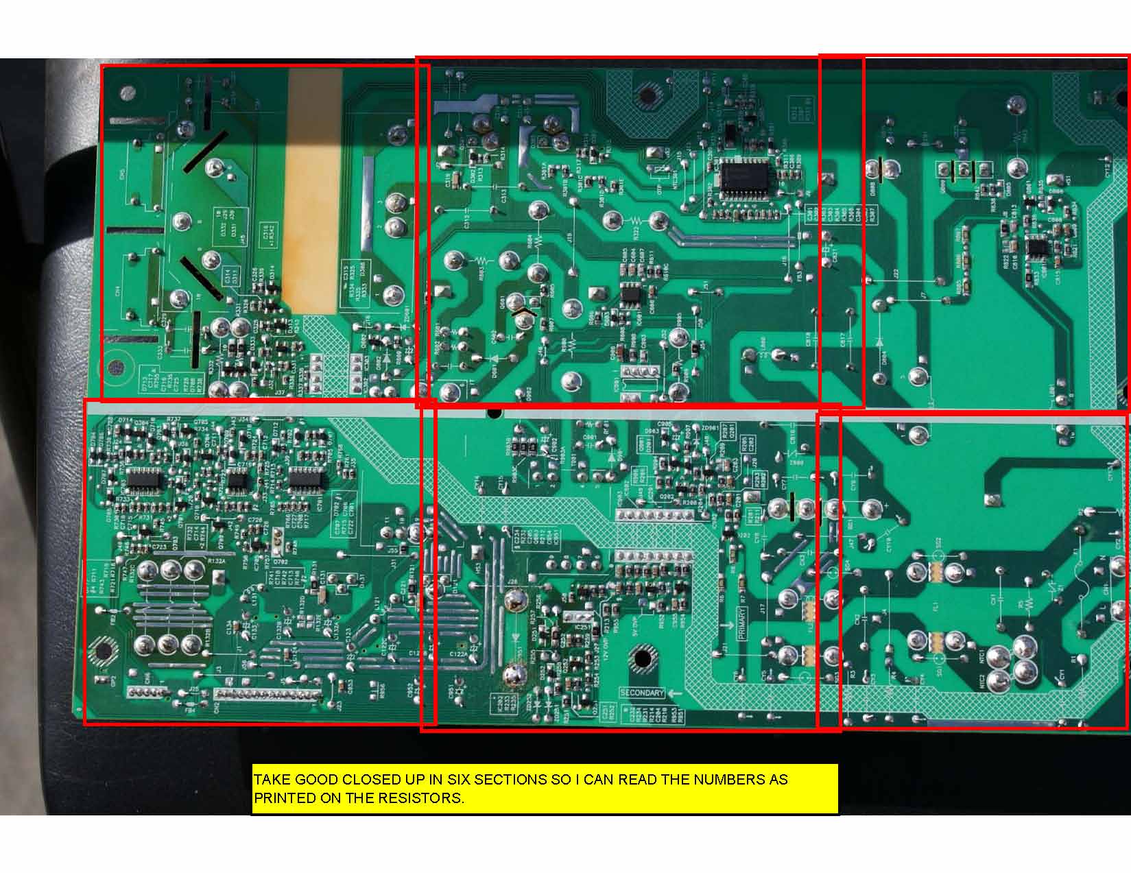

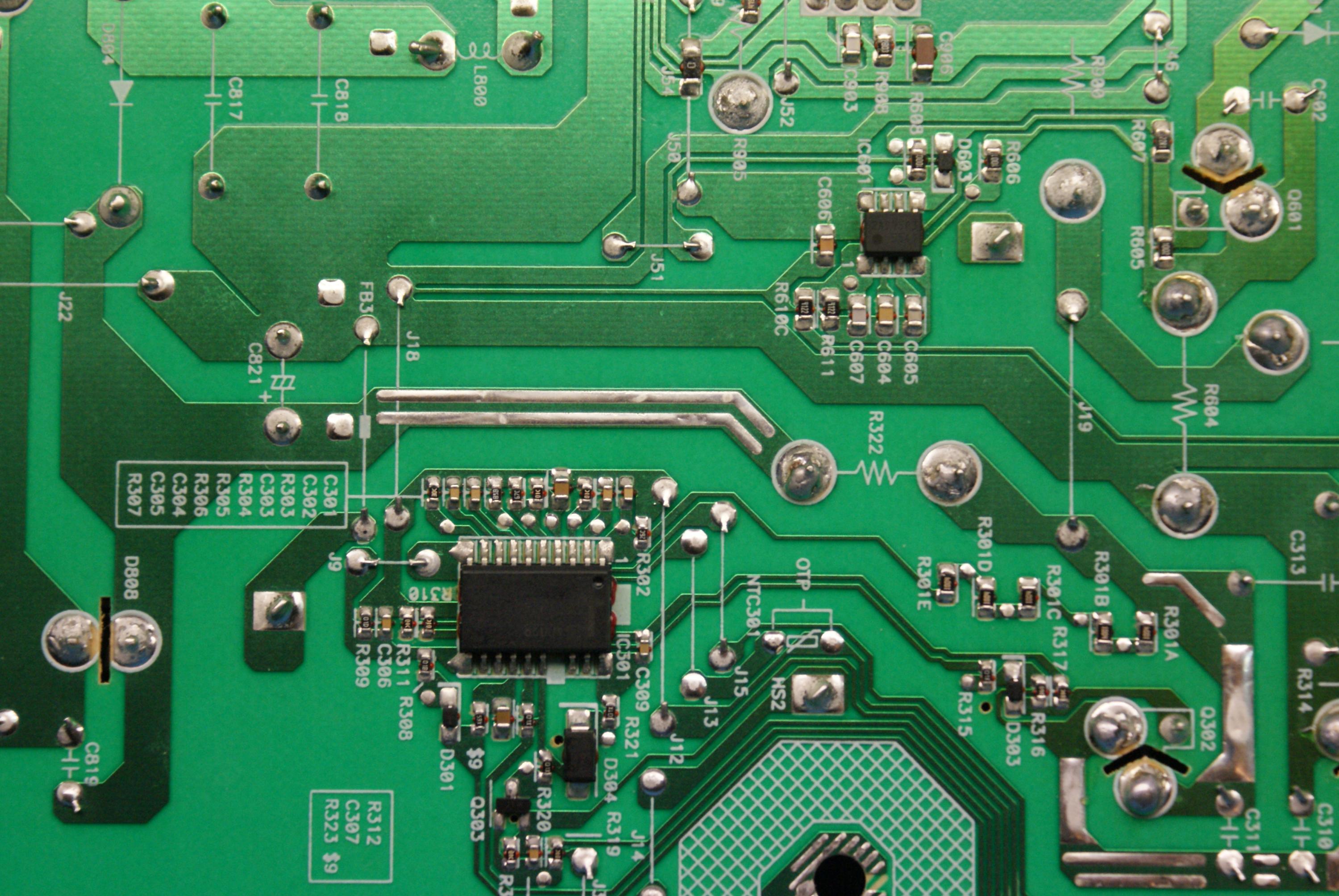

                          #152
                          can you give me the location pls.?
                            #153
                            Please take more pictures.
                              #154
                              see post 140

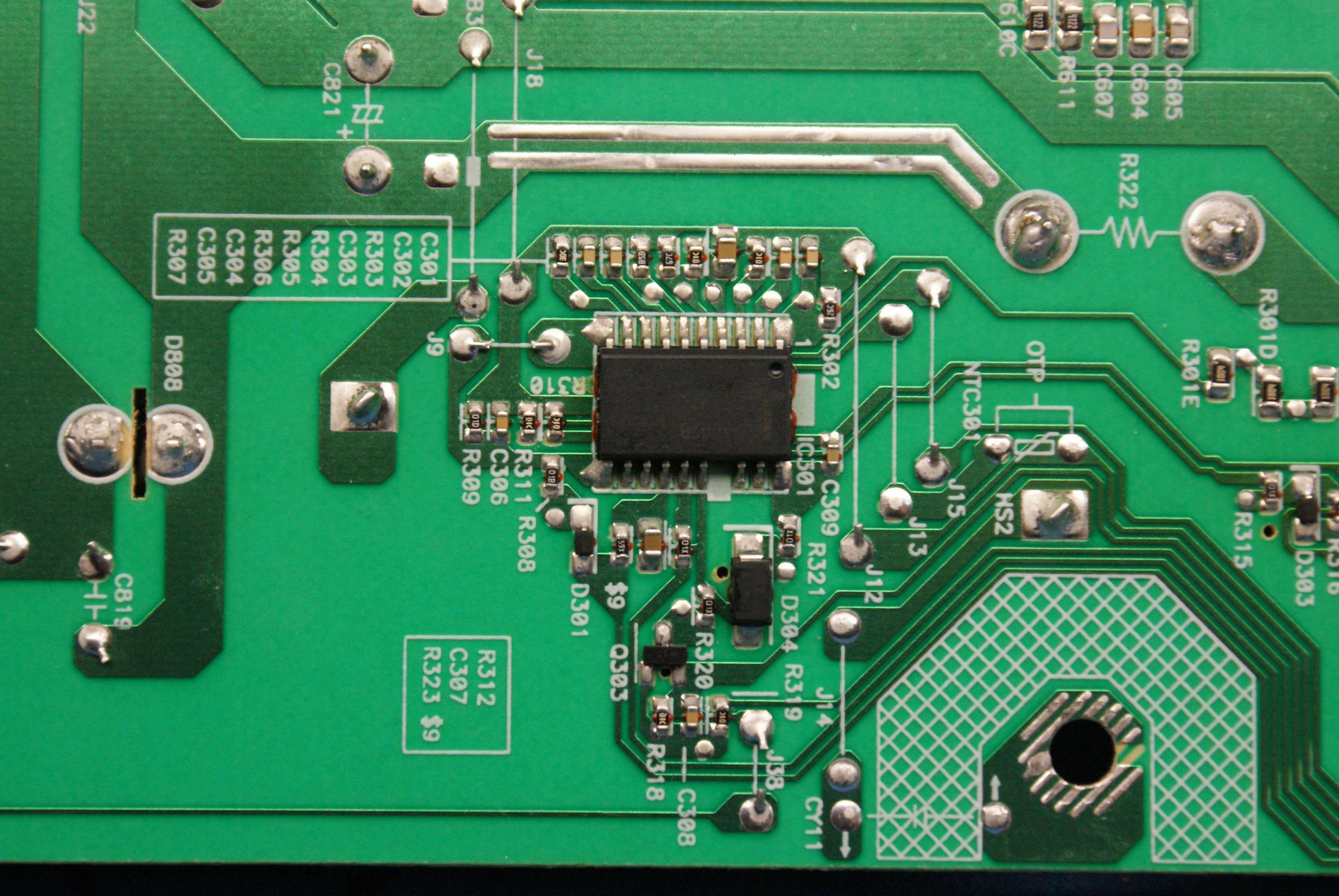

                                R322 was tested at 3 ohms. Given the lead resistance from a typical DMM, that seems like a good fusible resistor.

                                    #157
                                    I trace out the board, R322 is the main fusible resistor that feeds other fusible resistor for the 5V SMPS, and also the 12v SMPS circuits, so it must be OK.
                                      OK, what are the P/N for these two IC?
                                      Per diagram and look at the bottom of your board, check C312.
