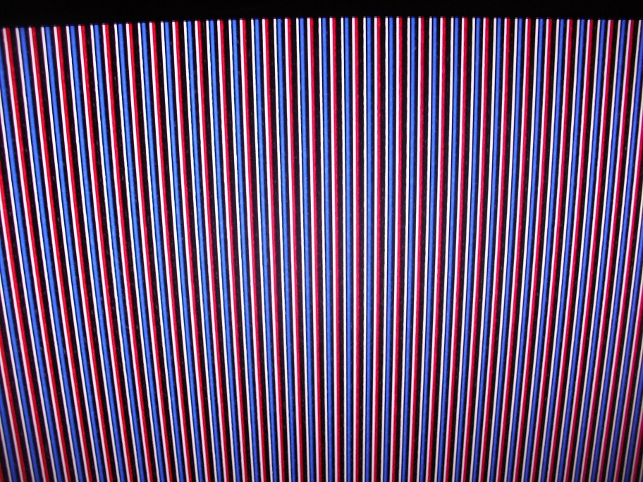

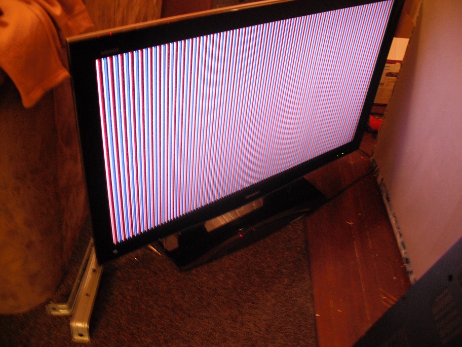

    have not cracked it yet! but heres pic of what it doin! seem to remember if lines like this it screen an not fixable!

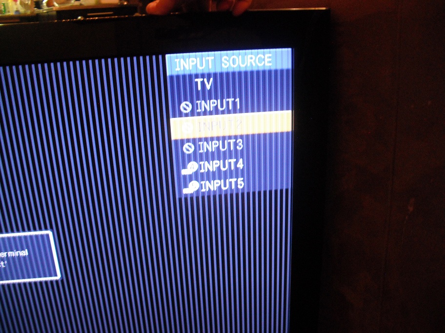

    It could also very well be a main board problem considering the lines seem to appear behind the OSD.

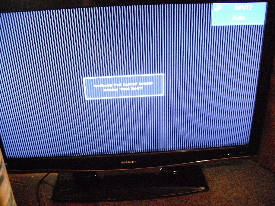

      Re: sharp lc-46d62u
      the main board has 2 red led on it one comes on an stays solid an the other just blinks, re seated all the wiring an turned on, lines where gone! except when in menu's or any osd! only lasted a minute before lines came back, but this time red an blue! an worse them before! will post pics soon!

        Re: sharp lc-46d62u
        when tv first fires up it looks good for about 2 seconds. then does the lines thingy! will have internal pics shortly!
