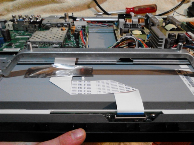

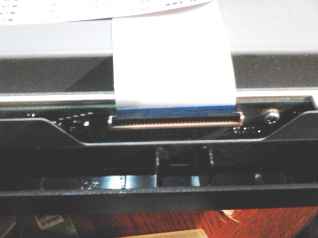

        The pictures look like mine, but interestingly enough not the same t-con board.
        I have attached a picture of mine, I am guessing it's that long narrow one along the top edge of the set, perpendicular to all the other boards? That's where the ribbon cable goes to.
        Not sure how to get it out but looking down the side of it I could see the letters FP1 next to a fuse, I tested it and it was fine.
        I turned on the set and read the voltages coming out of the ribbon cable where it attaches to the (presumed) T-con board. Is that where you meant for me to check?

            You have one those not to be repaired integrated T-CON/LCD panel assembly. The voltage feeding it is present so the circuits on that T-CON need to be troubleshoot, you will have to disassemble the LCD panel so you can get acces to the test points, voltage regulators, switching power supplies on that T-CON board. Not sure if it is worth it for 26" TV.
