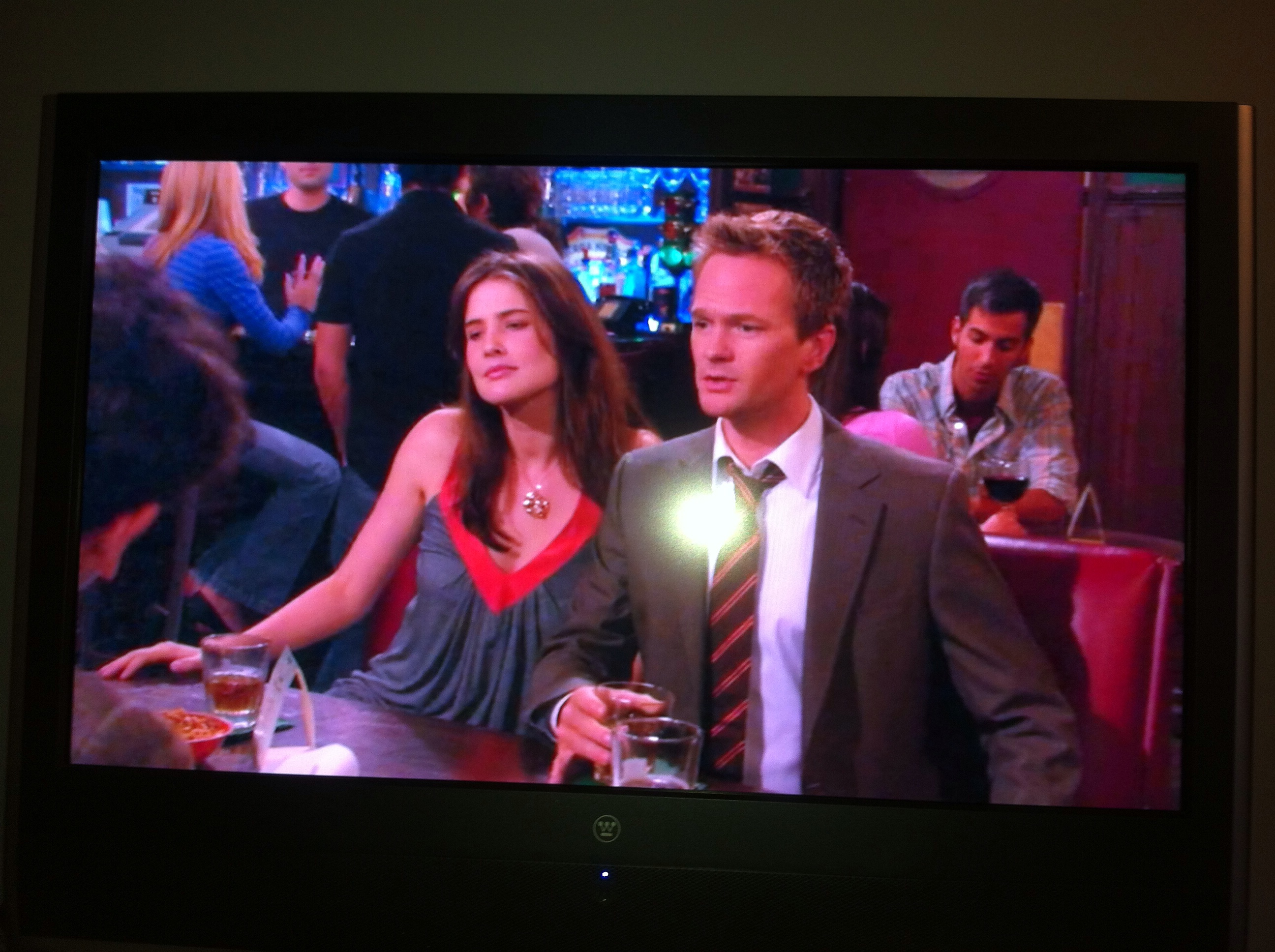

    Symptoms:
    • Sound works perfect
    • Problem occurs on Cable AND VGA inputs (haven't tested others)
    • Dark parts of picture are off-colored and splotchy
    • Menu OSD is bright and crisp (looks perfect)
    • Really dark scenes are barely visible
    • Brightness adjustment works, but colors just get washed out
    • Contrast adjustment has barely any effect
    • Backlight adjustment does not have much of an effect (currently at 100)
    • The problem started as no picture at all (but this has not happened in weeks)
    At this point I'm trying to figure out which board needs to be replaced - and am torn between the mainboard and T-CON. I may find out more when I take it apart, but trying to narrow things down early-on.

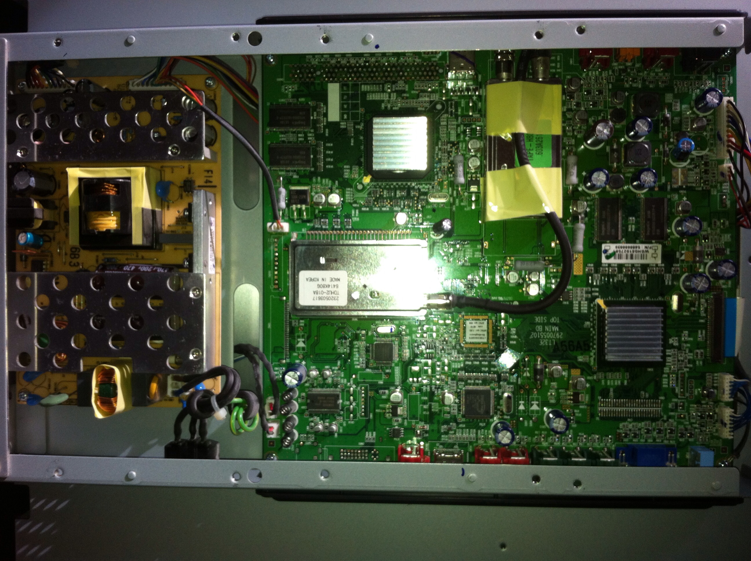

          Whelp, took it apart today, gave everything a look over, and cleaned all of the ribbon cable contacts per caphair's suggestion. There hasn't been any change in the picture, so I guess I'll be ordering a new main board!
          Thanks for the help!

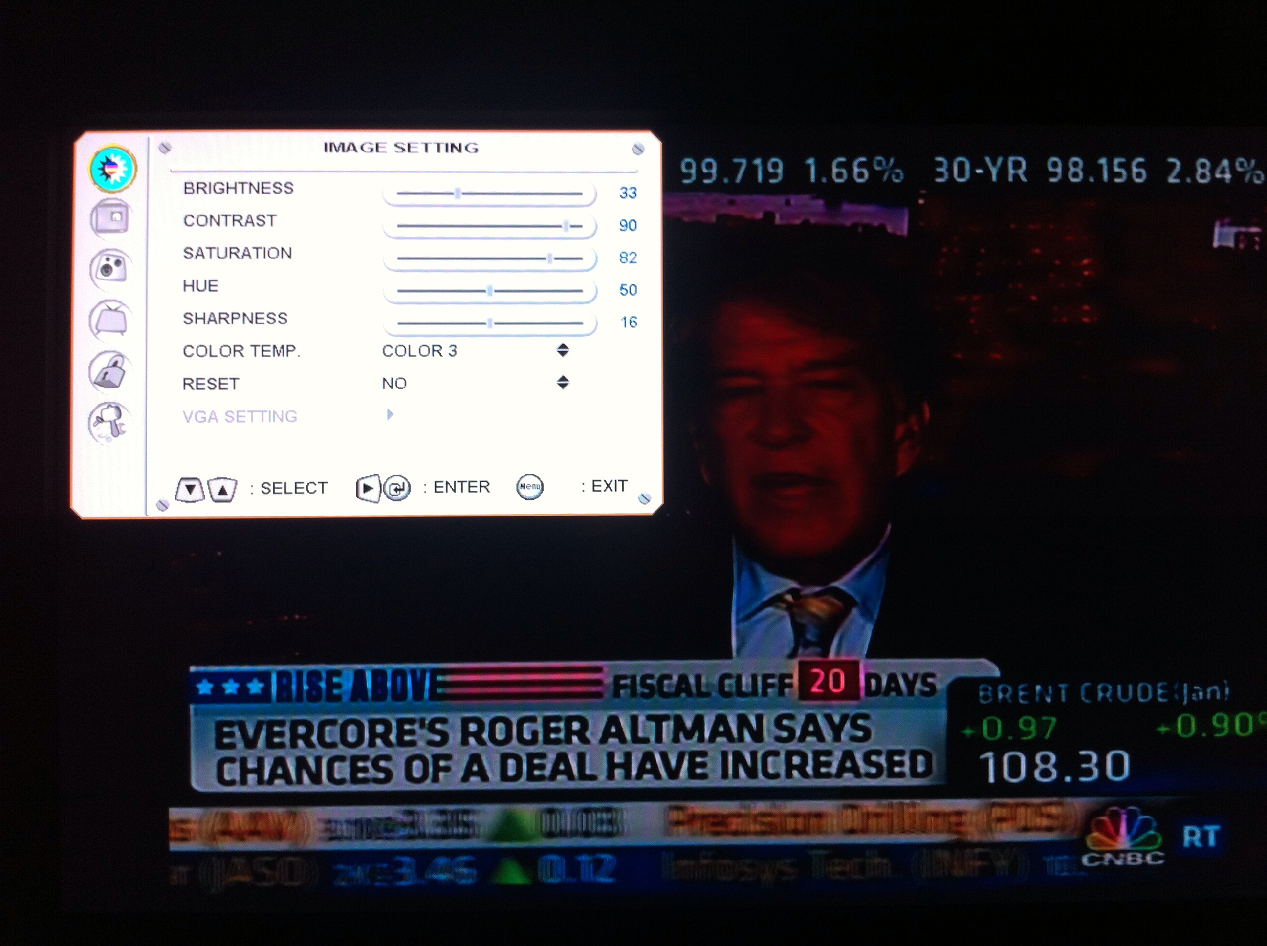

                        It's hard to tell if the menus are ok or not. The menu looks like it's bad in the same way that the picture is. The colors seem odd in the same way.
                          Re: Westinghouse LTV-32w6 splotchy/poor/dim picture (LCD TV)
                          The thing I'm looking at is the menu has full white capability, but the picture can only make a dim white, grey-ish colour. But I agree, it's hard to tell. One way we could be sure is if someone else (without the problem) has taken a picture of the OSD with a decent camera.
                          • Dgtech
                            E. Technician
                            • Apr 2009
                            • 1462
                            • Steeler
                            Yeah, its even hard to tell the differences in comparison to the picture of the OSD in the user manual found on page 15 here:
                            It's grey but is that the real color? It's close. The blues are close but kinda not... too close to call.
                              To make it even more confusing, there is also a transparency control -- this would obviously change OSD appearance. The menus shown are at 25%.

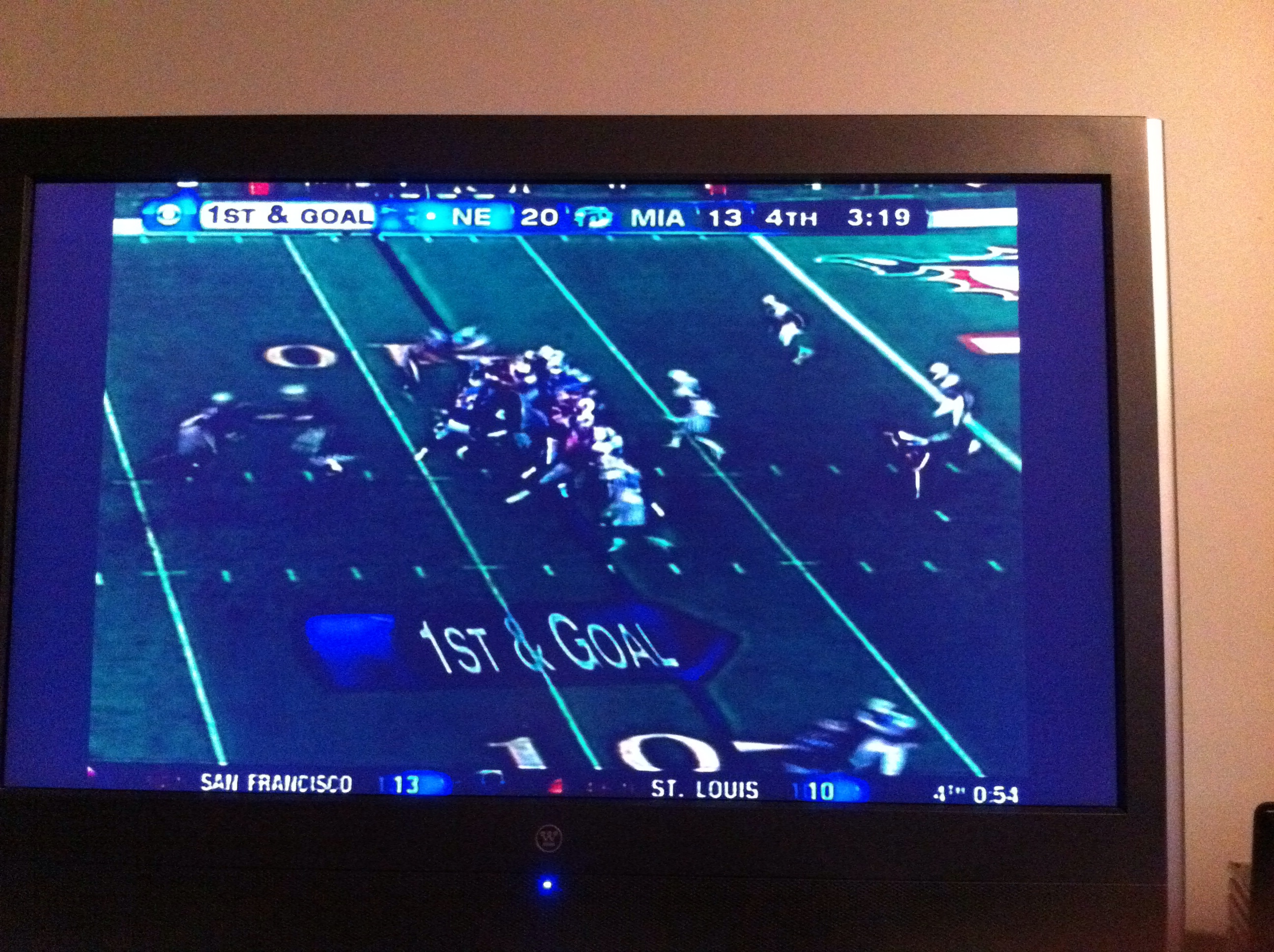

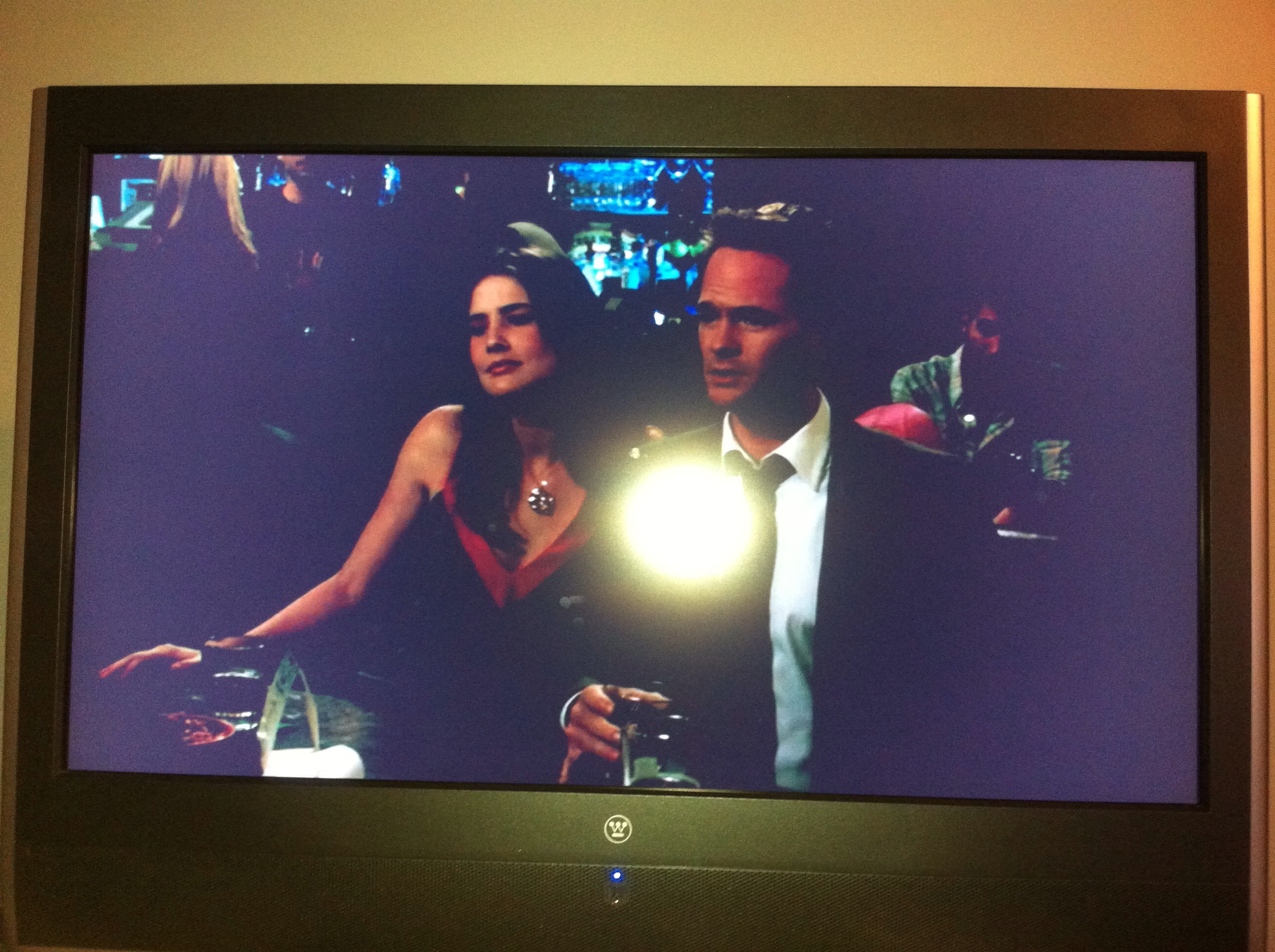

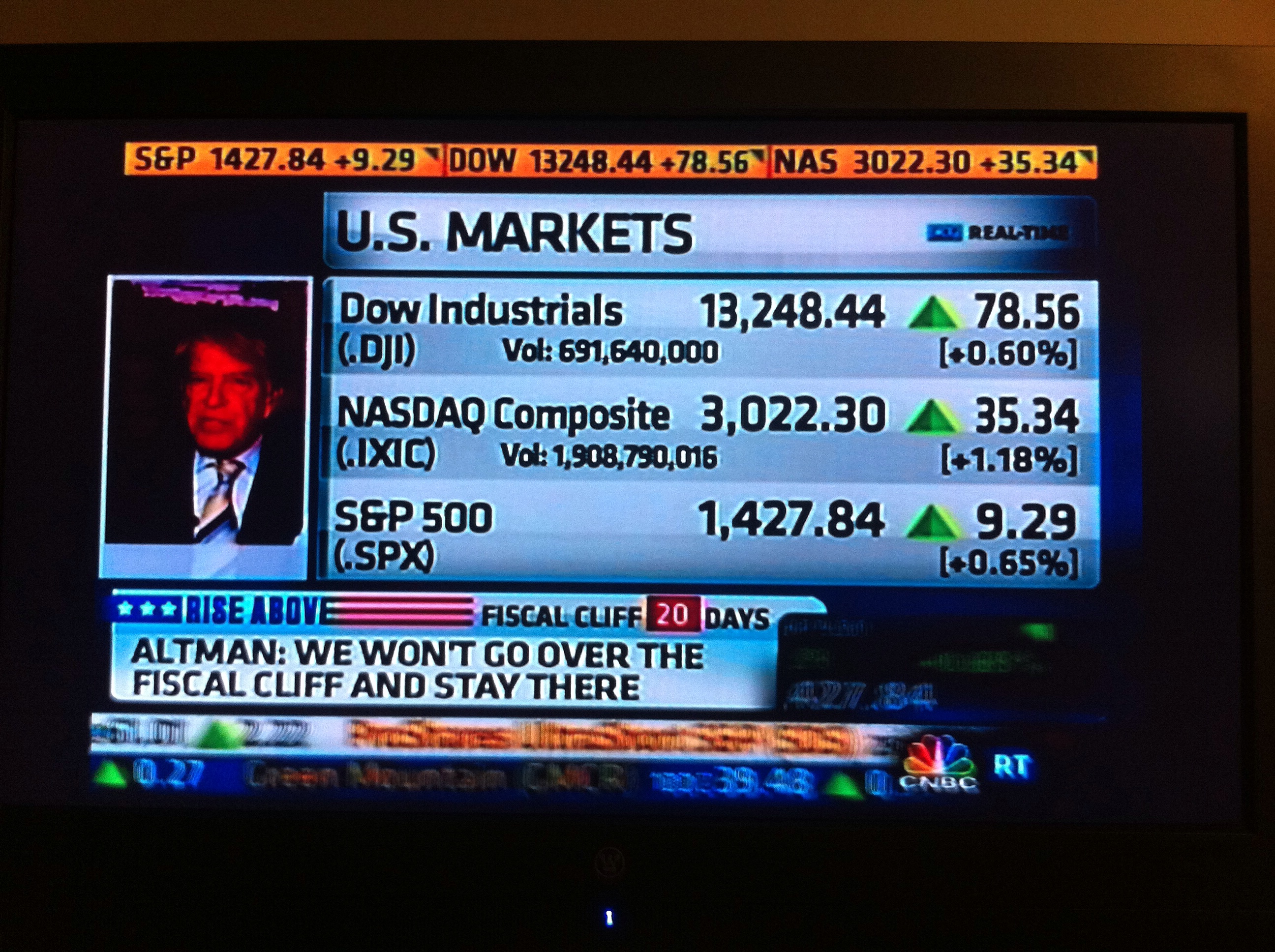

                                Good call on that one Tom. I've attached two pictures of the exact scene - source is my HTPC, first pic is VGA connection, second is HDMI connection (I usually only use VGA, since HDMI upscaling doesn't seem as crisp) - clearly the HDMI is what the "normal" picture should look like, and VGA is showing the "dark" symptoms.
                                So, at the very least, you've identified a solution for my HTPC, thanks!
                                As for what this means about what is malfunctioning, I have no idea - my guess is that the problem lives in whatever processes the analog signals (there's probably some sort of A -> D conversion going on here)...probably one of the chips soldered directly to the mainboard?
                                From what I can tell, the menus are as good as they have ever been, and look the same regardless of the input selected.
                                Overall, there is also some inconsistency in how "bad" the picture looks - by comparison, in these pictures, it's probably on the better end of what I've seen over the last couple weeks.
