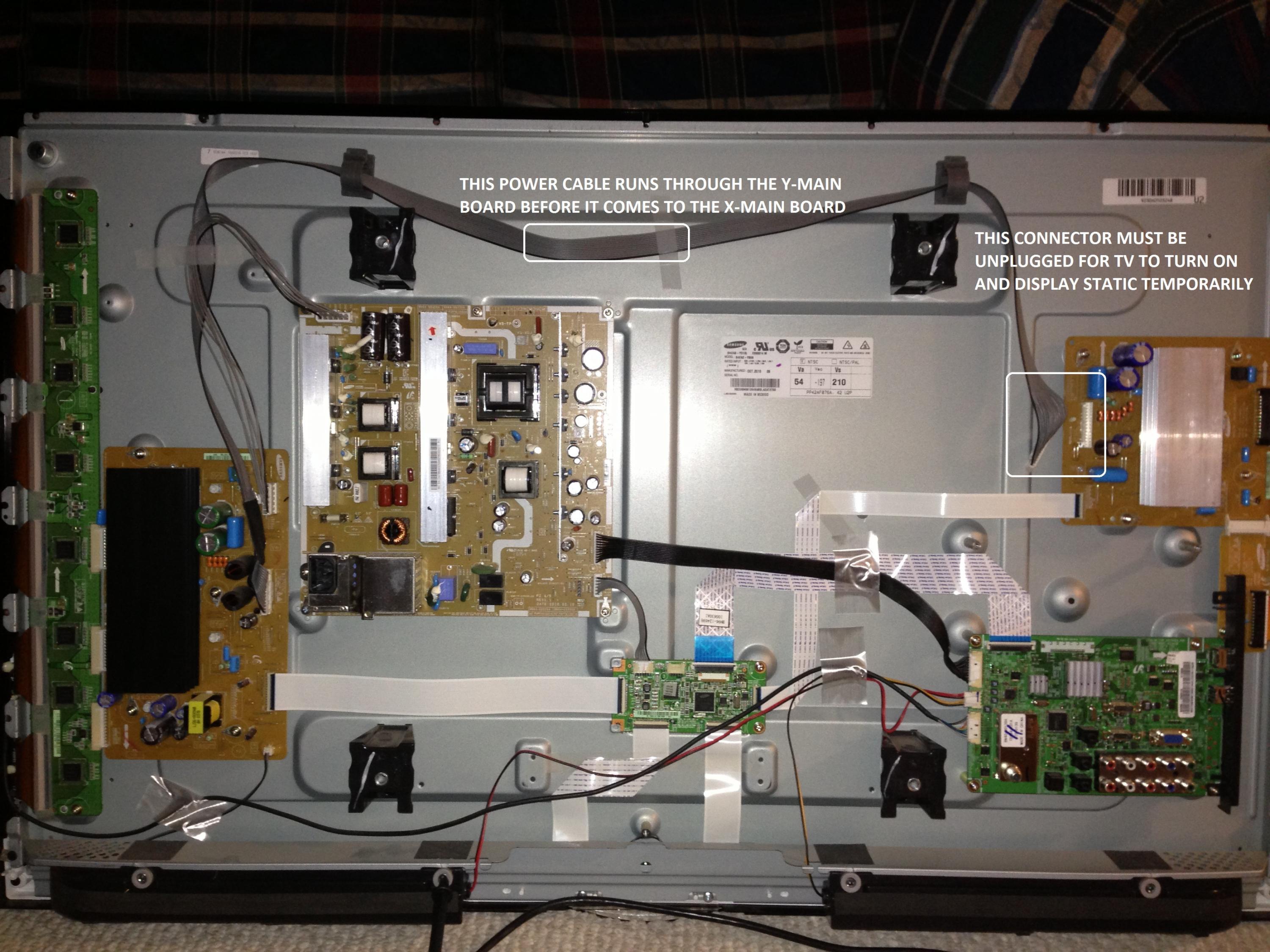

      -When all cables are plugged in EXCEPT for power to the X-Main-Drive, the TV powers on normally and even chimes and displays static for a second.
      -Va/Vs voltages begin at typical values, however when the display turns off, the voltages return *slowly* back to zero.

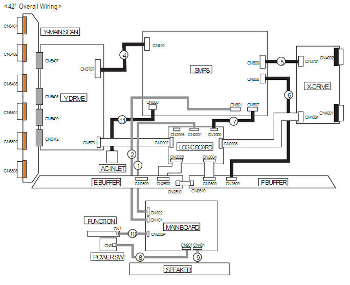

      I'd be inclined to conclude that my X-drive has failed. However, because the power is actually routed through the Y-drive, I can't be sure the Y-drive isn't to blame... Is there a way to know for sure? Also, why am I seeing incorrect Vs/Va voltages?
      In the first attached photo, you can see the connector I need to unplug in order to get the static to display. I hope I have my naming right but feel free to correct me :-)
      Last edited by MrBerga; 12-11-2012, 12:35 AM. Reason: [edit: also added schematic which I have been getting terminology from. I can see it's not exactly the same flow as my panel, however...]

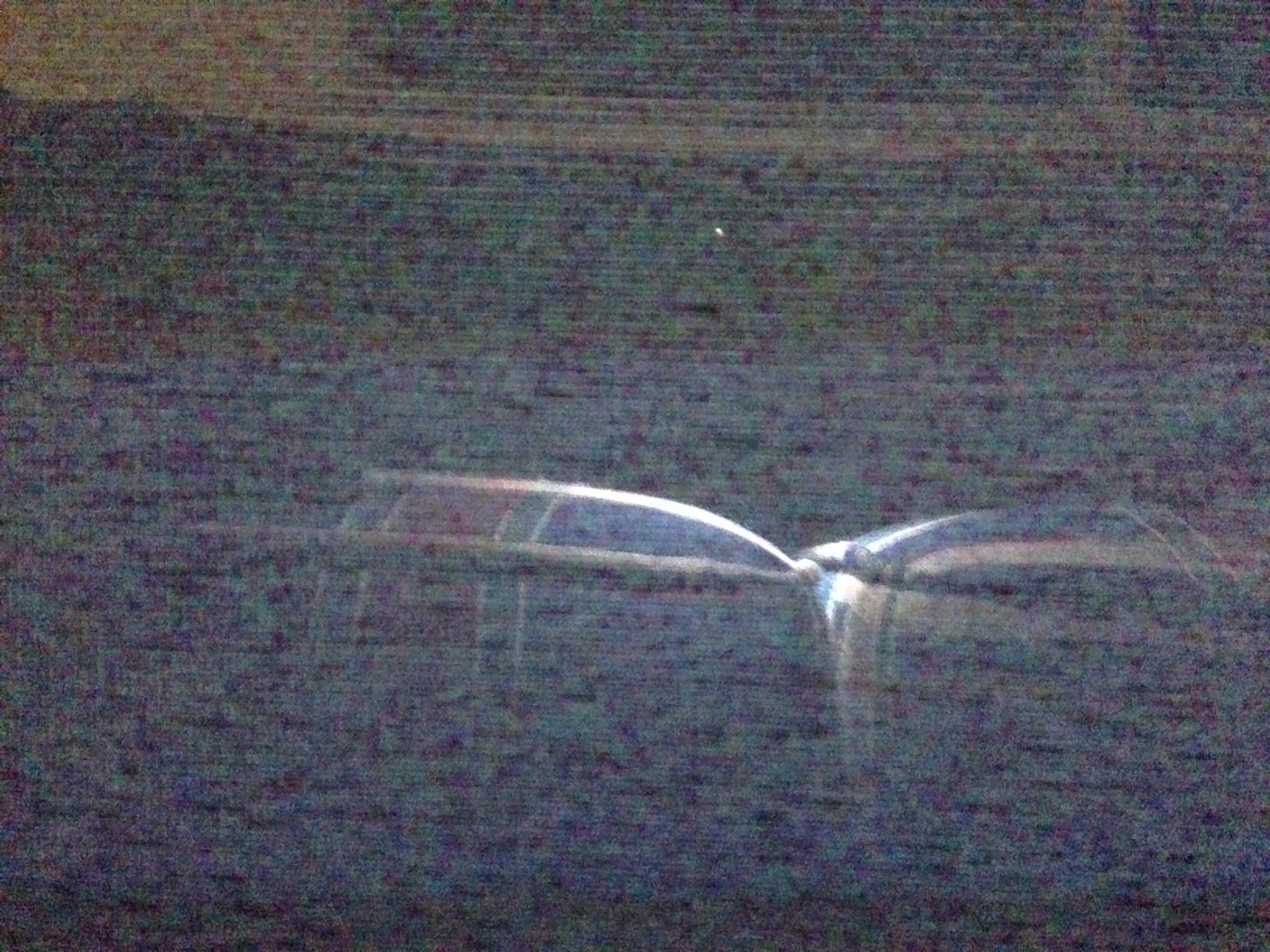

            I have a similar defect but not the same. My display turns on for about a second and shows static. I am unsure whether it's normal brightness.

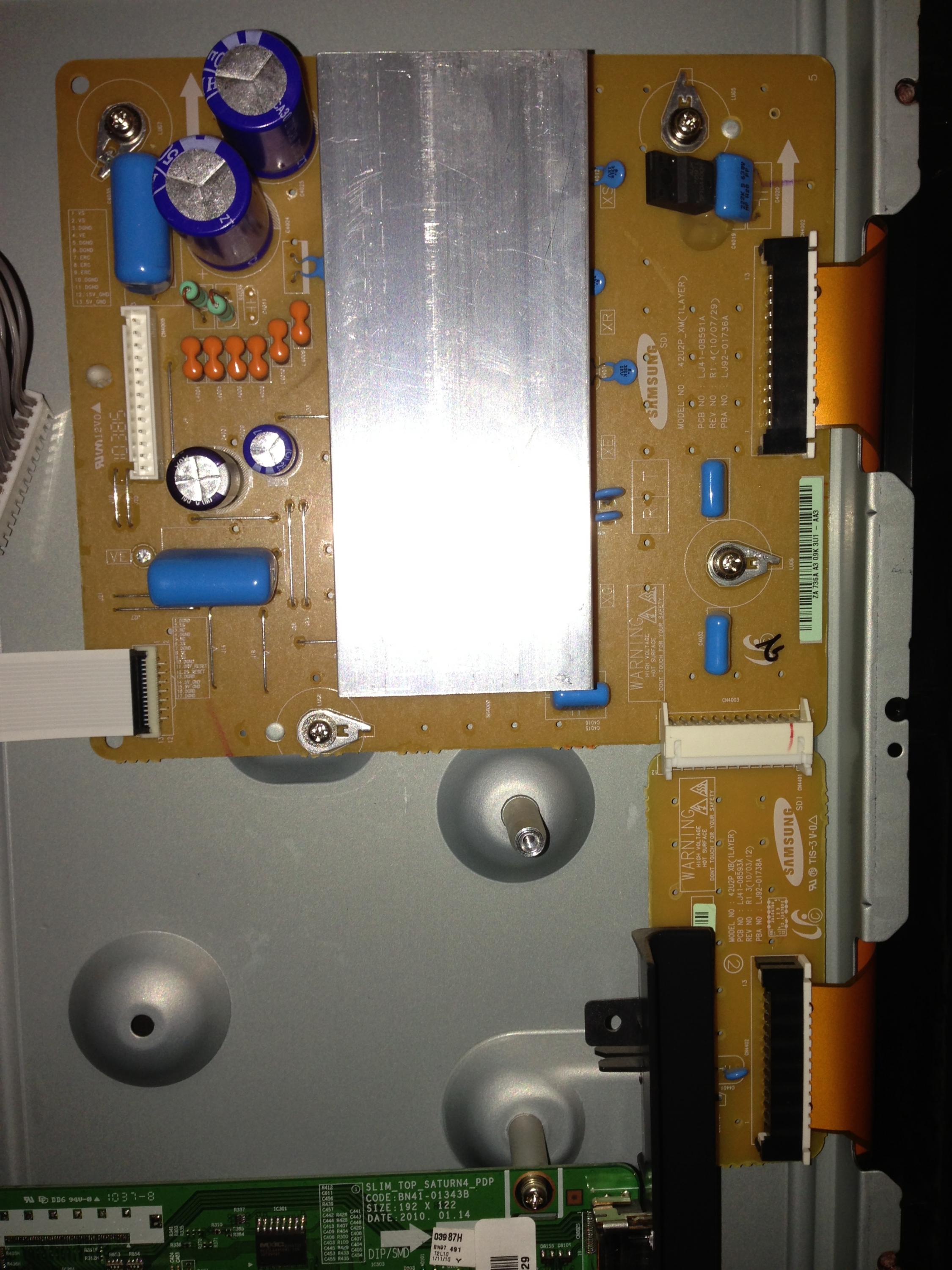

                Hey Tom66, what component(s) did you replace on that particular X-drive board? I'll pull that board out and look at it more closely.

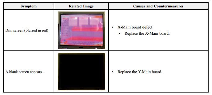

                Additionally: the troubleshooting manual below describes scenarios for certain failures...
                Red tint: X drive failure
                No picture: Y drive failure
                Is this reliable? I have a (staticy) picture but only momentarily. Uploaded a lousy shot of the static.
                Last edited by MrBerga; 12-11-2012, 10:01 PM. Reason: added troubleshooting diagram
