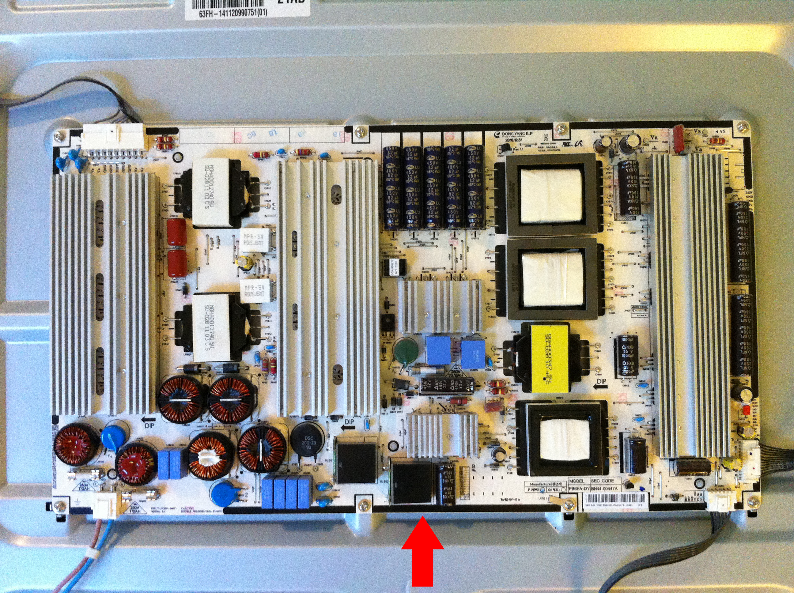

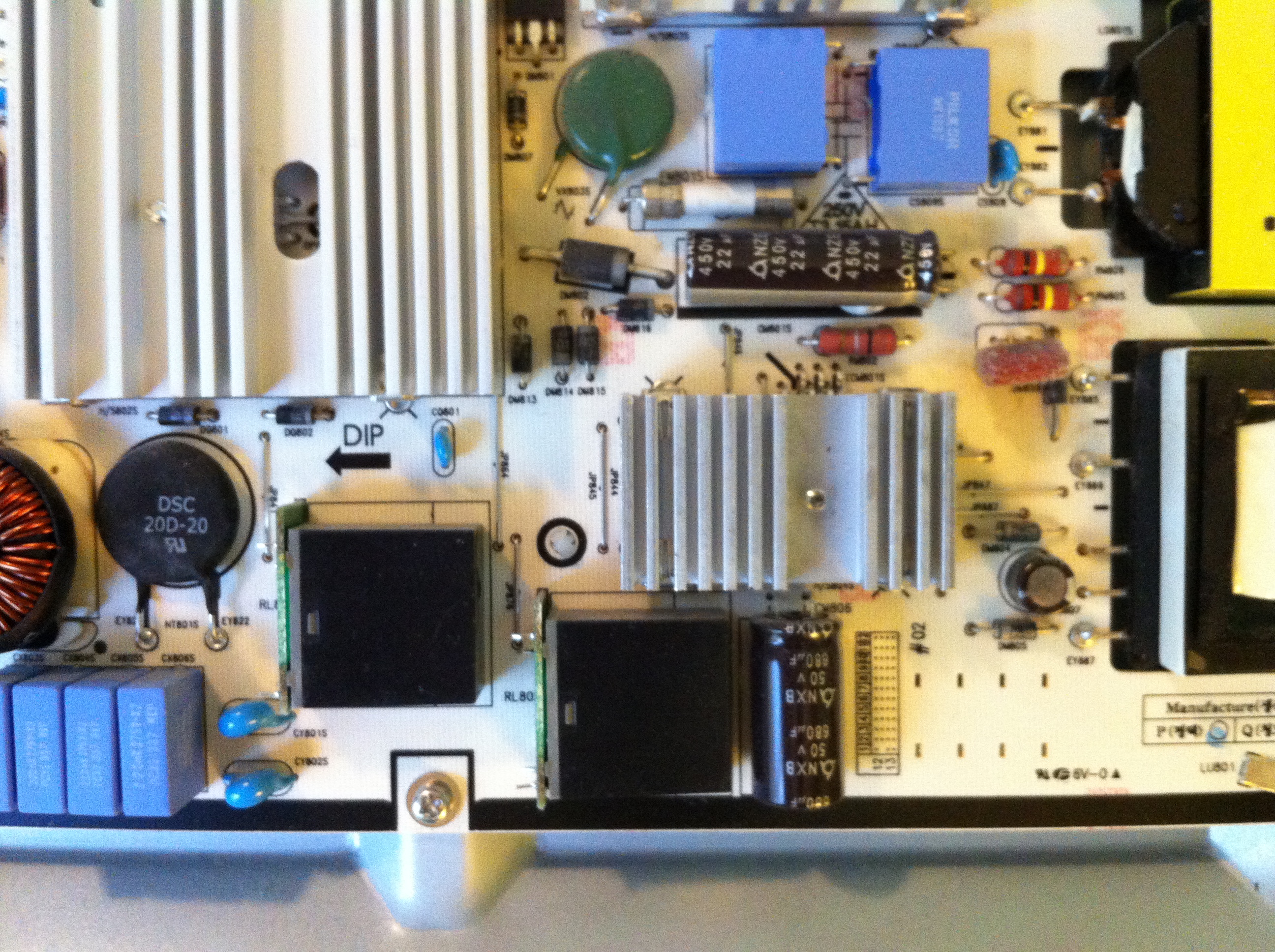

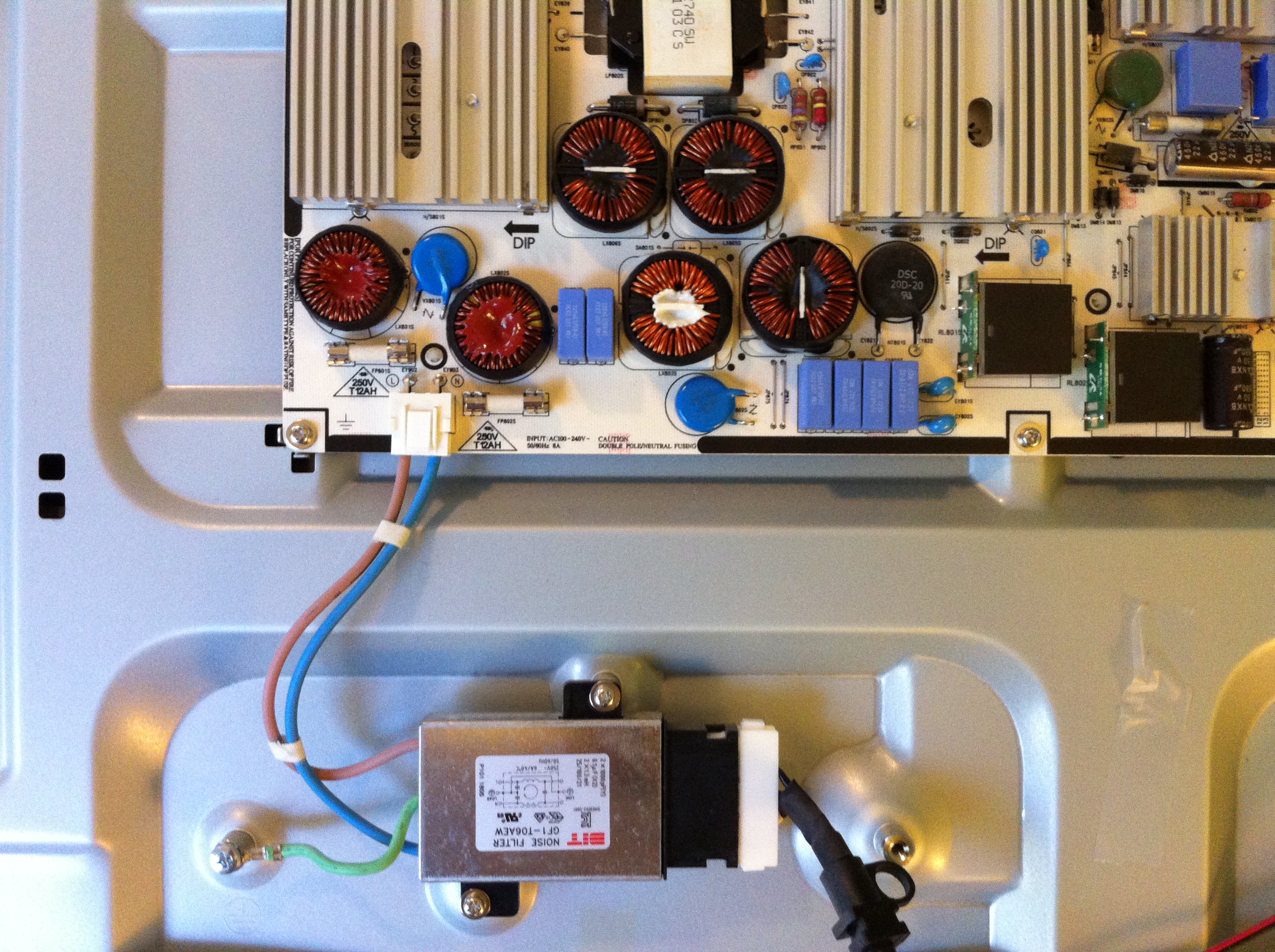

                    Okay, opened it up and took some photos.
                    These images are of the main board where the clicking sound is coming from.
                    The red arrow (in image 0500) is pointing to the approximate location where this sound is coming from.
                    Not sure if these help. Don't see anything obviously damaged/blown. Then again, I'm not a technician.

                      • Mt.Man
                        • Jun 2012
                        • 53
                        Re: Samsung PN64D7000 Keeps Power Cycling Never Stays On
                        Most likely the main board. Part number BN94-04689C
                          What makes you think Main Board instead of a Power Supply related problem?
                                    You say display comes up with 'Smart TV'. Most likely the the panel boards and power board is ok, usually when these are bad you do not get video on the screen before a shutdown.
                                    Bad main boards on Samsung's is a common problem.
