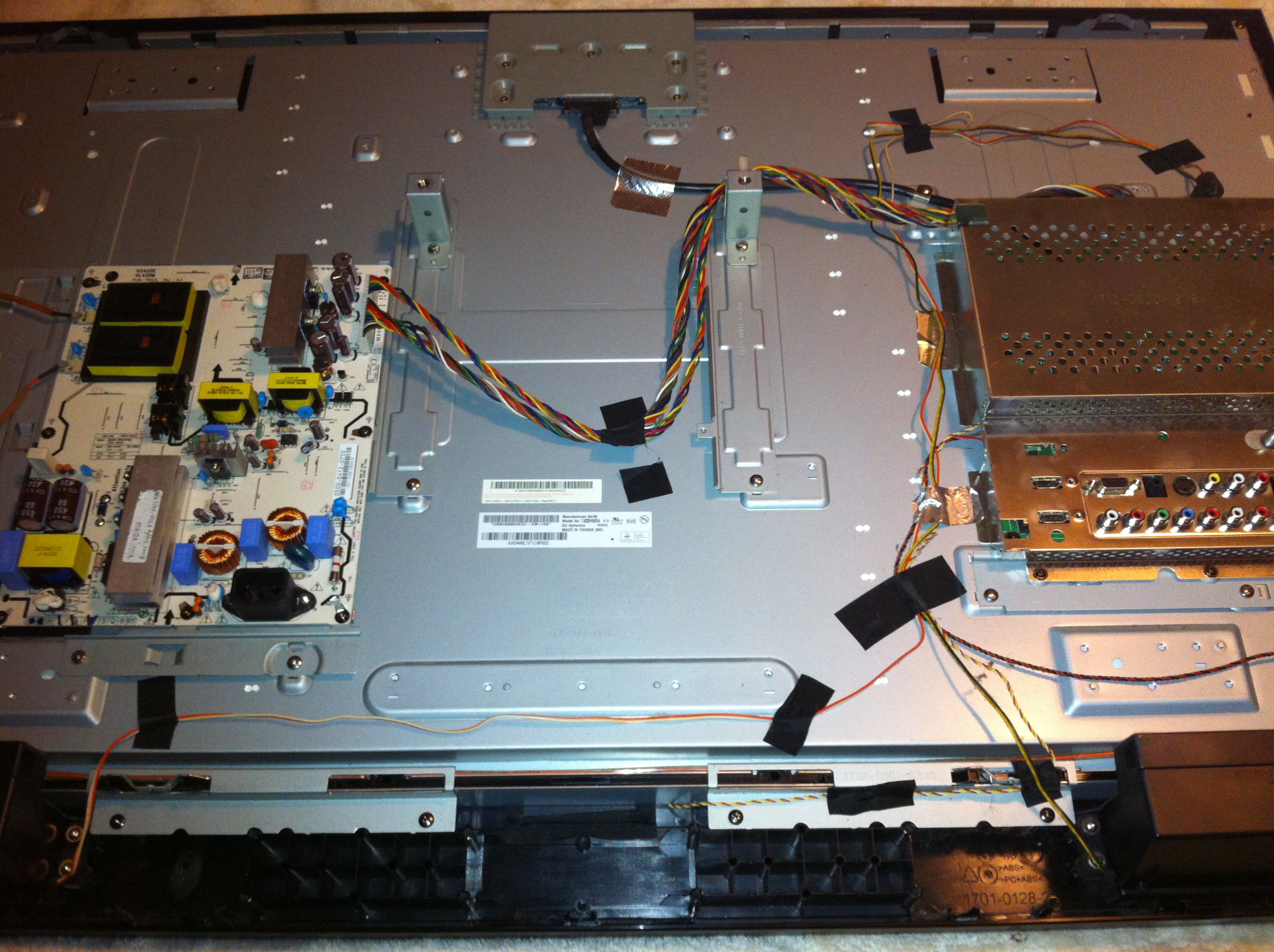

    While watching my Vizio VO420E last week, the screen went black on me. I still have Audio, and the Vizio logo goes from Amber to White when turned on, but the screen is pitch black. I was originally told it was the Power Supply over the phone by Vizio. I purchased a new Power Supply (Model # 0500-0412-0750) and put it in yesterday. When I turned the TV back on, I had a picture for about 5 seconds before the screen went black again, so I'm assuming the Power Supply was not the problem. I have done some research and a few people have told me it is the Backlight Inverter, but upon further inspection I've read that this Model does not have a Backlight Inverter, so I'm at a loss. I have a Dish Network Receiver & Playstation 3 hooked up via HDMI cables. Thanks in advance for any help, I'm clueless right now...

      Can you post some pictures of inside of your TV?
      It is possible you had bad CCFL (fluorescent) tube if this does not use discrete inverter and drives all the tubes from the power supply. Would be rare for a Vizio though.

        Sorry if the picture isn't great, had to use my phone. The board on the left is the one I replaced Friday to no avail.
          Re: Vizio VO420E Black Screen, HELP!
          You have power supply-inverter combo board, so, like TOM said, you may have lamps problem.

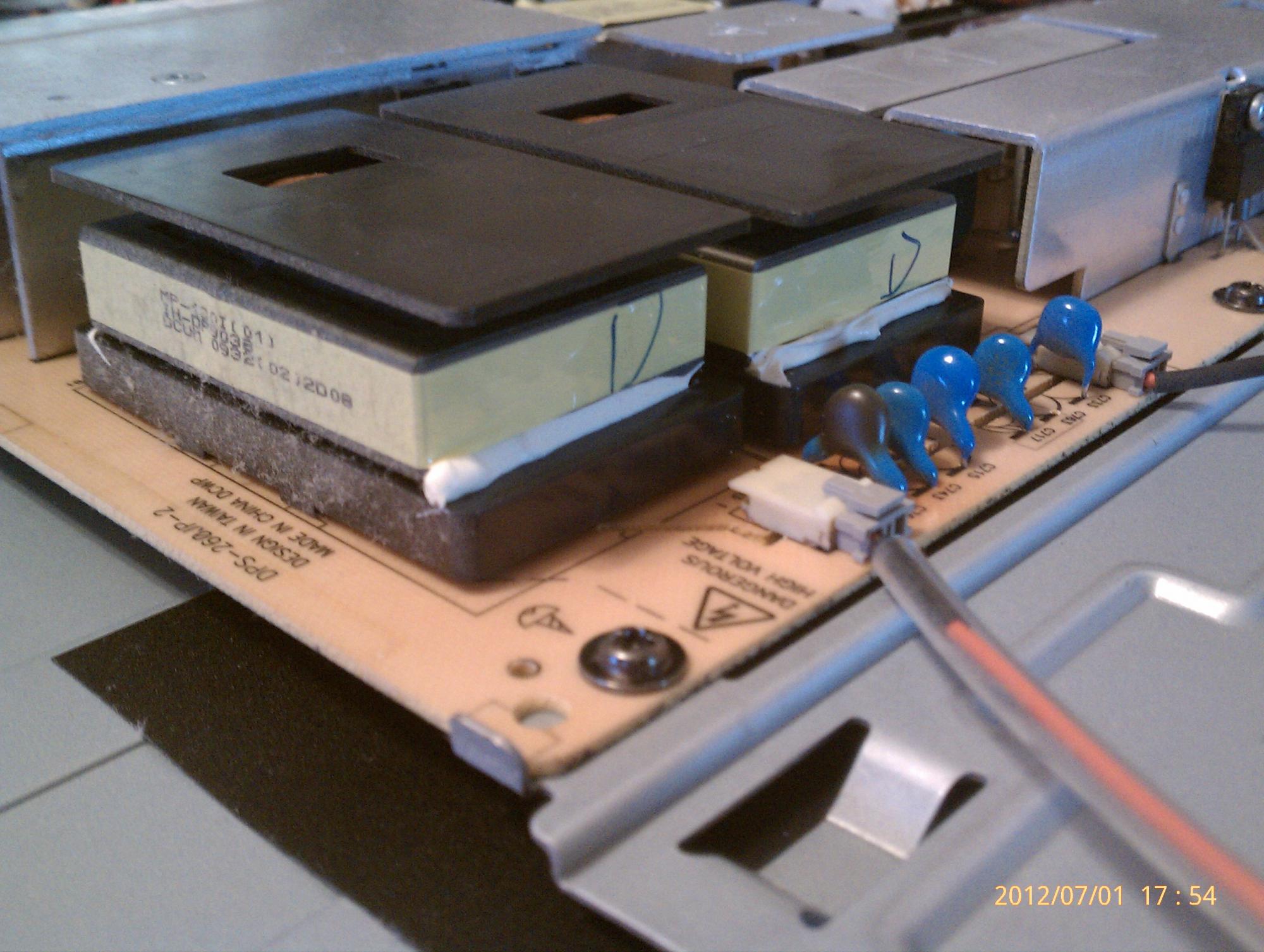

                I found this picture while searching on here earlier. This looks identical to my old Power Supply, it had burn marks in the same spot, so I replaced the Power Supply but the new one is doing the same thing, but it isn't burnt up. This is a picture I stole from another thread on here, but as I said, the Power Supply I removed from my TV Friday looks identical to this one, burn marks and all. This poster said he had the same problem as I am having, so he just replaced the caps for the CCFL and his worked perfectly, I replaced the entire board so why isn't mine working?
                  That bad ballast blue cap burnt up can make 2-second to black, bad lamp can also cause 2-second to black. You can have the same symptom caused by more than one type of component failure.
