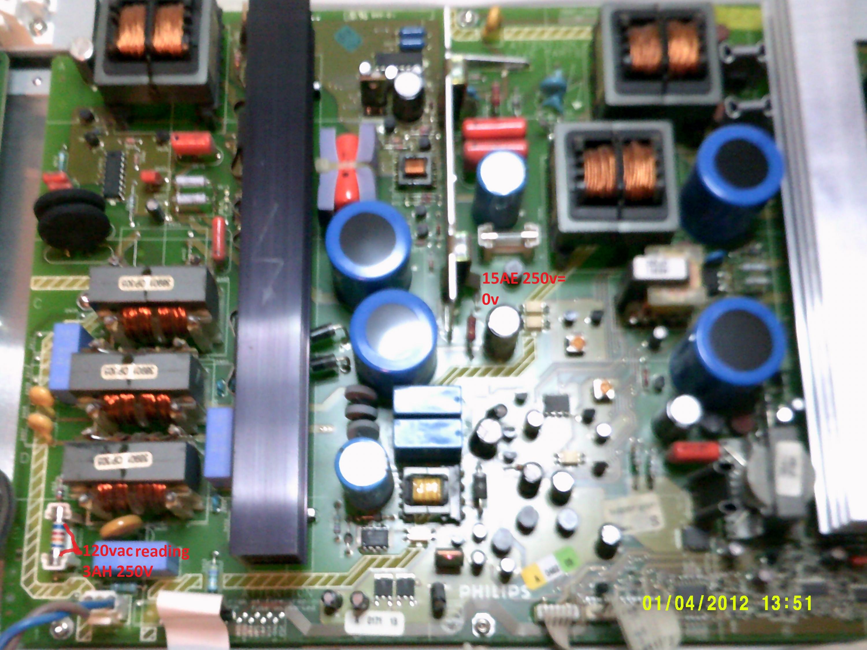

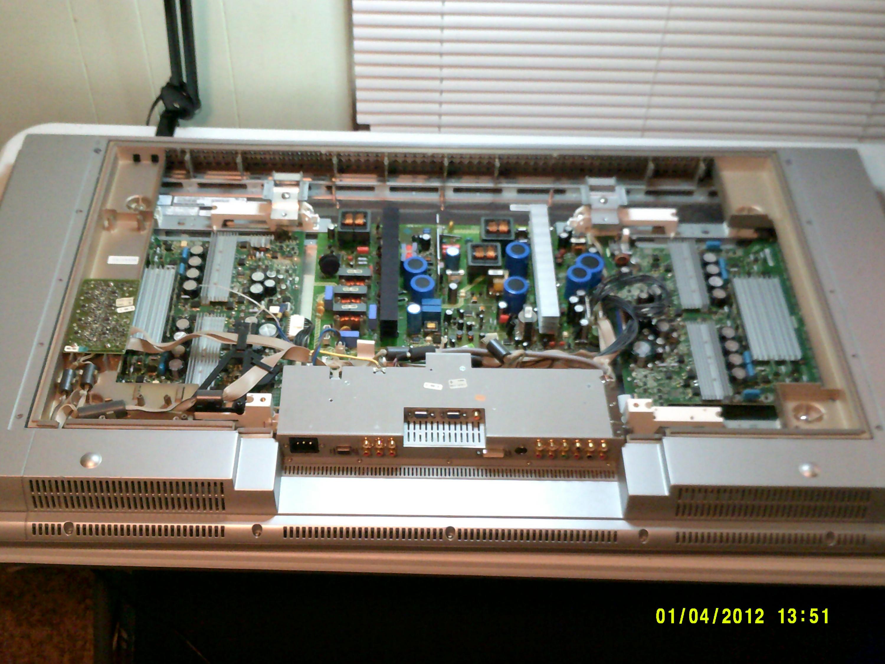

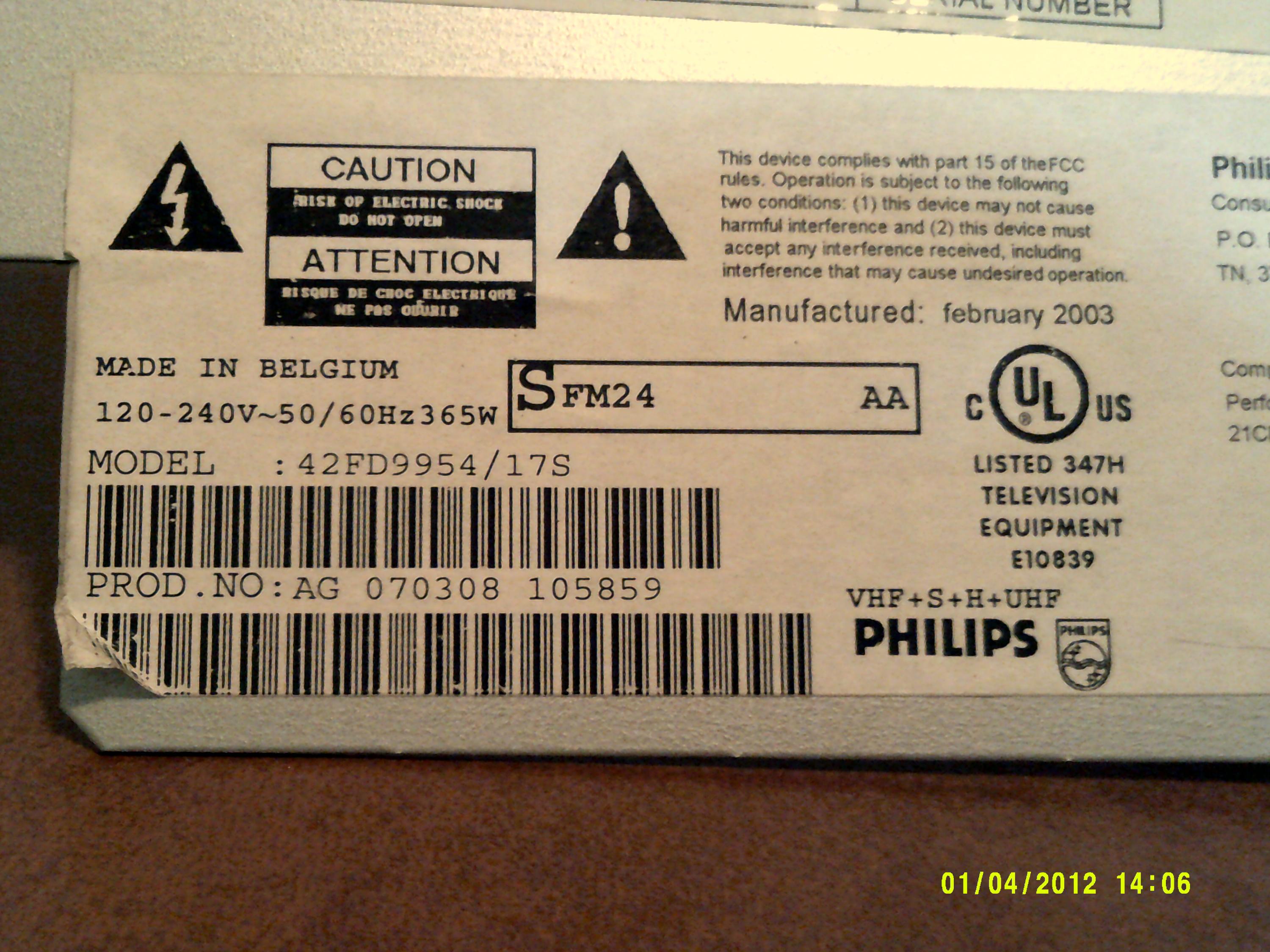

    this plasma does nothing. no led(standby), no relay click. no response at all.
    caps visually look good, 120v at main fuse
    I cannot find a service manual.
    I would apreciate some help and a service manual if possible.
    the main fuse tests 120vac but it is labeled 250v.
    Philips model# 42FD9954/17s
    I can supply closeup pics if needed.

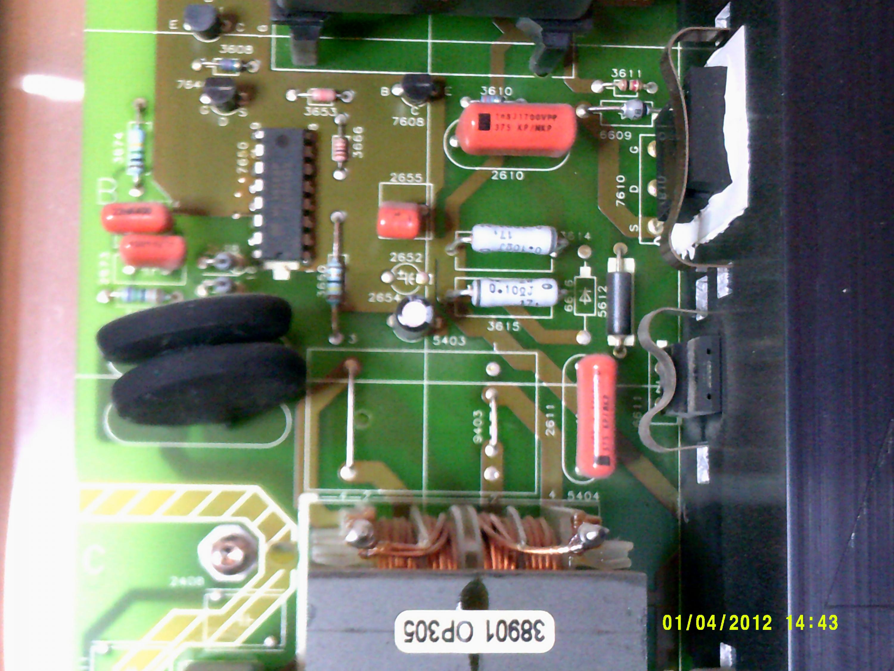

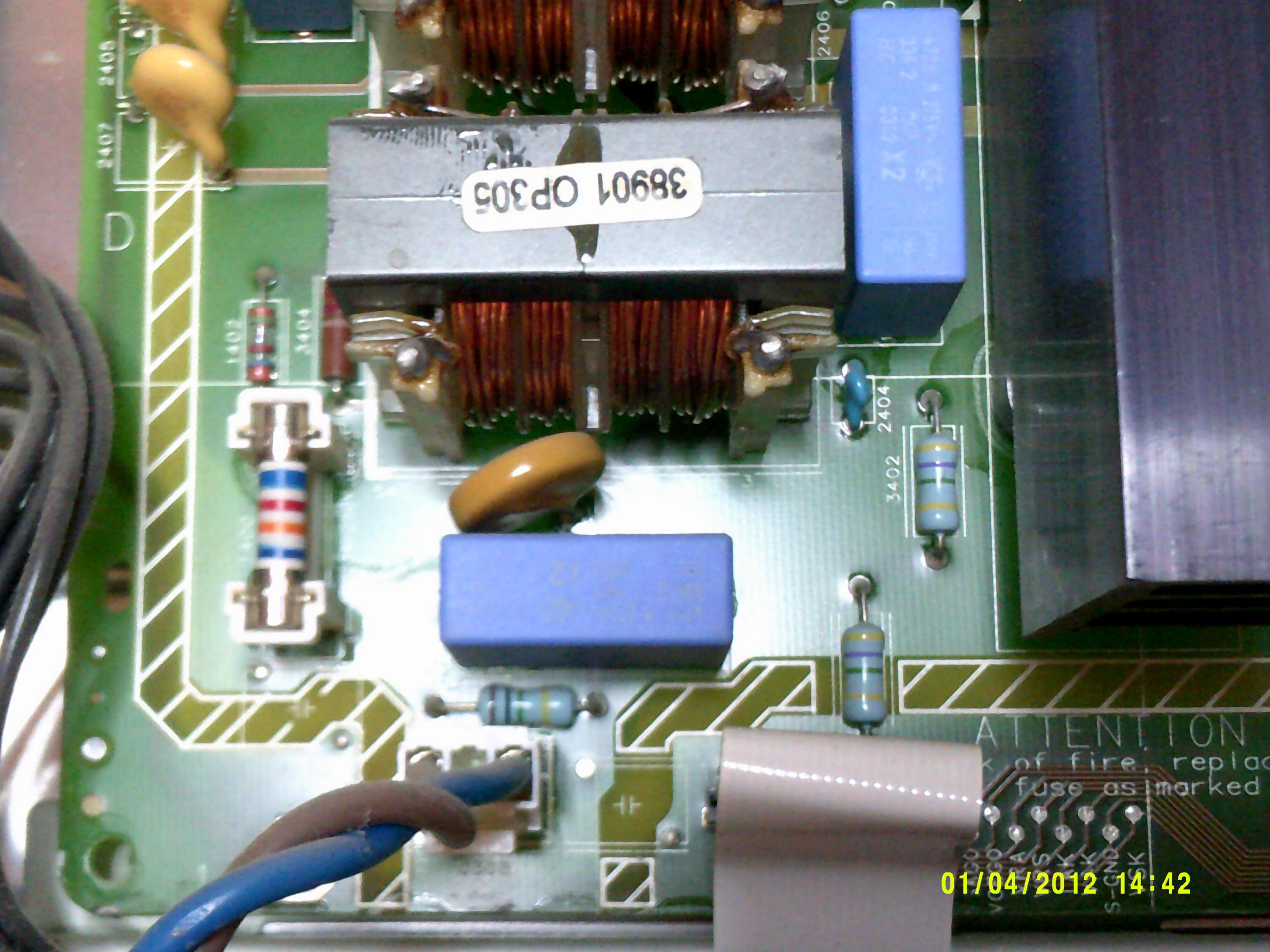

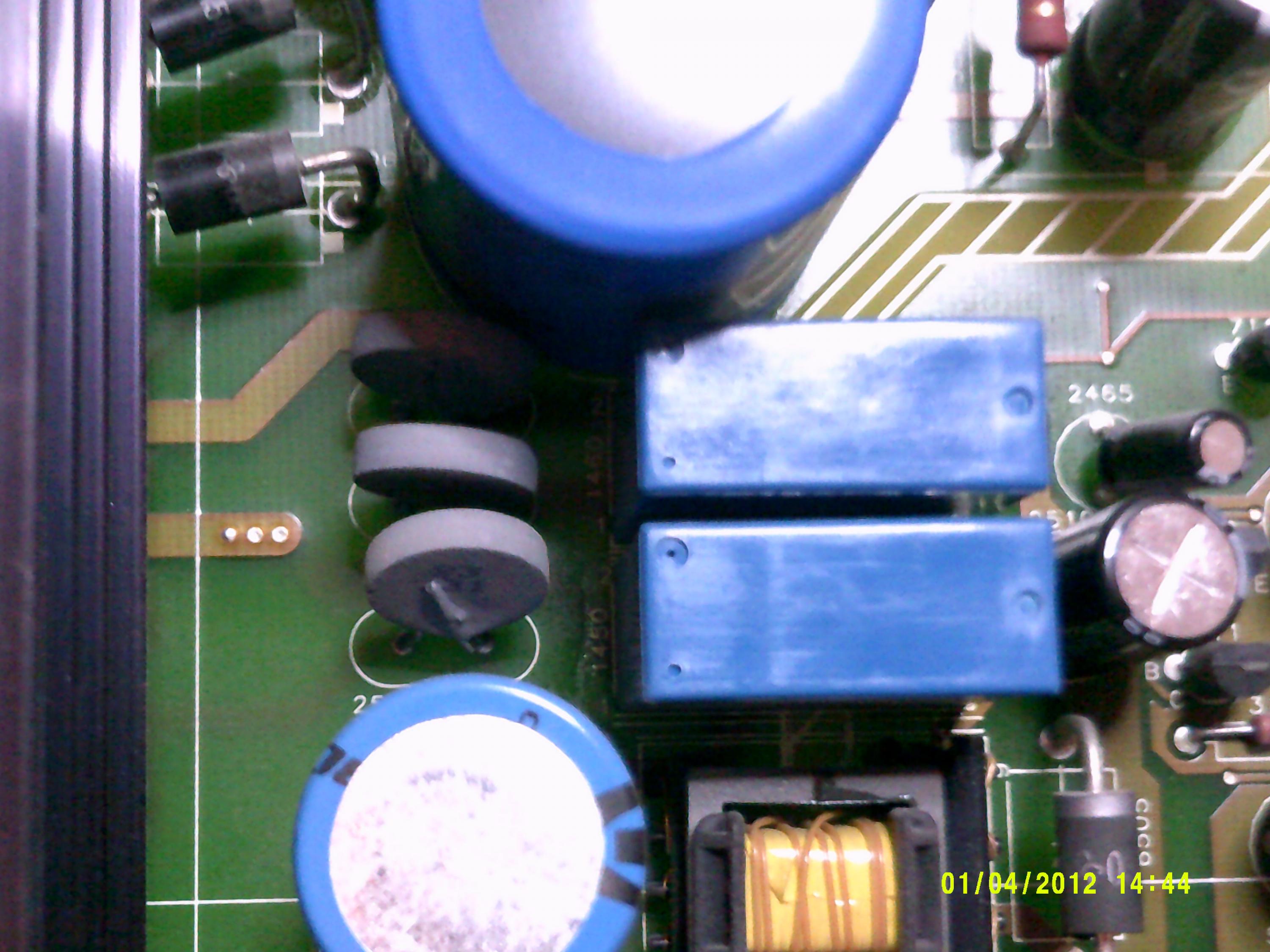

    Re: Philips 42FD9954/17s dead

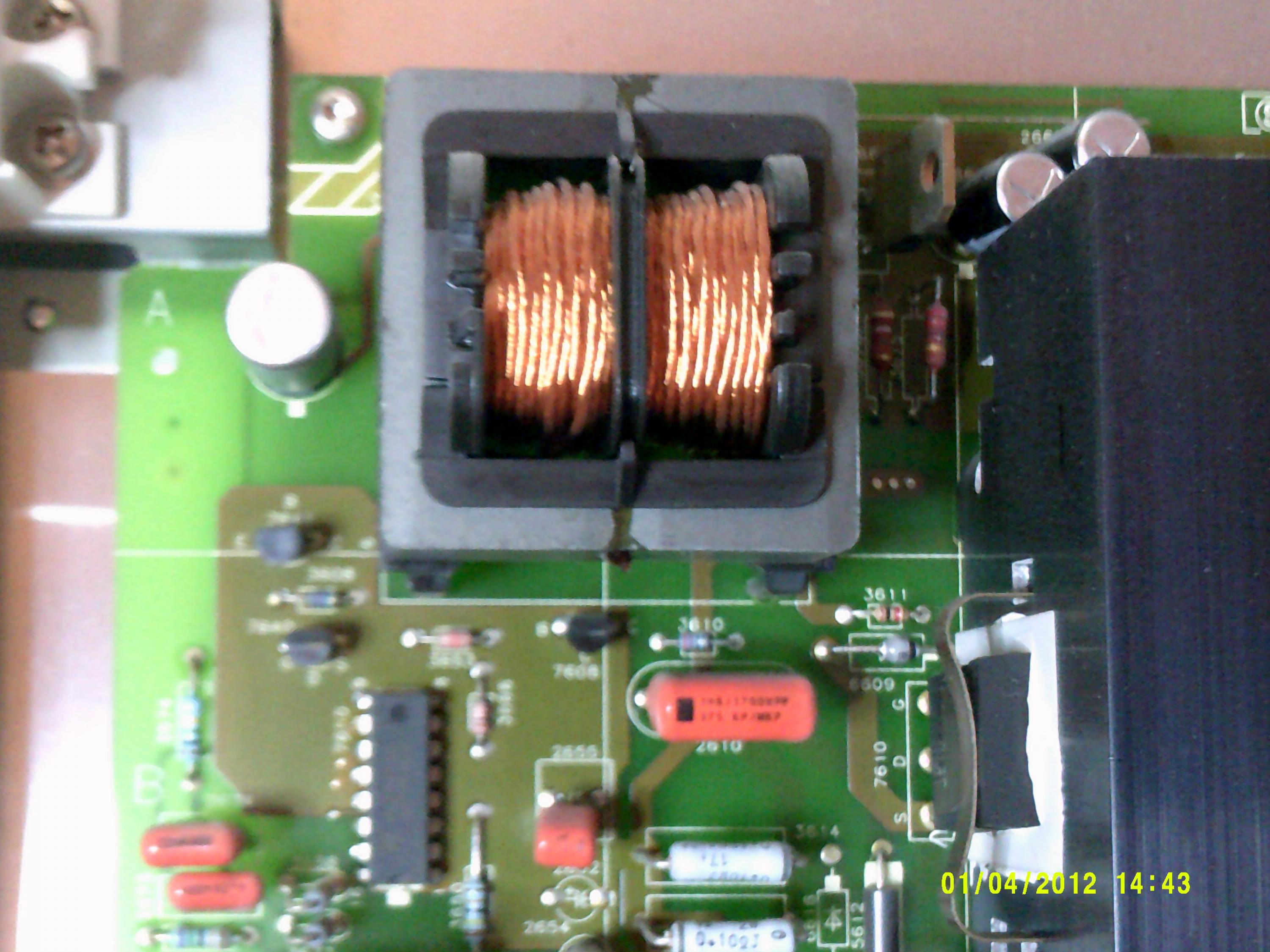

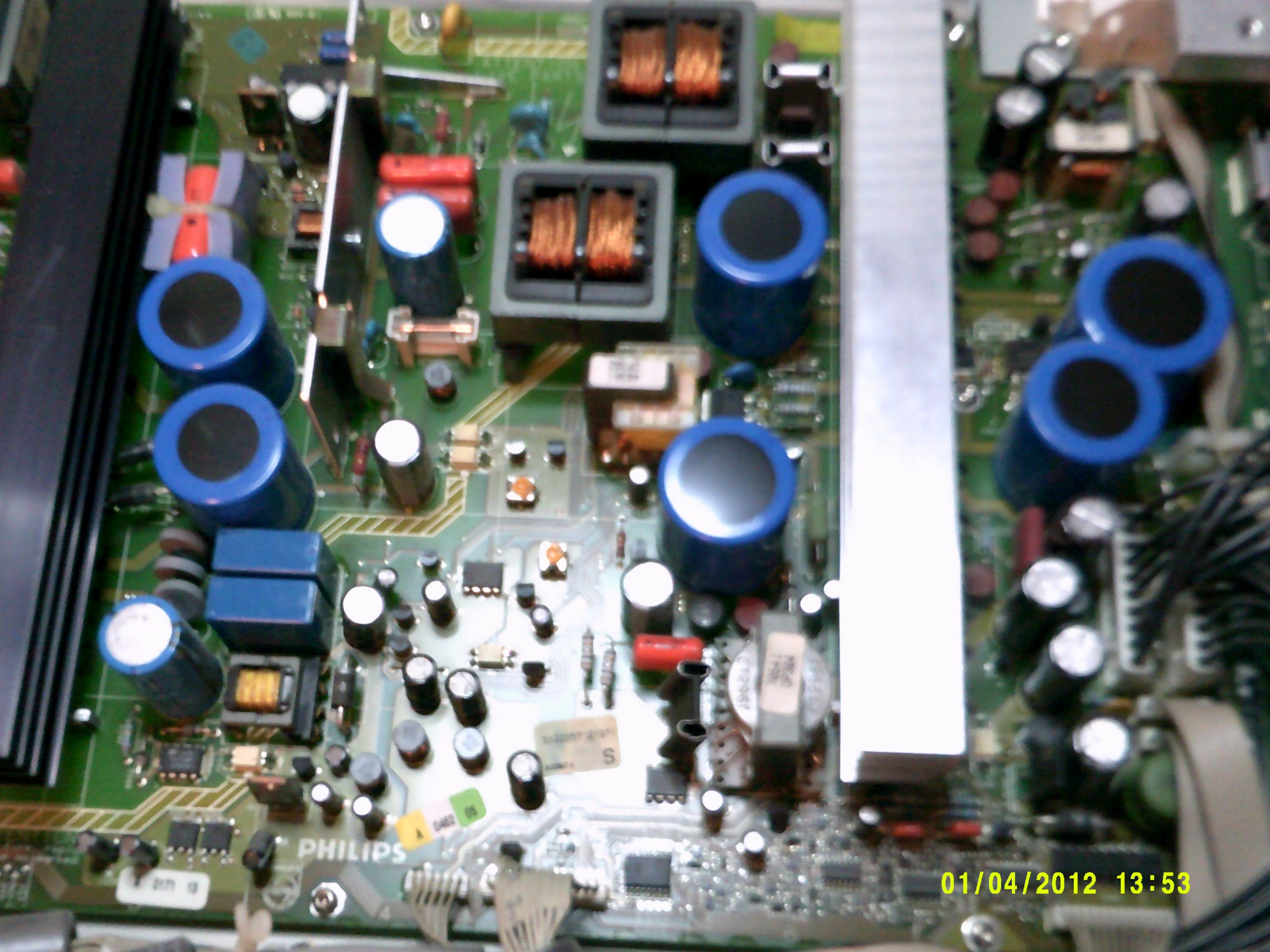

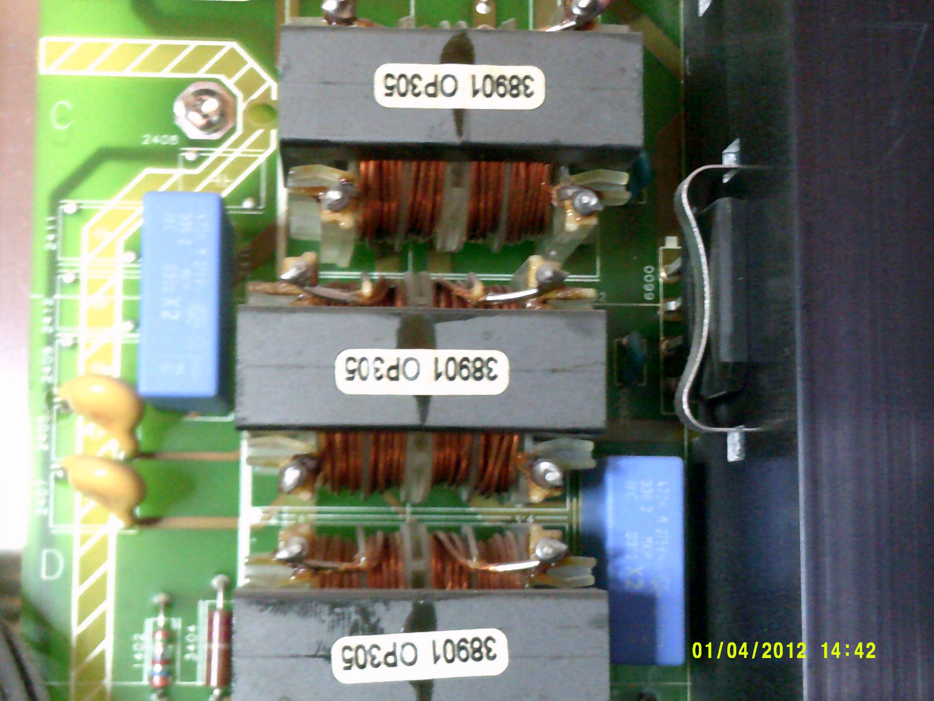

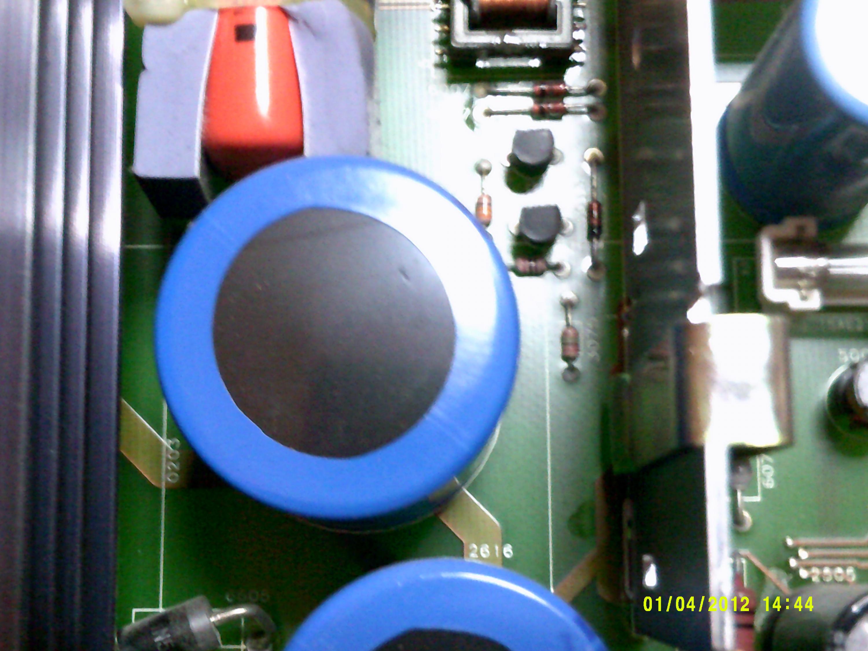

    here are close up pics of, only the left side of board.

        my panel sticker is:
        Fujitsu Hitachi
        FPF42C128128UB-72
        #N7A304224F103A

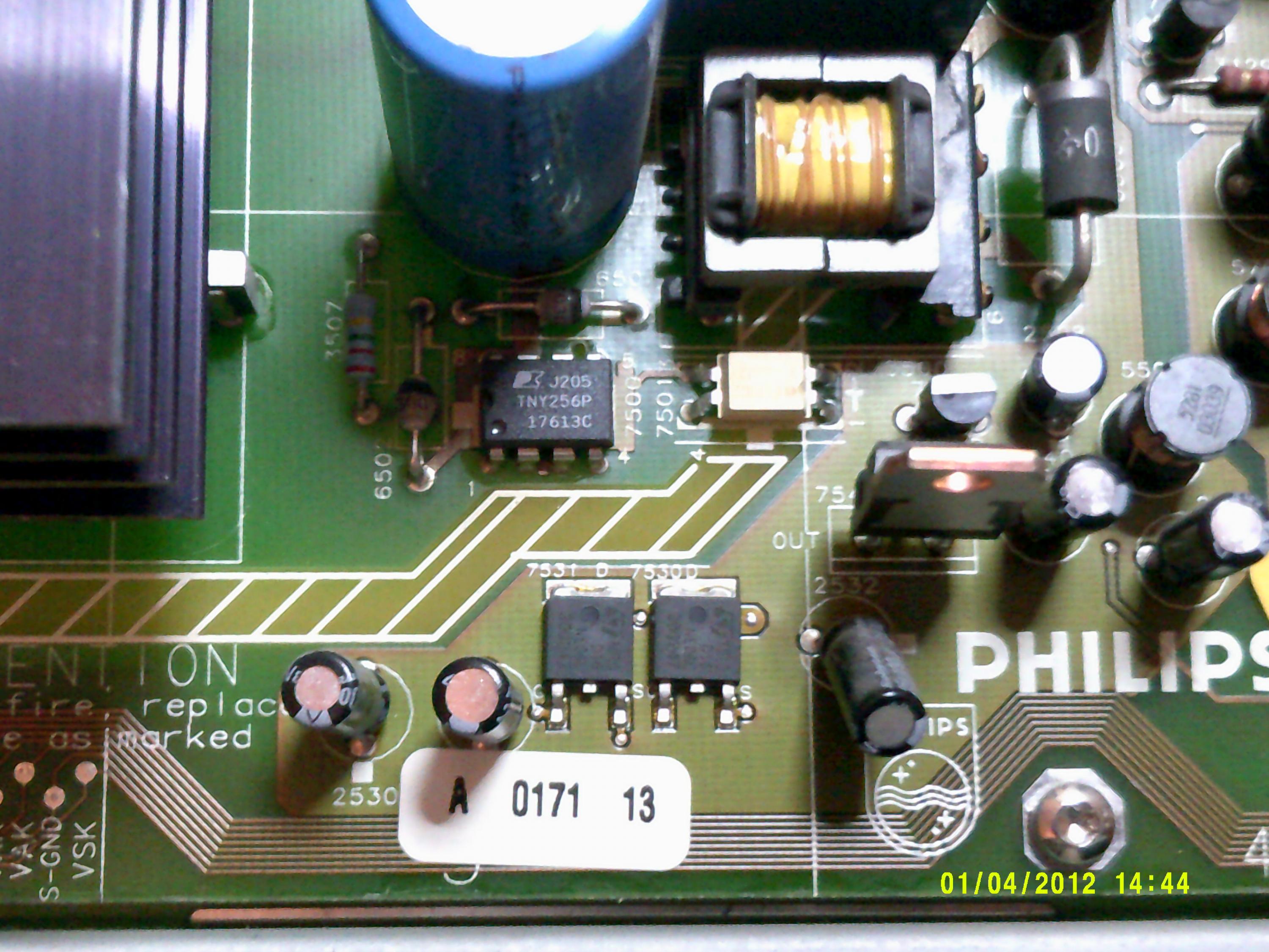

                          My error. This design doesn't use a startup cap. TNY256 doesn't need it.
                          You need to trace where the 9V is coming from. I don't think that small transformer is the source but I could be wrong.
                              I found tny256(loc7500) control.
                              It looks like there should be 400v going into control/standby supply from preconditioner.
                              I will look into it more tomorrow.

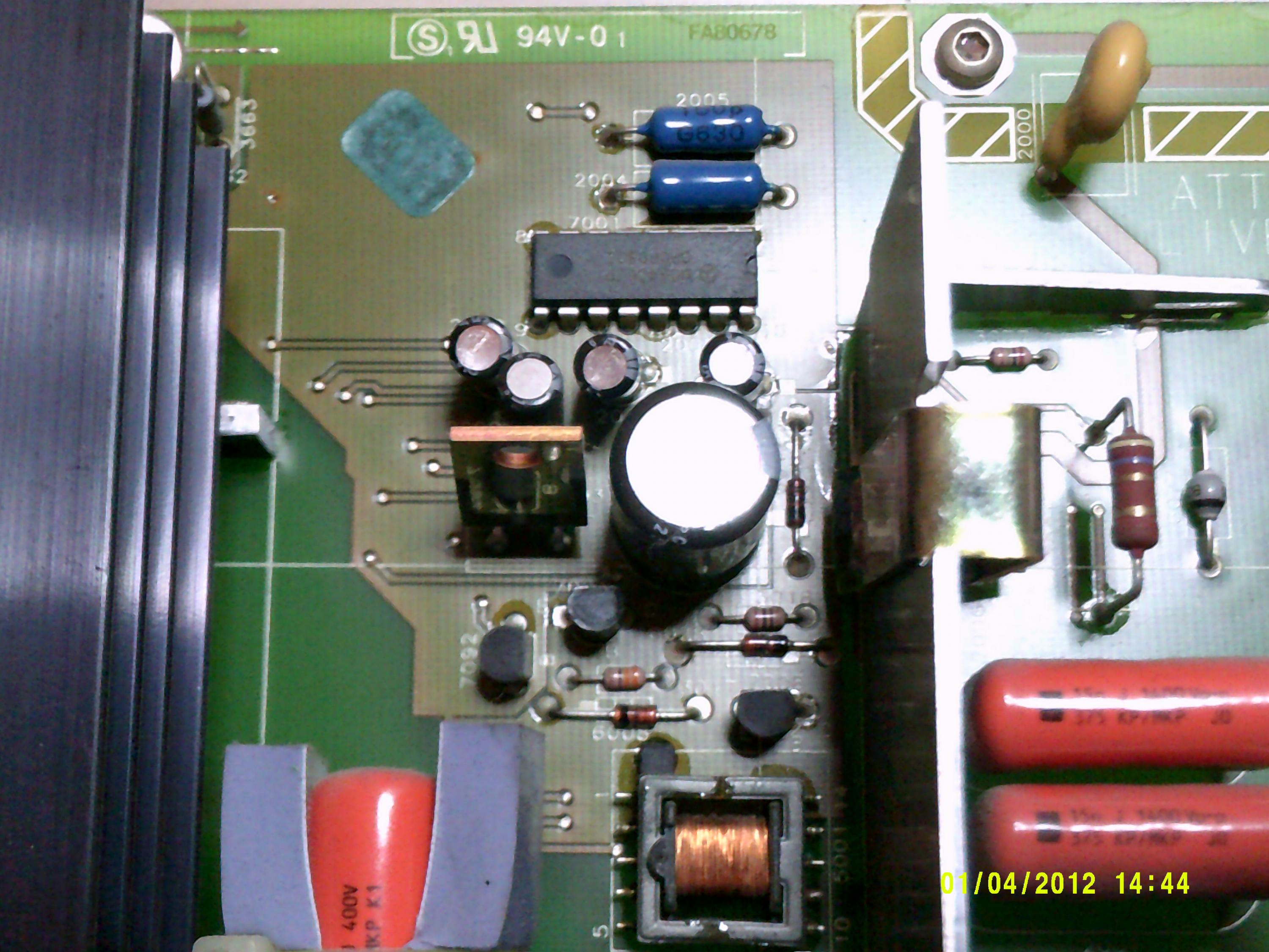

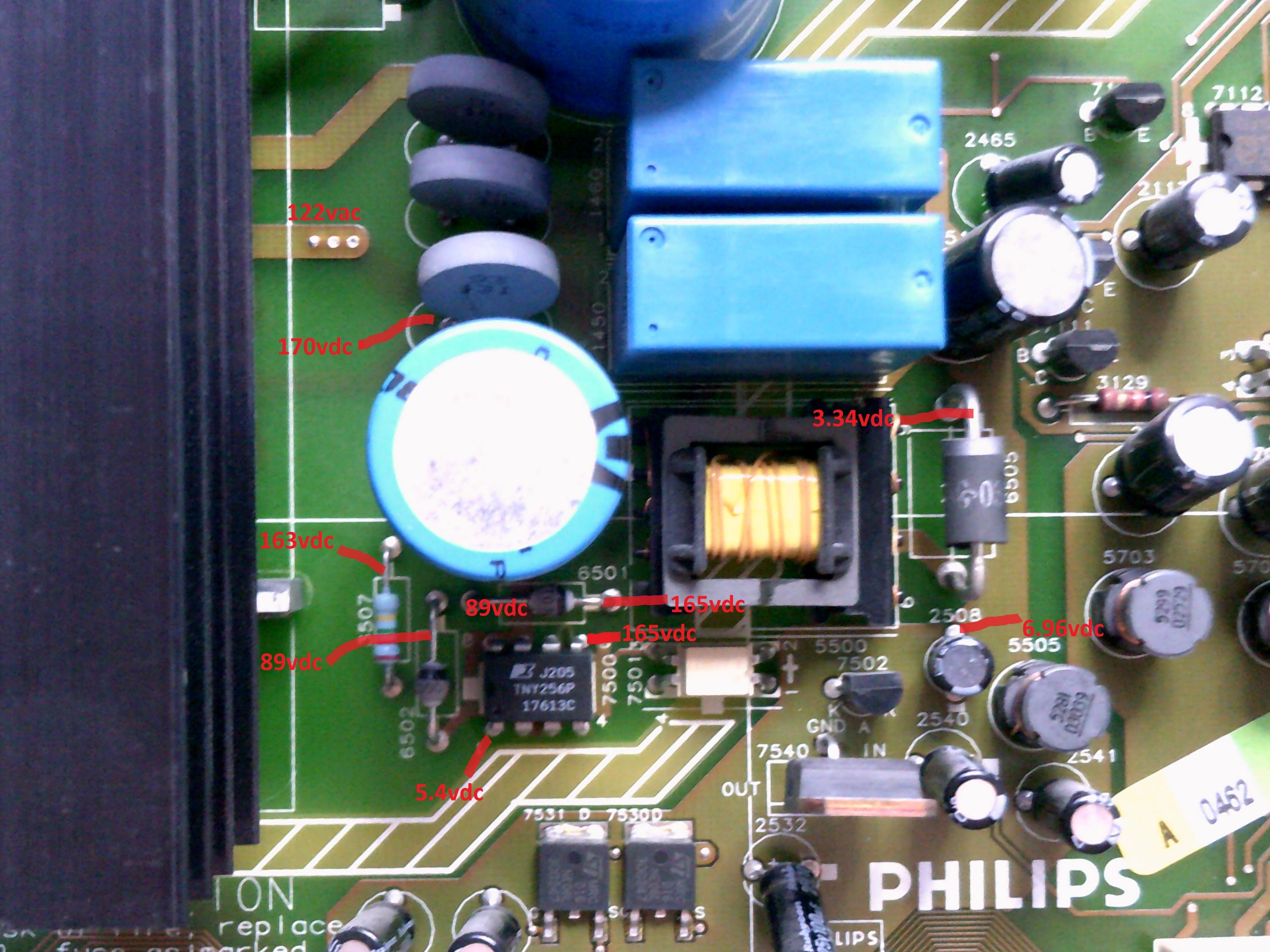

                                I let this stay pluged in an hour with power switch on(red led) then i grabbed remote and hit power and relay started clicking about 6 times and led turned flashing green durring clicking. i got no response from remote when i first powered it on. I still just get red led when i push power button
                                I took what voltage measurments i could from top of board and marked them on pic.
                                at 3506 I tested 170vdc but schem. shows 500v(400v from preconditioner)
                                I need a little help here.
                                I dont know what the preconditioner is.
                                If TNY256(loc7500) and CE165T(loc5500) should be fed 400-500v as schematic shows should I look at preconditioner?
                                or
                                Is this voltage ok and do i need to test CE165T and TNY256 for faults.
                                        It doesn't run in standby.
