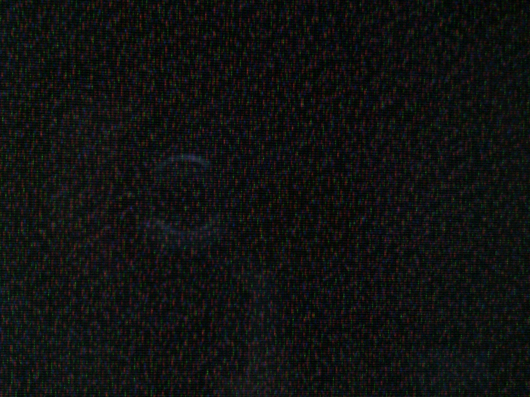

    -Update-

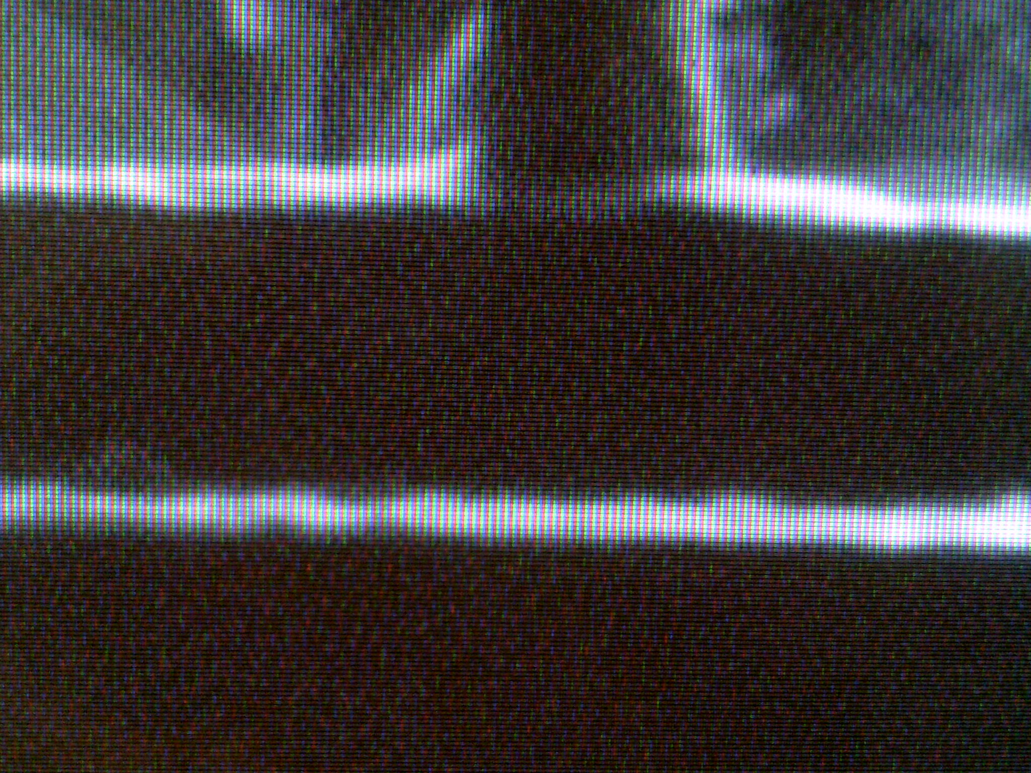

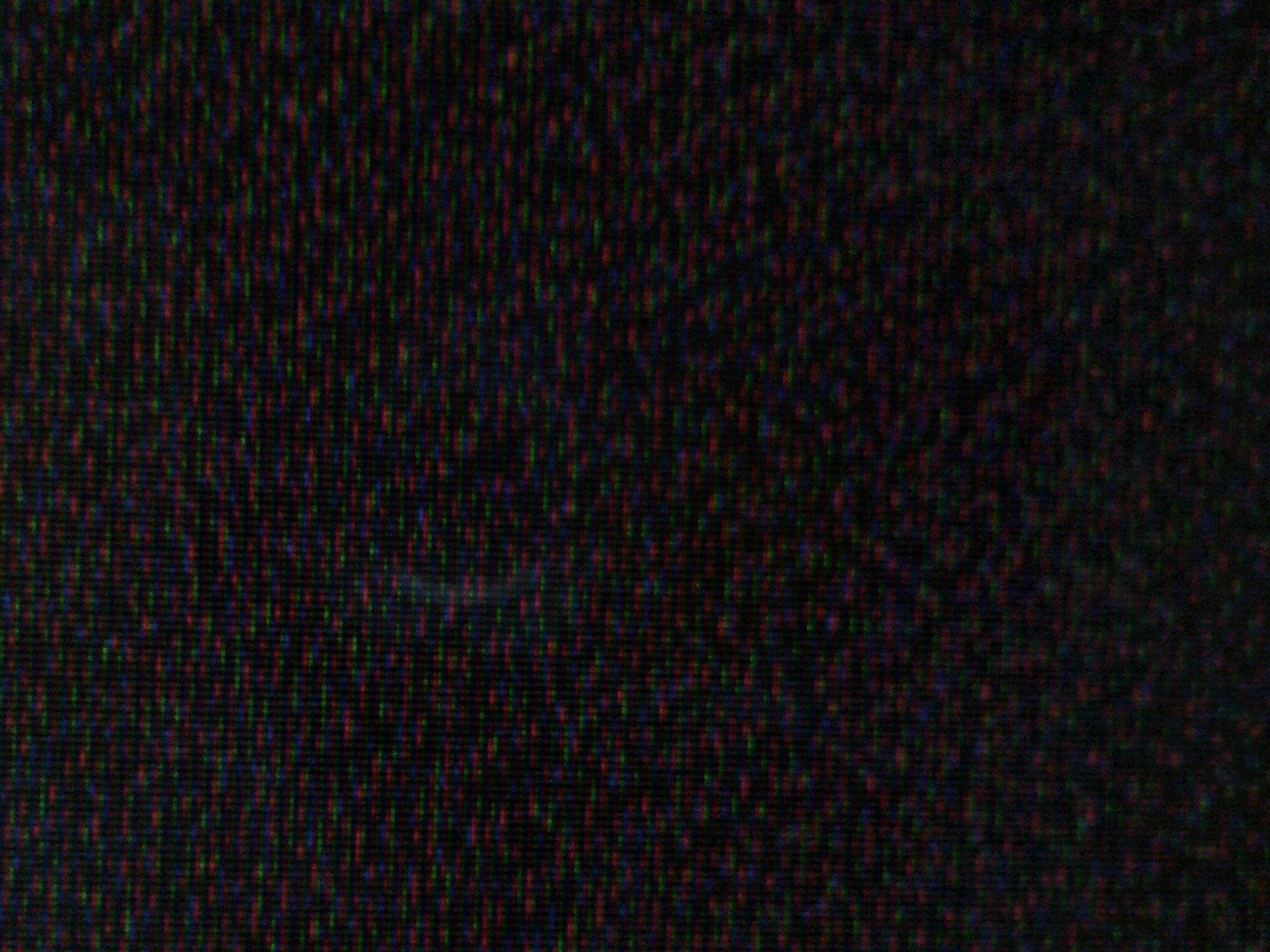

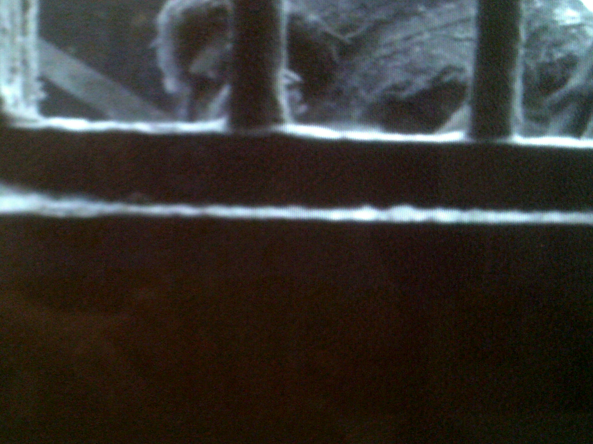

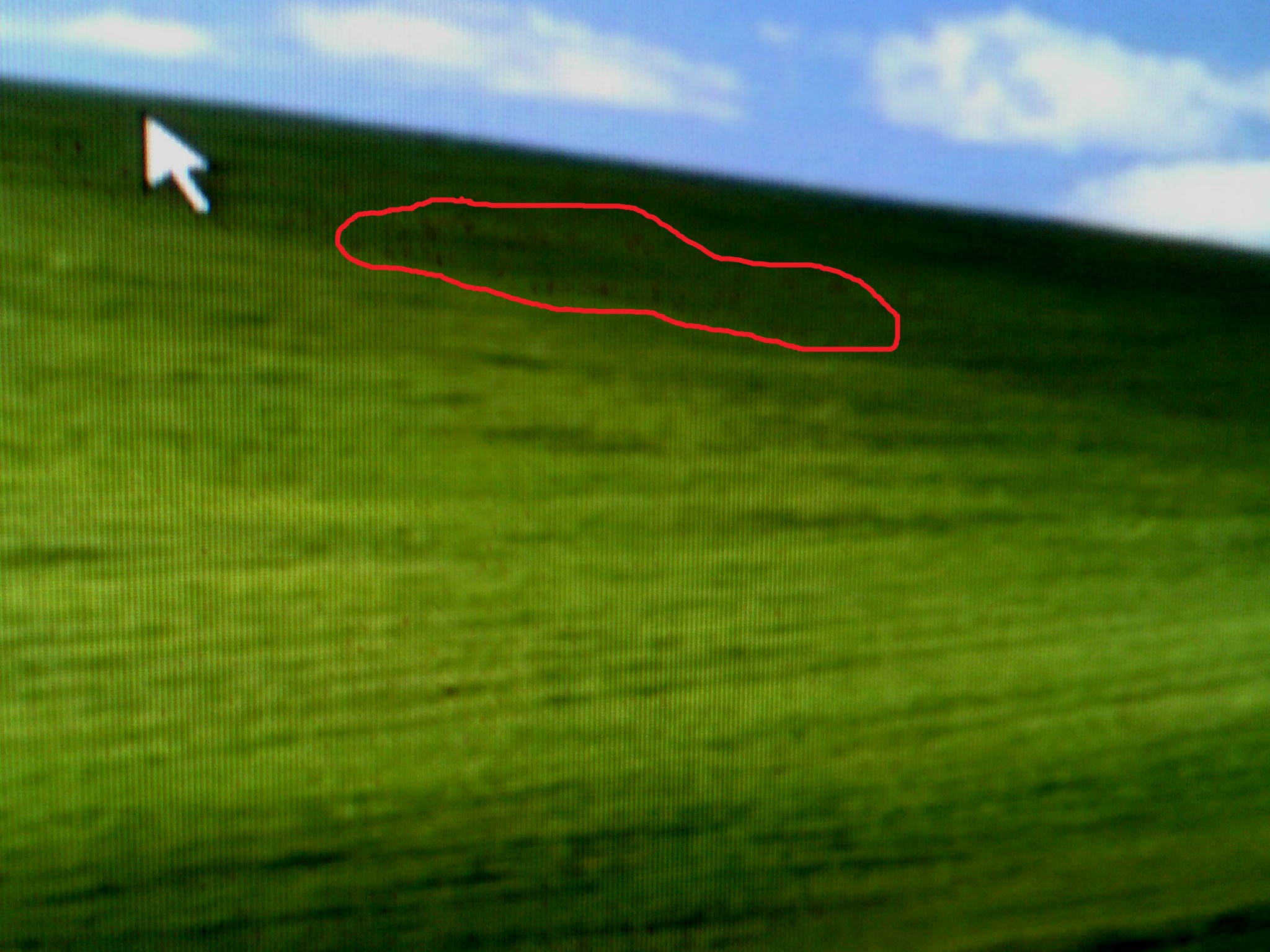

    I replaced 10 caps on the board in startup area.
    It now powers on ok and stays on but now I have a slight picture issue with input.
    The black pics are windows paint
    On dark screens i see some white sparkles and up close colors(see pics)
    On lighter color screens i notice black dots.
    it looks fine without a video input until it powers on.
    I have seen posts on sparkles on screen but havent read them before.
    I will do some searching here and see what I can find.
    The last 2 pics are of paused video. 1 from a distance and 1 upclose.

      http://www.avsforum.com/t/1083055/vi...#post_15046682
      Perhaps I'm just seeing dithering from being too close?
      I can't seem to capture the few random sparkles or white dots on camera.
      I may do more testing but I would like to get into service mode or do a factory reset first if Ican find out how.
      I think I may be able to make adjustments to fix it if voltage is off.

            This is also visible on the 37" Philips that I am in the process of fixing.

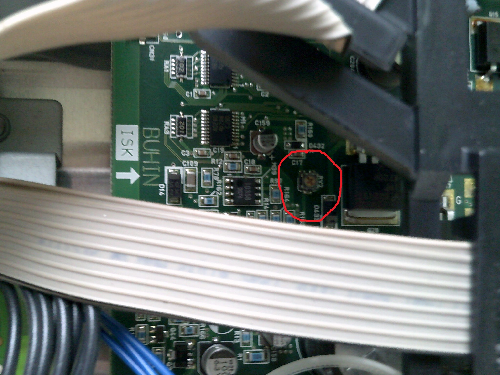

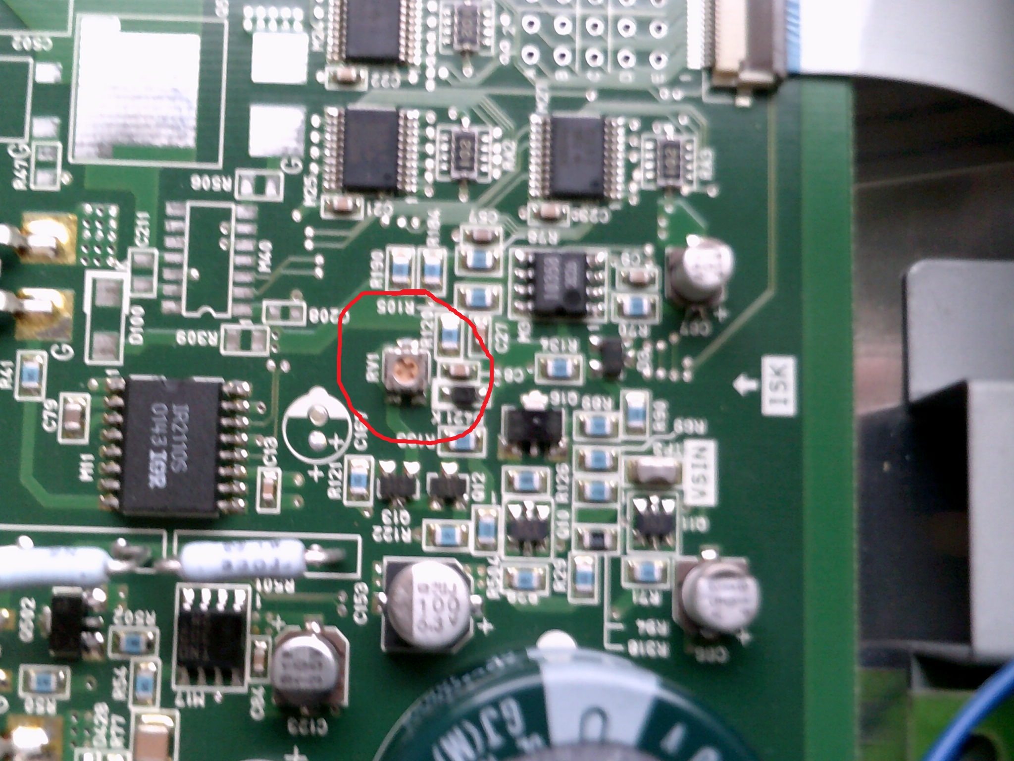

            The only adjustment on these panels is "Isk" on both sustains. Try tweaking that. There is no ramp-up/ramp-down control like on LG or Samsung and the -Vy/Vsc are fixed.
            The Vs/Va are not adjustable because Philips didn't include potentiometers.
            The exact required panel voltages are printed on a separate sticker. e.g. Vs=86.9V, Va=60.2V. It varies from panel to panel. I think Philips just stuck with a fixed voltage and hoped it would work. This may be the problem.

              I figure this is where you said to adjust in pics.
              I dont have a stand so it is face down on a table. Im going to have to figure out how to keep it upright while adjusting.
              -Edit- I cant see any other voltage ratings for panel unless it is under the boards.
                #47
                Re: Philips 42FD9954/17s dead
                Looks like them. Be very careful and adjust it slowly. If you can get a friend, then that works too .
                You need to take off the plastic frame, so that you can see the rest of the panel stickers.

                      The ISK didnt seem to do anything so I started messing with the adjustment on power board.
                      Sparkles went awawy 99% after slight adjustment at loc 3026.
                        #51
                        White sparkles are gone and from a distance everything looks good but up close i see color.
                        Im not sure if this is normal.
                          #52
                          Some sparkles came back as monitor warmed up and colors got a little worse. Adjustment on power board is maxed. Still can't find voltage sticker on panel. I may try replacing more caps and see what happens.

                                The sparkles issue you refer to is absolutely normal for a plasma. It's called dithering. Sparklies are only a problem if they are visible from approx 10 foot. A plasma panel only has single bit depth... pixels are on or off. So it dithers them to get full 10 bit colour, which works well when viewing the TV from approximately 10 foot. You will notice this on Panasonic, LG and Samsung plasmas.
