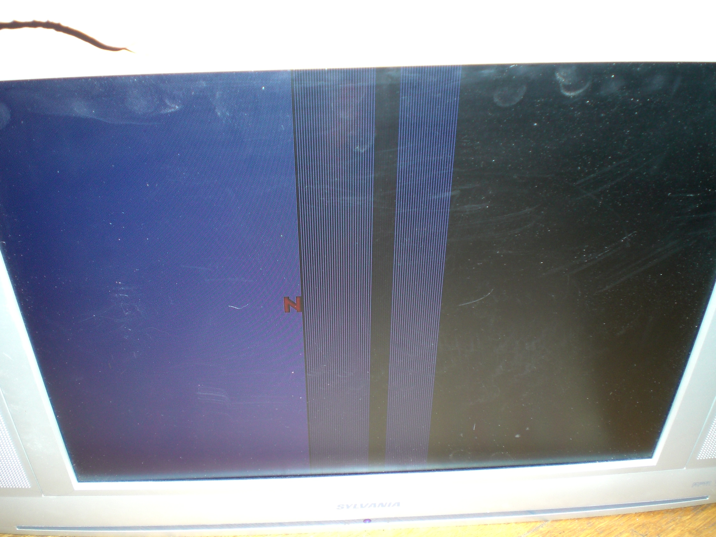

    Sylvania LC200SL8 - vertical stripes

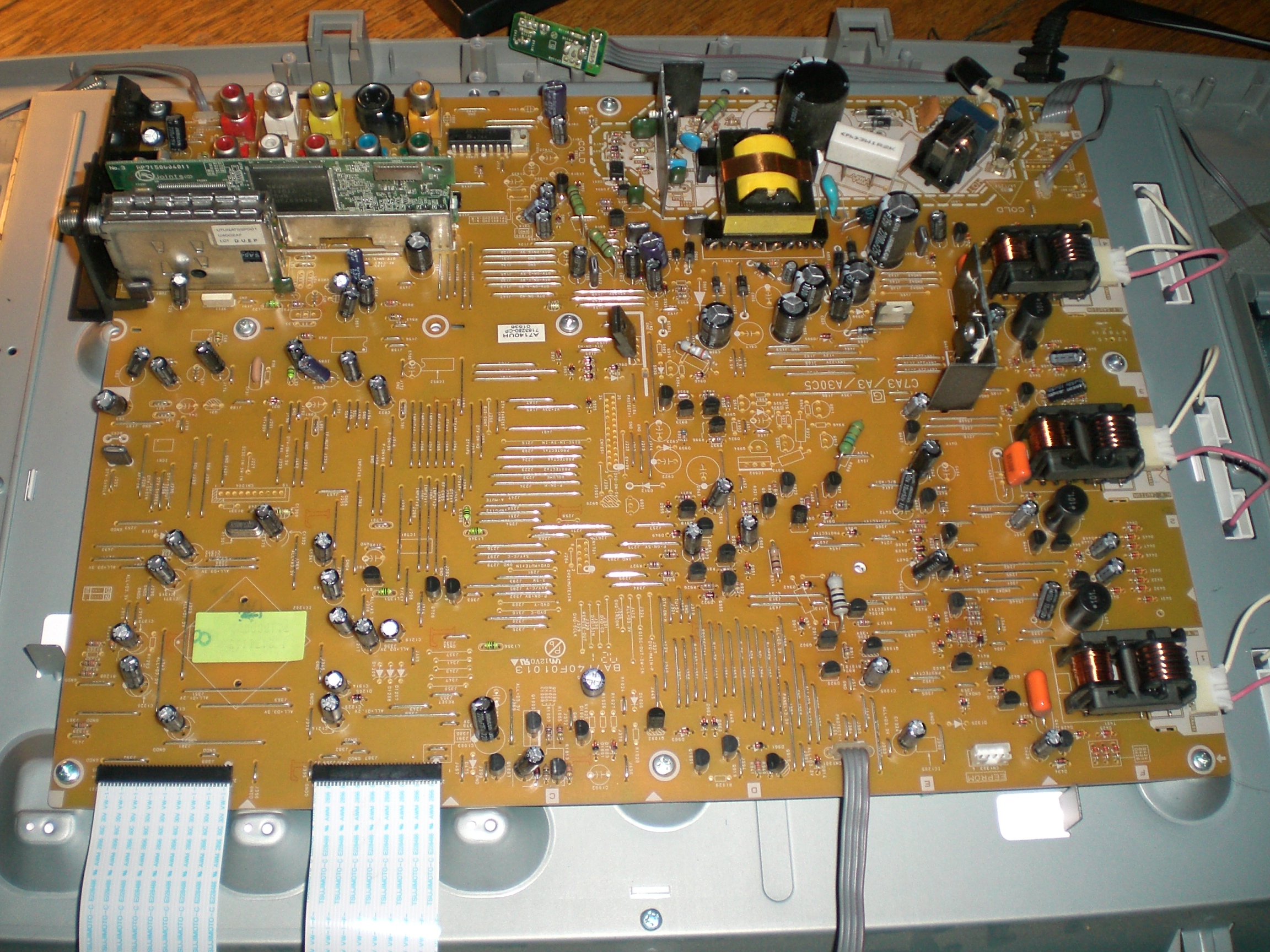

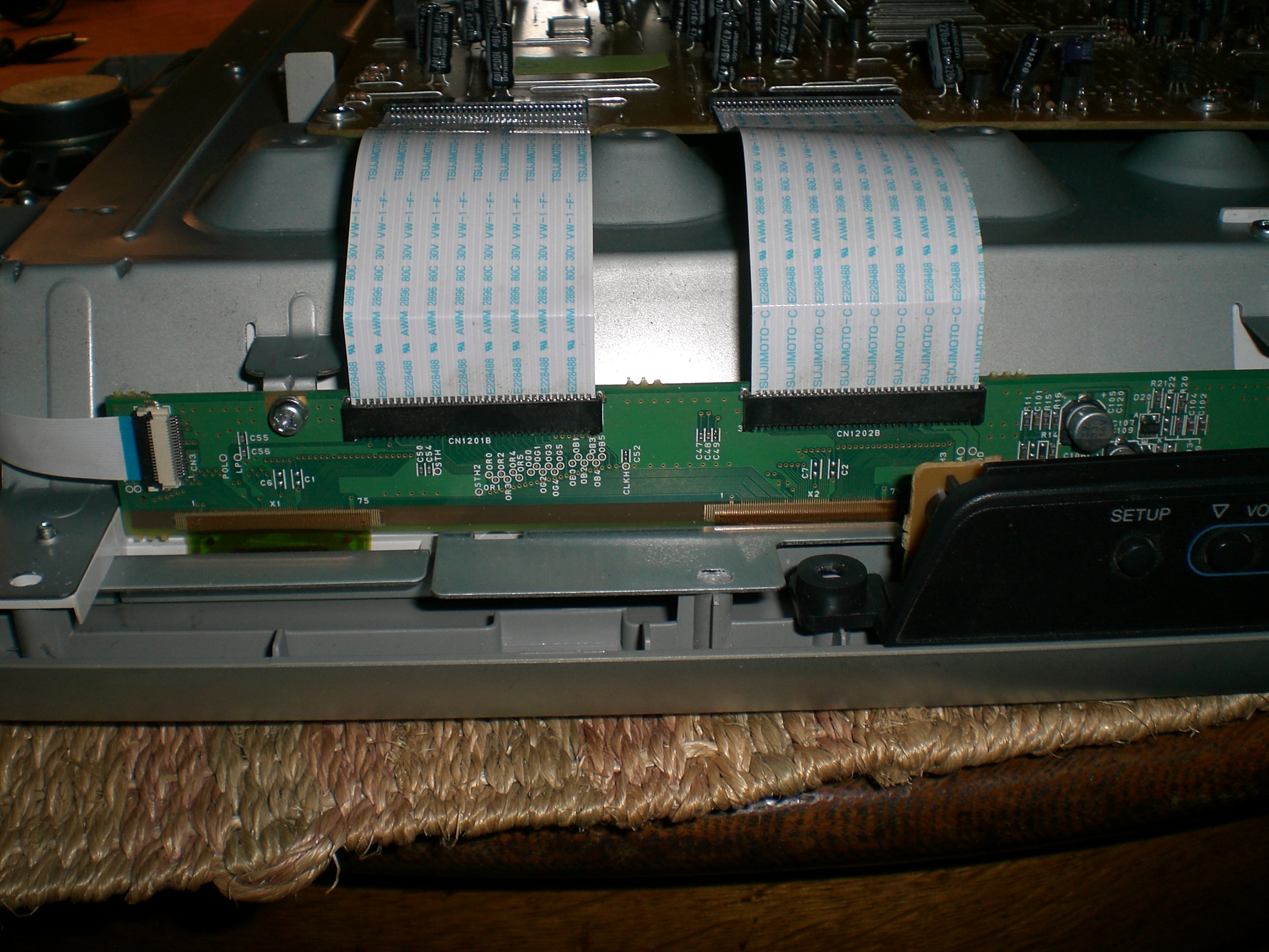

    Just picked this 20" LCD from the dump and plugged it in. Obvious right away why it was relinquished to the landfill. OSD comes on, but several vertical sections of the display flicker on/off. Looks like the display is divided up into six equal vertical segments. The three on the left are always on. The three on the right come and go as the t-con/LVDS (?) boards are pressed. Seems like the flat ribbon cables are delaminating? Never worked with the flat cables that connect the t-con to the LCD. Is this a fixable problem, or a waste of time?
    Re: Sylvania LC200SL8 - vertical stripes
    I am guessing panel failure. These TVs have all the T-con logic (whatever is left of it) on the main board.
