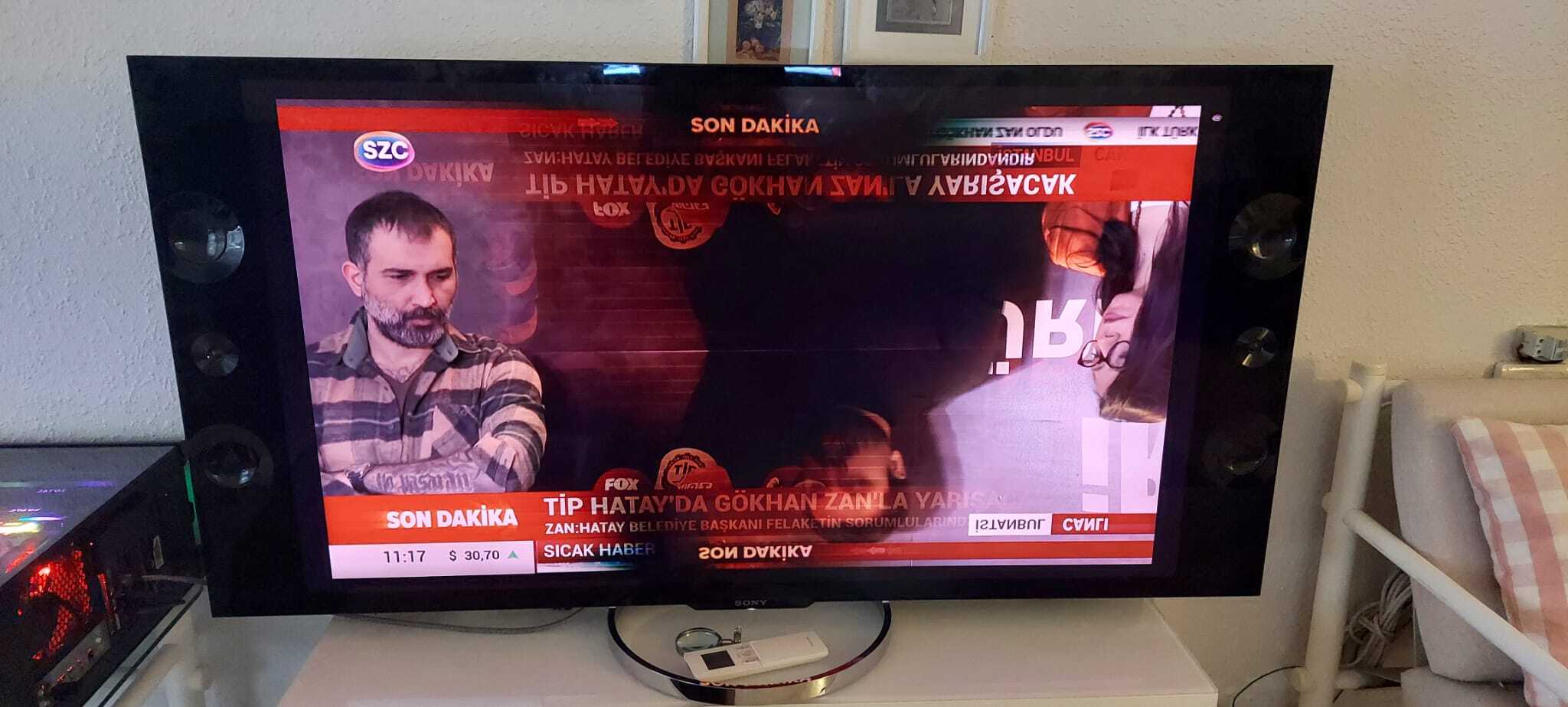

    Hi, TV boots with distorted image right side mirrored verticaly sometimes vertical stripes making off-on turns picture to normal and "perfect" (netflix image) that I highly doubt this is something related with t-con signal lines?? rather it looks software corruption bad mem chips voltage collapse or an intantaneous fault with fluctuating powerboard voltages?? As it happens usually when TV is cold sometimes fault comes back after a full day use should I check powerboard voltages with oscilloscope??

    you could start to inspect the down side of the PSU... all area which had burn ( black on the top ) resolder the area... also take out the LVDS between the MB and TCON to clean the contact pins and seated back again

      Thanks will try very annoying fault resolder down or top? psu is seperated into two sections?

        This is what it looks..
