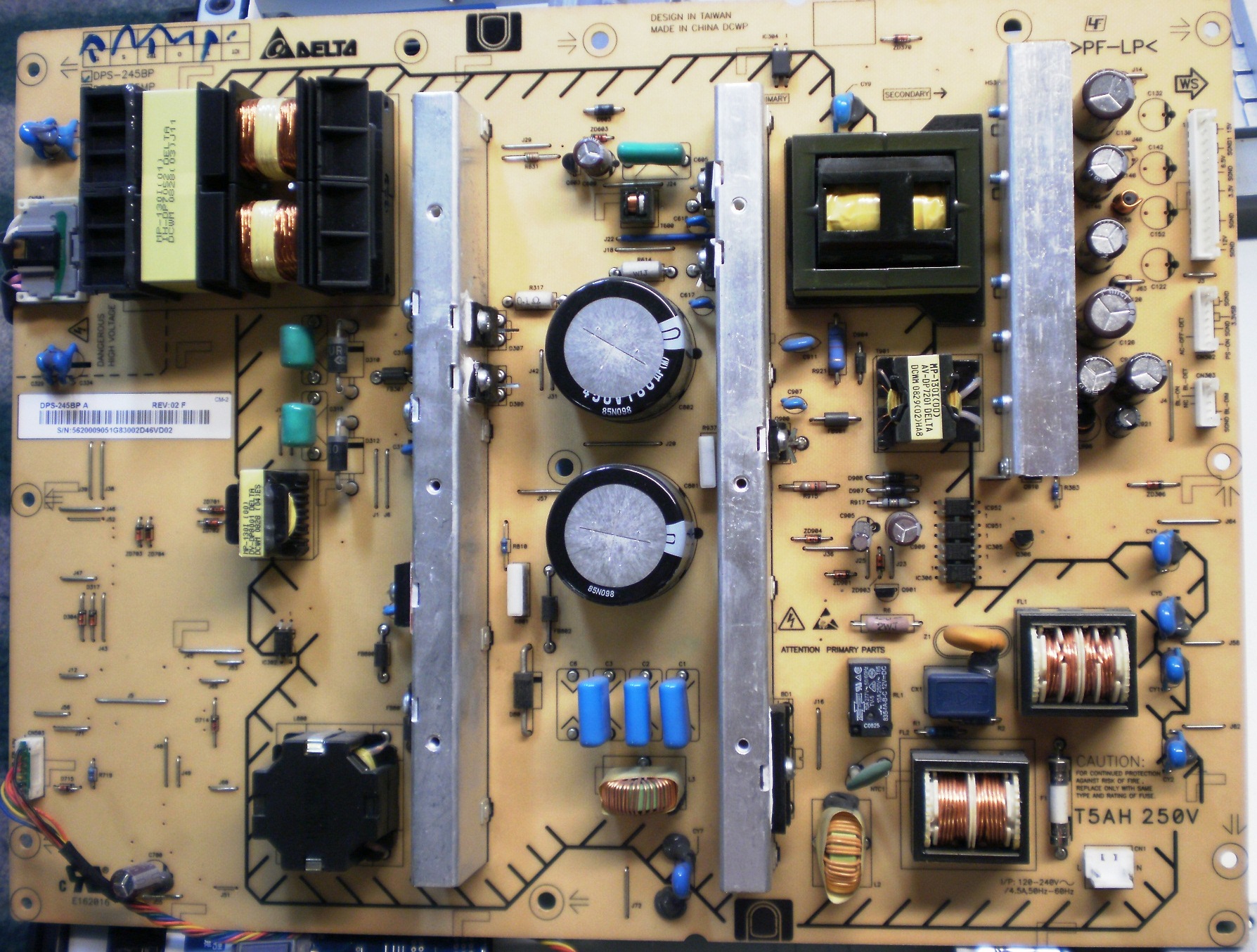

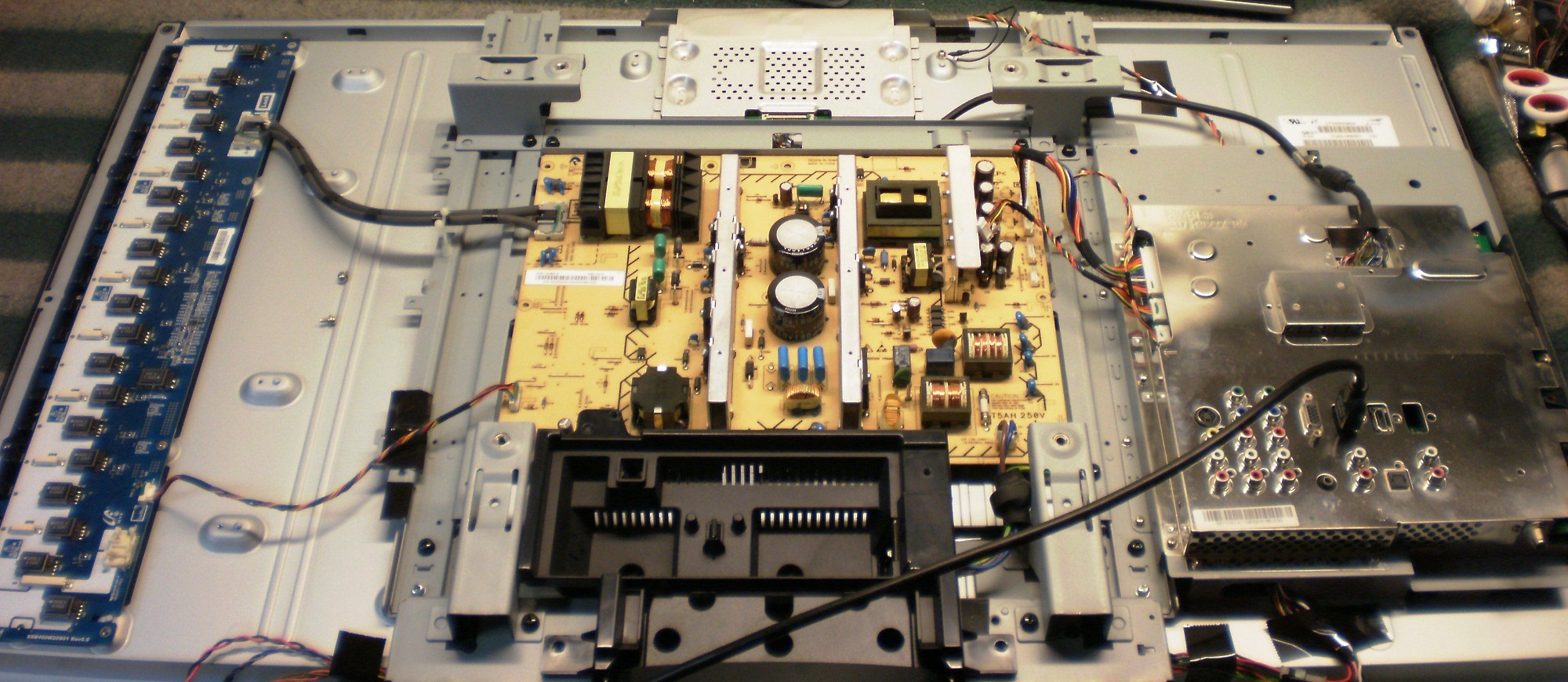

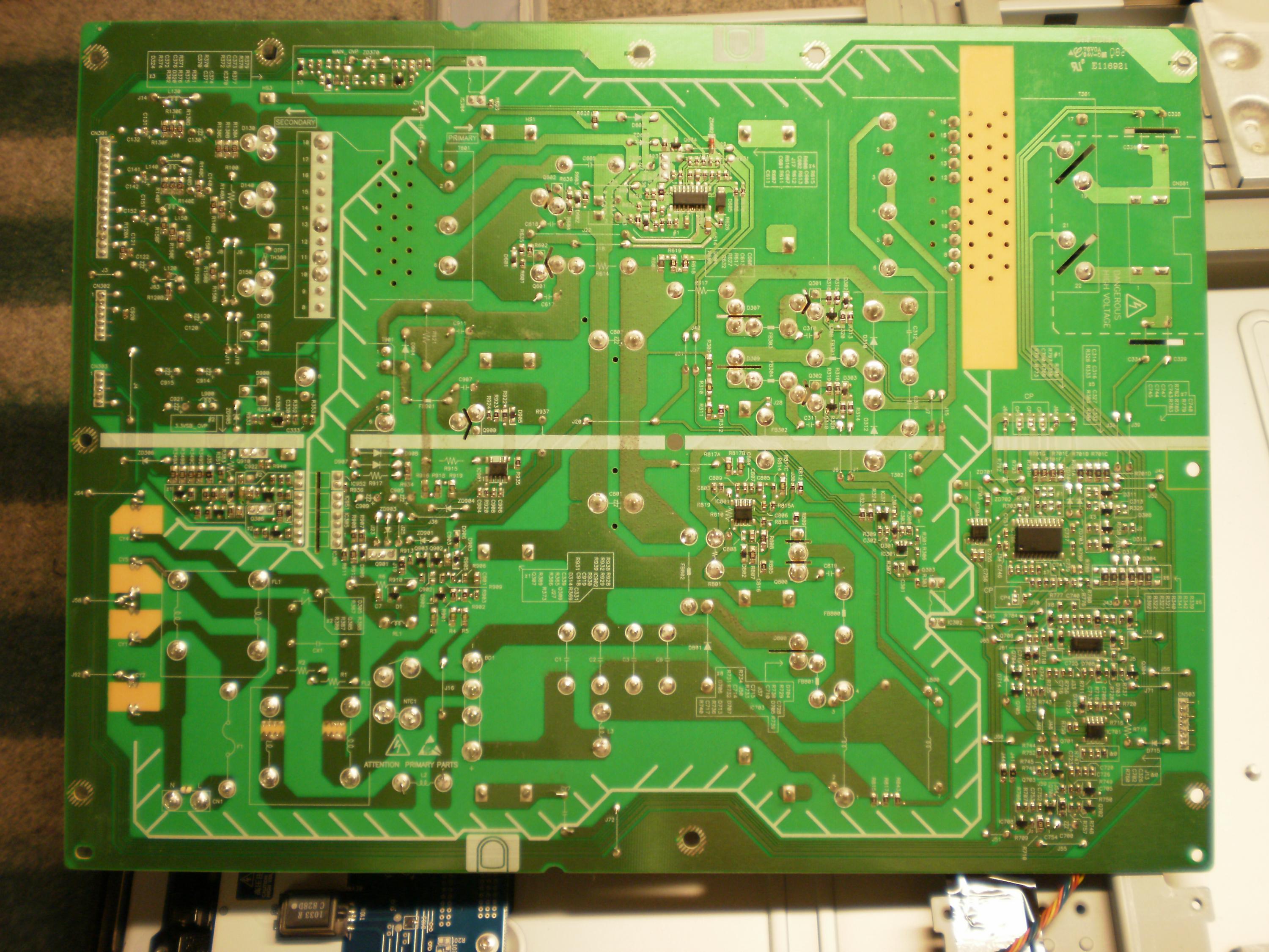

I have picked up this nice TV, looks like new. It was packed almost like you would get it from the store for $60.
TV works OK, except no backlight. It has sound, image with flashlight, voltages are OK.
I don't have 2 sec. to black, it's completely dead backlight.

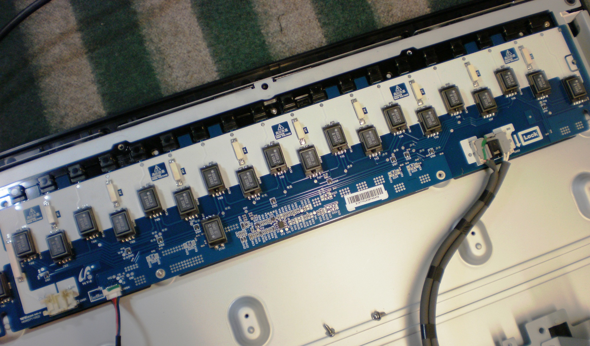

It's one big inverter transformer on the power supply and a bunch of small transformers on a separate board.
I have watched that Samsung similar setup which shows how to measure and bypass a bad transformer or ccfl tube.
I did not find anything bad there. All the transformers are the same resistance, 235ohm. Voltage at each test point is the same, if I wait a while it drops to 0.1Vacc. With the scope I'm getting a similar signal at all test points.
I feel like it's something very simple, I'm just over looking something.
