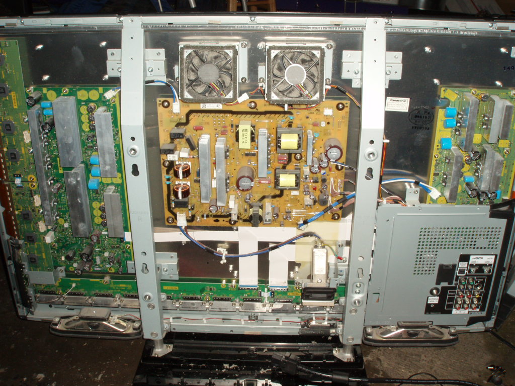

    I have a 42" Plasma that does not have a picture or sound. I have done little testing on it and if i unplug the top right board then the tv will power on and have a picture. Its a bad picture but its there. If the board is plugged in the it wont turn on at all and just flashes 10 times. I have not done much to it, I still need to blow all the dust off. lol.
    Its a TC-P42S1
    heres a few pics.

    Sounds like you've isolated the problem to me as bad SS board.
      Re: Panasonic TC-P42S1 no picture no sound.
      Picture purplish tinted, somewhat faded, and/or very dim? SS is dead.

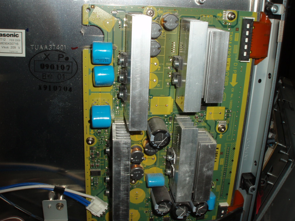

        Yep thats what it looks like. I Know the SS is dead but i would like to try to Fix whatever died on it. Does anyone have a trouble shooting guide or a service manual for it.

          I would start by looking for shorted mosfets

            Q102 test bad. Its a
            K3995
            8N7B
            Anyone know where i can get one or a cross for it?
              it is 2SK3995
              If that helps...

                If that's all that's shorted how lucky are you. At least it's off the shelf available.
                The schematics are all you're most likely going to find. SS boards are usually cheaper than SC to buy.
