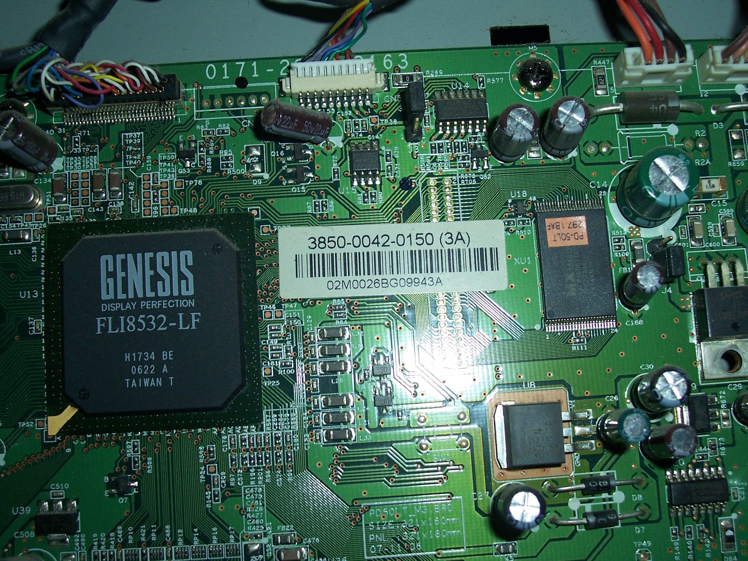

            In the manual it has a part number for the Main Board is 385000120150 (sometimes listed online with dashes). But no number for the Y Board (I assume Y-buffer). Can I trust this number or are there a bunch of different ones based on year manufactured? I would like to get my ducks in a row before I hire a crane to get this beast off the wall and take all 6k screws out and have it laying face down on the futon/couch for a week or two while board(s) are on order. LOL
            Manual
            http://www.scribd.com/doc/36893692/V...Manual-061107t
            page #21
            OMG I love this board!! It's the first board I have ever been on with no trolls or idiots asking me if it's plugged in! Thank you!!!

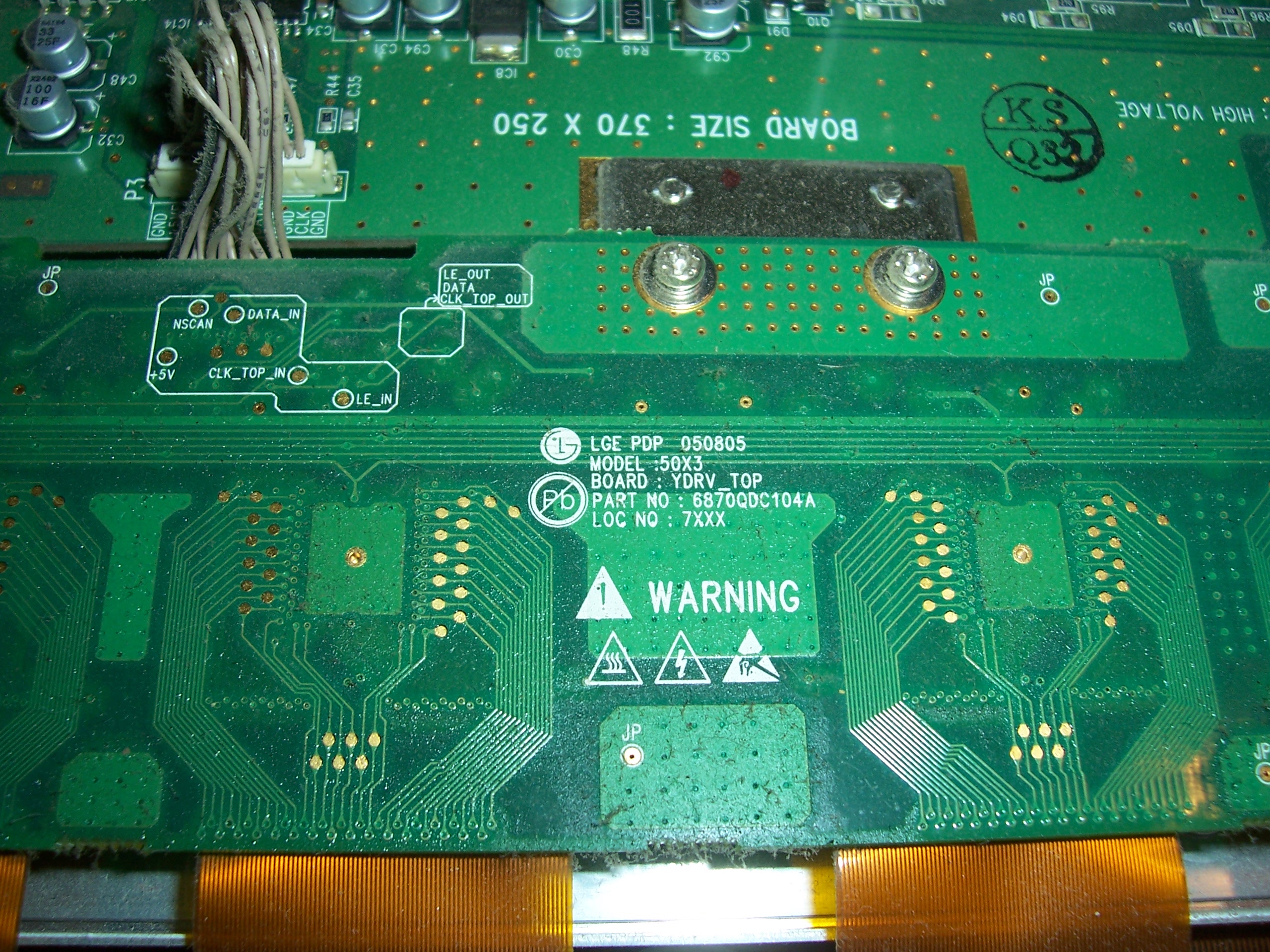

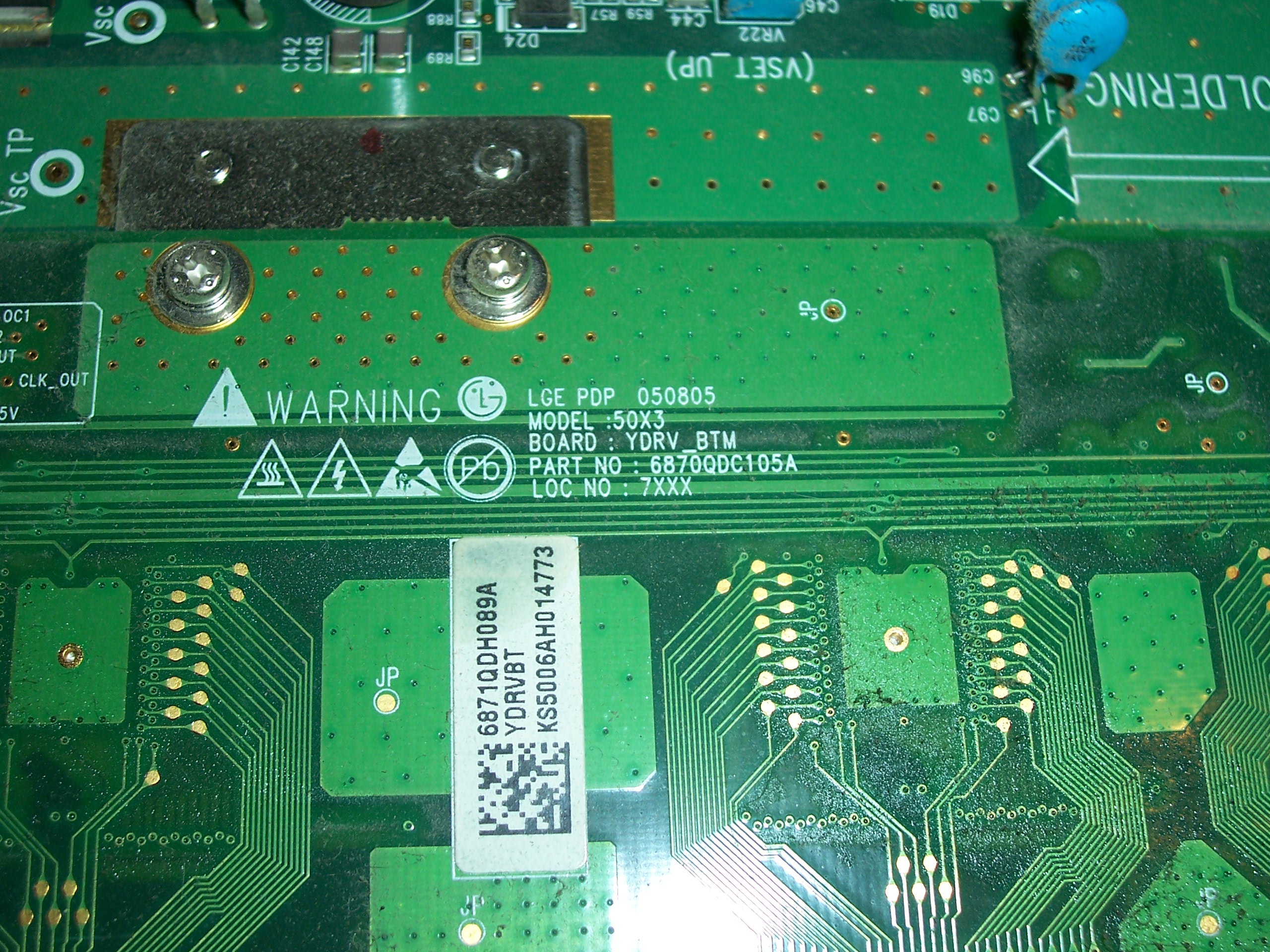

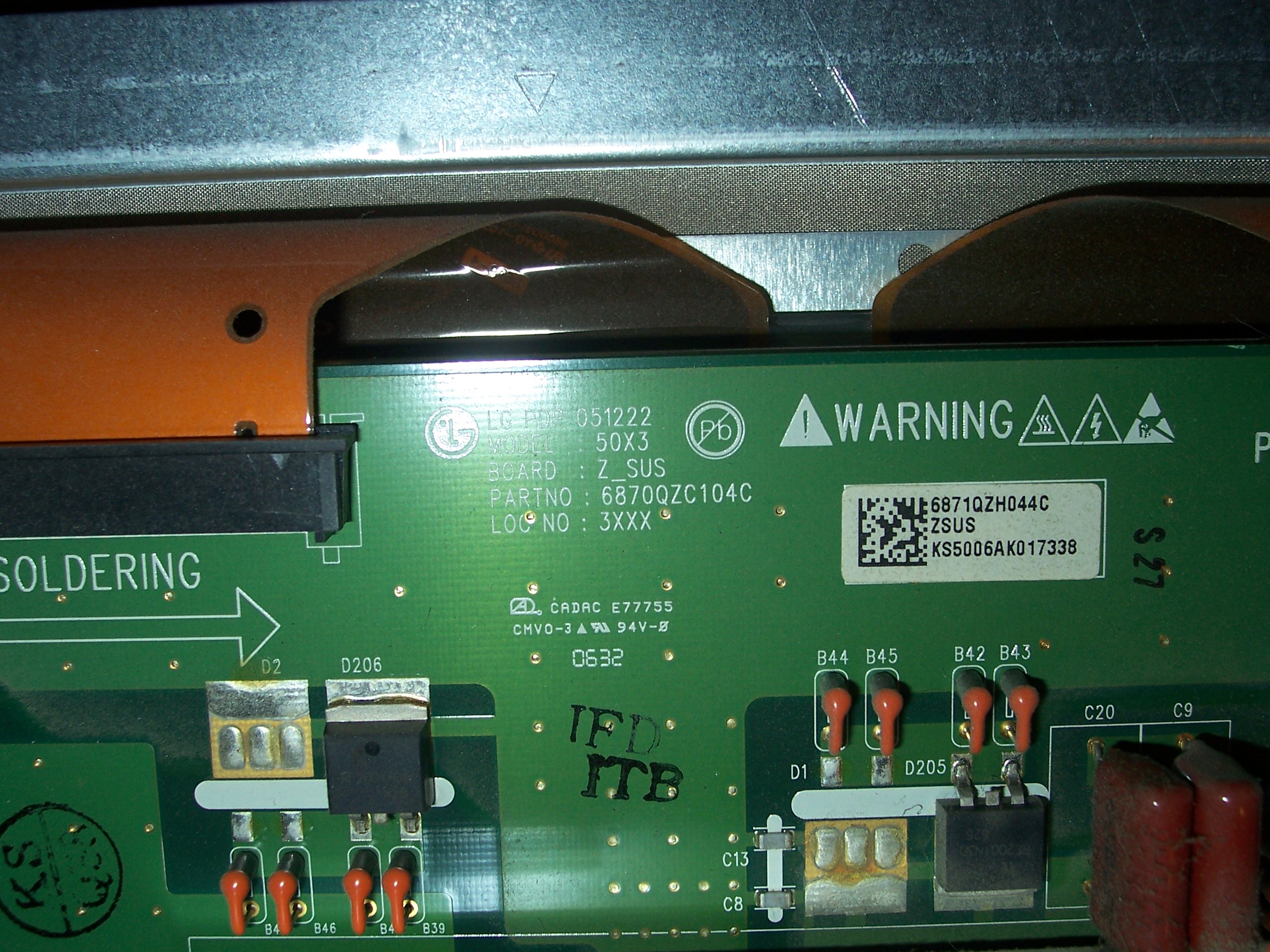

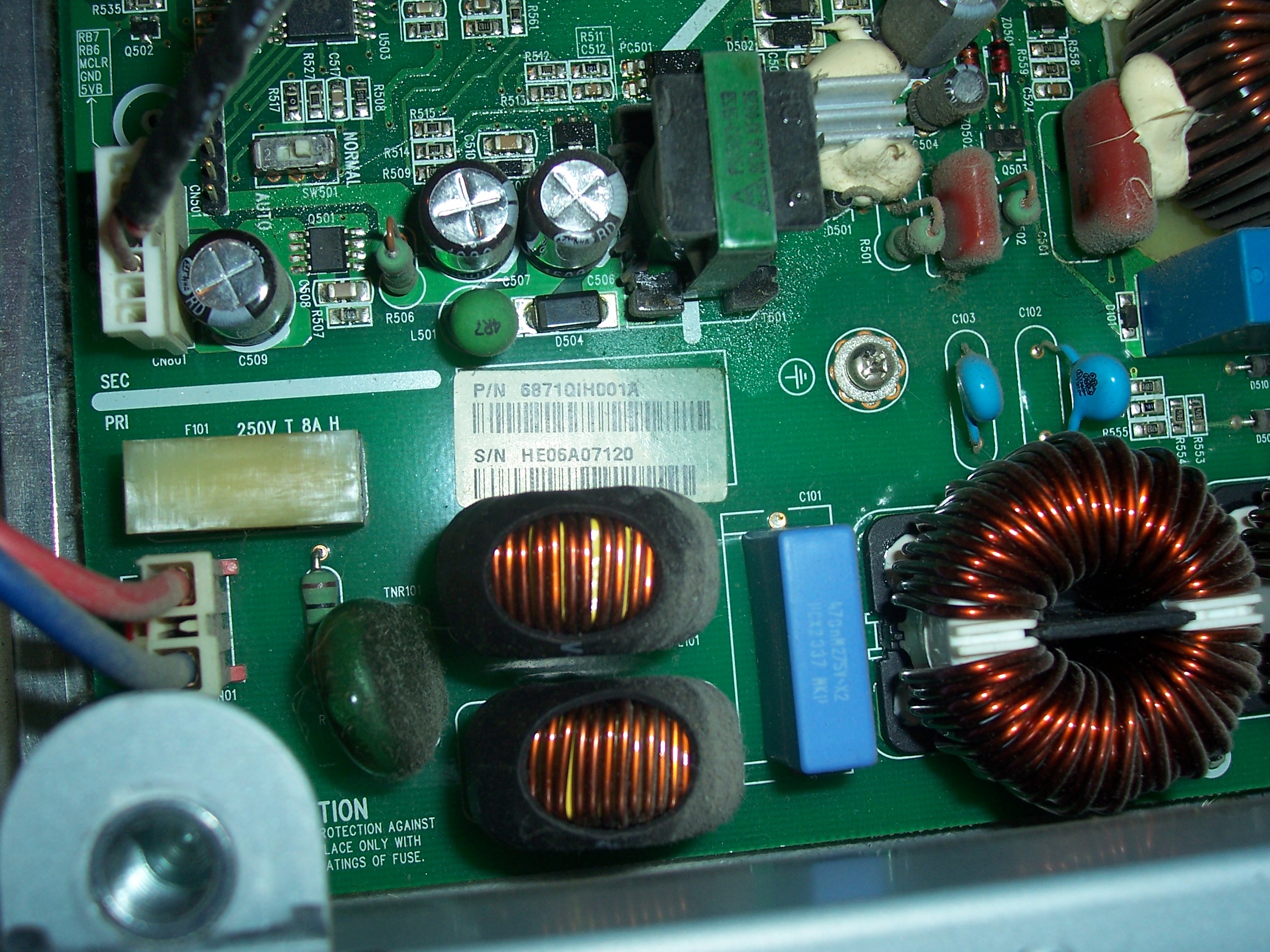

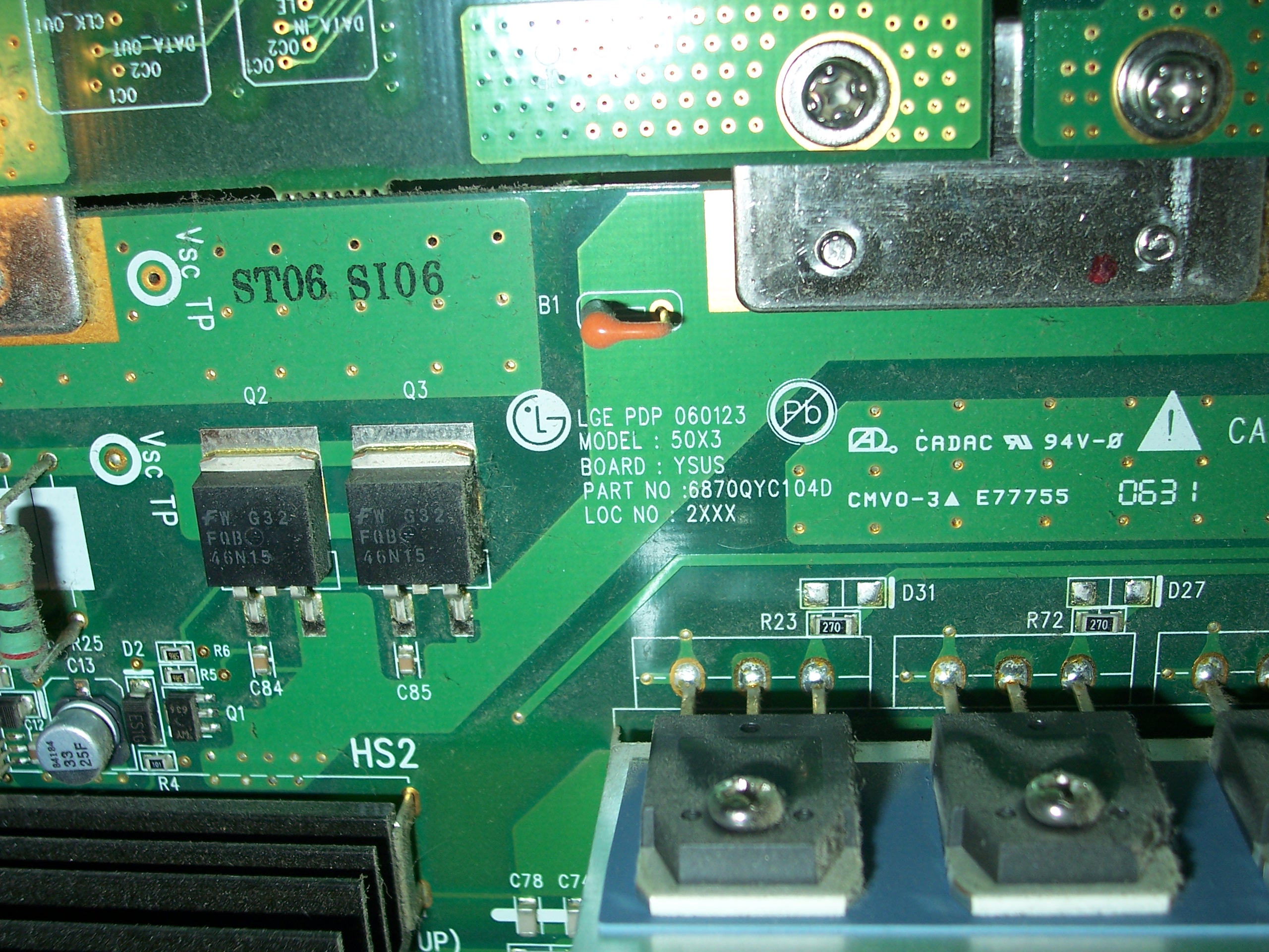

                              So I disconnected the bottom ybuffer board (they say ydriver on them) and powered it up. Still flashes just the top half. So I guess that means they are both toast then.
                              I looked and looked but didn't see any obviously bad caps.
                              So I guess I'll be ordering upper and lower boards. Should I get a ysus as well?
                              Pictures attached of all boards.

                                And the power supply fuses checked good as well as the two I could find on the ysus board.
