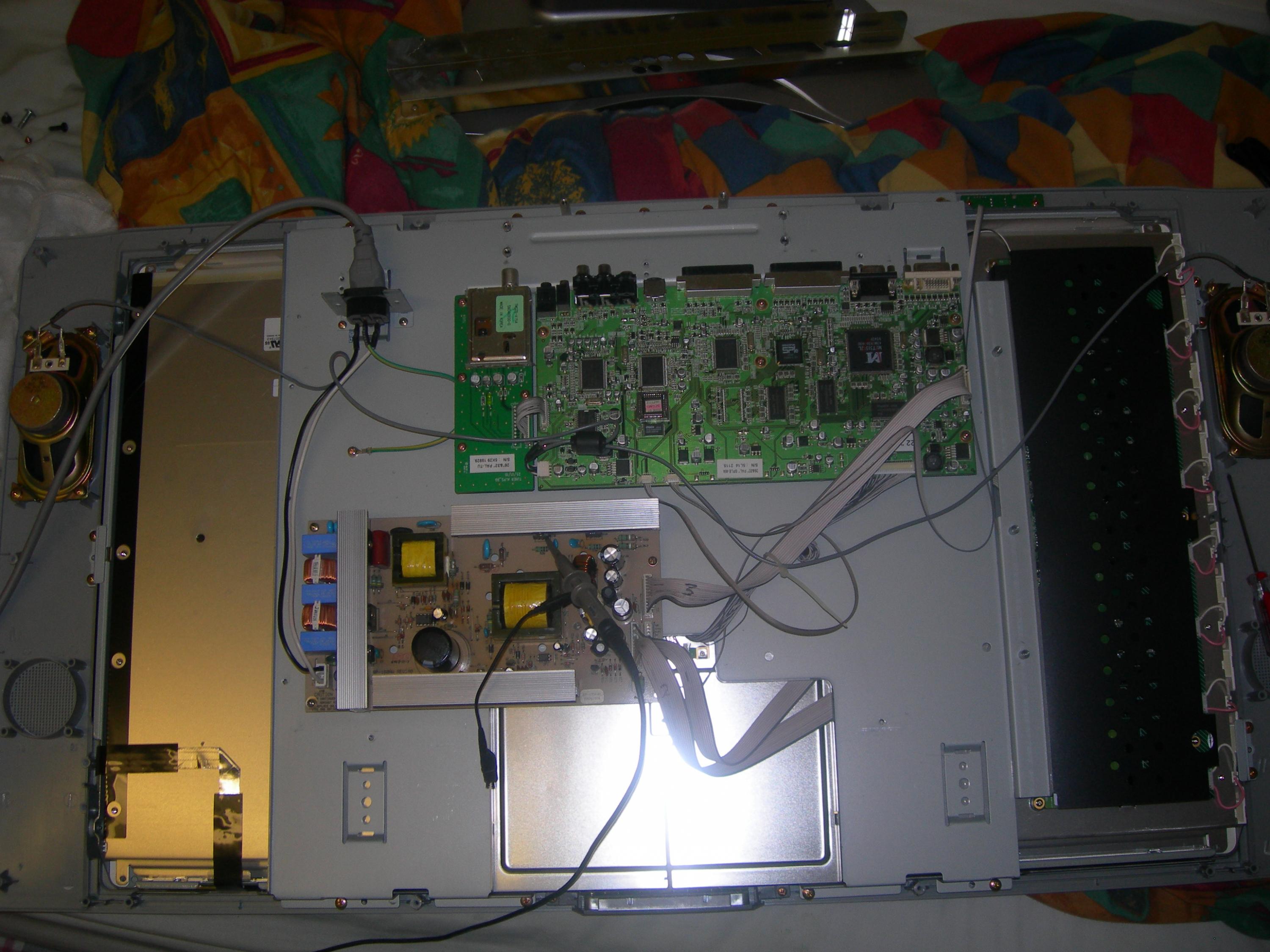

    Picked this up for a tenner, it has had some work done on it. Rails, 12V and 24V, are completely dead. This TV doesn't use a standby power supply, it keeps the 12V and 24V on all the time, it just uses the ON/OFF on the inverter to turn the TV off... seems a little dodgy, ya think?

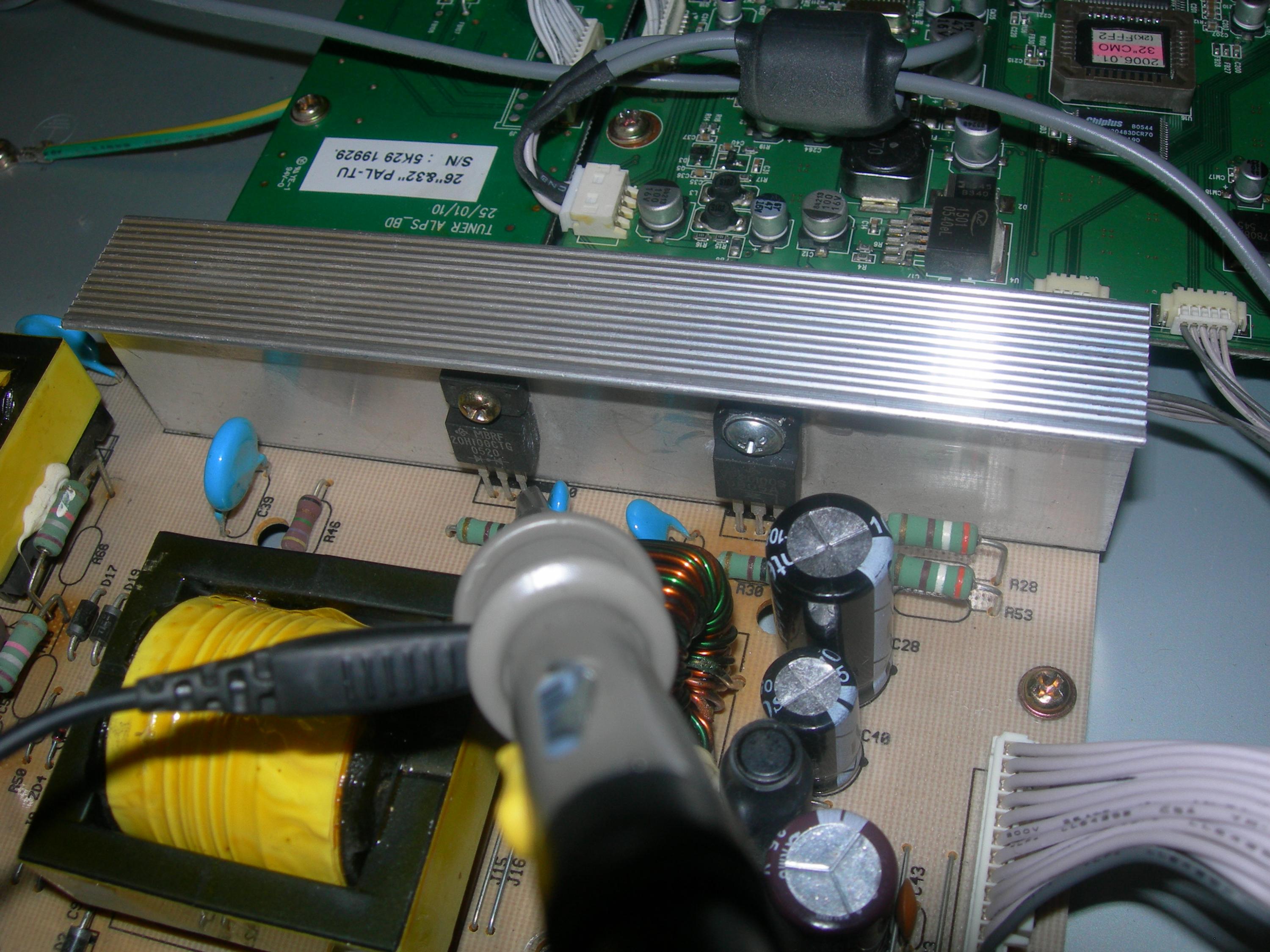

    Problem is -- won't power up at all. When I plug it in, I can hear a faint ticking sound; I also notice one of the diodes has got very hot as the board is discoloured around it. I'm putting two and two together and thinking shorted diode.

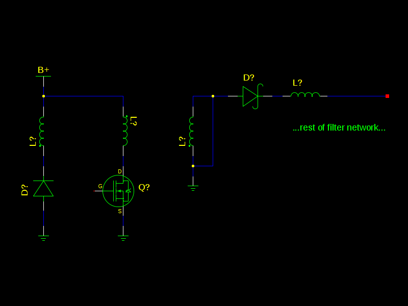

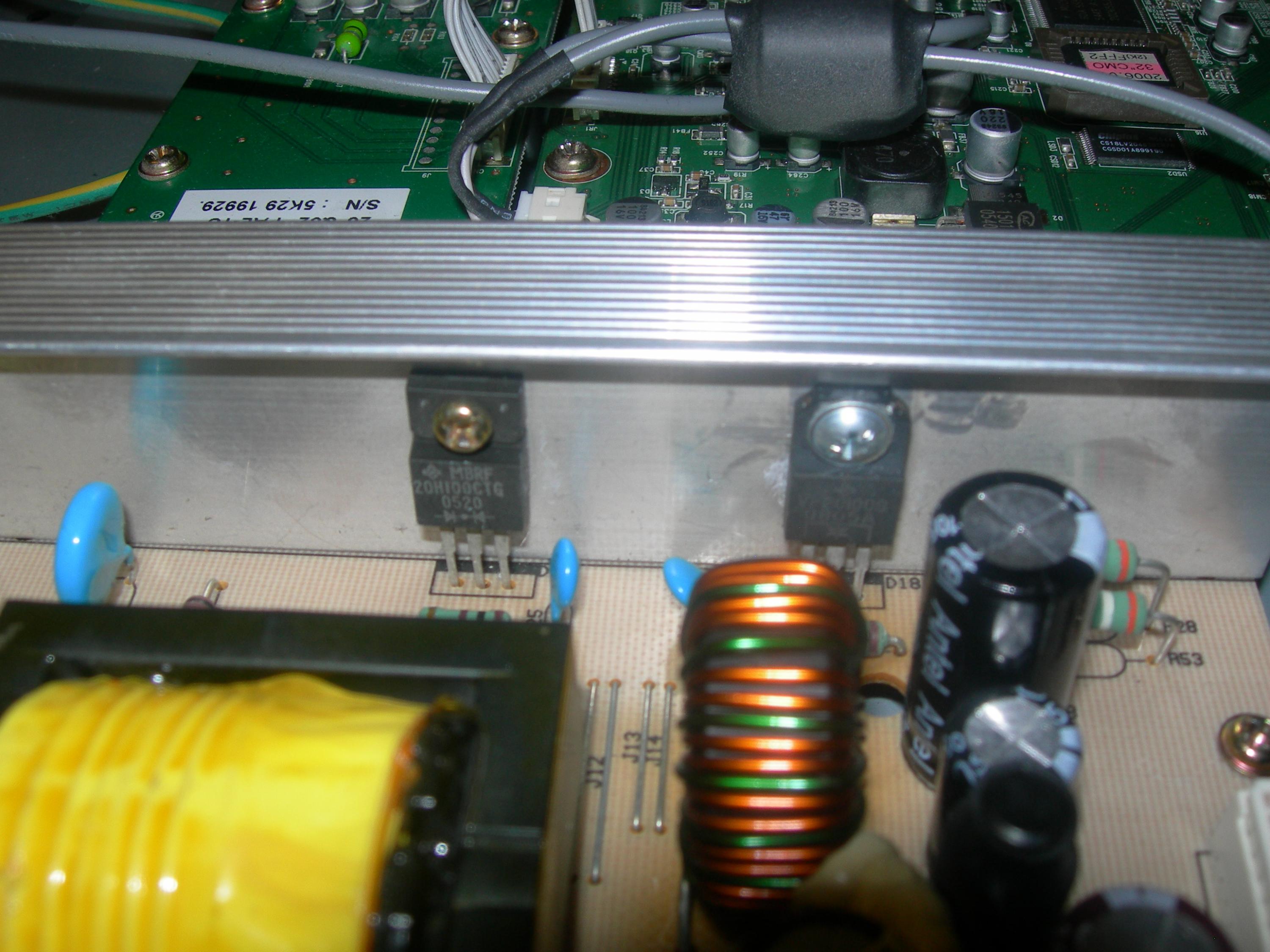

    None of the diodes are shorted... damn, I think. I notice both have been replaced previously. So, I take a closer look. The topology is a forward converter. It looks like this:

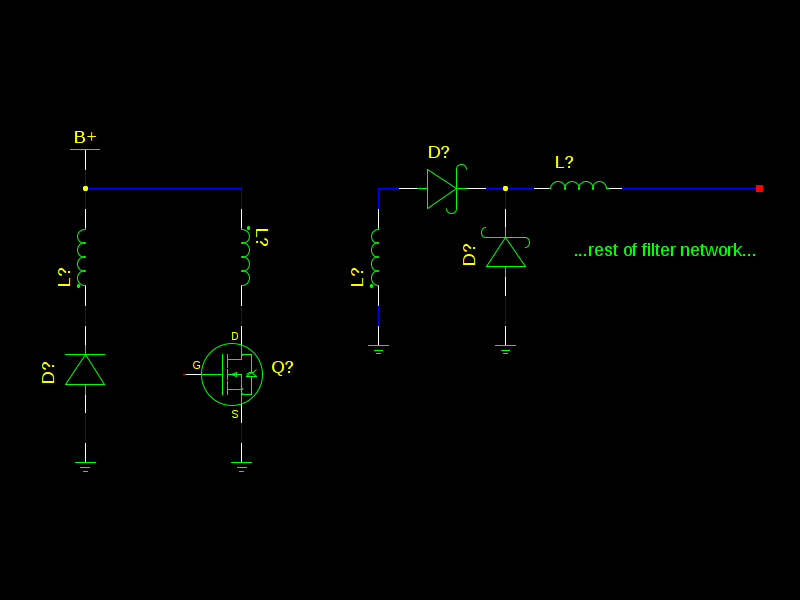

    Now, one diode has been replaced with a VF20100SG -- pretty ancient device from when TI used to make silicon. This device wasn't designed for a forward converter; it's for a flyback. It's got one diode instead of two inside the devicel; the outer legs are tied to the anode. The effective circuit now becomes.
    See the problem? One secondary has a dead short across it! Hence, of course, the PSU doesn't work.
    I will replace this diode and hope this is all that has been messed with.

      Also, there was very little thermal paste on the replacement diode and the guy used an insulated package... great, until you realise the combination means a rapidly overheating diode if it did work.
