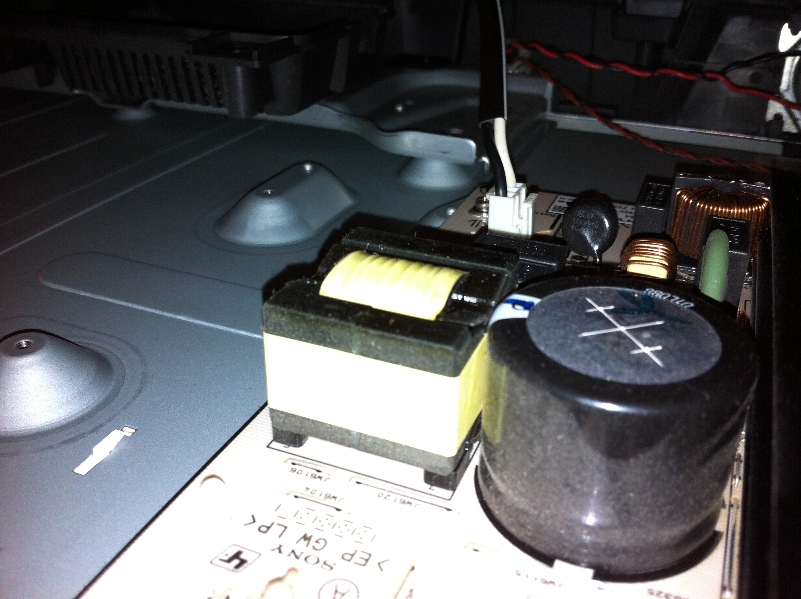

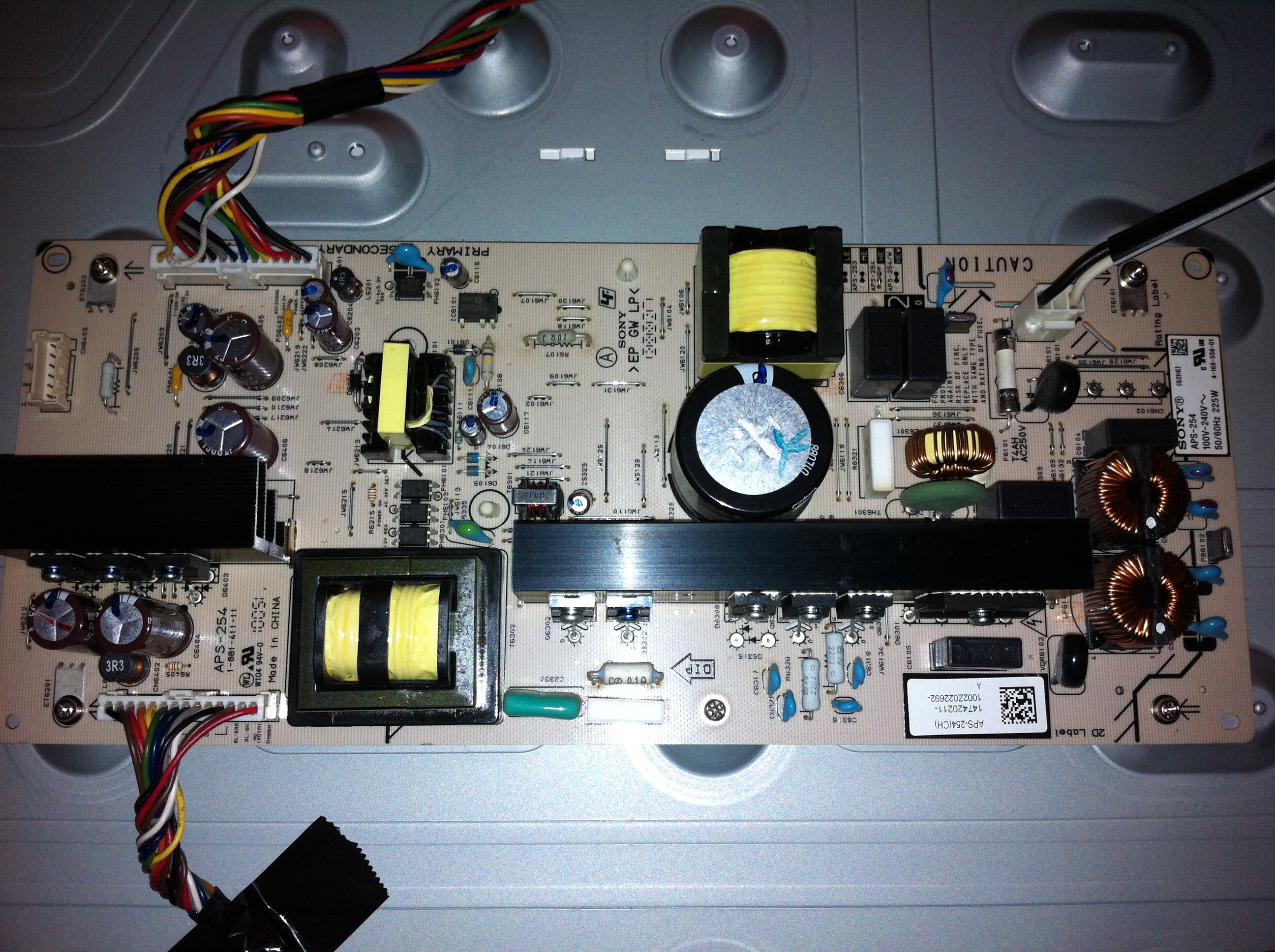

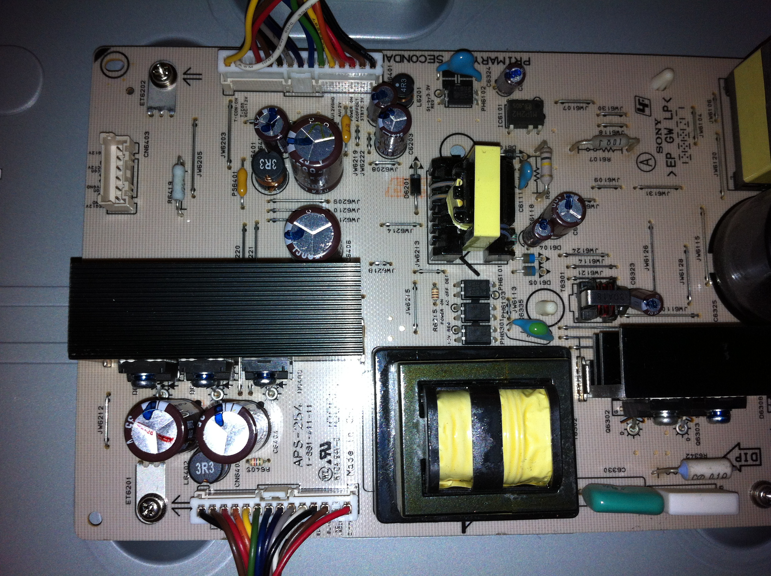

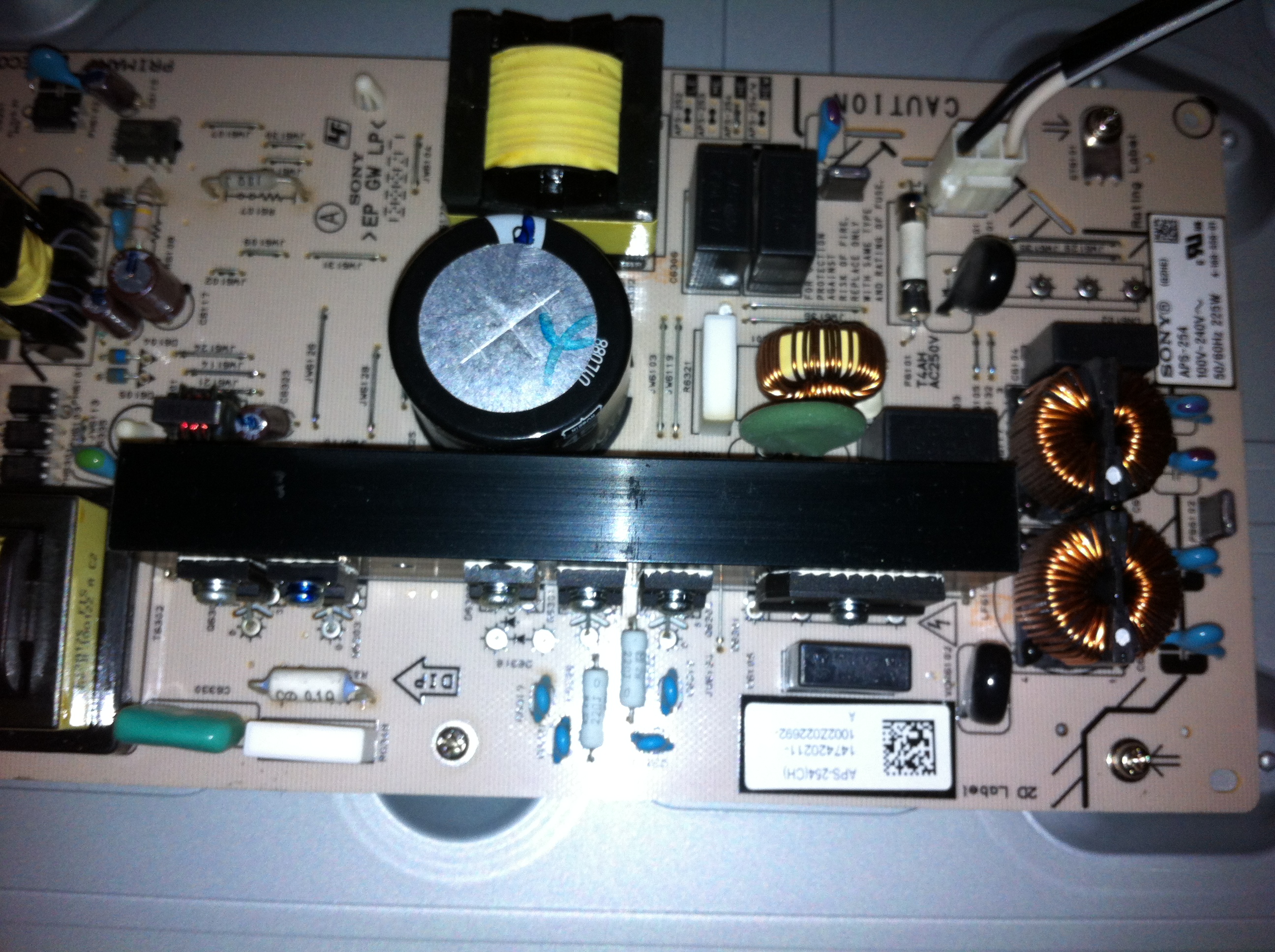

    So I have a 40" Sony KDL-40EX400 that was struck by lightning this summer. The unit was on and in use when the power went out. I'm getting absolutely no power to the unit, though I'm lacking a multimeter at the moment. None of the capacitors look blown, except maybe the rather large one. It's flat on top, but not flat/concave like all of the smaller ones.

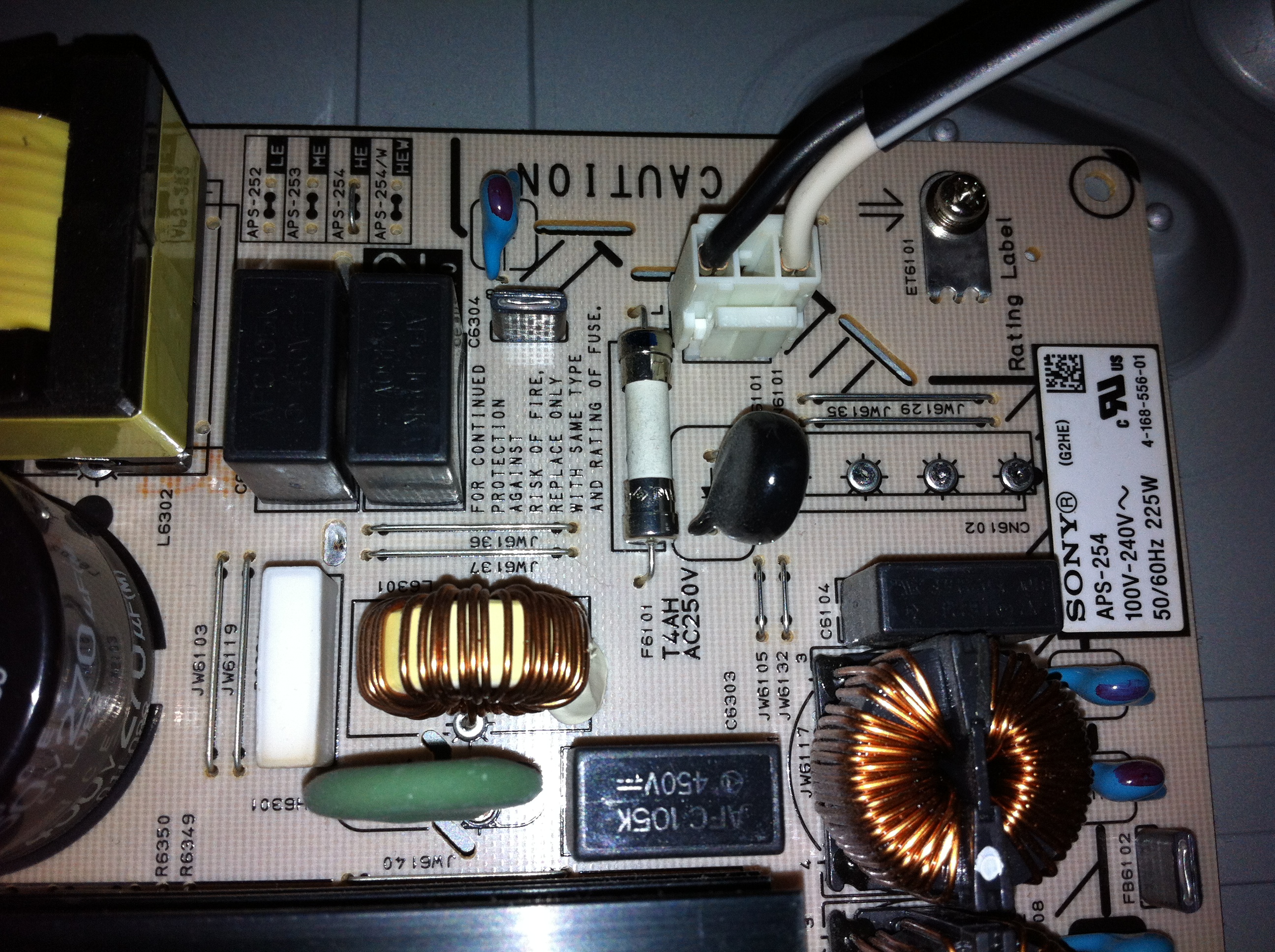

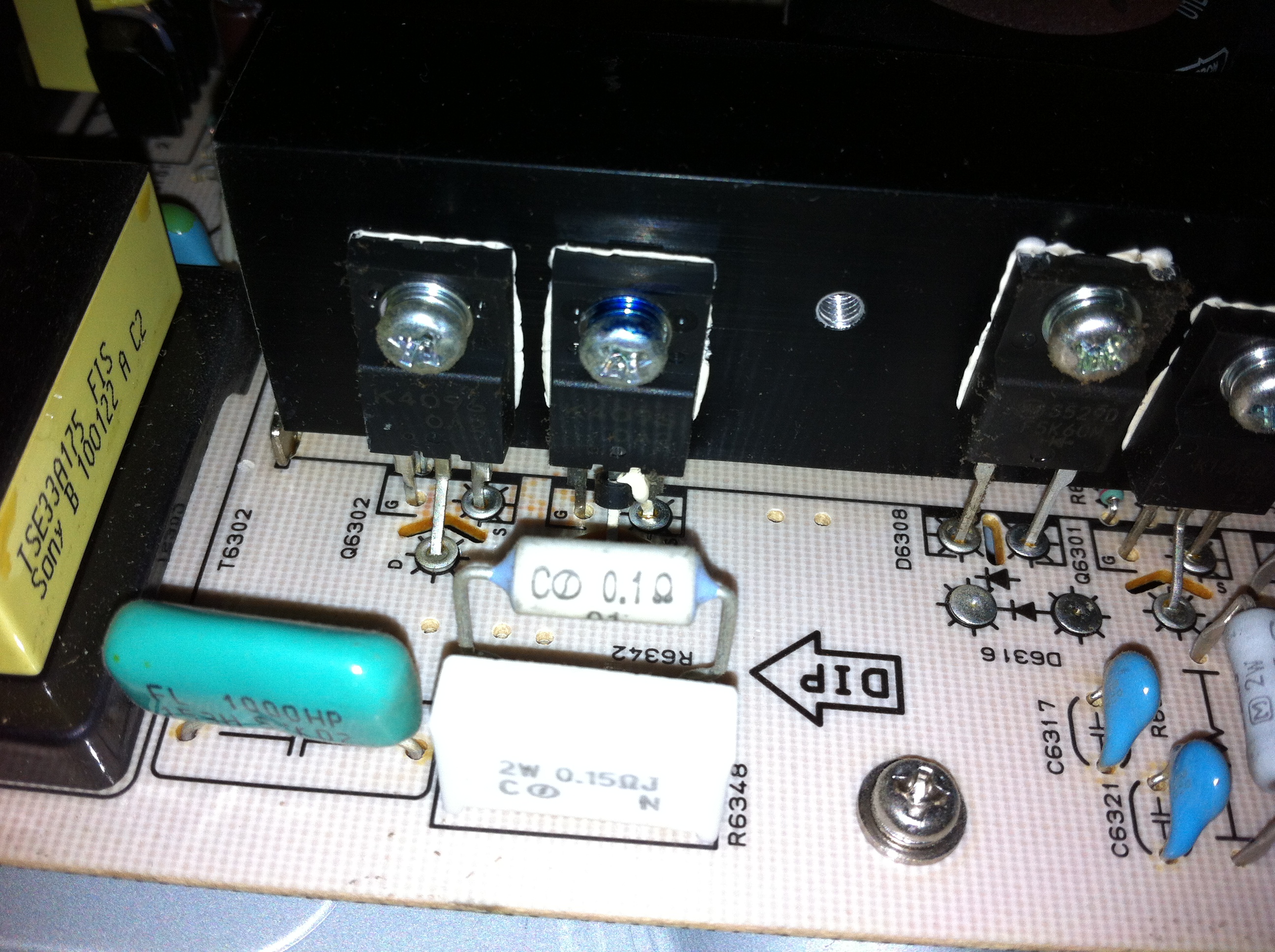

    I didn't notice this before I uploaded the photos, but around the base of some of the components (resistors, maybe?) there seems to be some singed yellow areas. For all I know the entire unit is shot. I was hoping you guys could tell me what tends to blow in situations like this.
    I have some previous experience replacing components, since I do have a couple of arcade machines, and I was able to get another tv up and running thanks to the advice here at the forum. Any help would be appreciated.
    The most likely suspects.
    1) The fuse may be open.
    2) The bridge rectifier may be shorted.
    3) The power mosfet may be shorted.

      The yellowing is just from heat. You'll notice the resistors are 3-5w probably so they'll tend to dissipate some heat.
      It also looks like you have fuses near your output rails so check those as well on top of the main AC fuse as retiredcaps advised.
