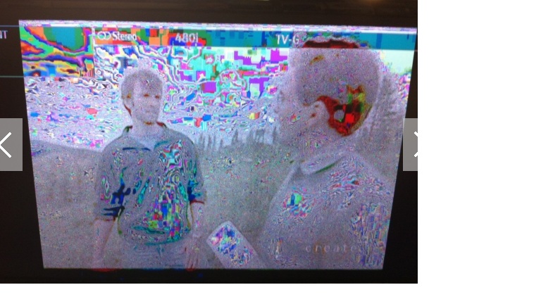

      Does this look like a bad main board in a LCD set? He said he tried it with two different tcon boards.
      • drpj23
        • May 2012
        • 528
        Re: How likely is a cracked panel to short out boards?
        I would call main on that, the video processing is getting a little screwy.
        Especially if 2 TCONs didn't work.
                  That is not main board, but instead a Panel Config problem, you have taken the board from a TV with one panel and it has been put with the wrong panel. It may be possible to configure the main board to use a different panel from the service menu.
                    So you think this board is safe to sell again?
                      Yes. But the owner may be able to fix it by accessing the service menu and changing the panel configuration.
                          Next time note down the panel model # on the back of the chassis and note this with the ebay auction. (Only for main/digital video boards; doesn't apply for most other boards.)
                            Buyer admits his tv was 32" while the board came from a 46". Does this apply to all brands of LCDs? What about plasmas?
                              Yes, His board might have the same "board" numbers but there are some boards that have a bar code sticker where the actual part number is.
                              What about plasmas?
                              Same thing as above. The X & Y sustains, buffers ect. need to have what panel was in the broken television.
                              Use shop jimmys site to see if the board you are selling is compatible with other tvs. Alot of auctions i see the sellers just cut and paste the info directly.
                              Also, after you get the board back and refund the money you can cancel the transaction so you'll get the final value fees credited back to your account.

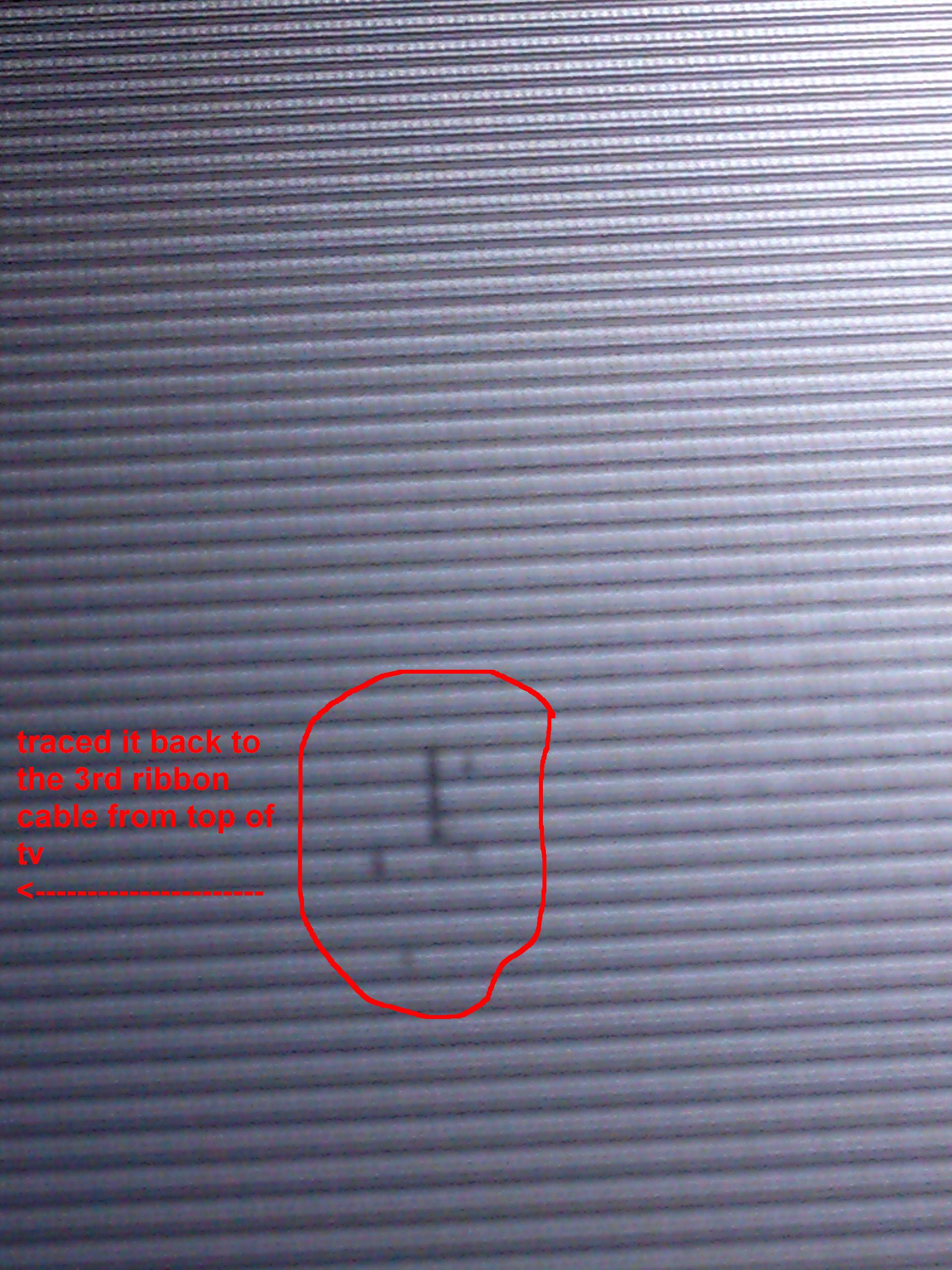

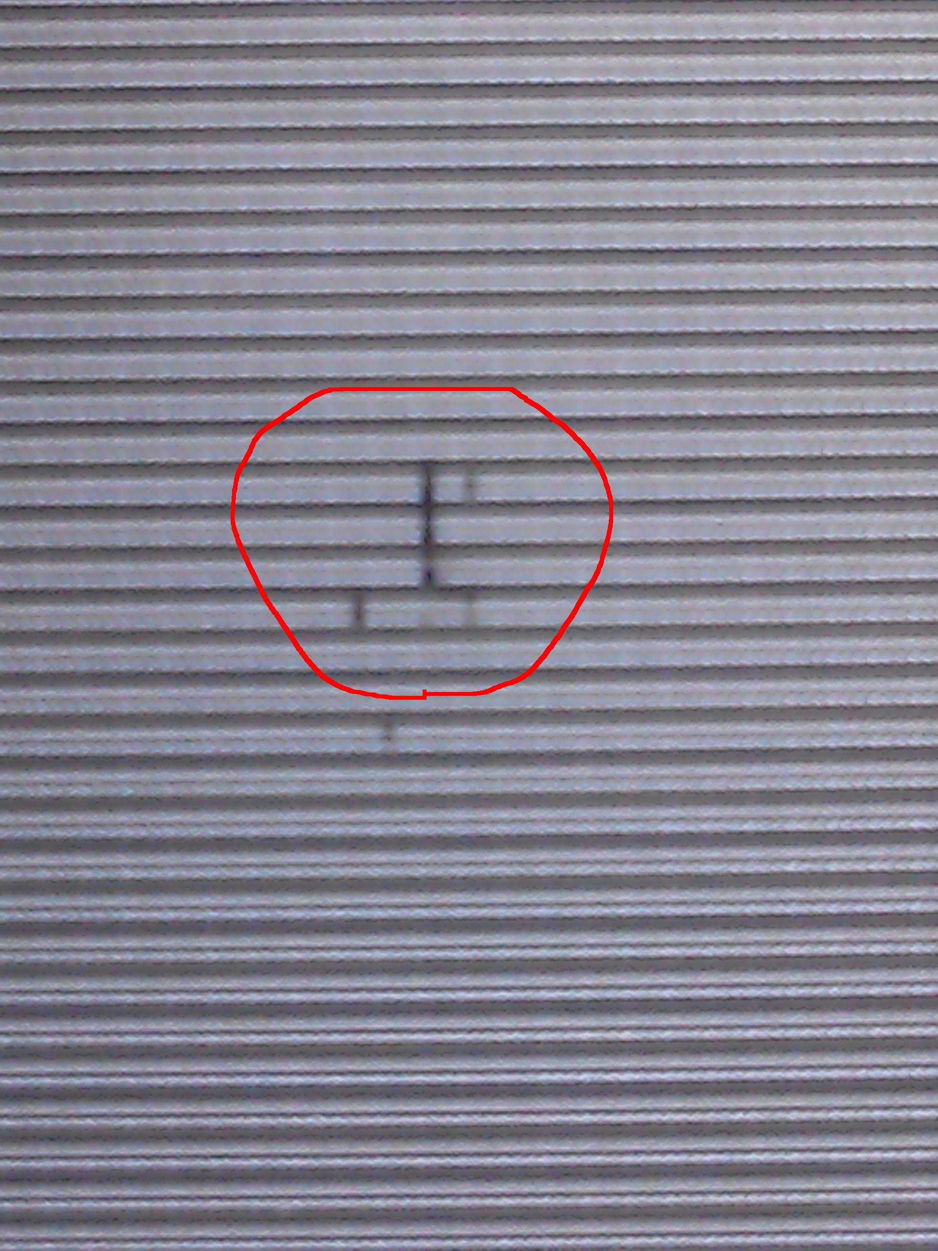

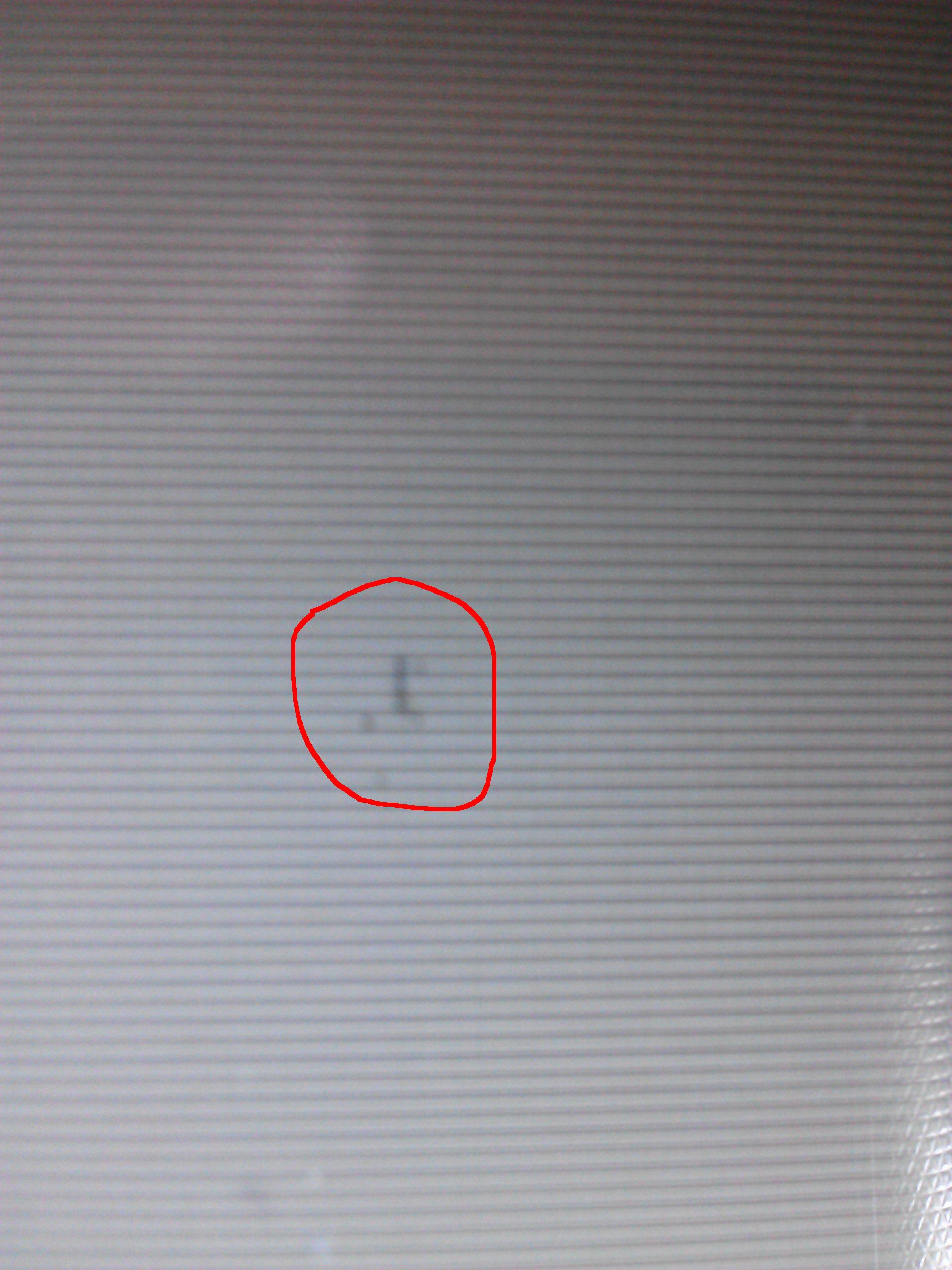

                                      this is what i found. thanks for the tip.
                                        Looks like dirt to me...
