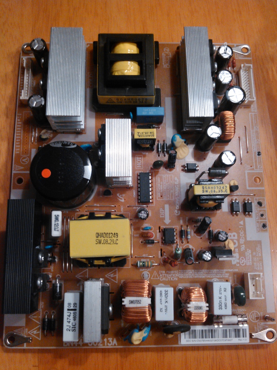

    Hi!
    Have to say first that i'm a newbie and have been fixing electronics very randomly.
    My friend gave me this tv to see if it could be repaired with low cost. I have measured every thing from the psu board that I could imagine would be a problem but found zero faults.

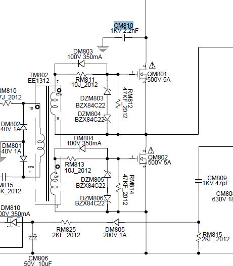

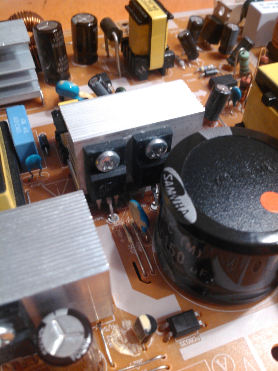

    Symptoms are that when tv is on standby (red light on) I press power button it starts to blink red light 5 times and makes this sound from cap CM810.
    There no picture or anything. If I don't cut the power it will go like this forever.
    Any ideas what to look for ? Could that capacitor CM810 be BAD or is this sound a symptom that is caused by something else ?

        Hi - looks like no-one knows or your thread gets missed- perhaps due to time differences. Anyway I know very little about tvs but if we get some dialogue going others may join in. I am assuming you have a multimeter and soldering equipment?
        As you have not given the actual results of any of the tests you have done I will just ignore them.
        As you seem to have the manual does it say what the flash code means?.
        Are you sure the sound is from the cap ( Is it the small blue ceramic one and have you taken some glue off it?) If you have check it is not physically damaged - ceramic cracked on the legs?
        Could the sound be from the transistor on the heatsink nearby?
        Did the fault just start or was it brought on by an event - power cut lightening strike.

          That cap 2.2nF (0.0022UF) 1000V, is a filter cap to take care of the high frequency generating by the two MOSFET swtiching circuit for the 24vdc power supply for the backlghts inverter.
          Remove the cable between the inverter board and the power supply board and see if you can get the TV to come on.
          Do you also have about 390~400vdc (when TV is off it should have about 325V, when TV is on it should have 390~400vdc (pfc kicks on)) on that large DC filter cap C803?
          Be careful since you are working in the HOT PRIMARY side of the circuits.

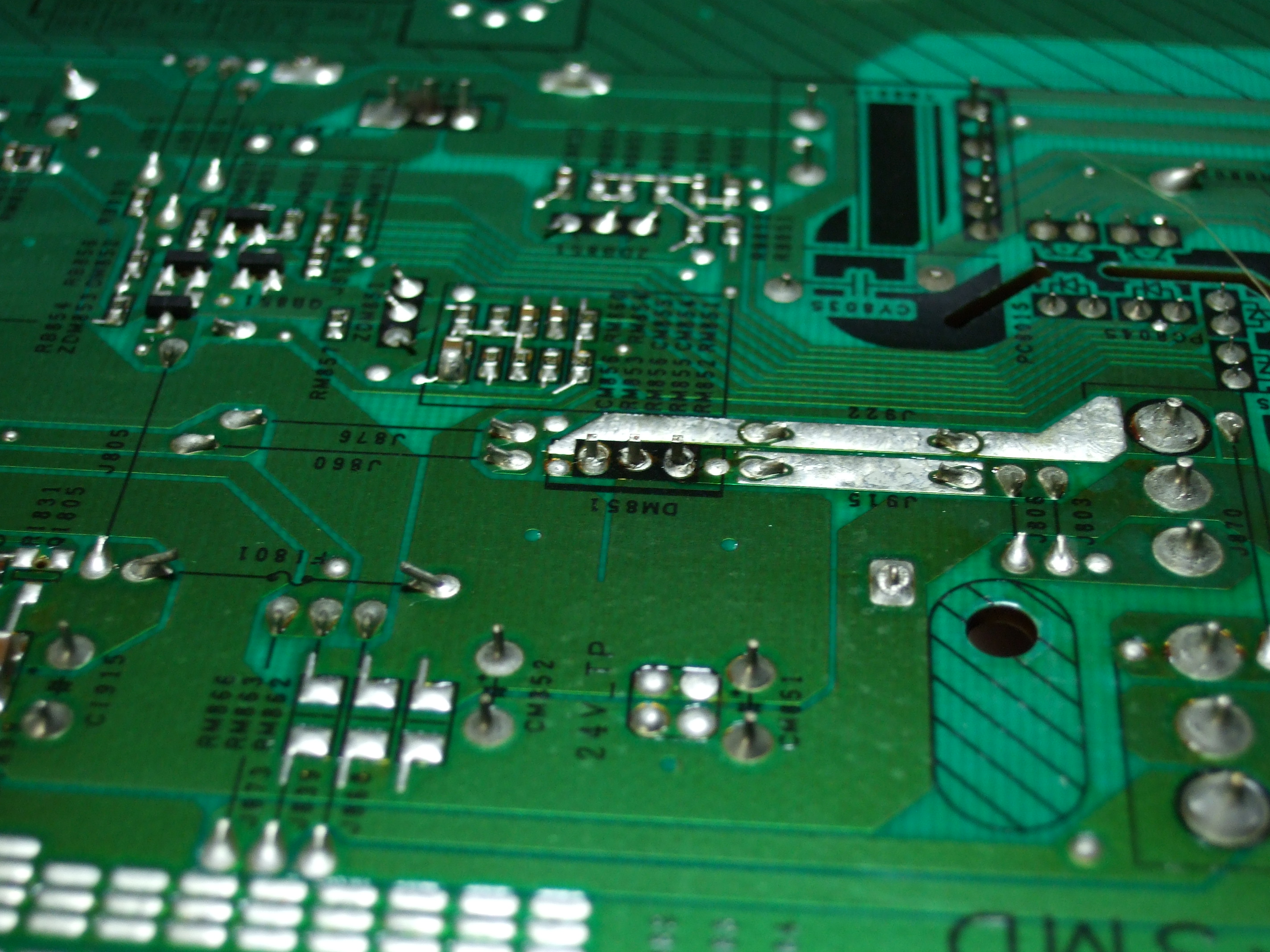

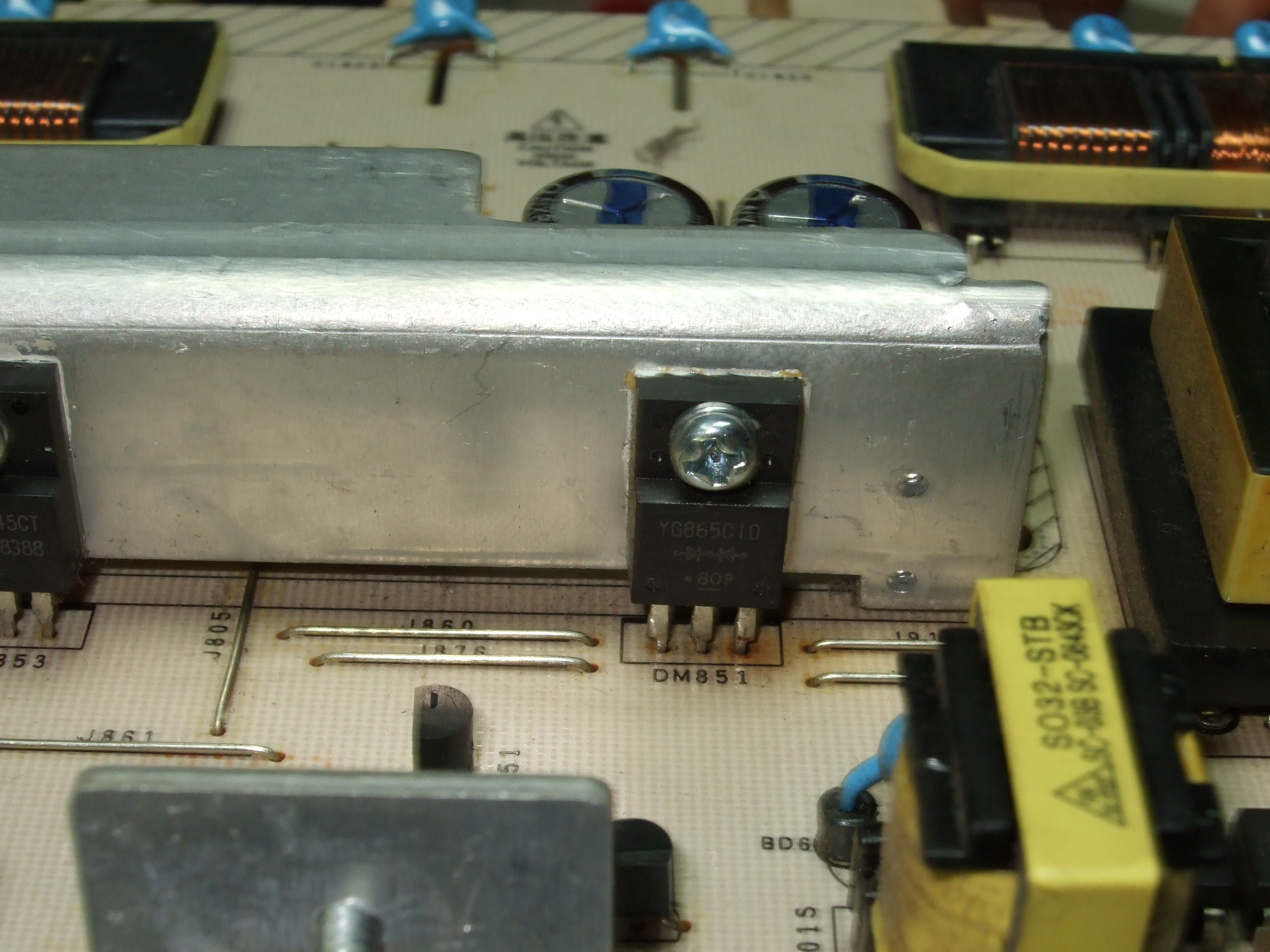

                    Re: Samsung LE32A336 bad PSU (maybe)
                    Yes it rebooted endlessly.
                    I called a friend and he identified what must be the problem: dry joints
                    When the tv heats the solder no longer makes good connection and goes out.
                    here are some pictures. tested the tv for 4,5 hours and still on...
                      Remember if you are testing with the back off it wont get as hot as with it on.
                      • Napalm
                        • Mar 2013
                        • 20
                        • Portugal
                        Ok I tested it before without the back on.
                        Now I put the back, and it is working so far for 2 hours...
