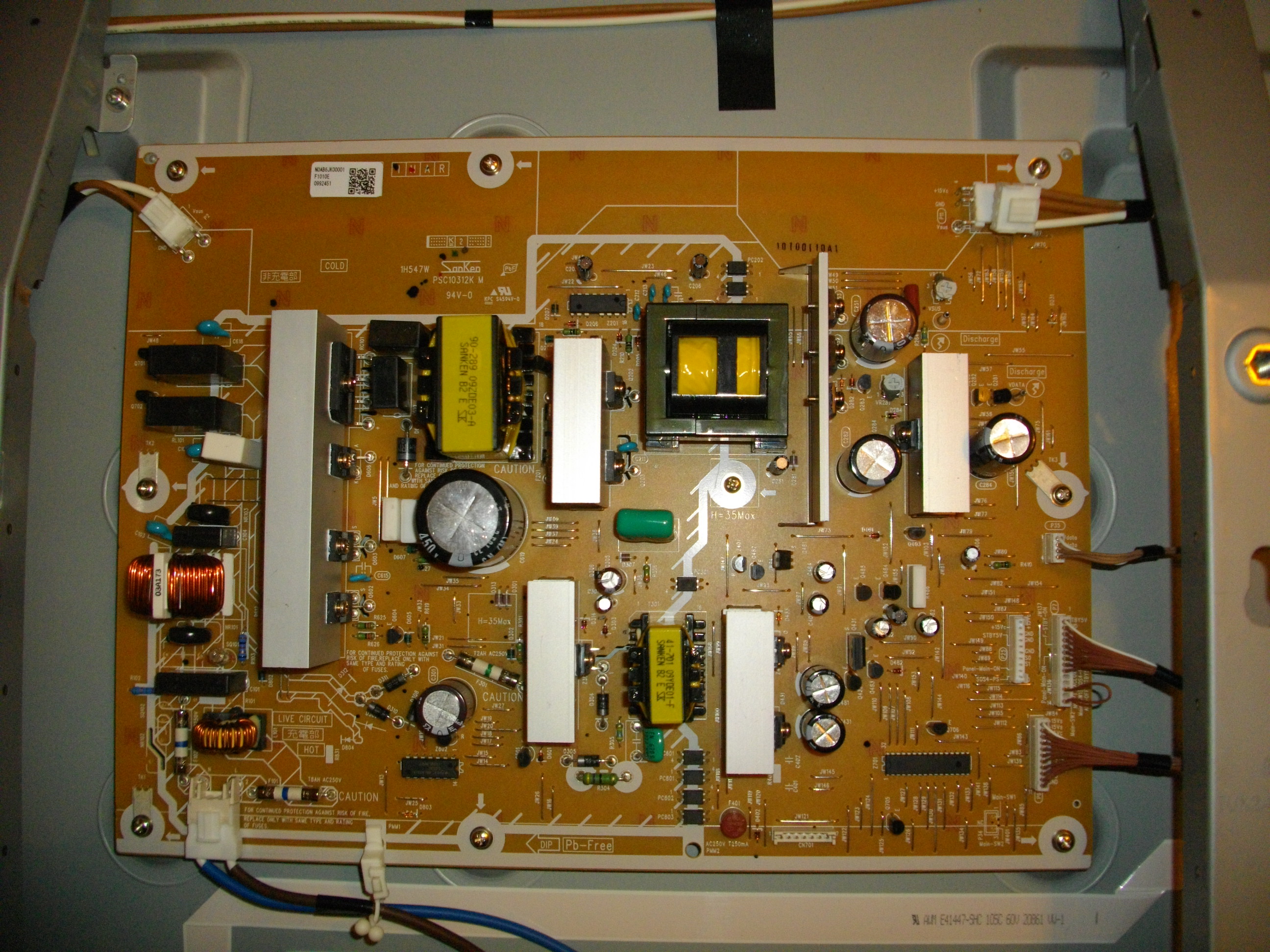

      I checked v at all the optos all have 5v on the secondary side but ! has 11v
      I will take good pics of the PS

        #43
        Re: Panasonic TC-P42X2
        Had to use flash, But everything is visible, Let me know if you want to see the foil side.
        Optical closest to the center was 10v on the upper right leg.
          #44
          So, if you CAREFULLY tweak the Vsus adjust pot, does Vsus change?
          I had a plasma TV which would display a faint image down to 130V on the Vsus, so I think sometimes else is up, but there is the possibility if it is designed for a high ~210V it might not show anything on 165V. Here's where you may need to use that scope .

            #45
            see that is the thing, the PS treats the SN as a dead short when it is not. with SN plugged in and for the brief moment that the vsus powers up I measure about 1v then the psu shuts down the vsus relay.
              #46
              Ah, that's where it gets tricky, because this set doesn't have removable buffers. But you can still tweak Vsus with them disconnected.
