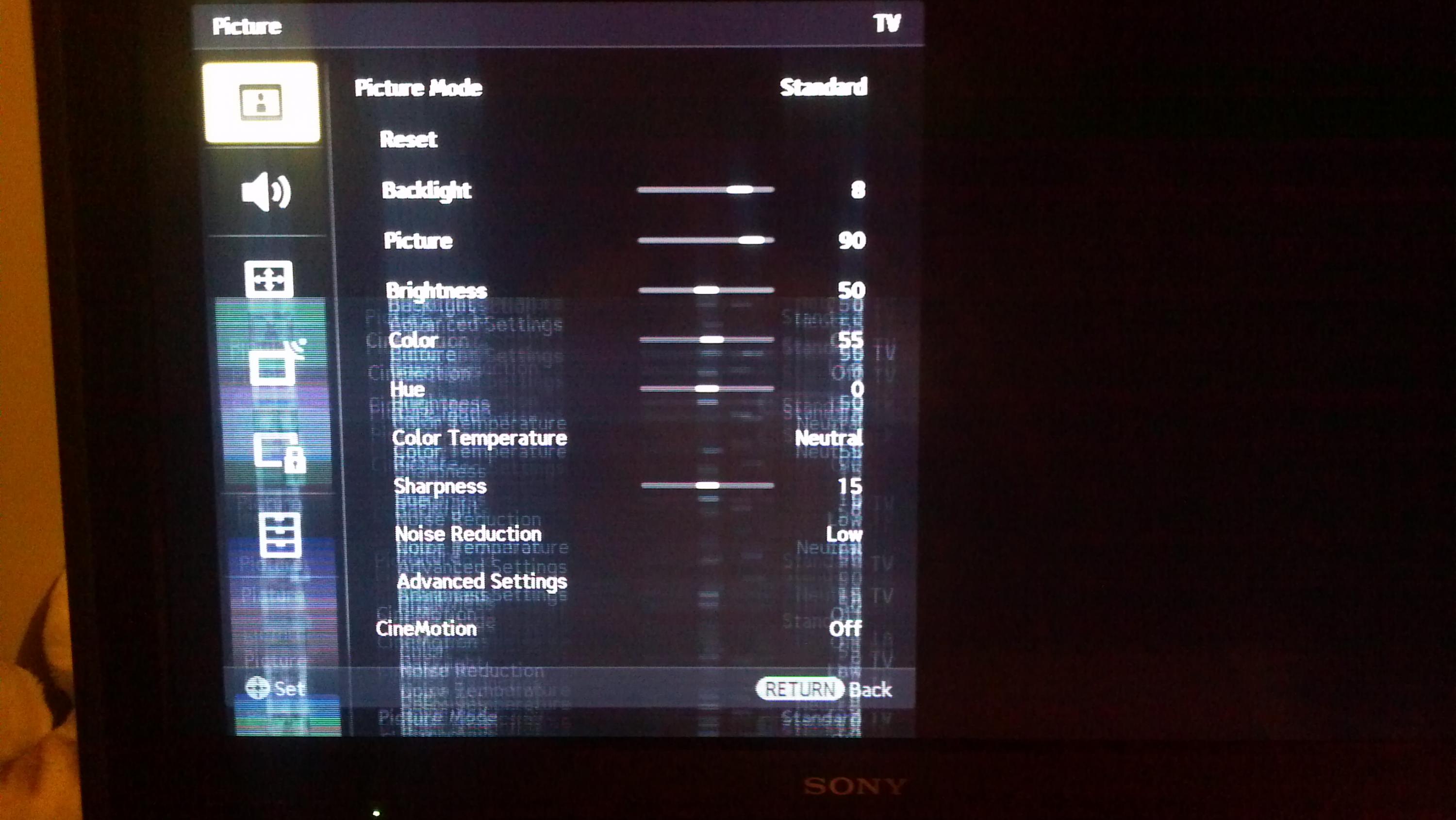

    I'm looking at buying a 32" sony bravia lcd with some overlay from top to bottom. (Less than a year old)
    What usually causes this, and is it worth buying for $40?

      i havent bought it yet. was just wondering if its worth buying.
      all he said was, it has picture but there is overlay from the top, on the bottom

          i assume picture image overlay, but not sure.
          i think the top few inches of picture shows up overlayed(on top) on the screen, at the bottom.
          i will see if he can send me a pic of tv when it is on.

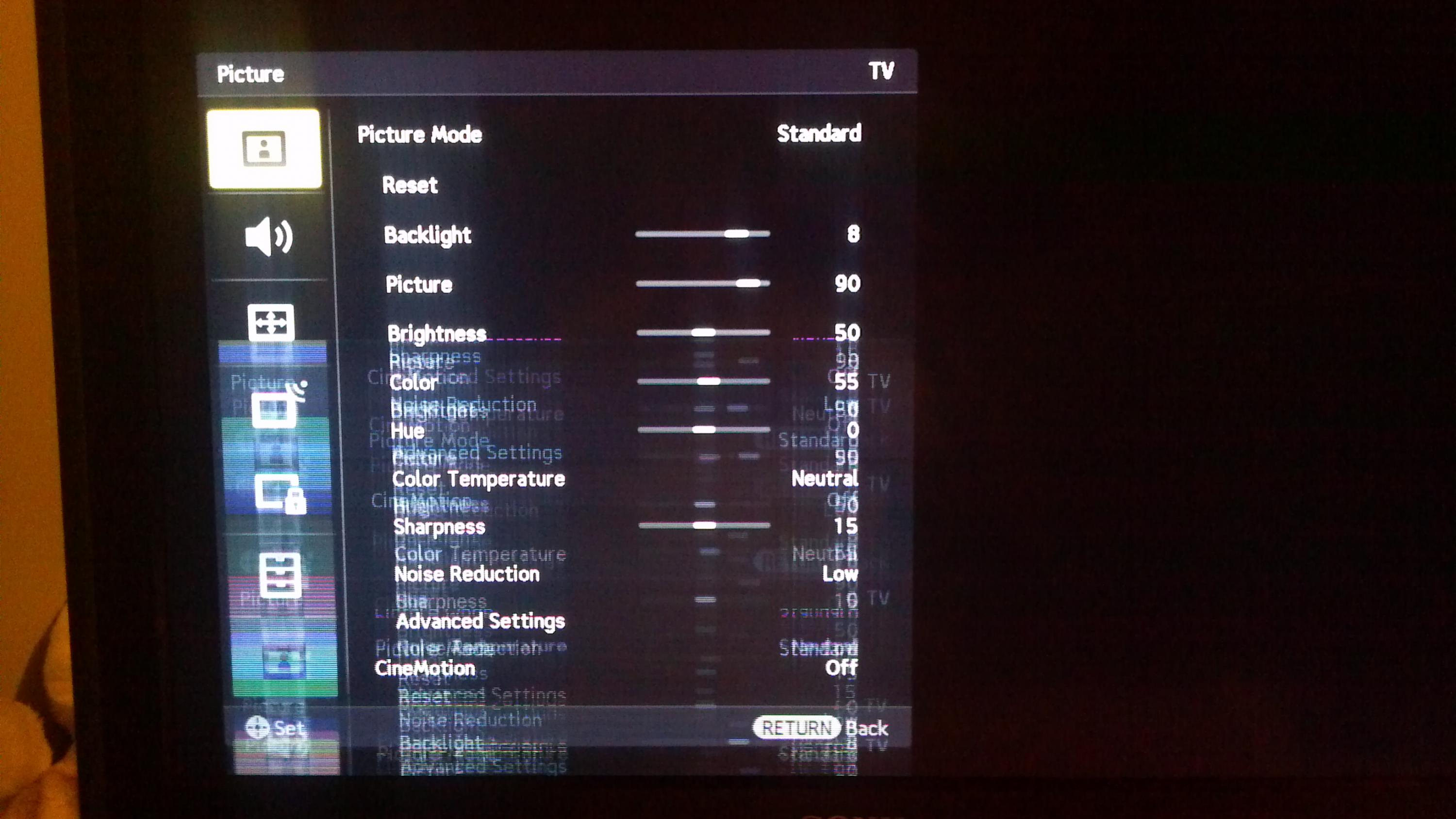

            he said it was flickering when he took pics.

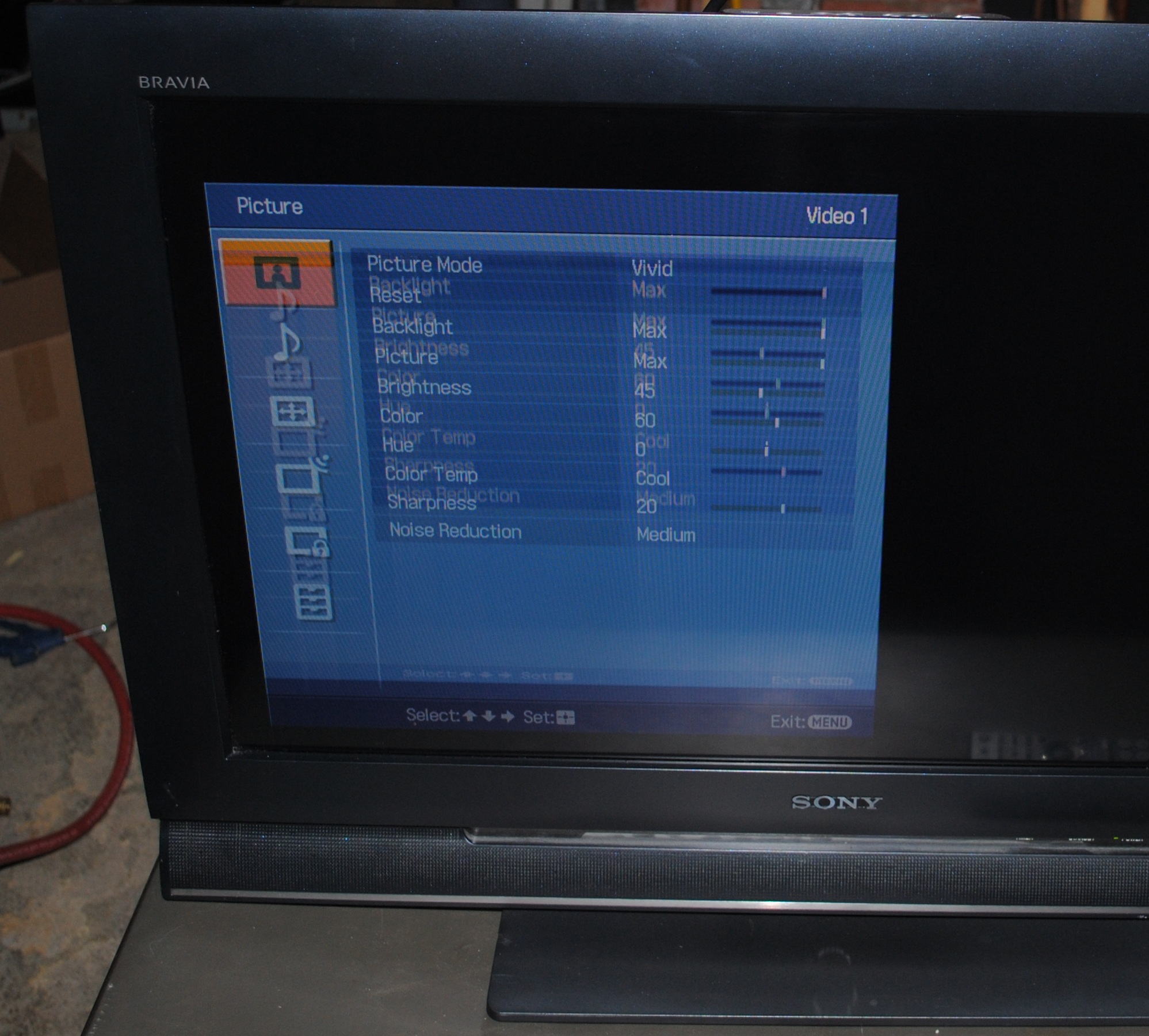

              Re: sony bravia overlay
              Not sure if the one you are looking at has the same problem as the one I reseated the T-CON connector or not, but it looks similar.
              http://s807.photobucket.com/albums/y...t=DSC02043.jpg
              After reseating the cable:
              http://s807.photobucket.com/albums/y...t=DSC02066.jpg
                it looks like the same problem but i see some color in my pics on left side.
                i wish i could look inside before buying.
                  Beware. I've run into this. There is a 75% chance the lcd screen is bad.
                    Yeah, that's a bad screen if I've ever seen it. Fixable sometimes, but tricky.
                      Don't buy it unless the boards are worth a fair amount of money. The panel is defective.

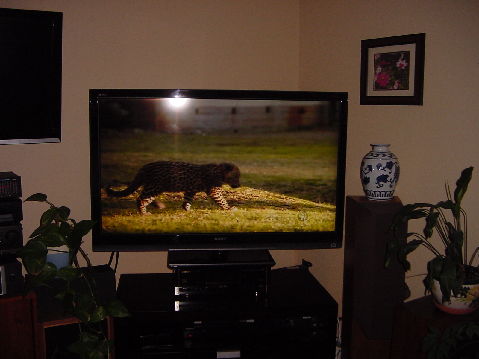

                        Well, the 52" Sony came in today with the pictures look just like in post 6.
                        I have a spare T-CON from another SONY with cracked screen to try out on this one,
                        Yep, the screen is bad.
                        This KDL-52VL150 is made in 2009.
                        http://s807.photobucket.com/albums/y...20KDL-52VL150/
                        So I am saving the boards for the next repair.
                            Follow-up: I got it fixed, took the panel apart and use the rubber pad on the bonding tabs on the left top of the panel, been watching it everyday so far so good. Now I am looking for another one with the same problem, easy fix for $50 TV.
