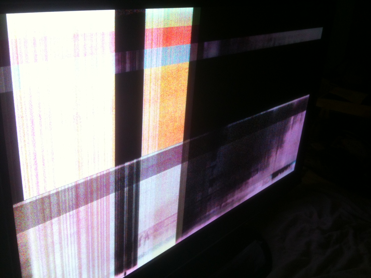

    Ok, so I finally figured out that is was the SD board that was giving me the 7 blinking lights. I got a new one and installed it and now I get this on my display?? Could this mean my panel is bad or something? Or something else I can look for causing it??

    It looks like D board or buffers to me. If SD died, SU could have too...

      Well, thru my dumbness I replaced the SU already as well. Bc I thought that was the cause at first. So the D board or buffer boards?
        Re: Panasonic TC-P50G15
        The buffers I refer to are SU/SD. So I think it might be D board. On this TV I believe the A and D are integrated together so it is one board to replace.
        Did TV just die, or did you pick it up broken?
        If it just died, it is far more likely you got a faulty SU. Someone else on this forum had a similar problem with an LG, he got sold a faulty one, and found that it had a similar fault to his original failure. Try with your original SU. I know a bad SU can cause the whole screen to mess up, whereas a bad SD usually only messes up the bottom half.

          Yea I got it from a buddy of mine who said I could have it if I fixed it.
          I just replaced the SU board back with the original and still same picture on screen. Is there a way to test the A board?

            Originally I had 7 blinking red lights. I isolated most boards such as, SS,SC,SU,SD and discovered that the SD board was the cause of the 7 blinking lights. Replaced that and TV turns on but with all that crap on the screen. Hope that might help.

              I don't know of a way to test the A/D board, sorry. I cannot be 100% as Panasonic TVs are hard to diagnose sometimes.

                Well, I think my adventure is done for now. everywhere I look the D board is out of stock. Thanks for your time.
