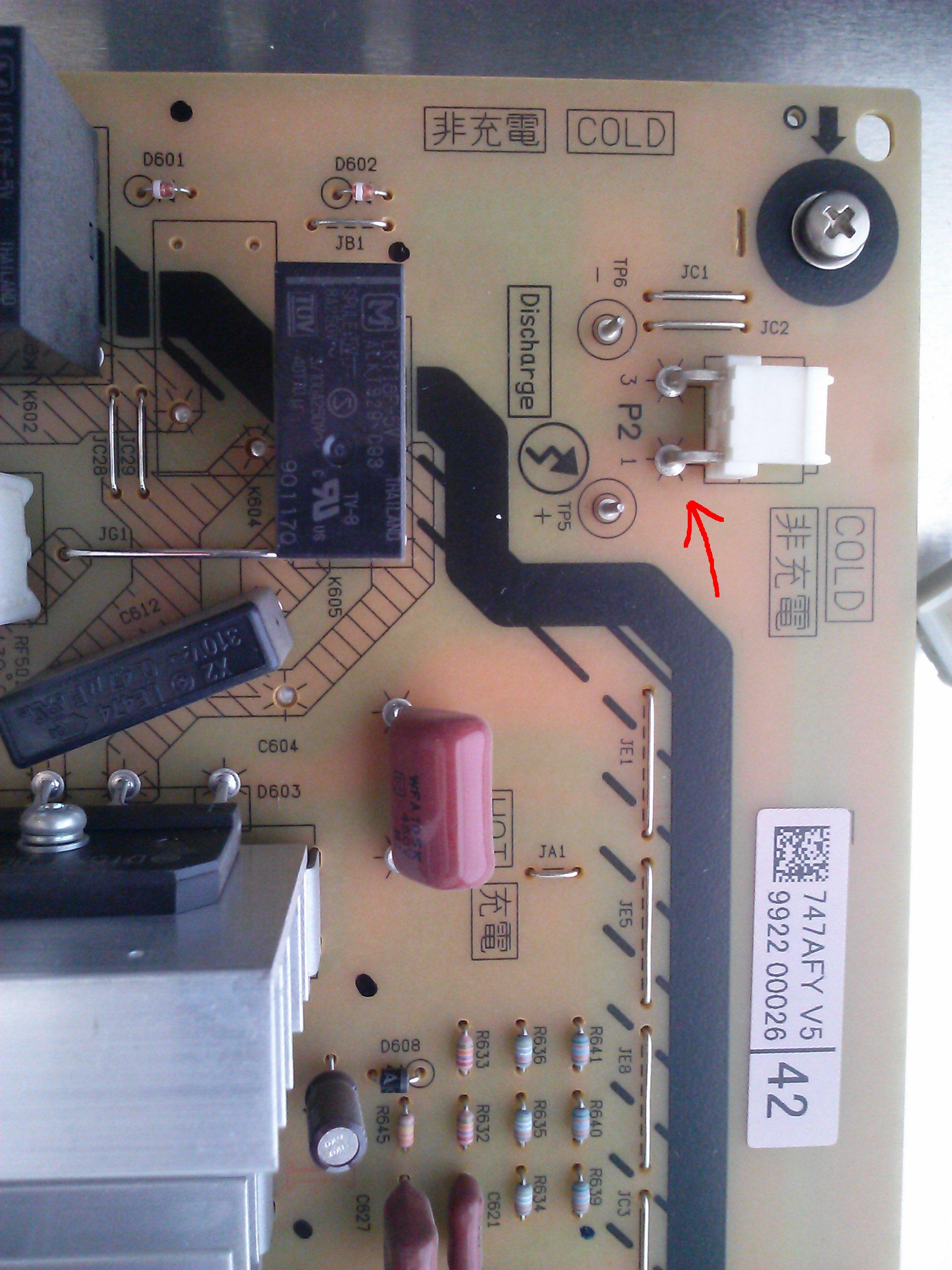

                    should there be power at sc2? blue and white wires going into sc board from power board?
                      Re: Panasonic Plasma TC-P42U1 my first plasma
                      Yes, you can repair TVs without qualification in the UK. In the US, I am not certain.
                      You should have around 200V at SC2.

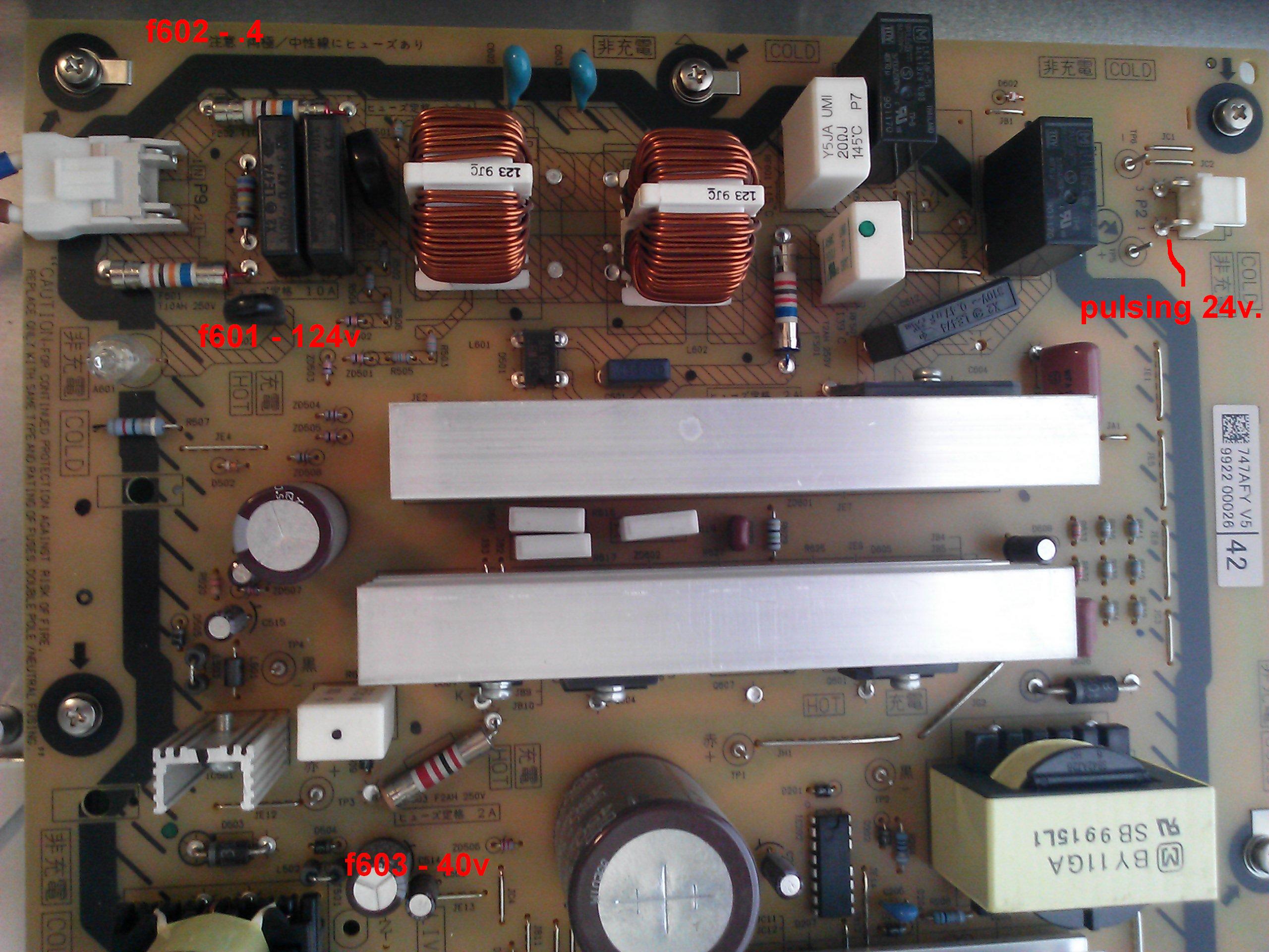

                        ok there is a power issue I think. Service manual shows 6 fuses to check all listed at 250v.
                        I checked both sides of fuses and had:
                        F201 - cannot locate, I looked at the boards twice and couldn't find it.
                        F351 - 0v
                        F501 - 123v
                        F601 - 123 v.
                        F602 - .06v.
                        F603 - 60v.
                        0v. At sc2
                        What now?

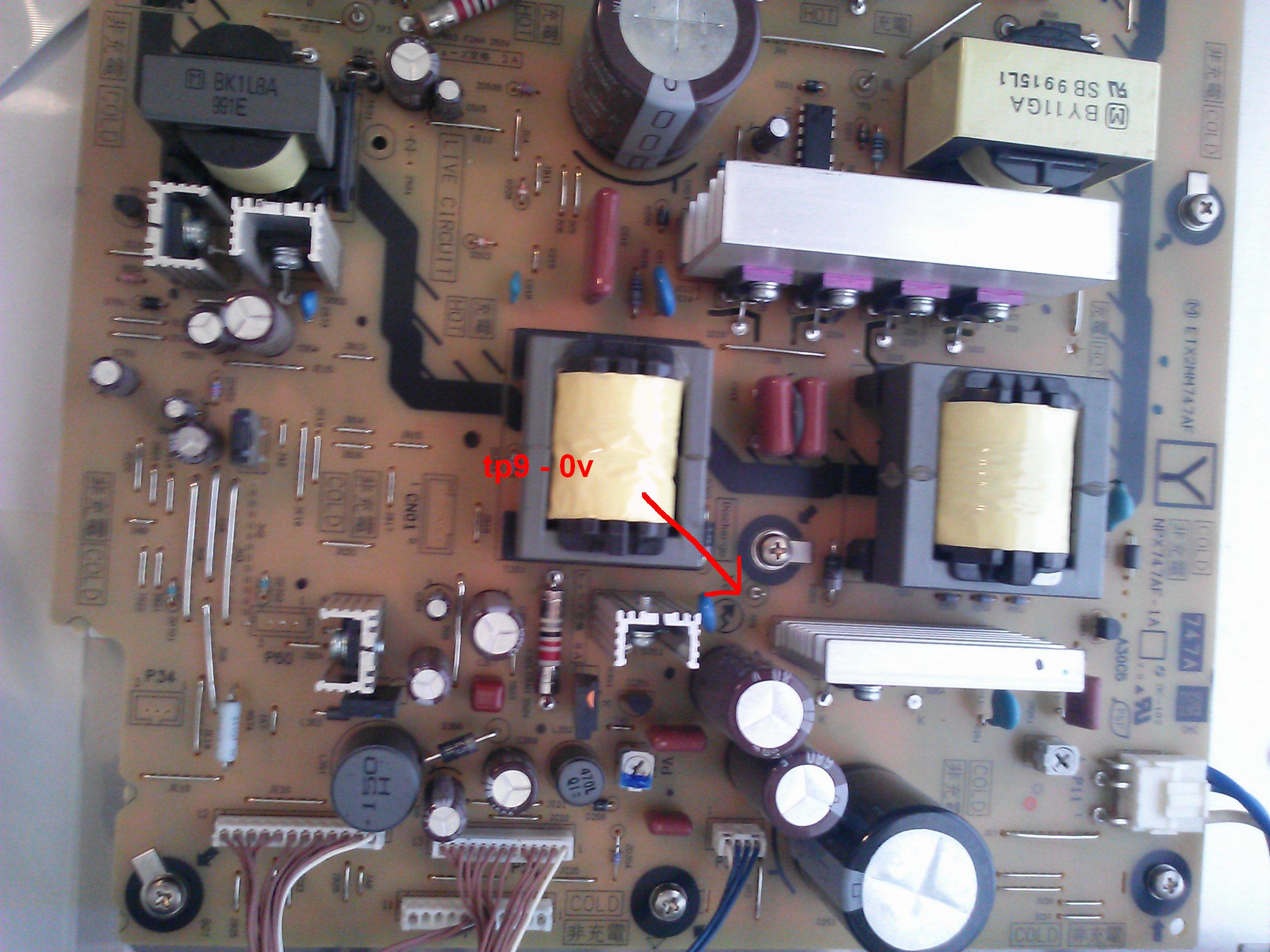

                            unplugged sc2 con
                            white wire to sc2 read 0-24v pulsing
                            fuses were the same.
                            tp9 - 0v.
                            i split the power board in half to get better pic.
                              OK, I would suspect the P board. Pictures?
                                forgot to upload em sorry lol..there posted above now.
                                these are all rated high voltage so i assumed its all ac not dc v.
                                i noticed more tp
                                tp1 - .98v
                                tp2 - .98v
                                tp3 - 58v
                                tp4 - 65v
                                tp2 and 4 had a neg.(-)mark by it. if im suppose to run meter neg to tp2 or 4 i did it wrong.
                                i still havent located a service manual for this model in case anyone has it.
