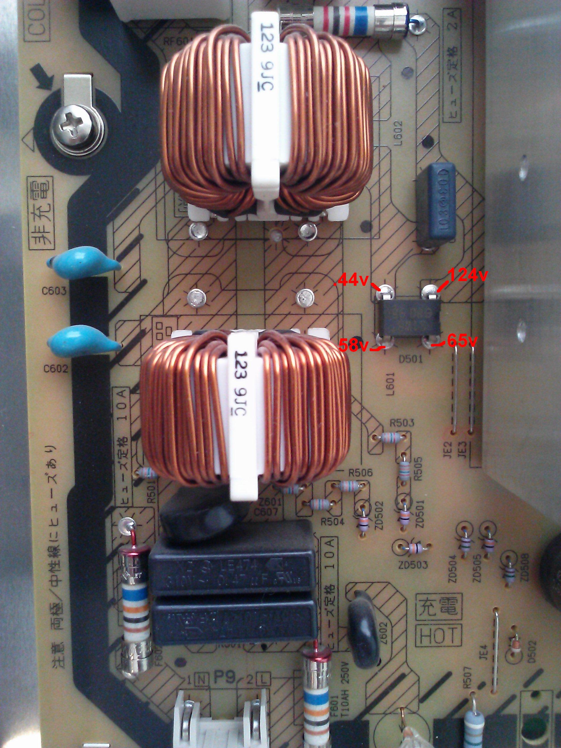

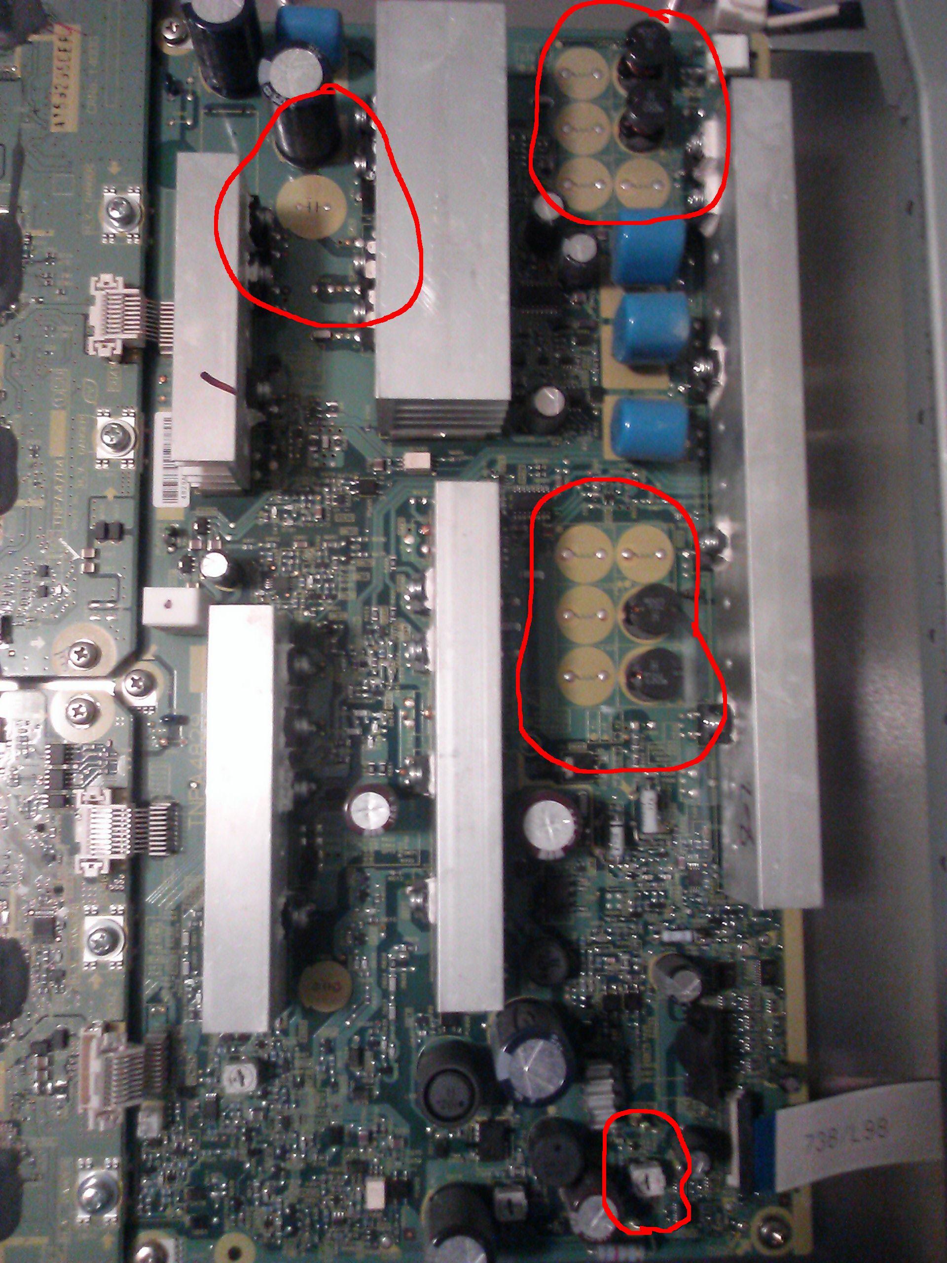

    i managed to trace voltage to D501 the pic shows voltage readings. i also measured 120v at jg1 and 1v at c604
      Re: Panasonic Plasma TC-P42U1 my first plasma

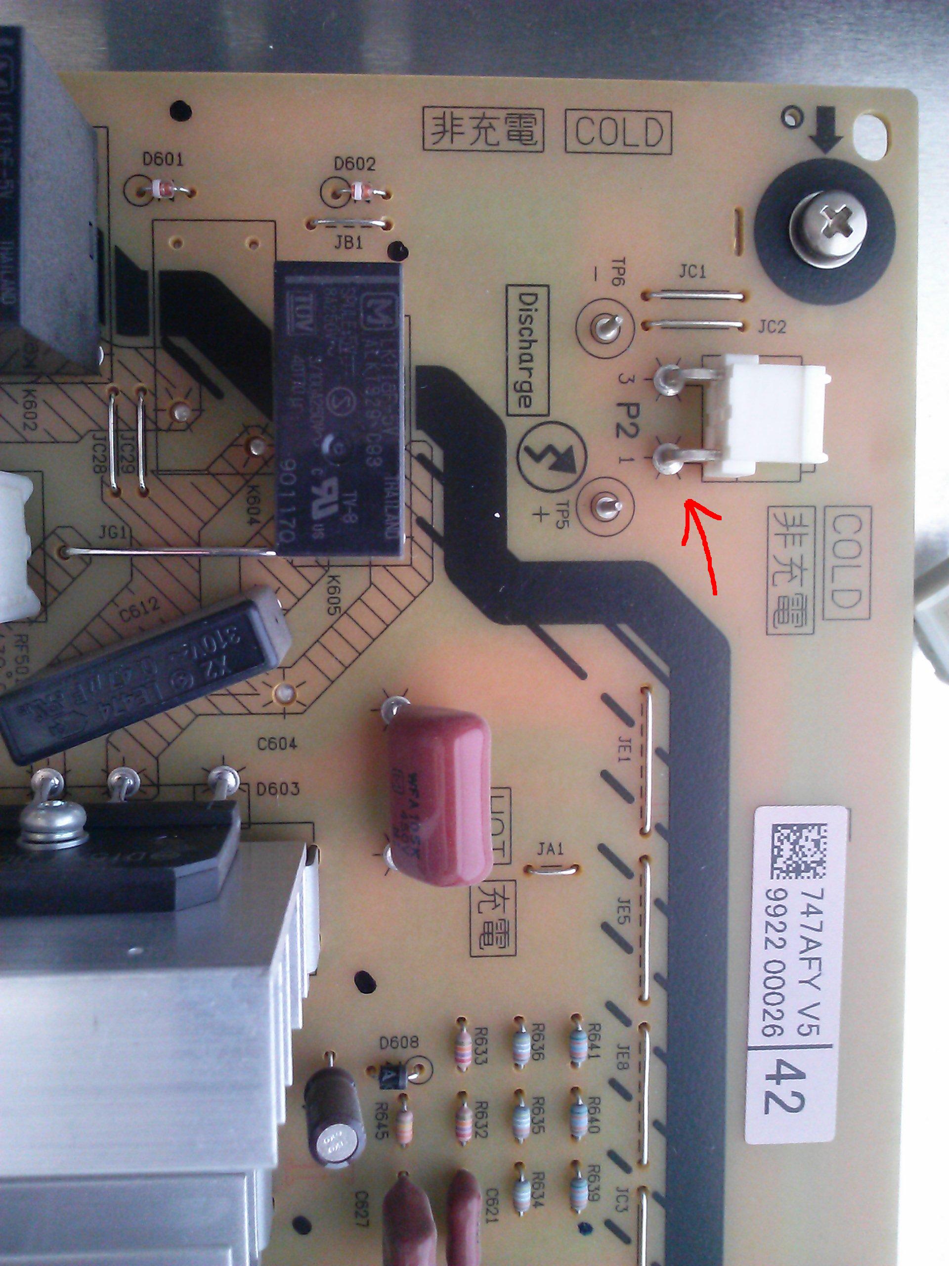

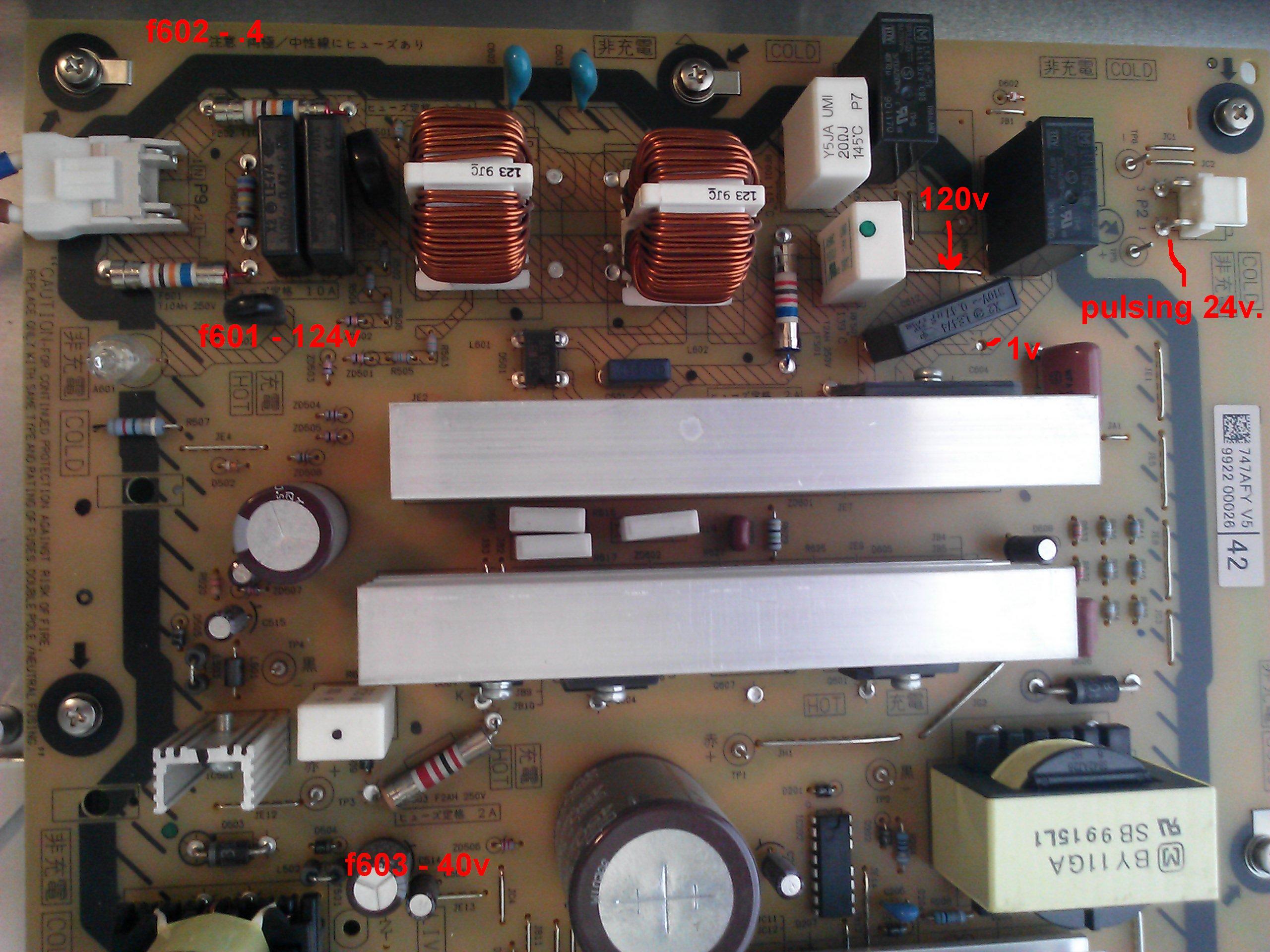

      Sorry, didn't see them.
      Across TP8/P2 you see pulsing 24V, do you see the same with SS disconnected and SC connected?
        i dont know why i got 24v before but i get nothing to sc or ss boards from those con. that i can tell.
          How were you testing it when you had 24V?

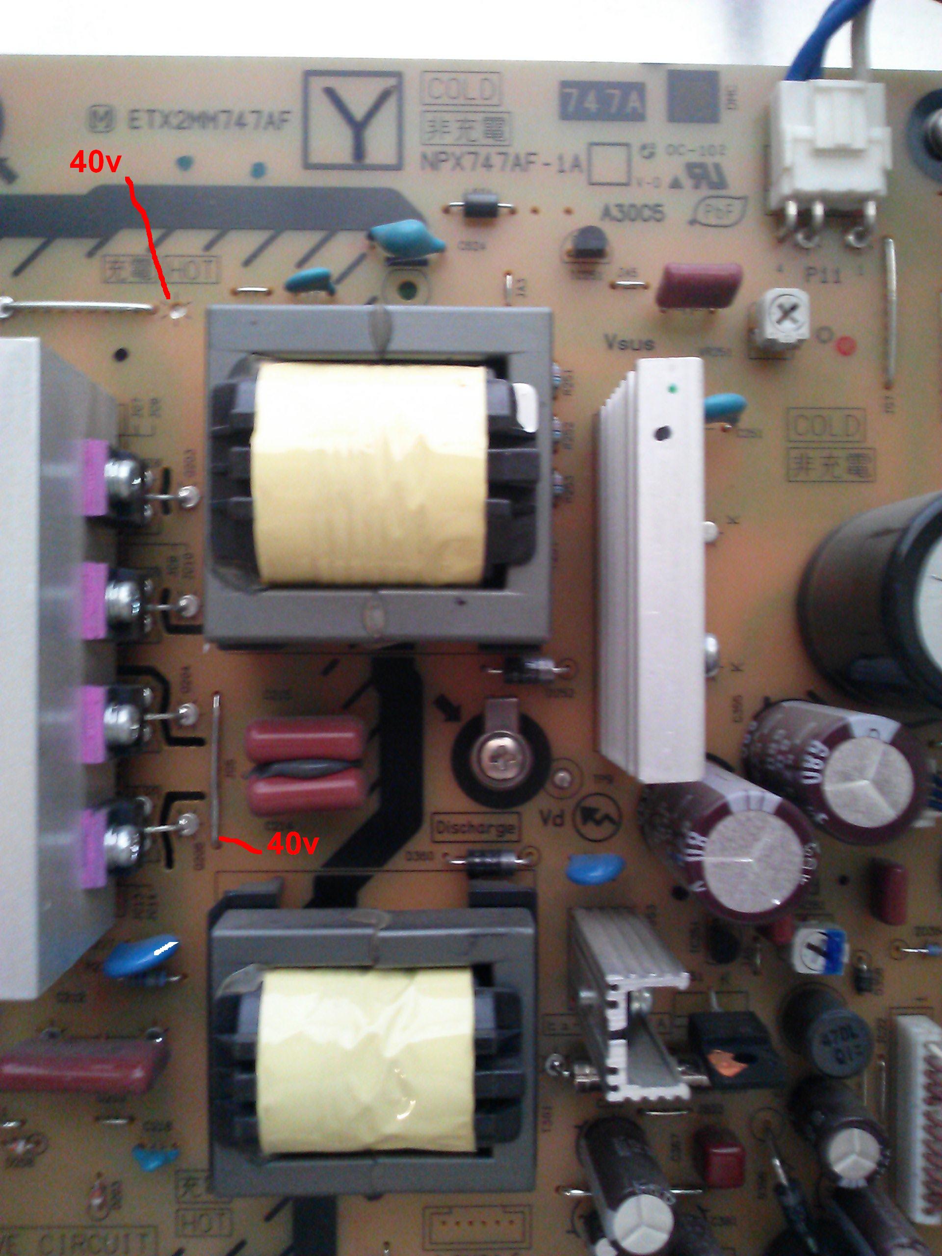

            i get 40v on hot side neer i think there transformers (see pic)
            i just had sc con disconnected and turned on power. dvm with grd to frame, it was pusing the 24vac in sequence with front led blink but it doesnt seem to be doing that now. at first i think it shutdown after 7 blinks but now it keeps blinking the code. im not sure.
              You need to measure DC, not AC. You don't need to measure the AC on the primary for now.

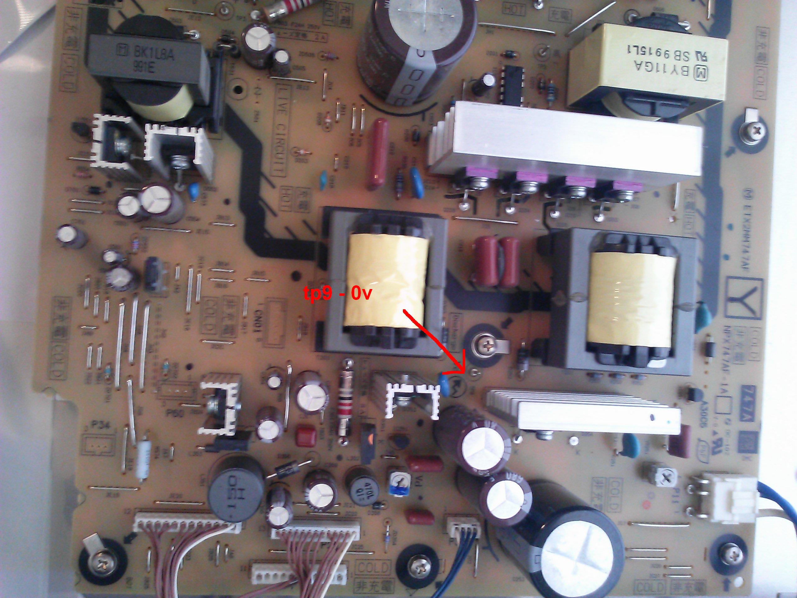

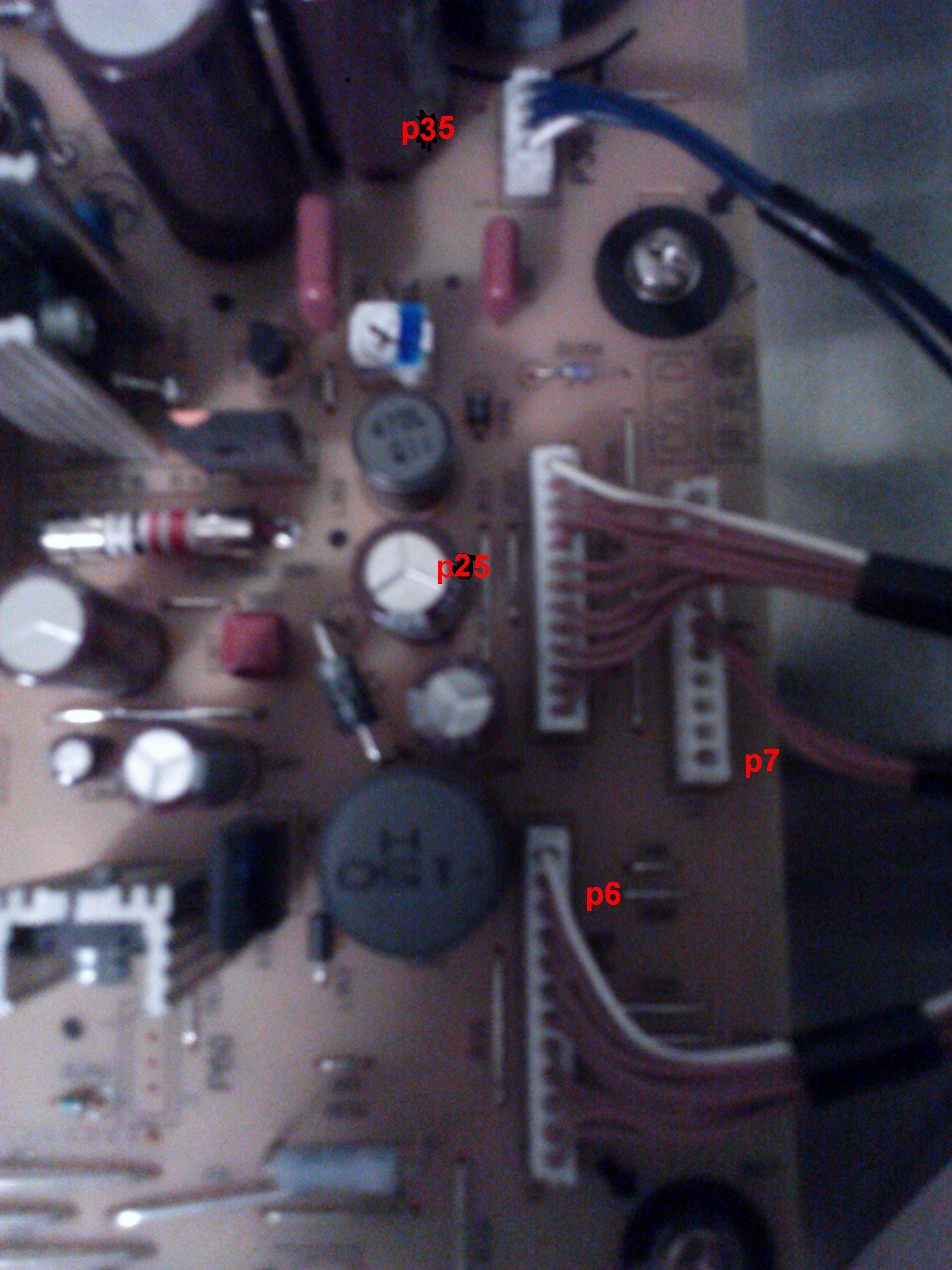

                      i tried to check voltages on pb at connectors coming from a board.
                      i got nothing but a few milivolts on a few.
                      this is what manual says it should be

                      p34/35(diag shows p34, board shows p35 if i saw it right)

                        #31
                        I'd look at A board then, it's not turning PSU on. Are all connectors except SC/SS power installed properly?

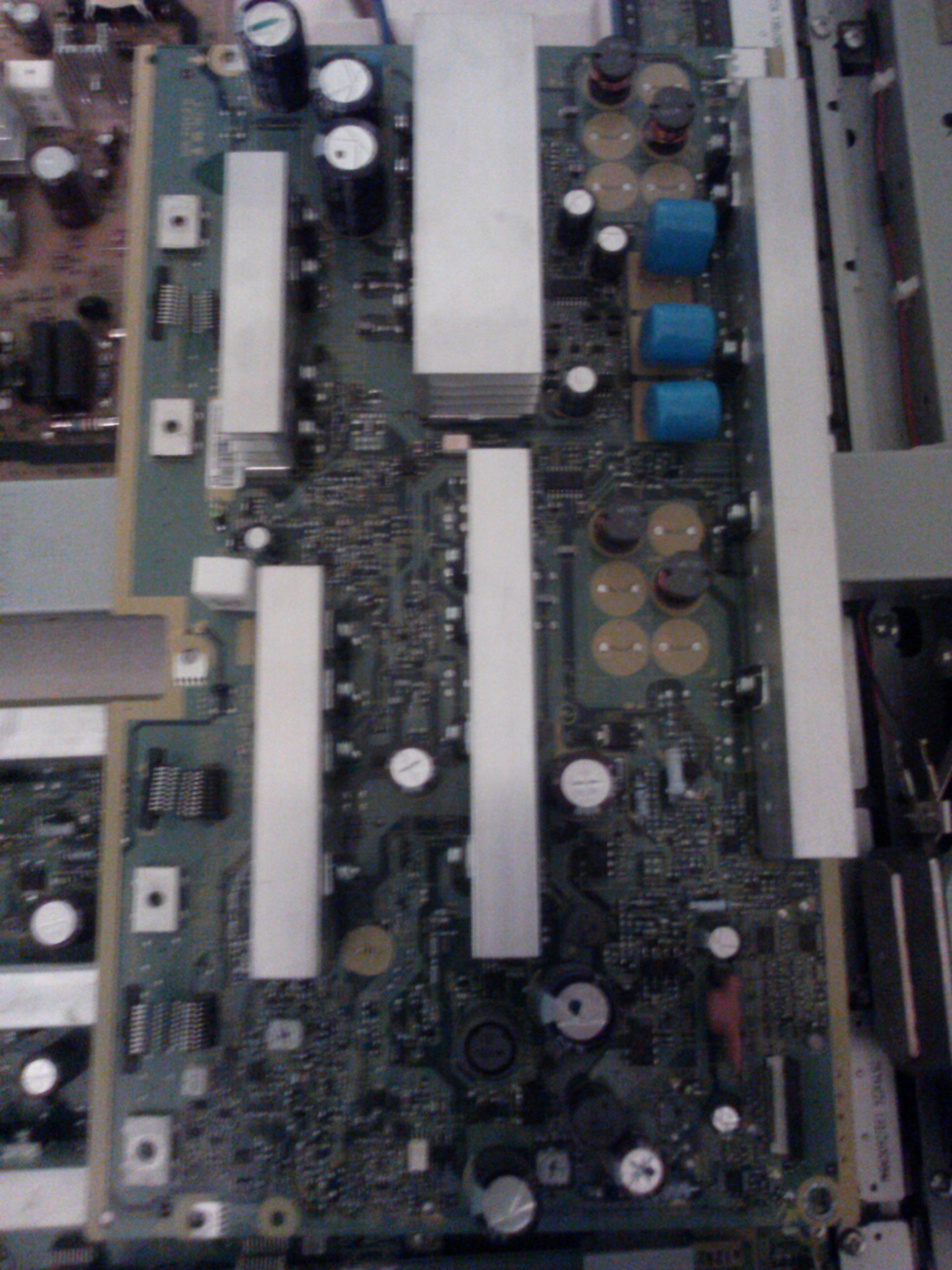

                                        #39
                                        i ordered from ebay and the guy listed the part as tnpa-4829 so i emailed him to verify it was a tnpa-4829AD. he replied that part number matched.
                                        i got the sc board today and it is a tnpa-4829AB
                                        there are noticable differences between the two boards.
                                        connection to sd/su boards are slightly different.
                                        i marked a few that i noticed right away in pic below.
                                        can i use this board??
                                        or should i ship it back?
                                        7 day return policy so i have to hurry.
                                        pic 178 is old board
                                          #40
                                          You have the 46" version it should still work, but you could not use that on the 50" for example.
