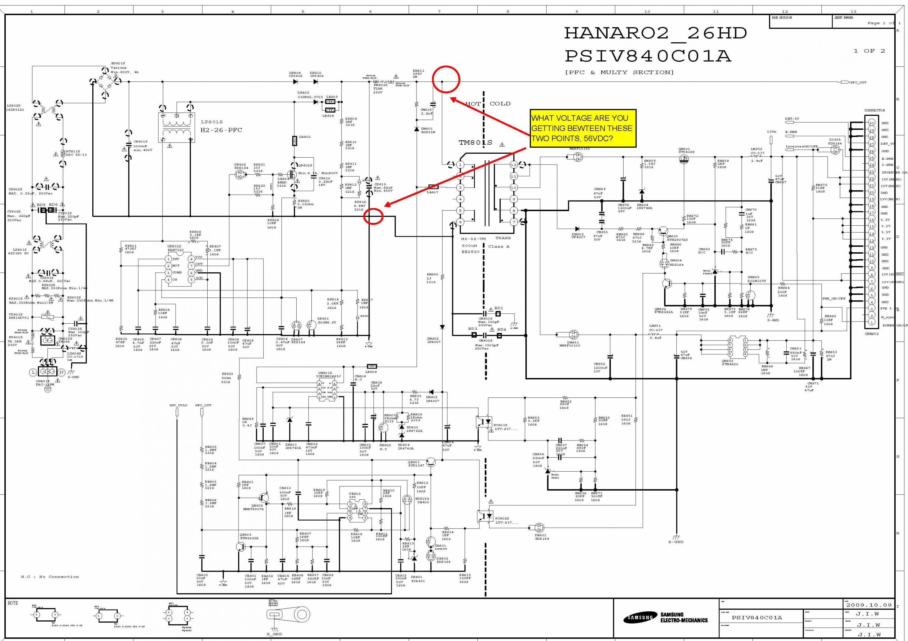

    We already know that the problem is in this power supply-inverter board, right now you are not getting 390~400VDC on the main DC filter cap, which you have indicate the reading of 165vdc on that cap, but then you indicate the reading of 56V between the fuse and the ground which is impossible and I am trying to find out how you come about getting 56V reading, one end of the fuse is connected to the positive leg of the cap, the other end of the fuse is connected to the load as you can see in the diagram.
    So let me repeat the question again, are you getting steady 165VDC on the main filter cap CP815? If you do, then the voltage reading between the fuse and the negAtive HAS TO BE 165VDC.
    The PFC circuit will have to be repair but not until we find out why your are getting 56VDC between fuse and ground.

      #42
      Re: Samsung 26in LN26B360C5D no picture good sound
      im getting 168vdc right now after clipping them on with clips and letting it set for about 30 sec
        #43
        One bad thing about working on this board is that the board will have to be mounted in place with the board's fingers still sitting into the lamp sockets, if the high voltage for the backlght lamps starts working, you will get big spark. I would find the ground point on the top side of the board which is connected to the negative leg of the CP815 main filter cap for you Black probe of your meter.
        So right now the PFC is not working properly, but do we have 165V between the fuse and the ground (negative leg of the CP815) as shown in post 41?

            #45
            Good, that will explain why the sound is OK and the standby power supply is working for you to be able to turn the TV on/off.
            We just have to fix the PFC circuit next.
            Next thing to do is to find out if that QP802S is OK, you will have to remove it to take the resistance reading, we are looking for resistance leakage between Source pin and the Drain pin.

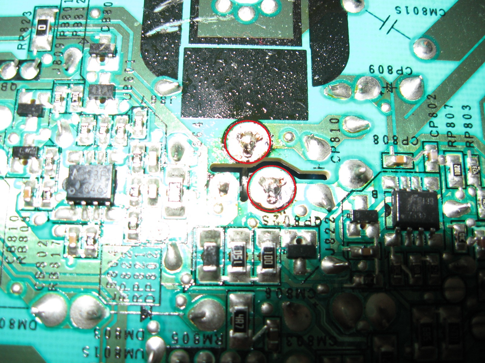

                              How do I remove QP802S? Will it just pull out? Two of the leads has more than just a straight lead. Attached a pic.
                                #55
                                At this point, you can take the resistance as is without removing it, just want to see if it show low resistance or not. The reading will be the middle pad and the right pad as shown in your picture.
