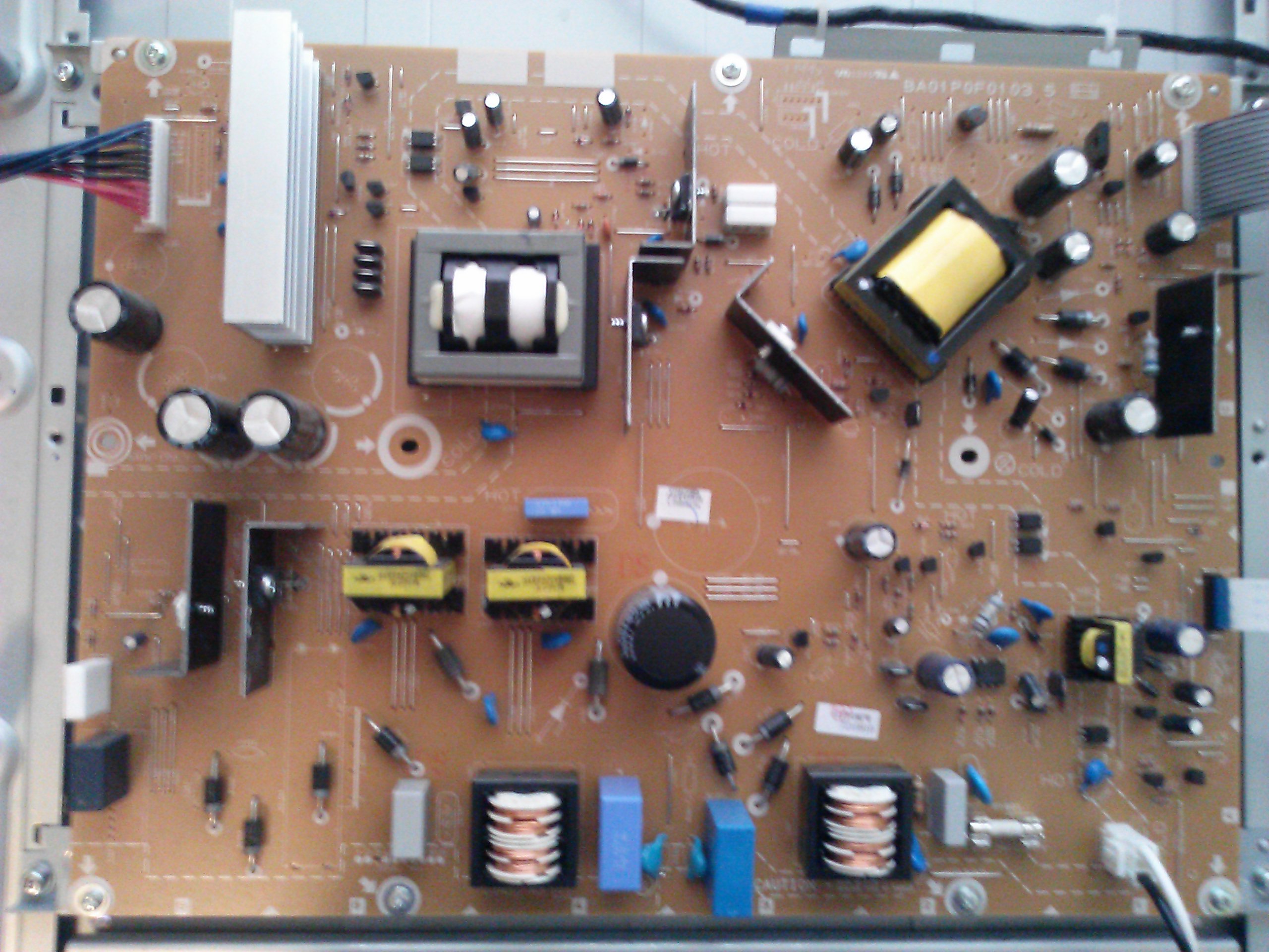

    i have a magnavox 40MF401B/F7 that when you turn it on the stby light in front blinks 18 times for about 5 sec and then goes out. when the light goes out the screen lights dim about 50%. no picture, no sound, no input display(time/channel).
    voltage from psu seemed ok but some tp werent labeled or couldnt read so i skipped them. there is a slight hum coming from the long narrow board left of psu.
    I think this is common but i couldnt find a thread. I would apreciate help.

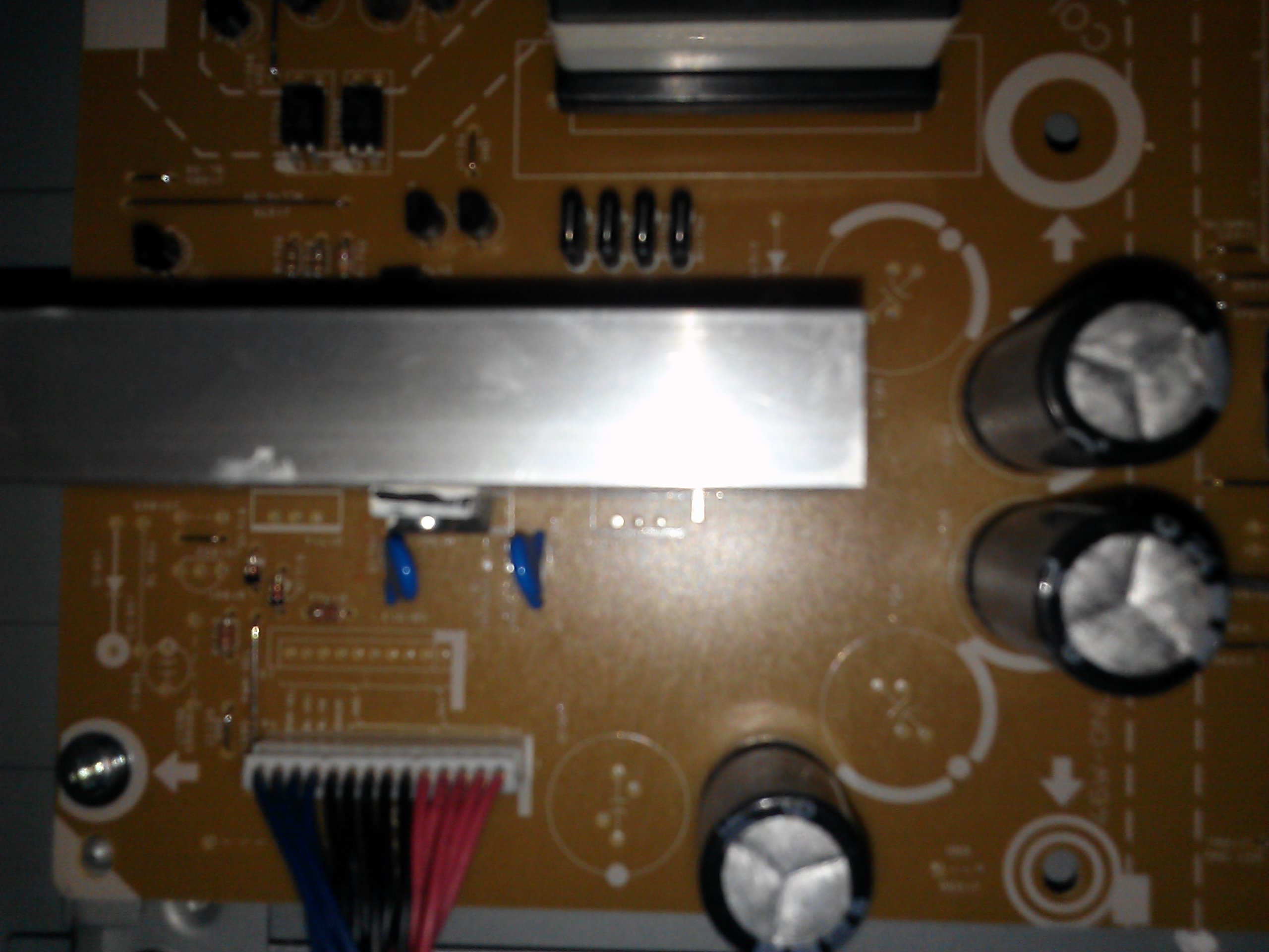

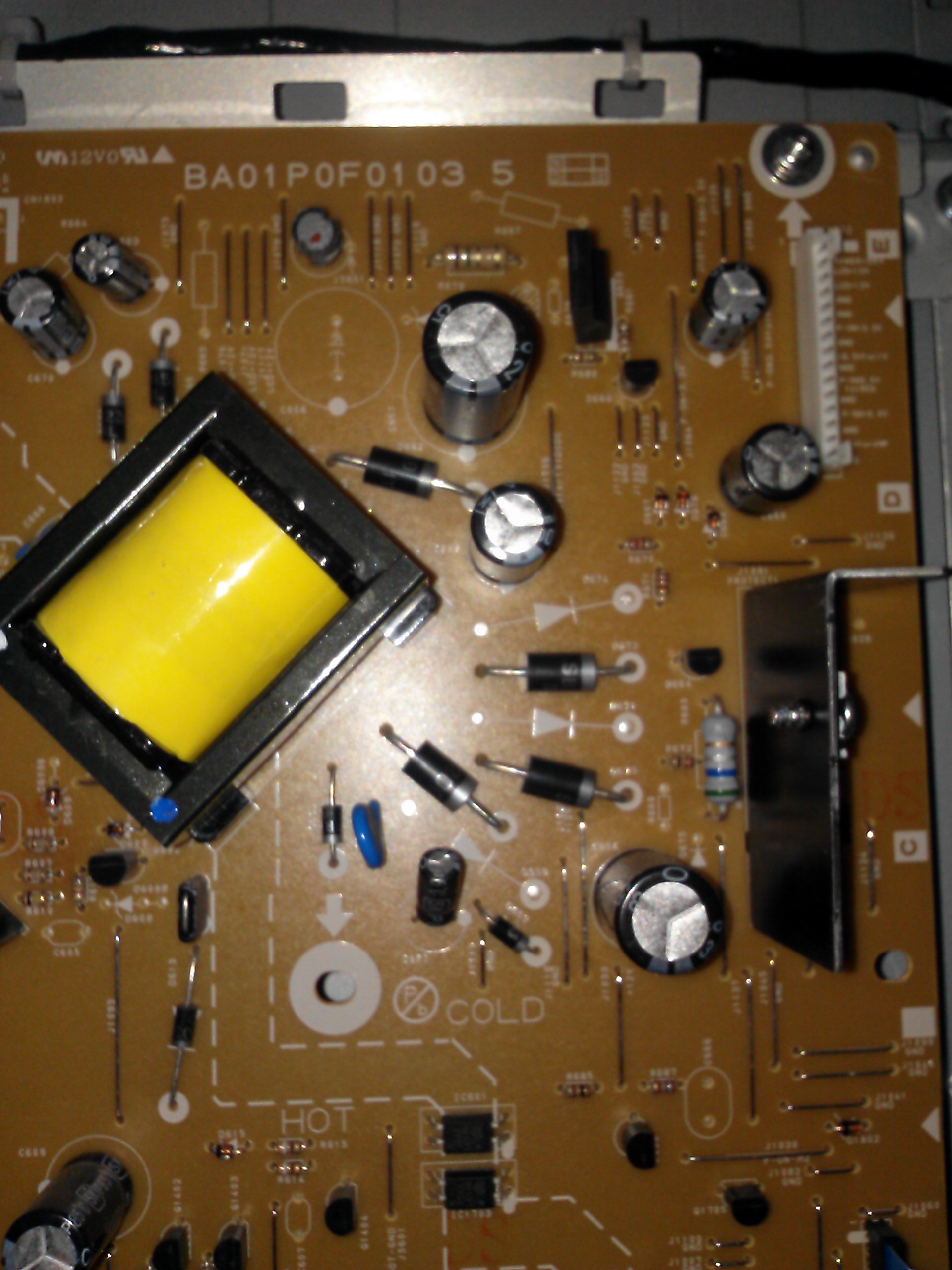

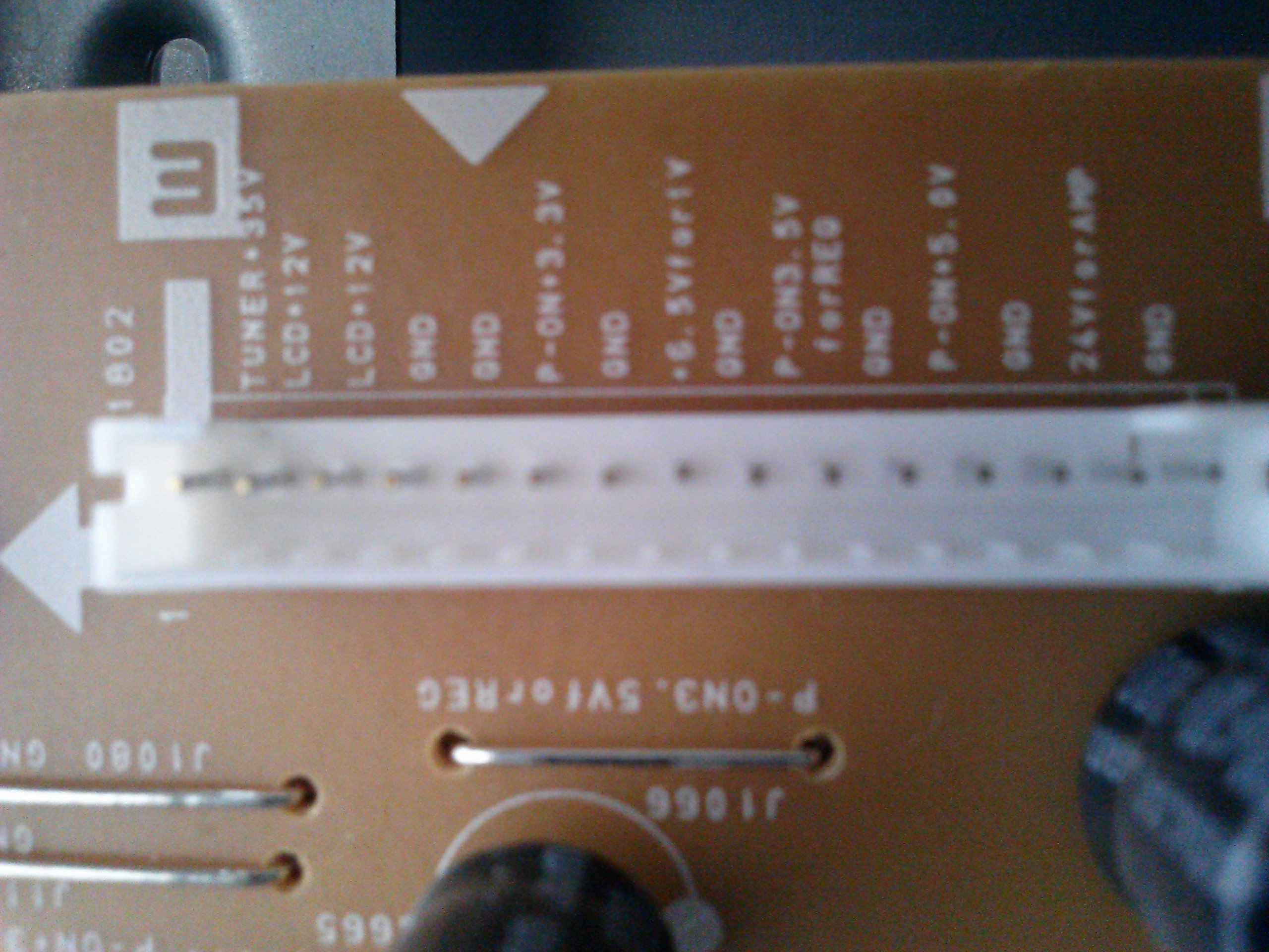

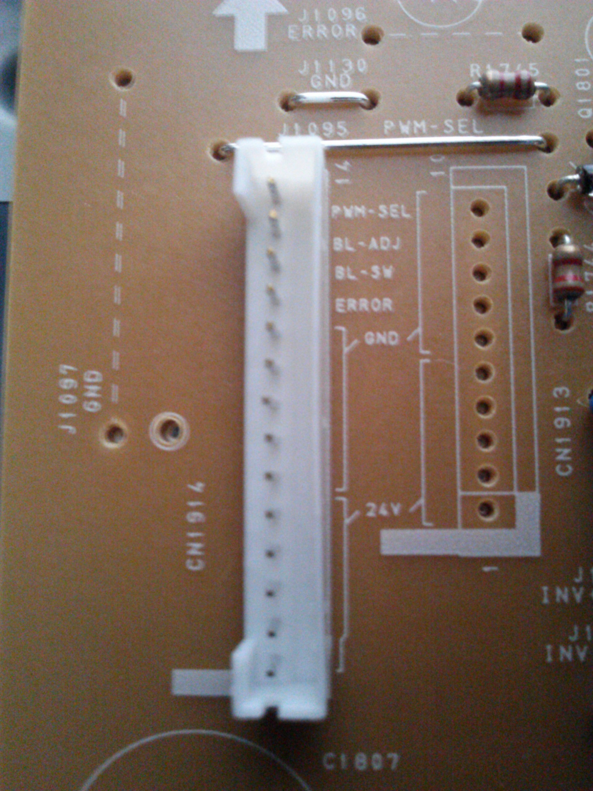

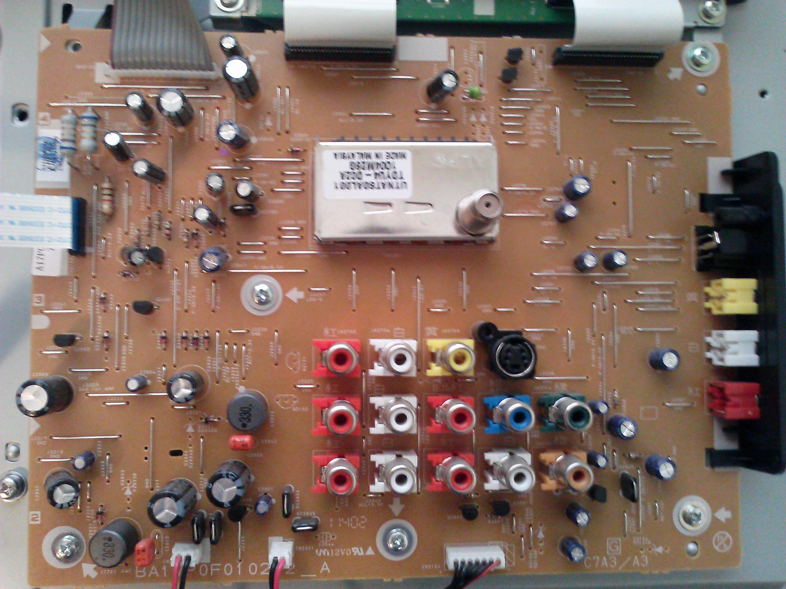

    pics of the 2 connectors on power supply. inverter and main board. i retested them.
    inverter con:
    pwm-sel = .772v
    bl-adg = .76v
    bl-5w = 2.95v
    error = 3.2mv
    24v = 23.90v

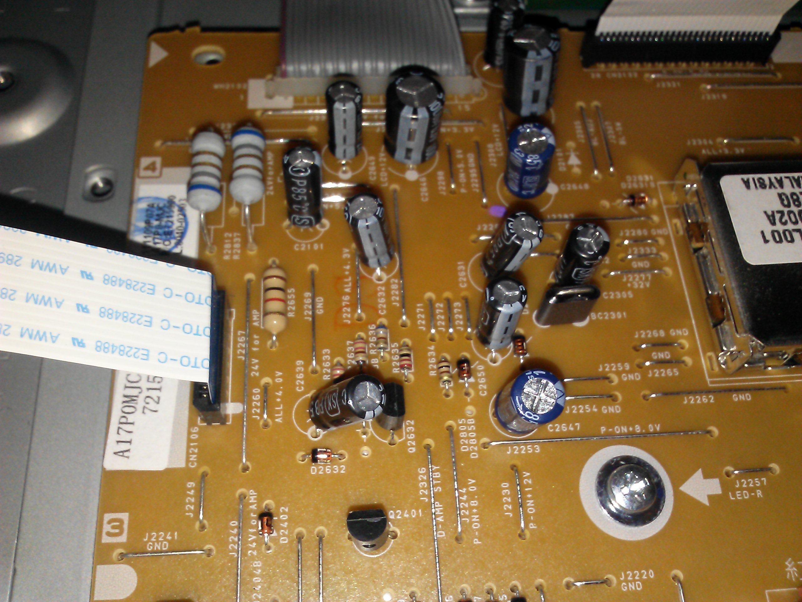

    main board:
    tuner35v = 37.68v
    lcd12v = 12.17v
    lcd12v = 12.17v
    G
    G
    p-on+3.3v = 3.38v
    G
    +6.5v for 1v = 7.71v / 190mv
    G
    p-on3.5v for reg = 3.68v
    G
    p-on+5v = 5.27v
    G
    24v for amp = 27.46v

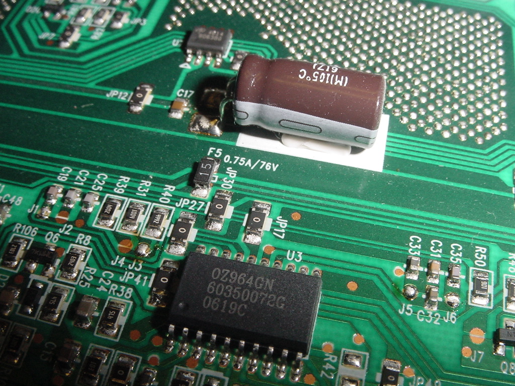

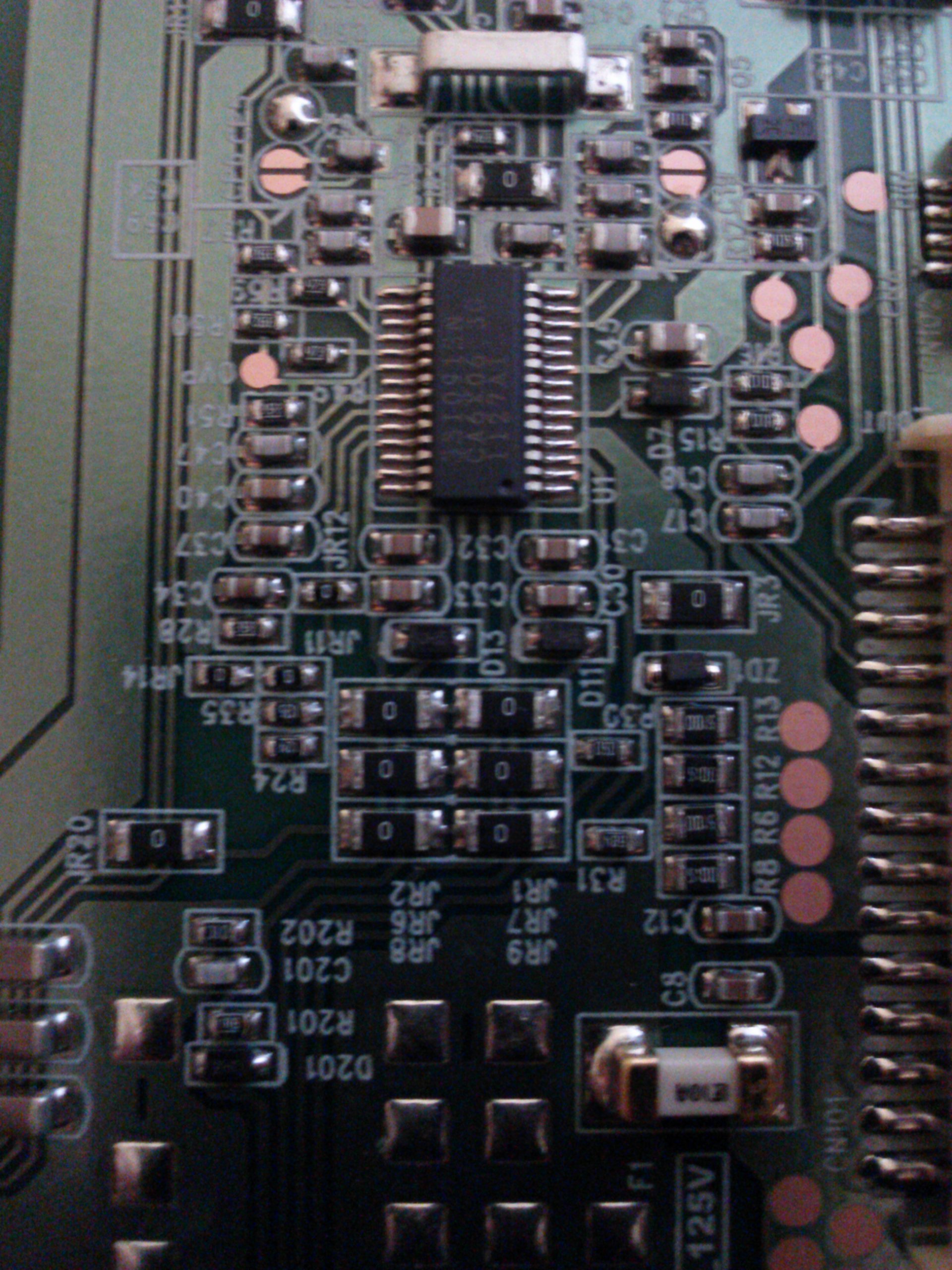

          Re: Magnavox 40mf401b/f7
          The inverter is getting all the correct voltages from the power supply and from the main board but it is sending ot an ERROR signal, if the Inverter board is fucntioning, the ERROR pin will be >3VDC, rught now it is LOW= ERROR.
          I need to see GOOD CLEAR FOCUSED pictures of the area around the connectors of the inverter board and the whole board that the cables from the power supply board are plugged in. I think you have a blown fuse for the PWM IC. See fuse F5 in the picture.
          I also need the LCD panel model number, there should be a sticker on the LCD panel showing the model number.

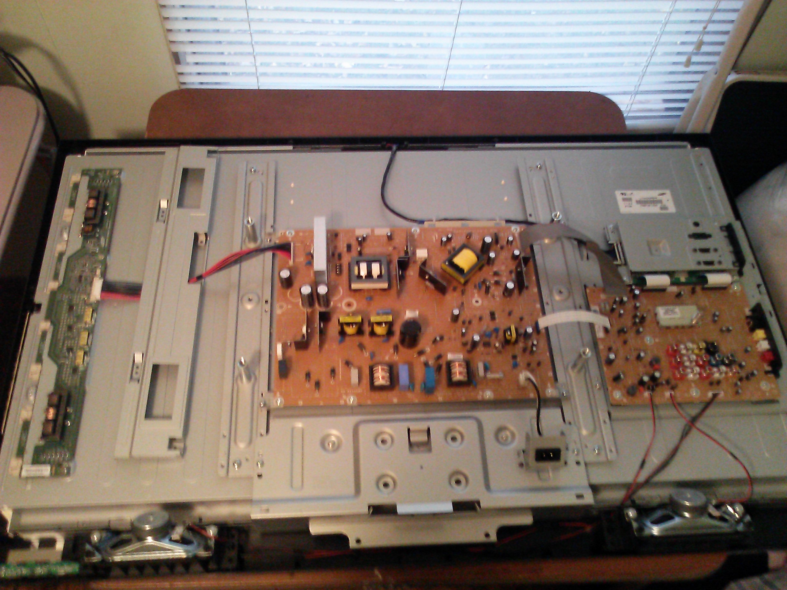

                                  I unpluged the inverter board, plugged in power. Solid front led
                                  Turned on power, heard 1 click, red led flashed 18 times and went out
                                  Pressed power and it solid red
                                  PressedPower again, click, 18 blinks, led goes out
                                  It repeats every time
                                  Unplugge!d power
                                  Reconnected inv
                                  Reconnect power, 18 blinks
                                  Backlights comes on led goes off
                                  Pressed power, backlights go off, shutdown
                                  Front led comes on

                                    i rechecked voltages. last time i must have error tested on bl_sw. there next to each other.
                                    pb con to inv:
                                    pwr_sel = .77v
                                    bl_adj = .77v
                                    bl_sw = 2.97v
                                    error = 0
                                    g
                                    g
                                    g
                                    g
                                    g
                                    24v = 24v
                                    24v = 24v
                                    24v = 24v
                                    24v = 24v
                                    pb con to main board:
                                    tuner35v = 37.68v
                                    lcd+12v = 12.16v
                                    lcd+12v = 12.16v
                                    g
                                    g
                                    p_on+3.3v = 3.38v
                                    g
                                    +6.5vfor1v = 7.68v
                                    g
                                    p_on3.5vforreg = 3.5v
                                    g
                                    p_on5v = 5.2v
                                    g
                                    24vforamp = 27v
                                    pb ribbon cable to main board:
                                    g
                                    protect3 = 3.0v
                                    protect1 = 3.1v
                                    bl_sw = 3.28v
                                    bl_adj = .71
                                    pwrreset = 2.8v
                                    p_on_h2 = 3.1v
                                    p_on_h1 = 3.3v
                                    g
                                    g
                                    g
                                    all4.3v = 4.3v
                                    all4.3v = 4.3v
                                    it all looks good to me. what do you think?
                                    from the main board theres 2 ribbon cables that go to hdmi jacks and from there to top of lcd panel. does video signal travel through inverter or is that just for backlights.
                                      The inverter does have all the required signals and voltage, it looks like you just have to try the new inverter board, there is no easy way to test the lamps in the panel.

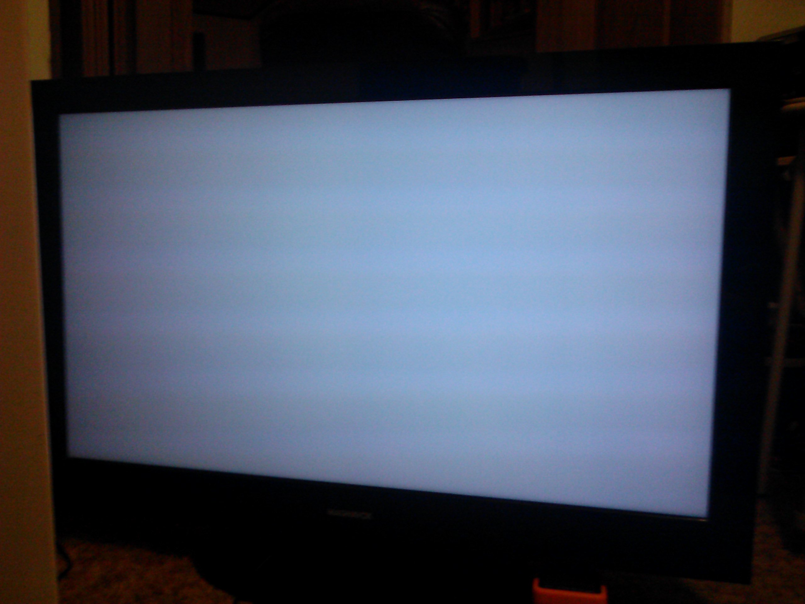

                                        all i get is backlight. (white screen) see pic.
                                        i will start looking for one online.
                                        the lines in pic i dont see on tv
