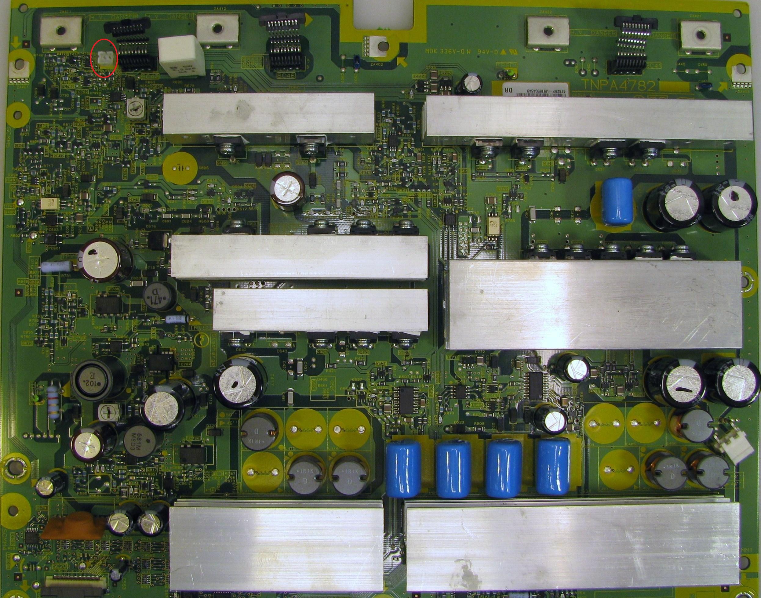

    This is what i would do. Disconnect SD & SU, jumper white 2 pin connector SC50 on the SC board TNPA4782.
    Power on set and see if it turns on normally(no picture though). If it still faults and you see SOS6, I'd head for the SC board which I'm expecting it to be.
    If no SOS then I would think it's the SU/SD. I'm assuming the panel is good on this TV.

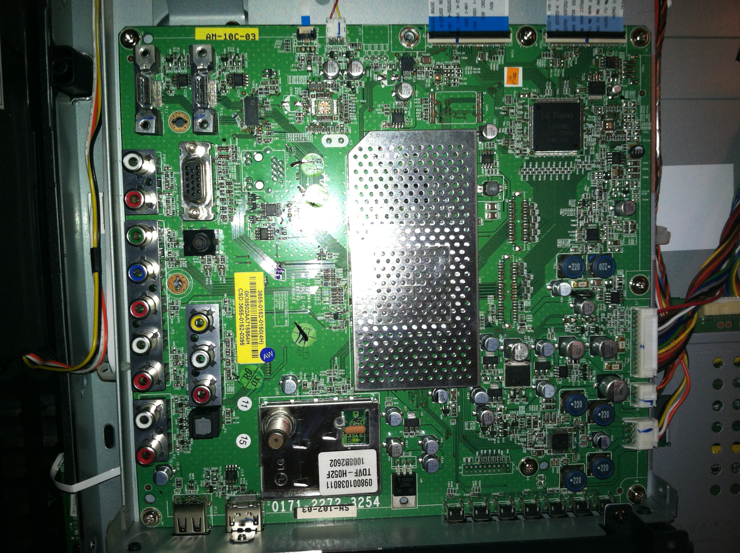

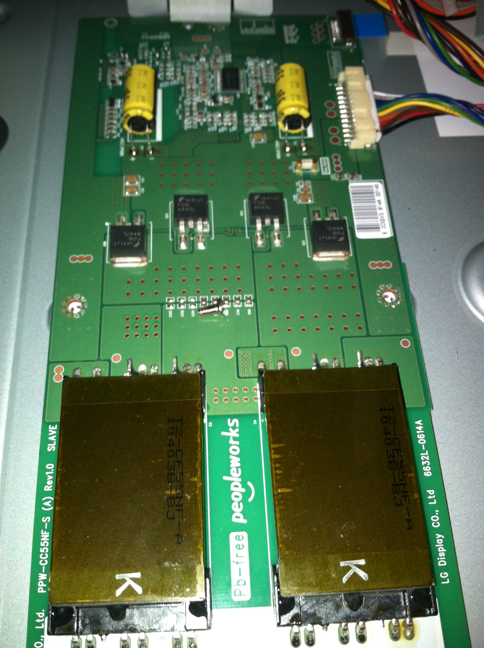

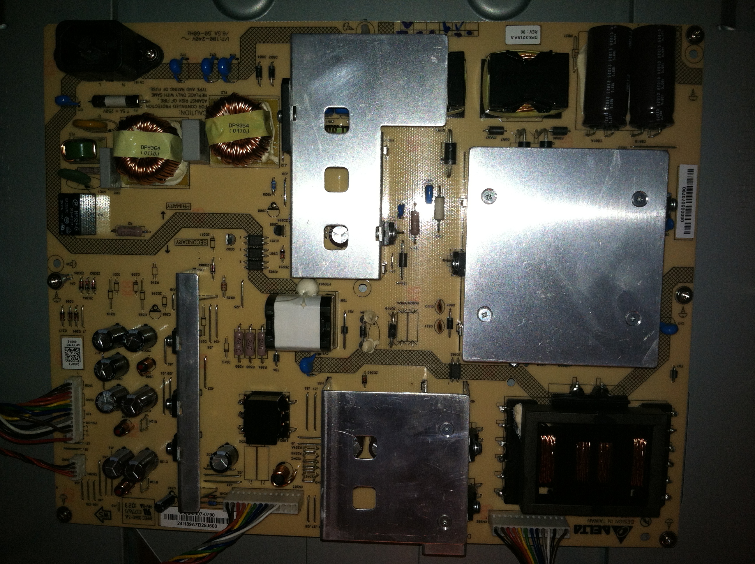

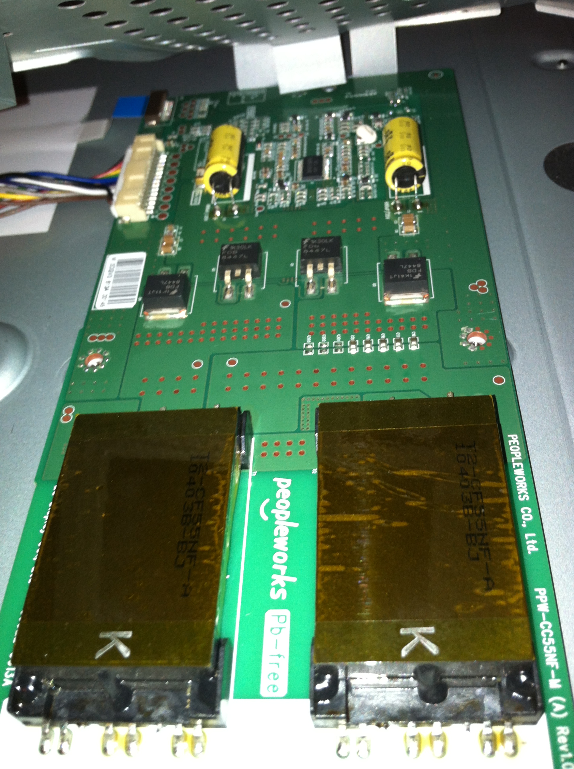

                Here are some pictures of my boards.
                  Re: Panasonic TC-P50G15 7 lights
                  Something tells me you've grabbed to wrong files. looks LCD and VIZIO?
                  Edit: Might want to check recent posts, looks like you've got TC-P50S1 info on the VIZIO post and VIZIO info here on the Panasonic post.
