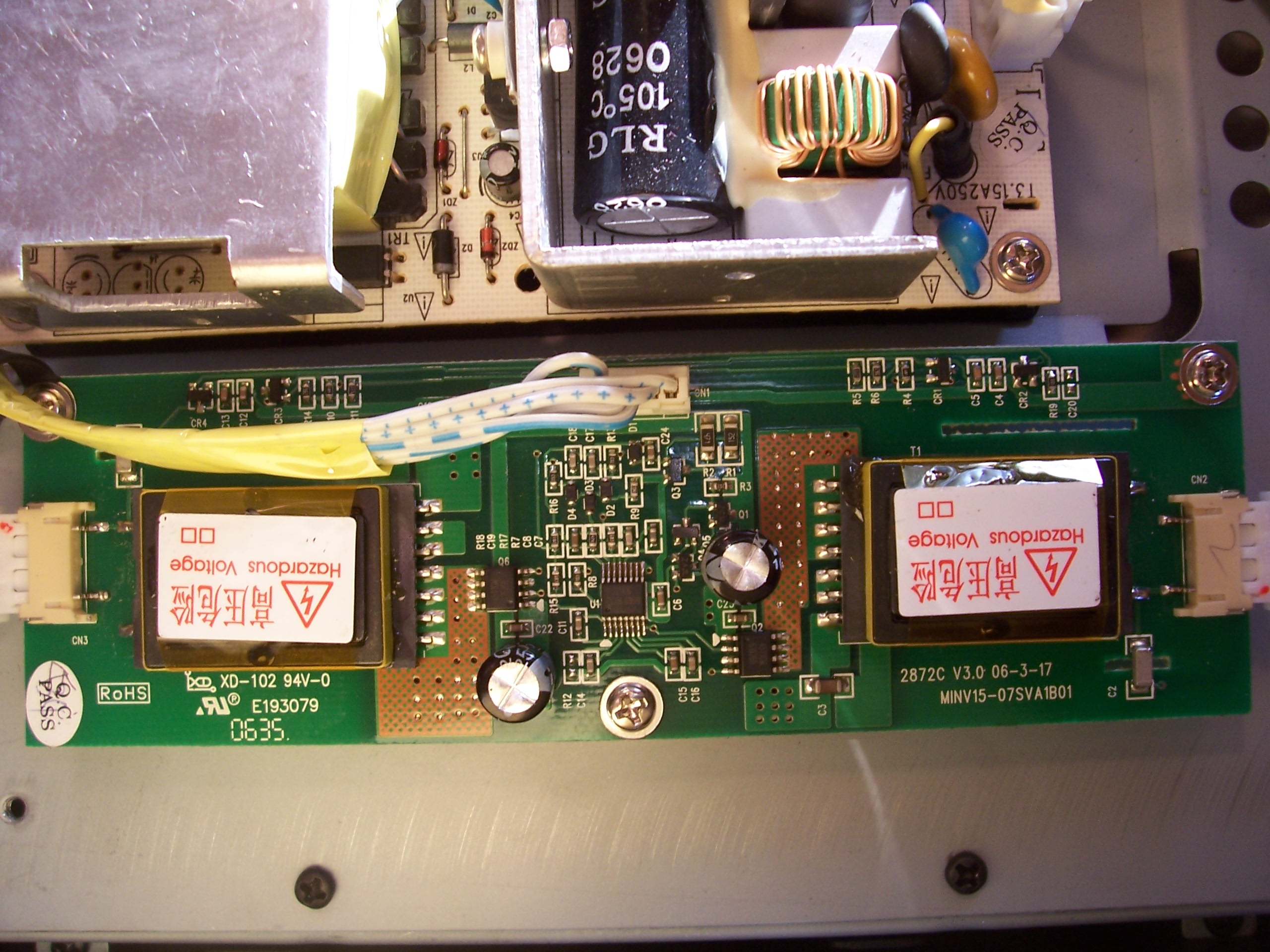

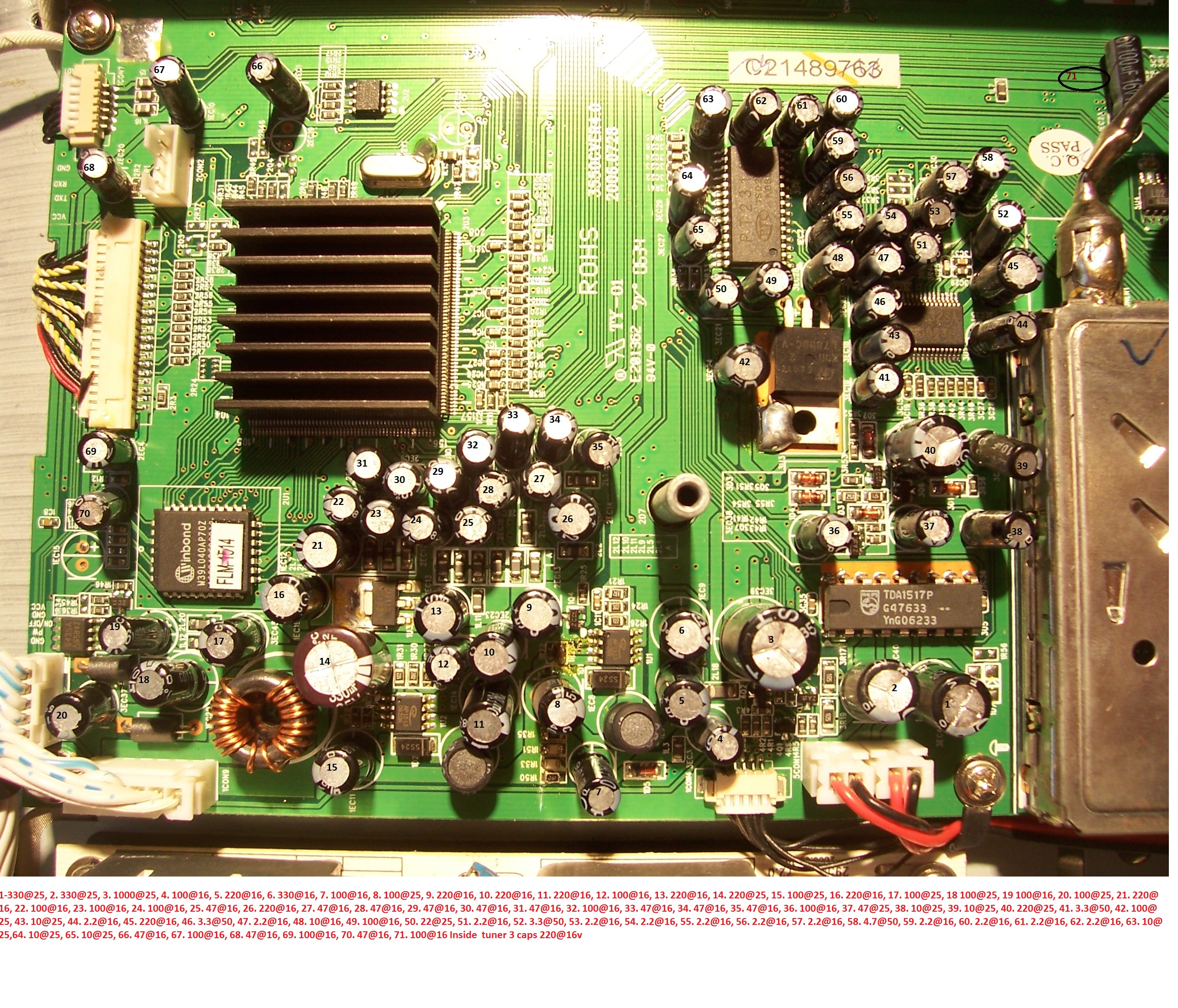

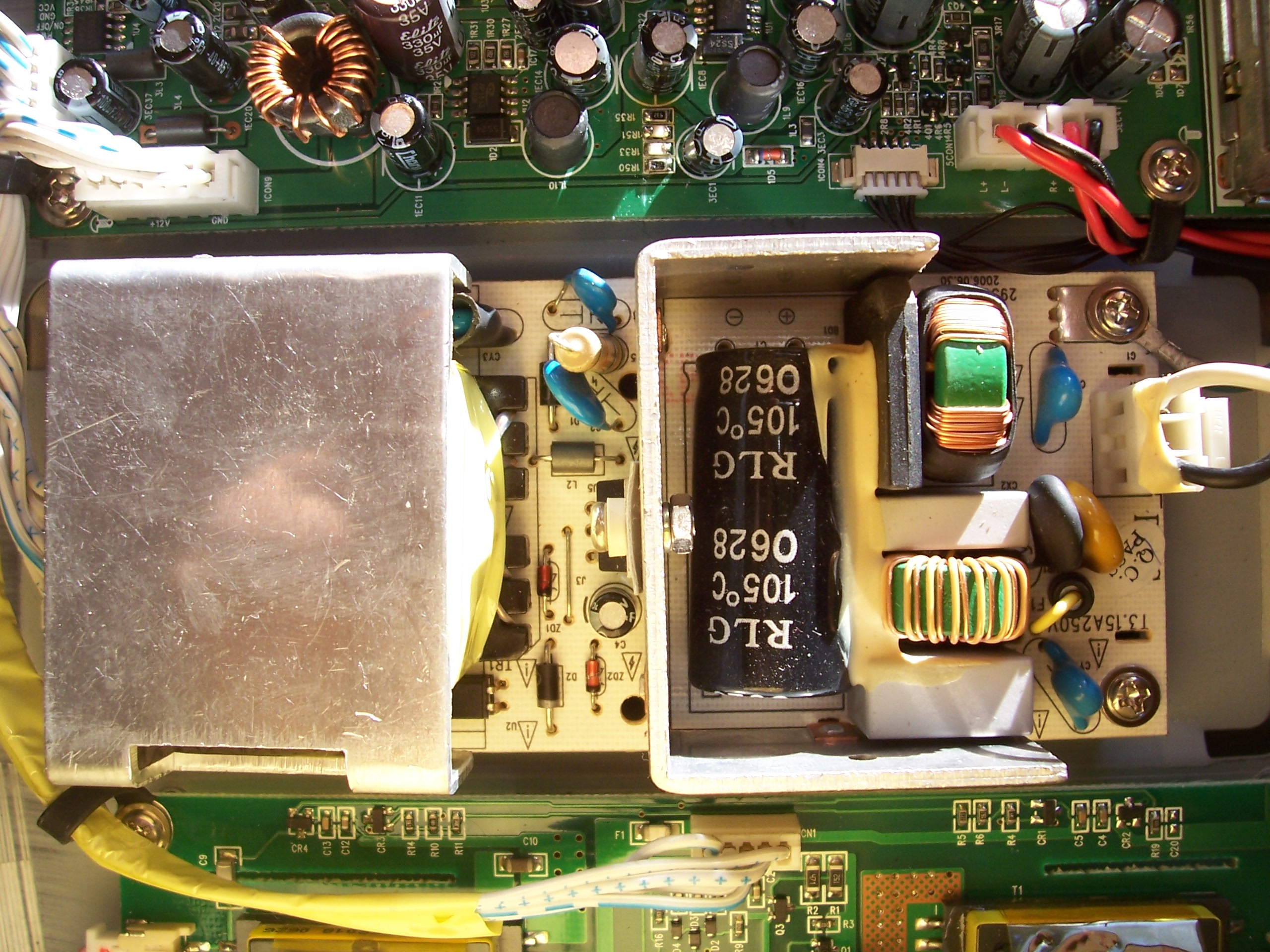

                Here are some pictures and as you can see the logic board is loaded with caps. It may be cheaper to buy a new Tv than replace all these caps?? May be someone may be able to narrow it down to which caps might be suspect? There are 74 caps and quite a number different values. Not sure what brand these caps are PH GS if that is a brand?

                  Thanks freakaftr8 when you say master reset I assume you mean Factory reset? I have done that in order to get it to work and have to repeat the procedure each time it is shut down. The unit works OK for either a TV or a PC monitor just have to do a factory reset each time it is turned off
                  • freakaftr8
                    • Oct 2012
                    • 3743
                    Re: Polarized 19" LCD TV
                    I would think that EEPROM is losing 5v in standby. But the odd thing is I tried unplugging my 19 inch Polaroid and she I power it up I can still switch inputs. Out of tolerance regulator maybe?

                        What would cause a regulator to be out of tolerance? Bad caps? or failed regulator?

                              Thanks guys and a TV Tech I am not. I have replaced several of the suspect caps but have not made any difference. I do notice a (hissing humming)sound in one of the boards when in standby? It is not there when powered on? I can't seem to narrow it down?
