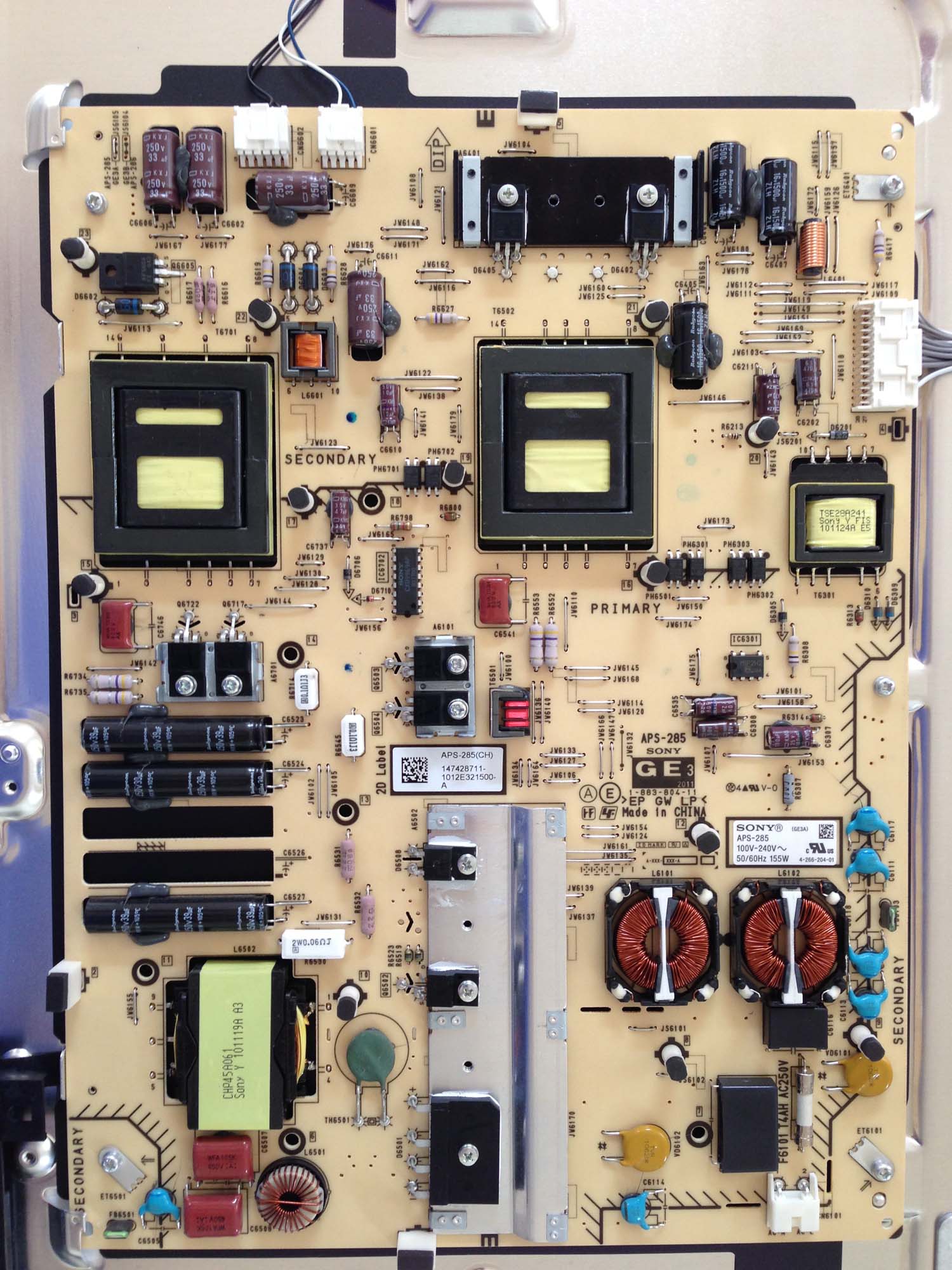

    - I took a multimeter to a few fuses on the power supply board, and everything looks good.

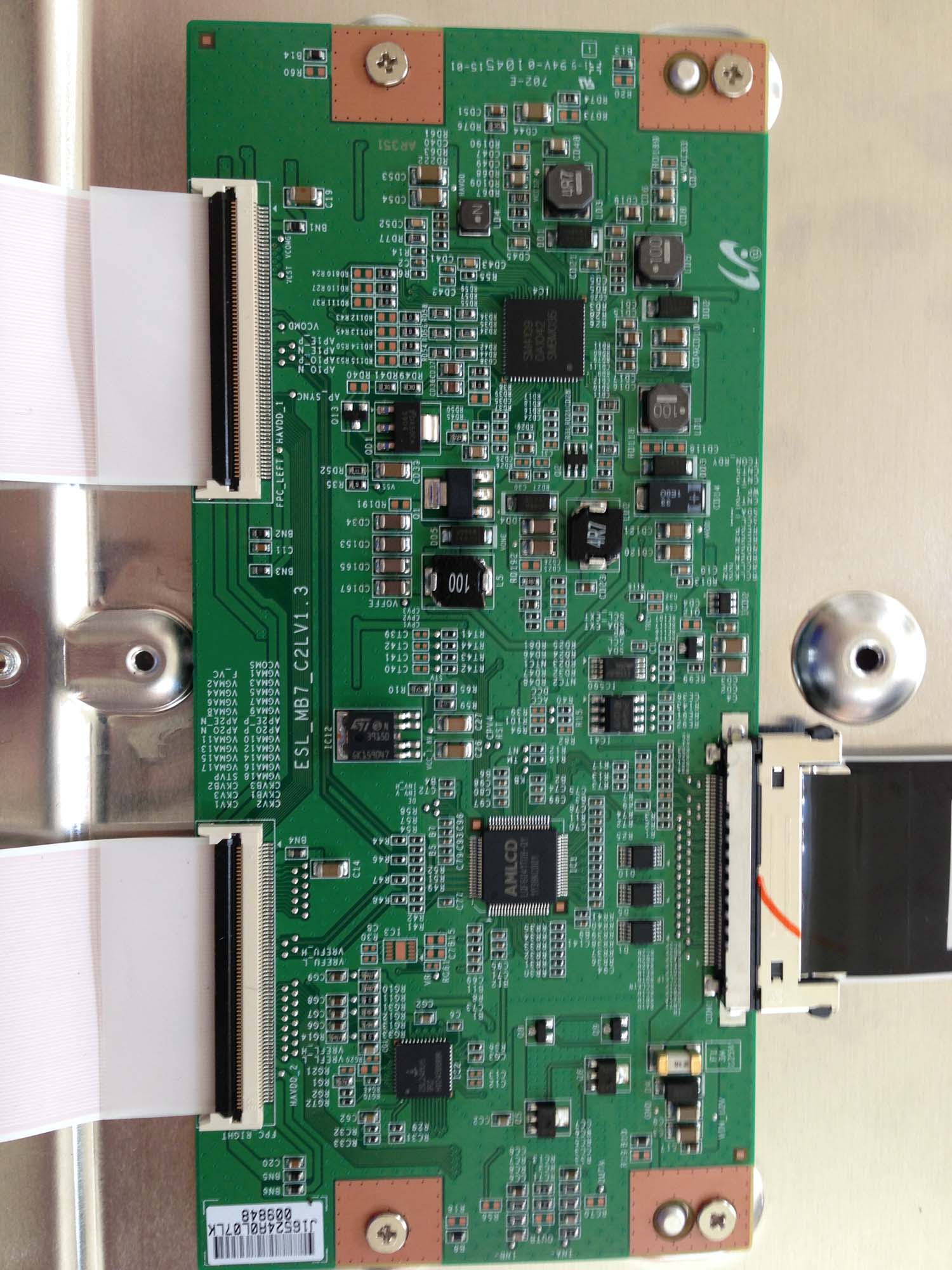

    - I checked the fuse on the T Con board, it is in good shape. Checked it with a multimeter, works good (~ 0 resistance, isn't burnt). (This is usually the 'F1' fuse. For me it was rated at 3A, 125V)

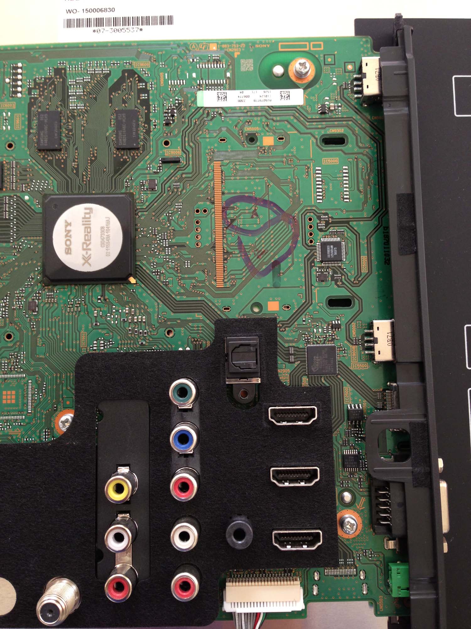

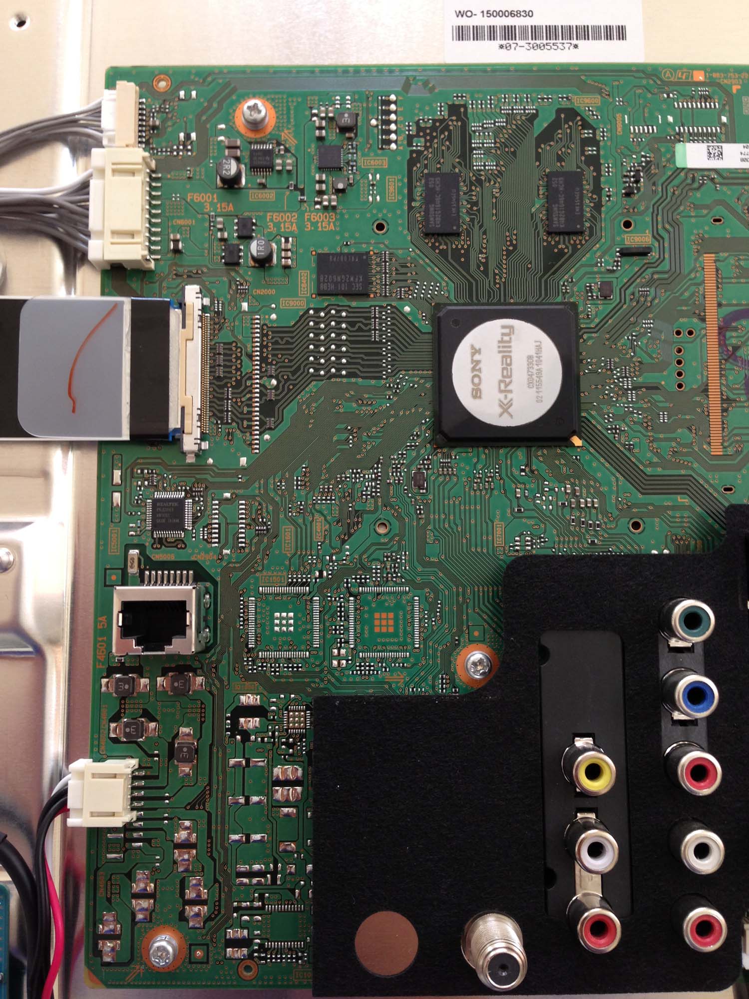

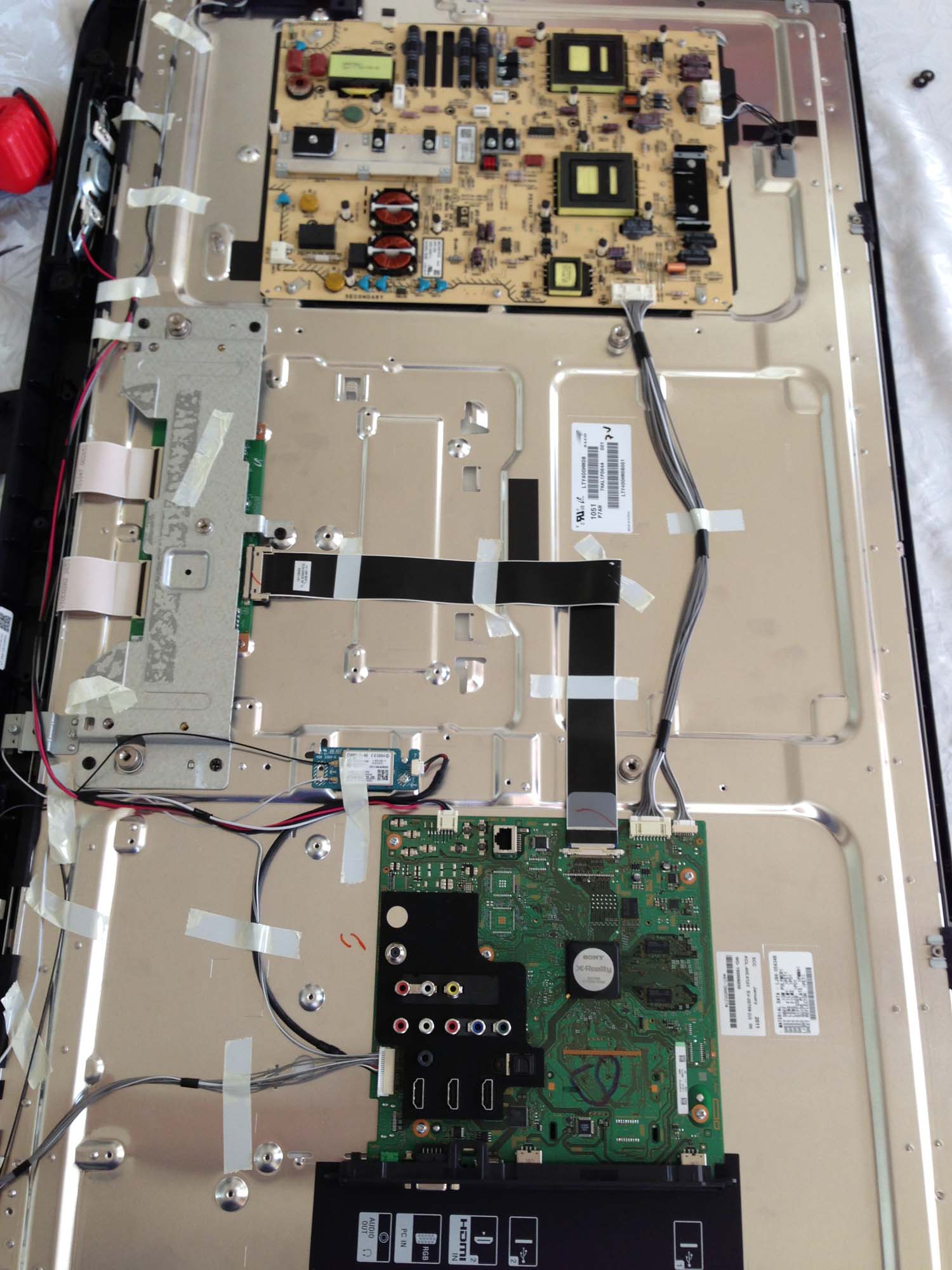

      Re: Sony Bravia 40" - No Picture, Sound Works
      Yes, I can see the backlight on.
      I took a bunch of pictures of the boards. The photos include: the inverter board, an overall view of the whole back of the TV, the t con board, and two pictures of the main board.
        Have you checked the fuse on the tcon? I see a few fuses on your main boards pictures too.
        • rzermatt
          • Oct 2012
          • 5
          Checked the fuse on the tcon, getting a reading of about 0.2 ohm with a multimeter. I checked the fuses on the main board, and I'm getting approximately the same readings too.
            Check the voltage on each end of the T-con fuse, with the red lead on either end, and black lead on the chassis, and the TV in the powered on state.
            • rzermatt
              • Oct 2012
              • 5
              Getting 12.54V
                OK, that is good. I would suspect the T-con, but it could still be the main board.
                    The T-con is usually the cheapest and easiest to replace.
                    Unless you have an oscilloscope, it's difficult to tell which board is causing no picture. The T-con tends to fail more often. The T-con is made by Samsung usually (as part of the LCD assembly Sony buys in to make the TV), and it carries with it Samsung reliability, which is not very good.
                      Oh, and there are a few things you can test on the T-con before you just swap it out, so if you want to do that it may end up cheaper or confirm the T-con is at fault.
