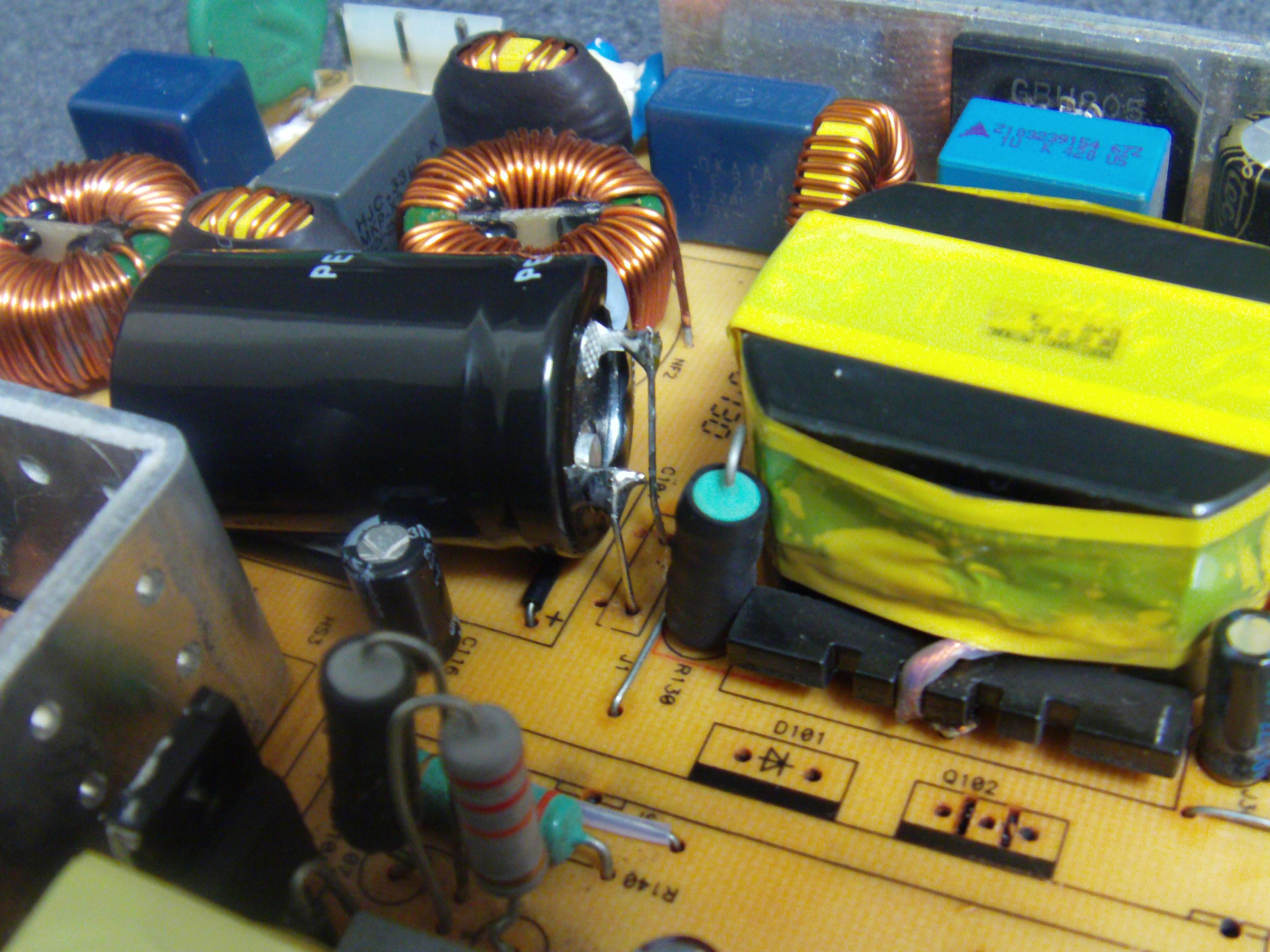

                      All screwed up now.
                      I had a look and couldnt find anything blown? Hoping it was just the surge of power to the new components, all voltages seem good.
                      Had to get a snap in cap and use some legs off another new cap to join it up.
                      I may of associated the pop with a spark, so seen a spark even though there was none. must be bonfire night making me go loopy.

                            #93
                            Re: Baird X47DTV power supply issues
                            Quick pic of bodge job.
                            And the small ruby next to it is what i put in too, original looked very slightly bulged.
                            Do NOT touch heatsinks when testing for voltages as they may be LIVE!
                              #94
                              Did you glue it down? I would glue it down, then solder (makes it easier.)

                                      #98
                                      No need. It died due to poor 180uF, unlikely to be heat. If you open it up again for service, I would replace that other primary cap on the other PSU.
