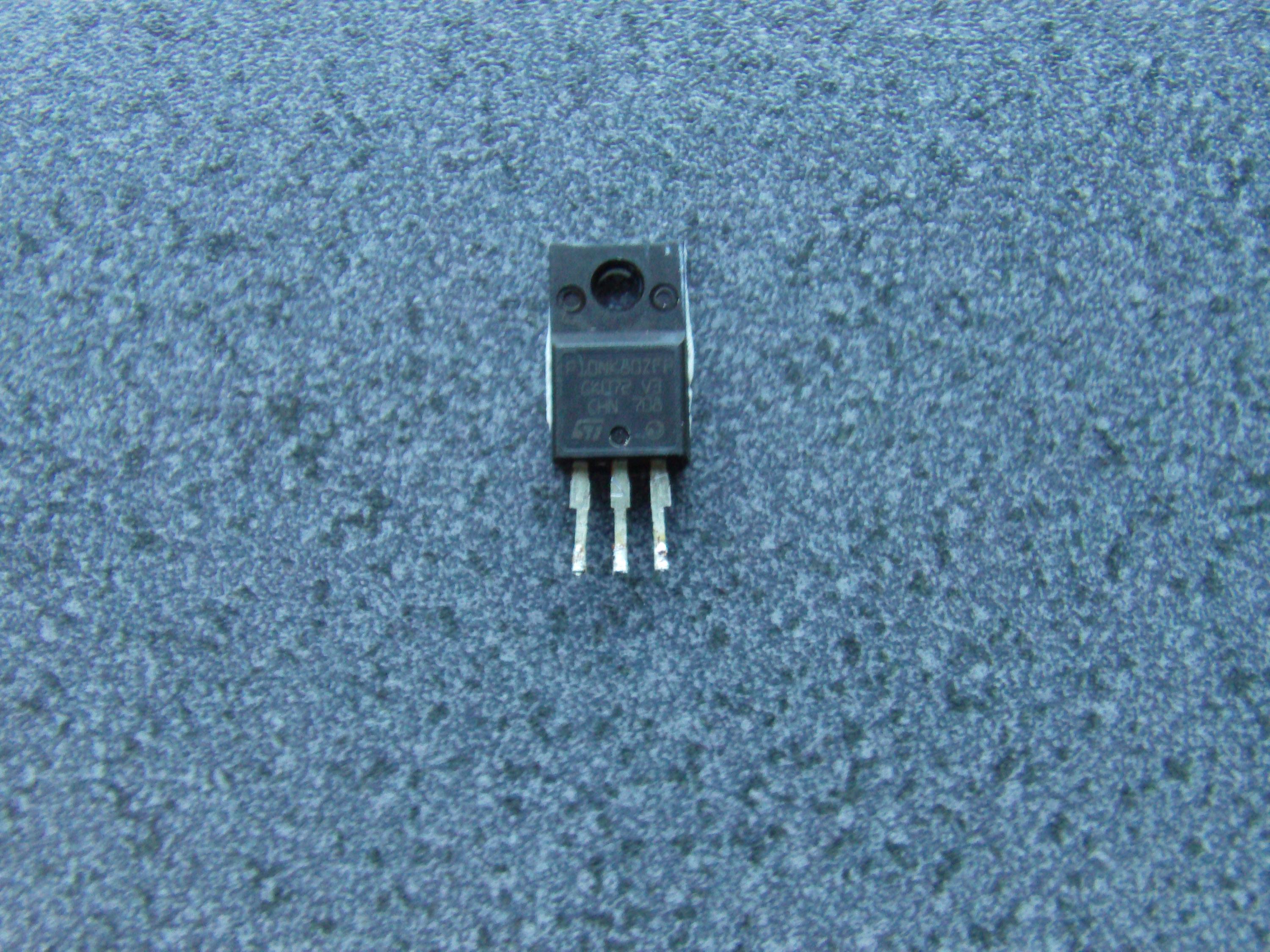

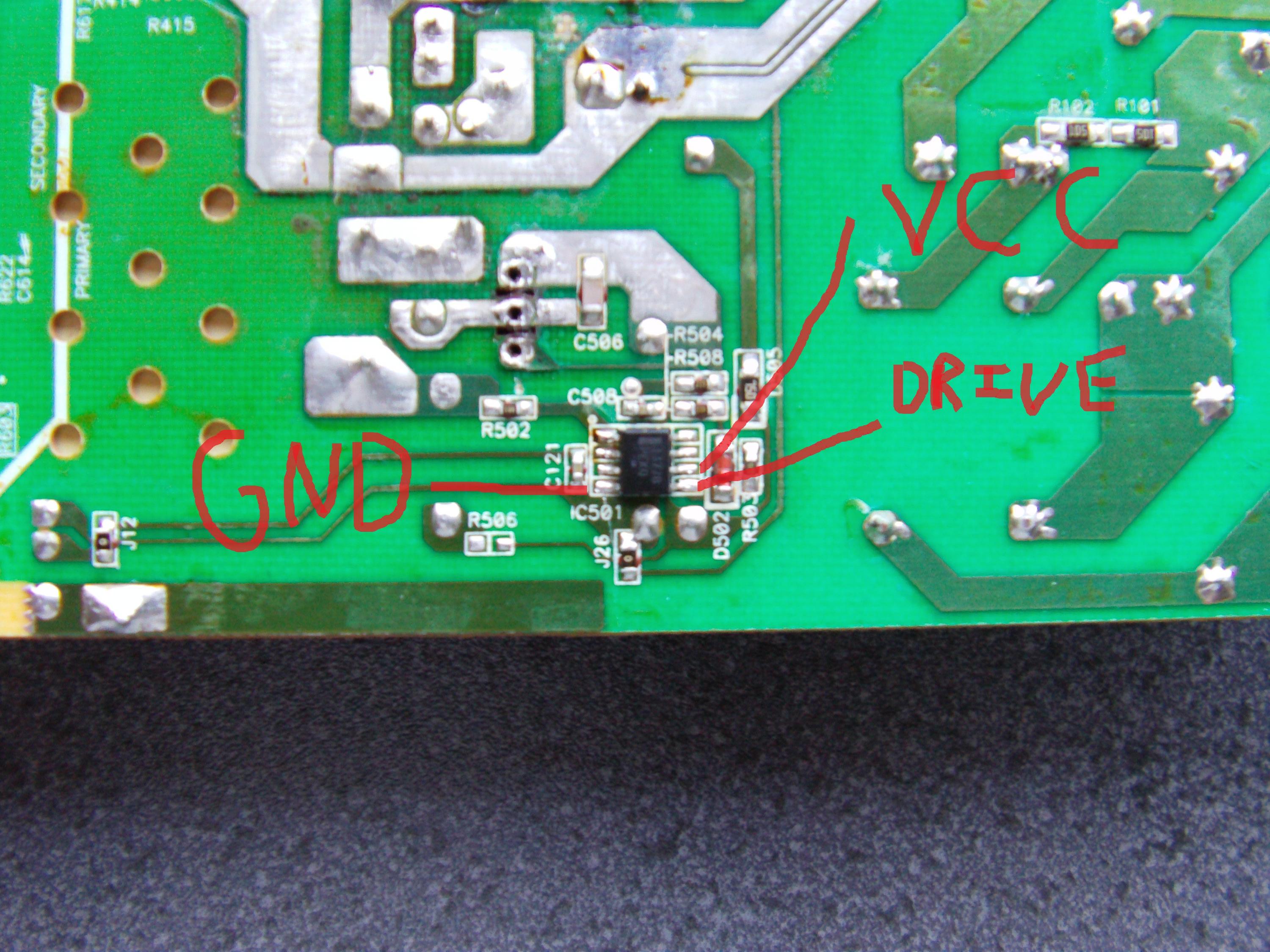

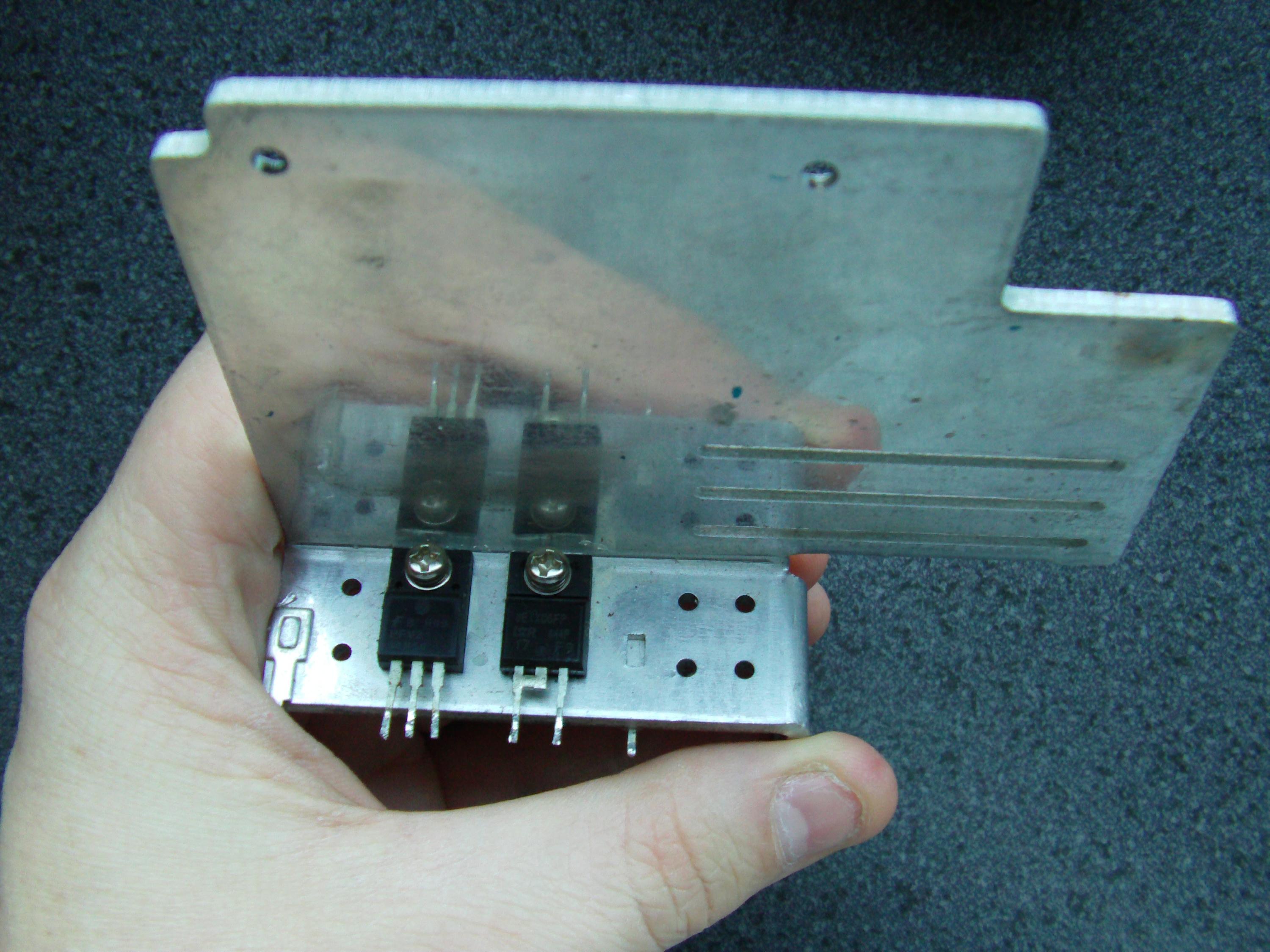

        Re: Baird 47"
        Checked what i believe to be the controller ic, and it checks out ok, on diode test it gives me 150+ to ground and 650+ to vcc.
        Not 100% sure if i used the right pins.

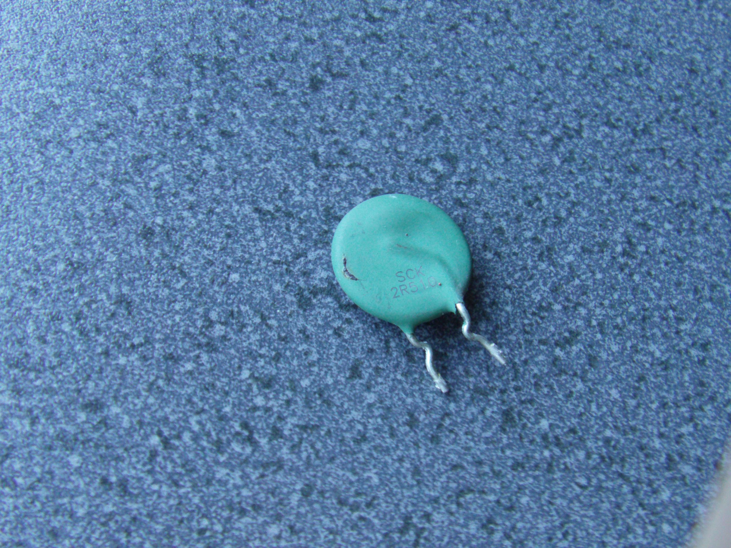

        Also included is the dead mosfet and dead diode (diode is the 2 pin one on the heatsink)
        And the last pic is a capacitor which has a crack in it, will it still be ok to use?
        Sorry about the pics, using a camcorder with no macro.

          Re: Baird 47"
          Try on ohms but I think your controller IC is shot. It is very common as the MOSFET will pass ~325V straight into the drive output pin.
          The other device is an inrush NTC, not a thermistor. It says 2.5 ohm which should be its cold resistance, so measure it when it's cold and check it's about 2.5 ohms (usually 20% tolerance.)

            Re: Baird 47"
            Right again i believe, The ic from drv pin to gnd gives me 149 ish ohms, but on the other working psu i get no reading.
            Gonna start getting expensive
            New psu only about £30, but thats no fun.
