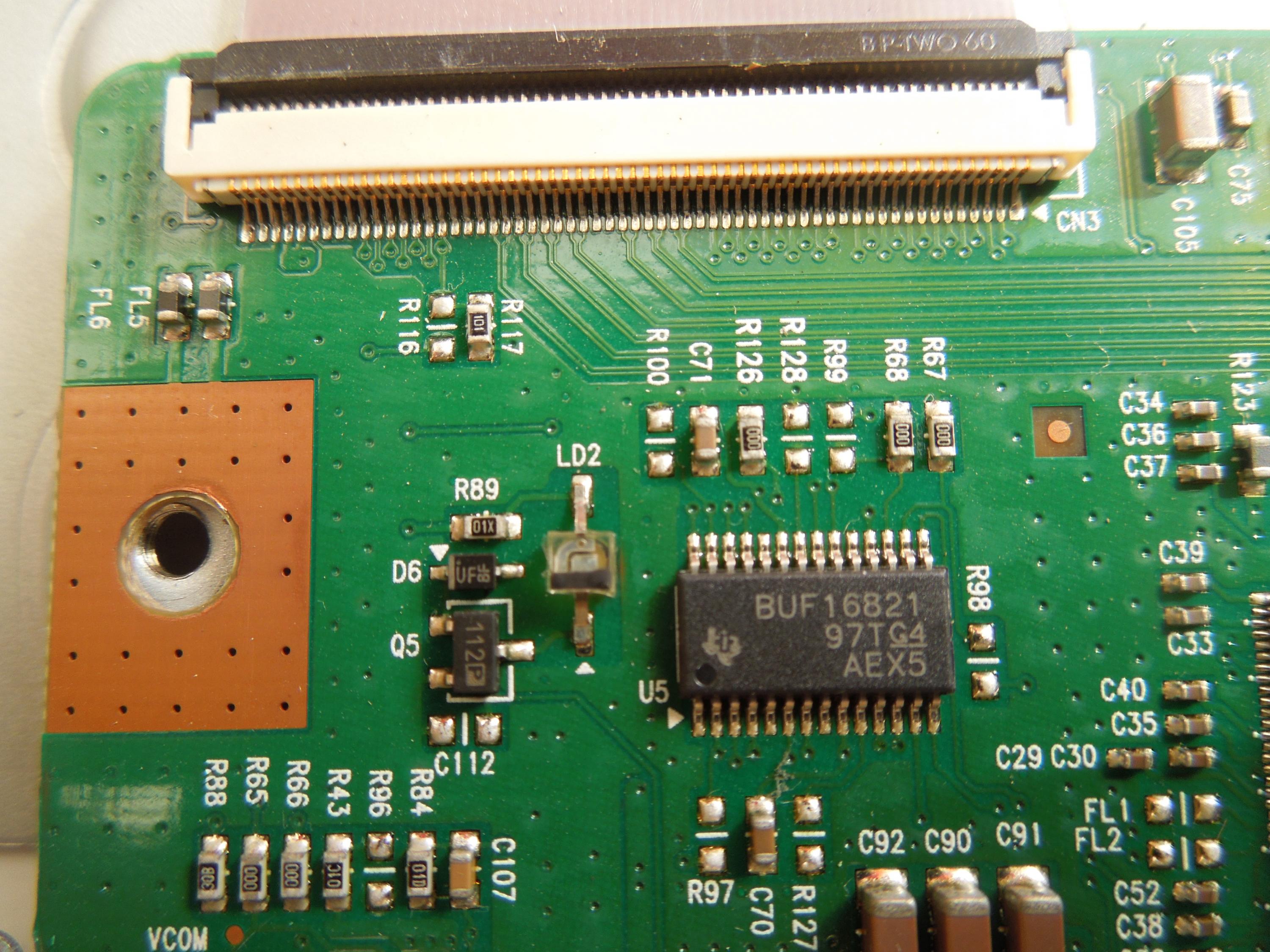

      located stay on for 2 more seconds,it comes from a blue diode on the t-com board that light up very bright blue and go off.
        Re: manuel432
        Boy, I never seen LED on the T-CON board before.

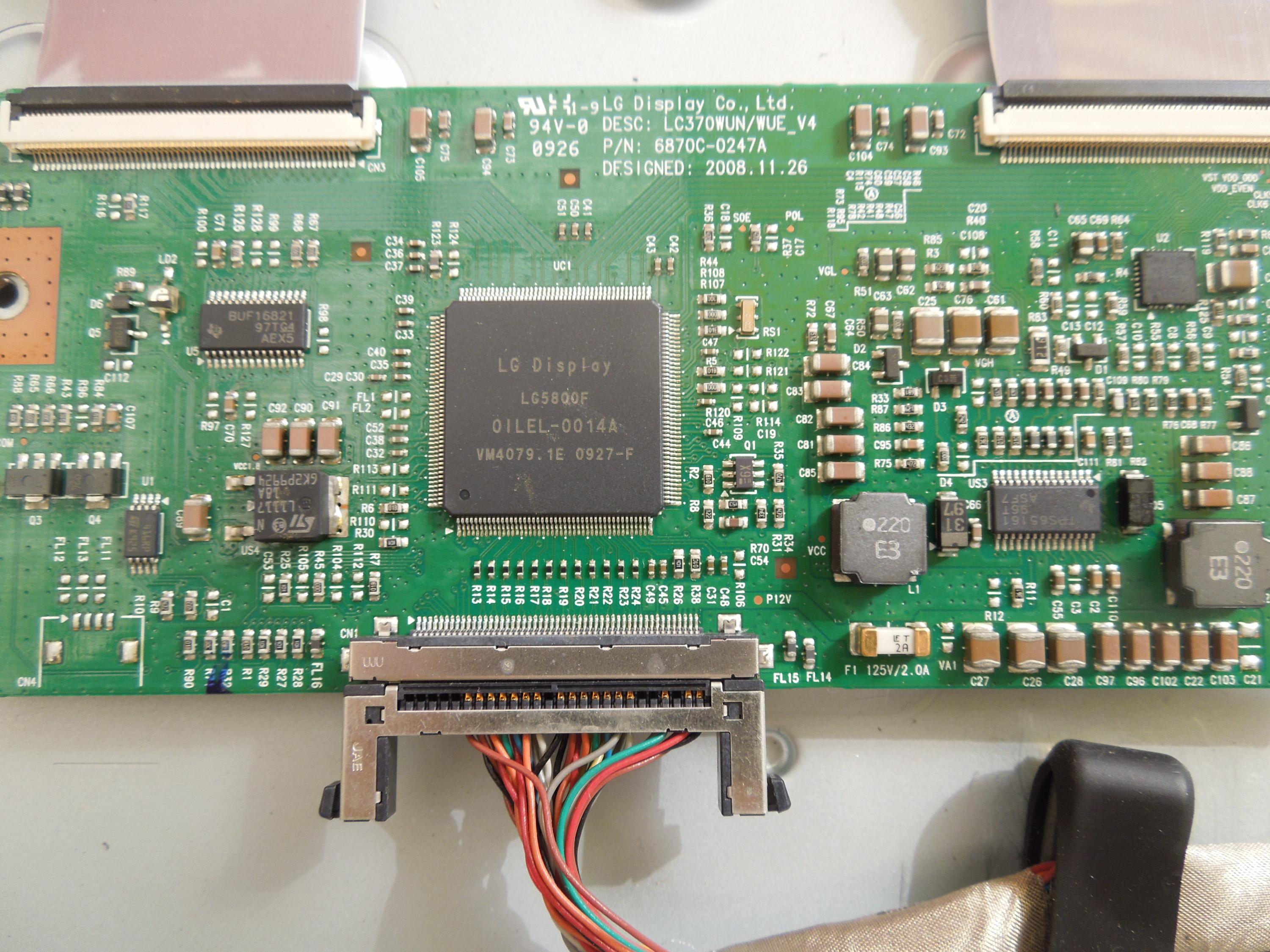

            Please take good pictures of the T-CON board and use Go Advanced to attach the pictures.

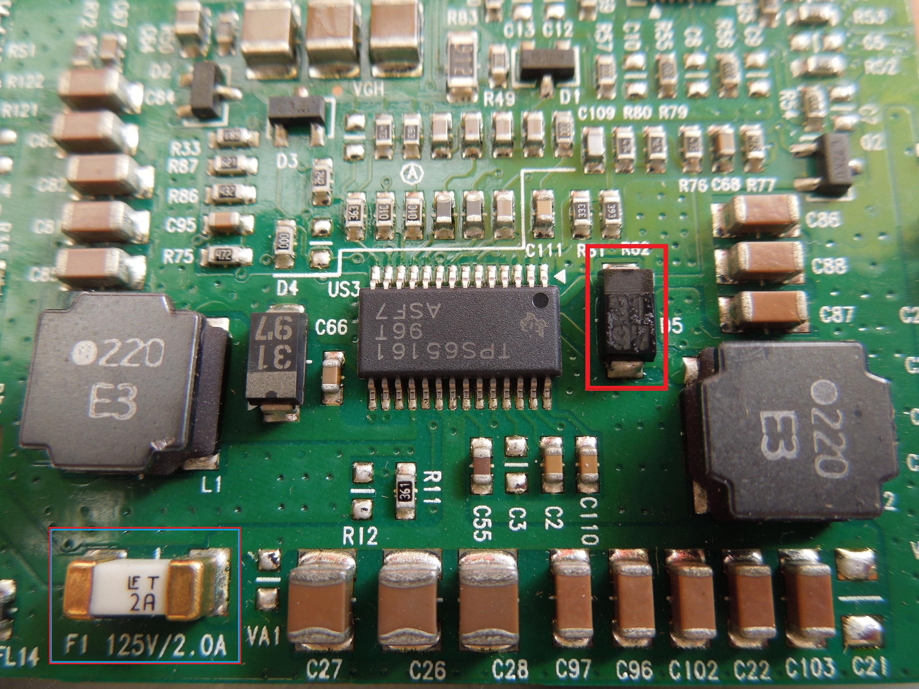

              I toock some pictures, let see if i do this right.

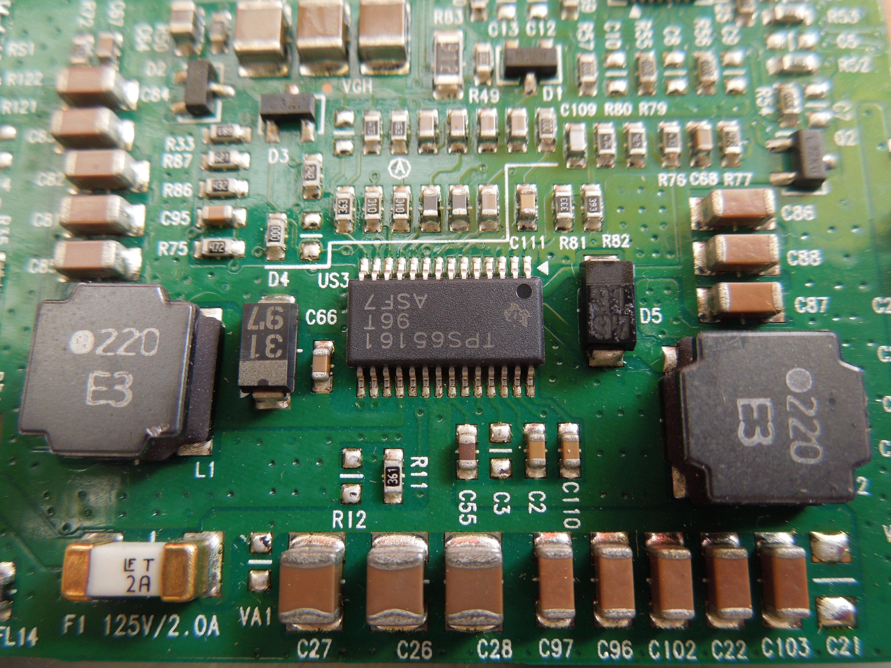

                The fuse on the tcon is in the lower left corner of the picture (F1). I did notice that D5 looks burnt. Is it crispy?

                  I would agree, look at D4 looks very different.
                    Re: manuel432
                    Check the fuse, those two Diode for the dual switching power suppliers. Check the voltages of the US4 1.8V regulator (look at the VCC1.8V pad next to the regulator), the P12V and the VCC test pads.

                      I check the fuse and it check good, check the diodes set the meter dial to
                      diode k2 the red lead at the white band of the diode and got .583 _+1
                      reverse the leeds and got .091_+1 on D4. did the same for D5 and got 0 no
                      reading at all, reverse the leads got.098_+1it seems that I have to replace
                      D5 but I dont have a schematic of the board I dont know the value of the diode or part # or were to buy it they are very small about less than a 1/8"
                      of a inch by 2/8" long they have a # 3197 on top( help on this ) about the
                      regulator do they have the #220 E3 on top end,? how do I check them, they
                      have for legs do I check them up and down or across the legs whid the power
                      on the board (help on this to.) and the vvc pad is that the small square on the bord nex to it.

                          hi!!! had time to work on the t-com as per instruction I check as you said
                          the 12v pad check out good 12V . the regultor pad checks 1.8V. the us4 leg in 3.25V w/ground at the Tv frane, w/ ground at the base of the regulator is 1.45 V and the out of the regulator 1.8V.
