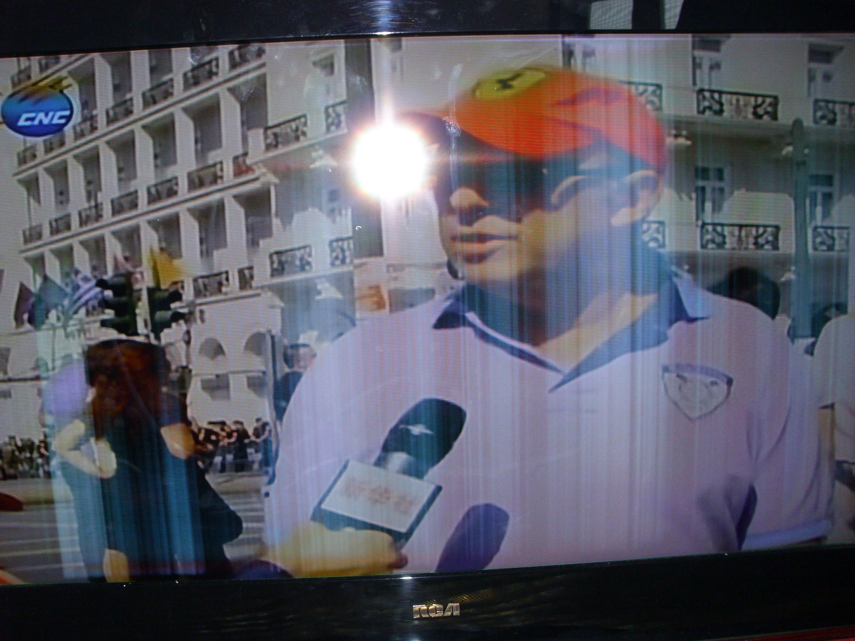

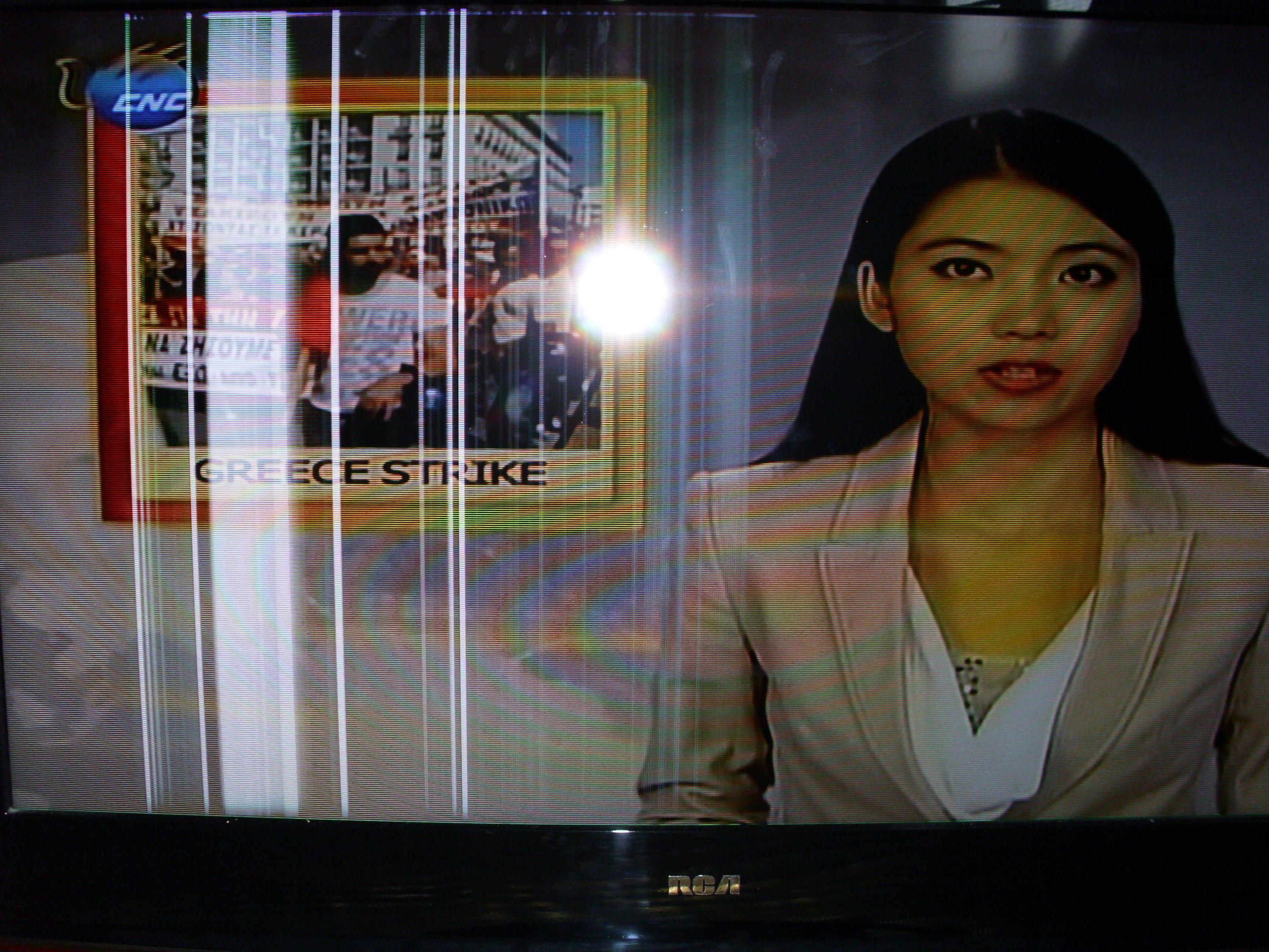

    Rca lcd#ls32d10.
    RCA lcd #LS32d10 with vertical white lines.
    Re: Rca lcd#ls32d10.
    Panel or t-con. If lines move, t-con very likely. If not, probably panel.
