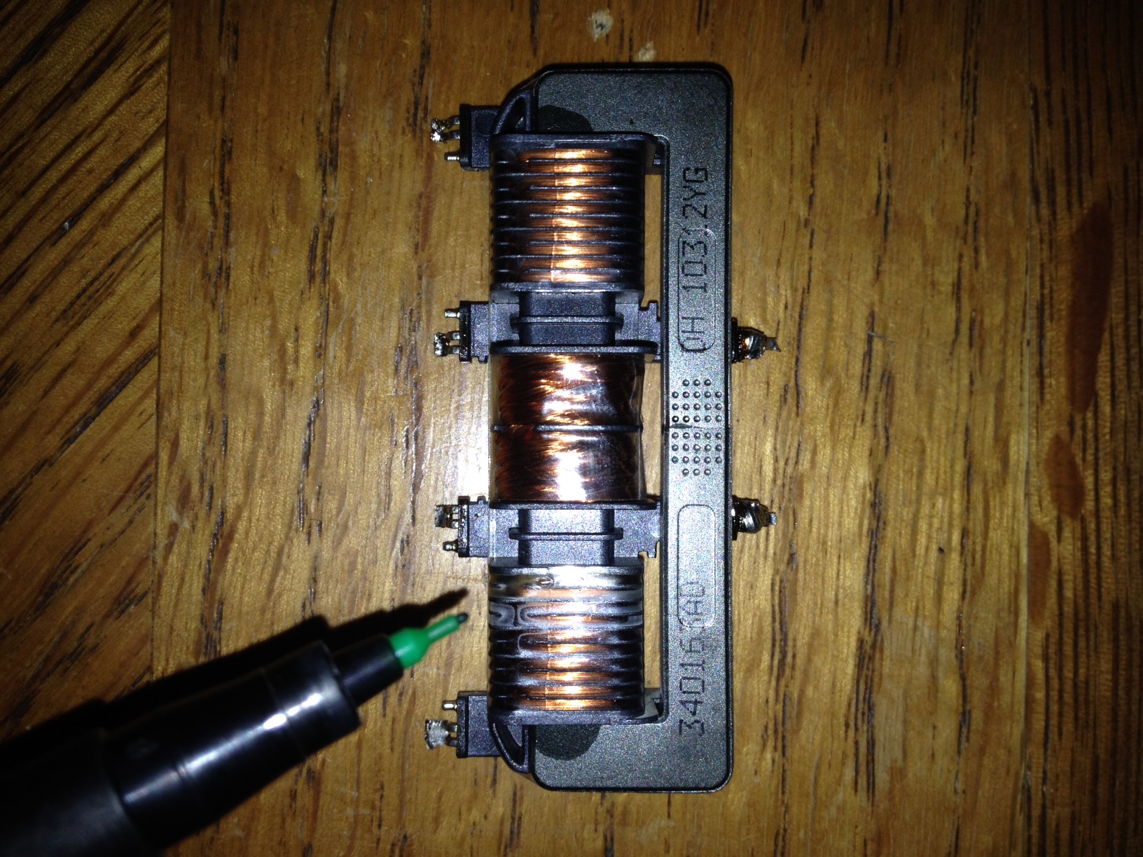

      Does it look anything like these?
      http://s807.photobucket.com/albums/yy352/budm/Dynex/
      • jonnyred06
        • Aug 2014
        • 2
        Re: DYNEX TV - Please Wait....then 3 Seconds to Black
        Same problem with my Dynex, regarding the "Please Wait", then black.
        Opened up my tv and started looking for damaged parts.
        The above pictures from BUDM shows a "burnt high voltage winding" on one of the removed parts. Found the same looking problem in my tv and removed the part. Can somebody help me figure out what this part is, what it does, and anywhere I can find a replacement?
