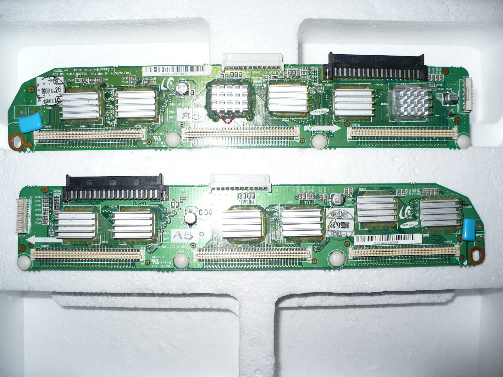

    Glue around the buffer heat sink
    tom66, I see some kind of hard, flexible but removable glue around this chip's heat-sink. do you happen to know what kind of glue is used around this heat-sink?

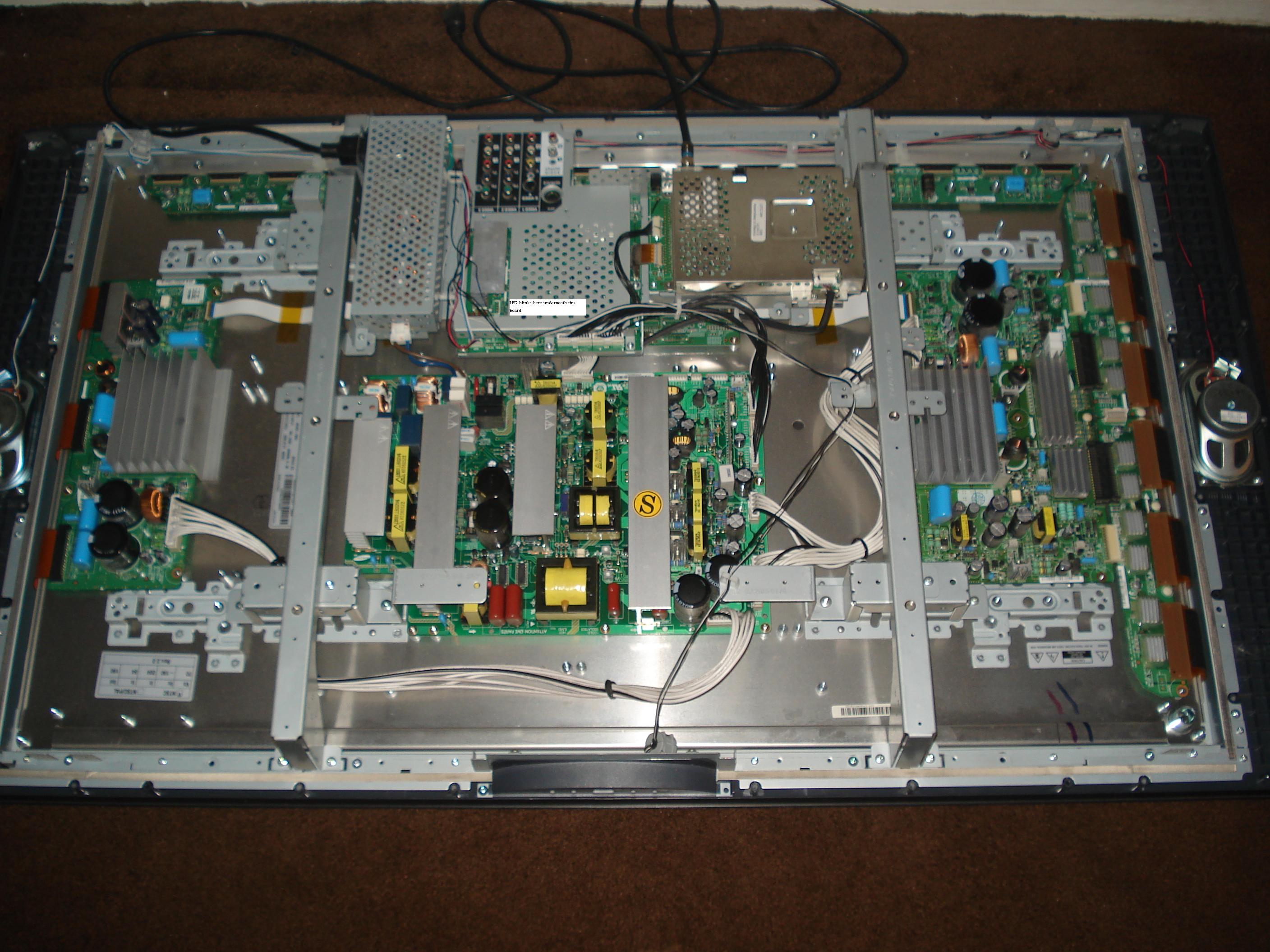

      Finally I have received the y-sus and both buffers today. I put the together but no picture or light on the screen.
      Power light stays solid, does not blink anymore. But led underneath the logic board still flashing.
      X-sus and y-sus has buzzing noise coming from them..
      Tom66, what could be the problem ? has any clue?

              Looks like x-sus and y-sus heatsink not heating up. But buffer board heats up.
              Do you know if the tv will power on or not if my X-SUS is bad?

                    Re: sanyo DP42746 Plasma TV 12 blinks with Y-Sustain Connected
                    If you get no picture, expect no heat from either sustain as they aren't driving the plasma panel.
                    I have had heatsinks on boards stay cool with a dark picture. It's not uncommon.
                      I hear buzzing from x and y sustain. No heat
                      Buffer heats up.
                      No blink on power board. All output from power board within specification.
                      But no light on screen , no video at all. This is strange. Could it be my panel? I don't even see a blink/flash on the panel.
                        does plasma TV has inverter board and back light just like LCD tv? I see two boards at the bottom of the panel near the logic board. Are those inverter board?
                          The 2 boards at the bottom of the panel are your E & F buffer boards.
                            can those be bad? It seems like everything is working perfectly. Infact I bought y-sus and y-buffers. But when I push power button I get nothing. This is strange.
                              E&F boards rarely fail. They could fail, but they would usually cause bars on the screen.
                                Buffer heats up.
                                The only thing i can think to suggest is look at the top left corner on the back of the panel and see if the glass bulb inside the sleeve is broken/cracked.
