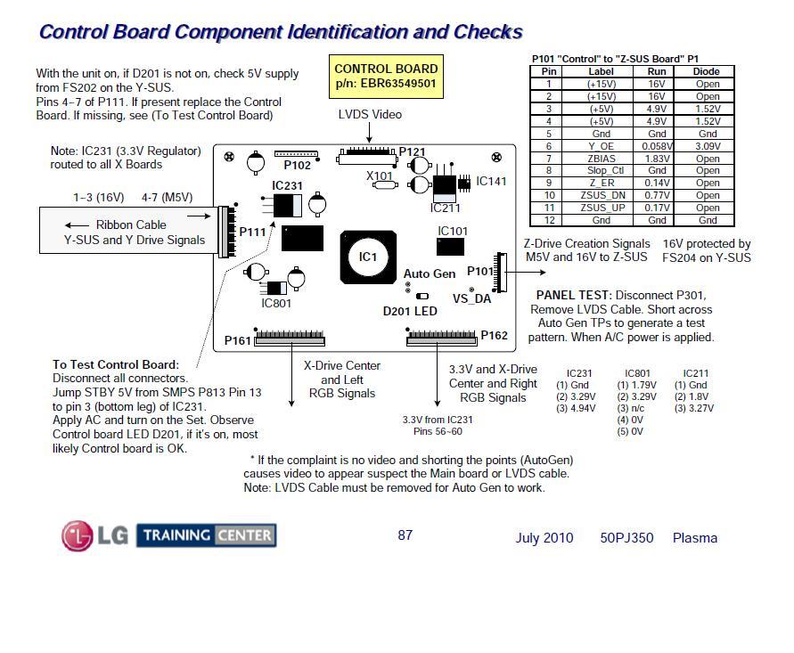

        I have this same LG set as well (50PJ350) and I recently put in a new power board after the screen went dark and got no sound. After putting in the new board, I still get no video, no OSD, but now I get static through the speakers, which is different than before. The static sounds like "snow" when you change channels with no input connected to it.
        I have taken the voltages off the top off the rail and they are all solid and stable (VS=207, VA=60, M5V 5.1, etc), plus ALL the fuses on the power board, and all the sustain board show continuity and are not blown. For what it is worth, the main board shows the optical out glowing when the set it on. Lastly, when I try and use the remote to change to a different channel or input and I get nothing.....no flash on the screen, no image, no light at all on the screen. I fear that I have a bad panel, but was hoping that you could help me perform some further troubleshooting before I jump to conclusions. Thank you for your time and consideration in advance.
          Re: LG 50PJ350 Power Supply Repair
          Have you checked your Y-Sus (-Vy and VSC) and Z-Sus (Vzb) output voltages? Also, see the attached control board check.
