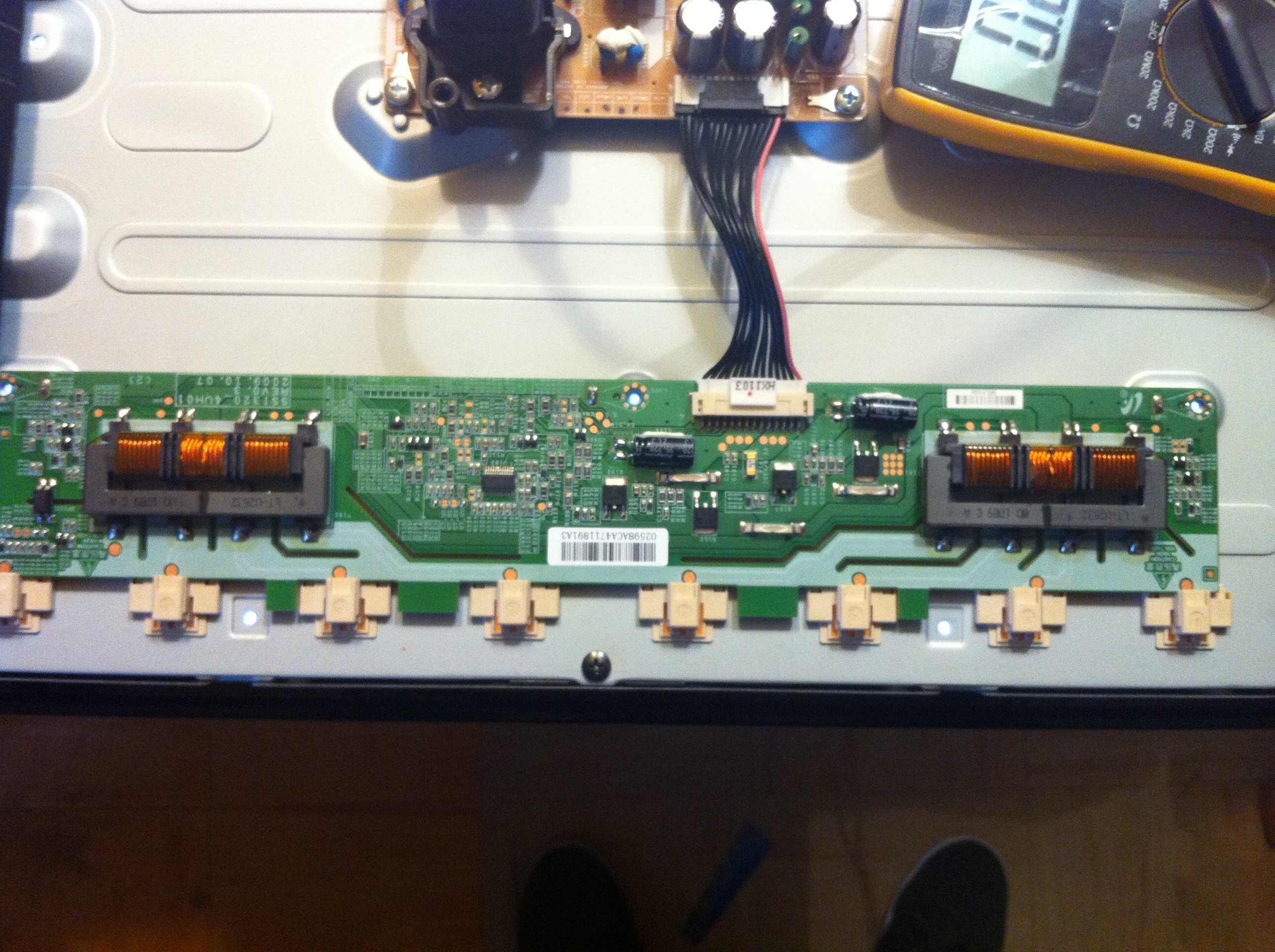

    I have a Samsung LE32C450 which has a black/dark screen. The sound works (has a startup sound), and the backlight appears to be working.
    I have checked for visible damages on capacitators, but cannot see any visible damages or leaks.
    Any tips on what to check? I am quite new in the electronics field, but have repaired a tv before, and know how to solder.
    Thanks!

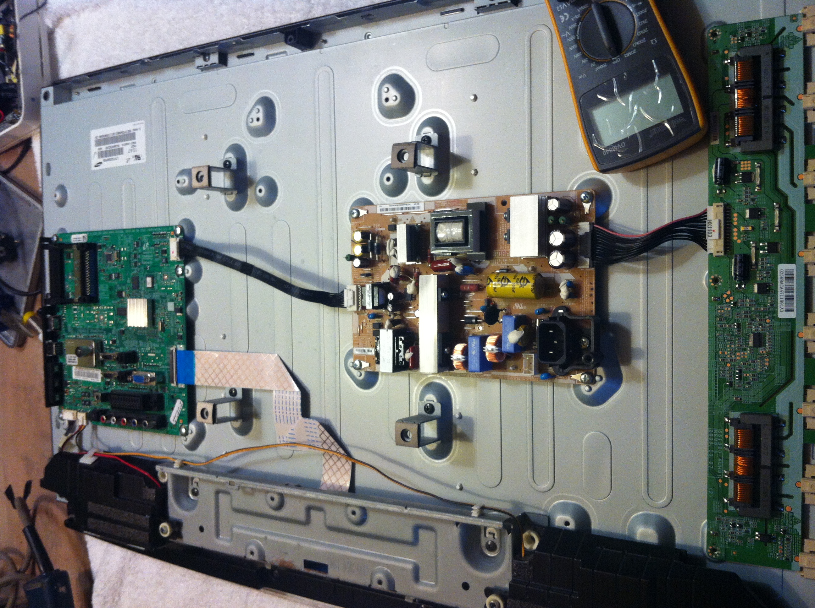

    Re: Samsung LE32C450 - No Screen - Has Backlight - Has Sound
    Please post good claer pictures of the back of the TV so we can see how all the boards are hooked. You may have dead T-CON board.

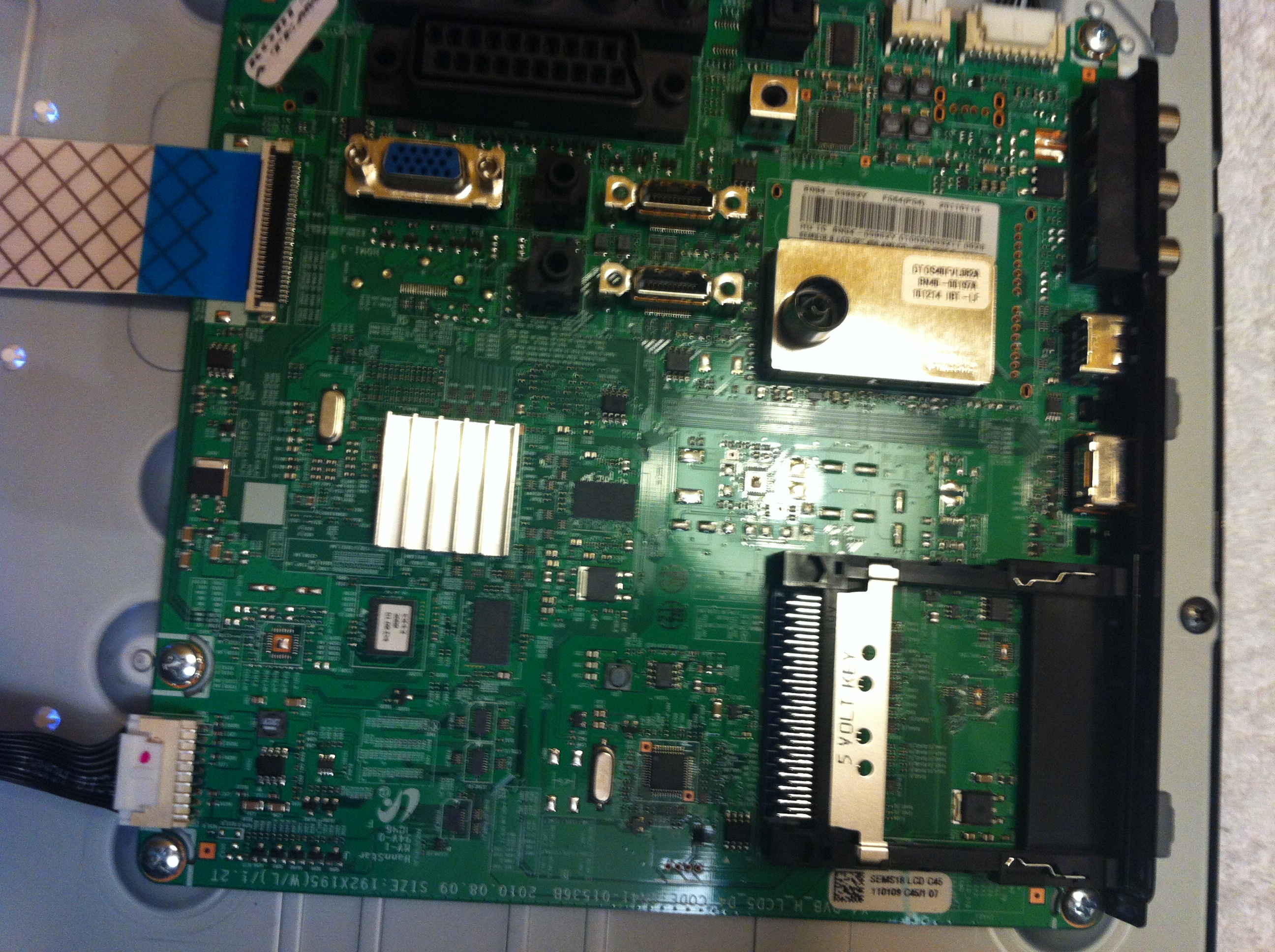

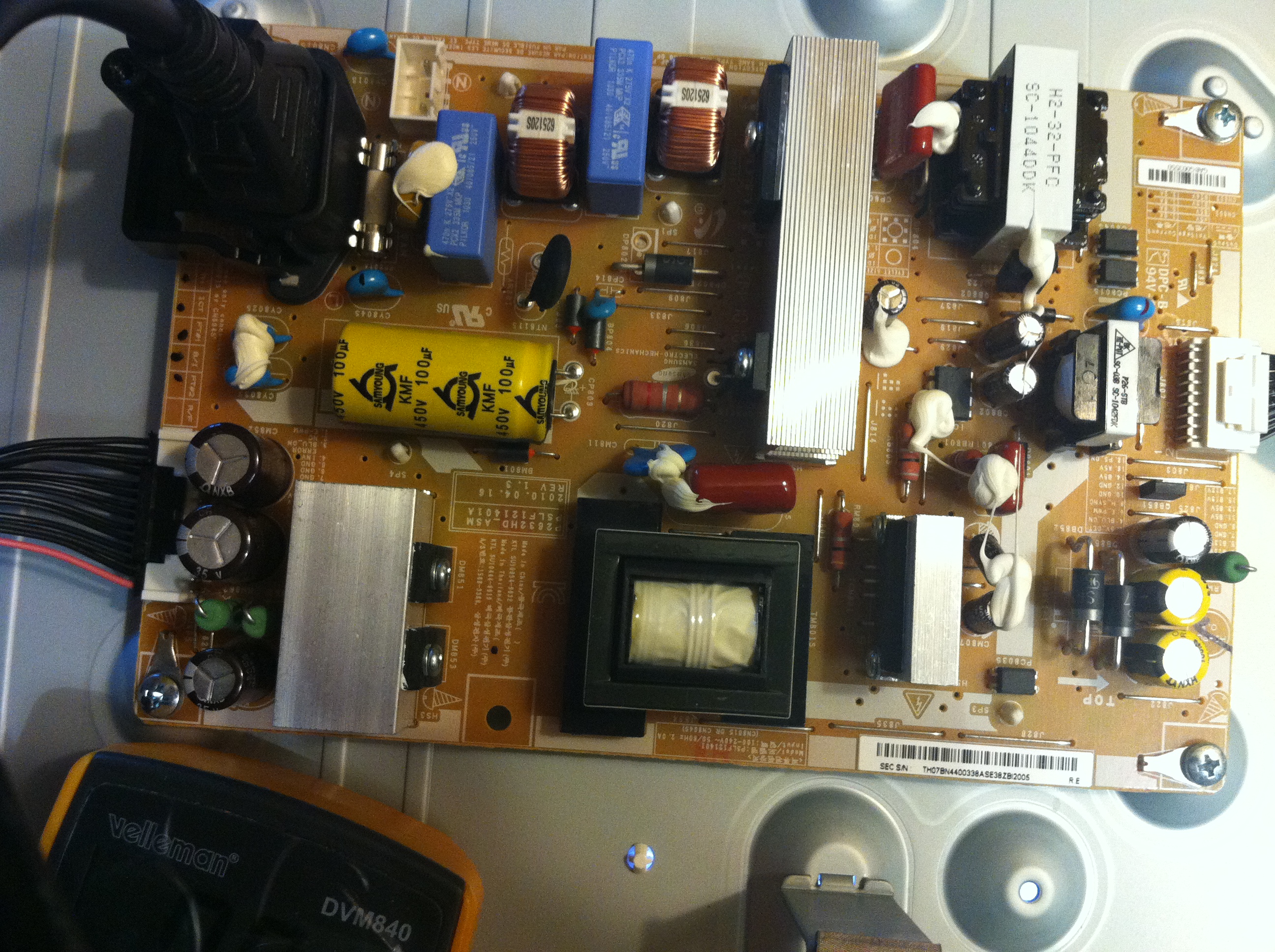

      Cant seem to edit my first post, so here are the images.
        This TV has the integrated T-CON board LCD panel assembly which will be real hard to troubleshoot the T-CON. For now you can see if the T-CON is getting the DC voltage feeding it. On the first picture of the flat white ribbon cable, the first pin on the top of the connector should have DC voltage on it, it should be either 5V or 12V. Black probe of the meter will be on the metal chasis of the TV, be real careful not to slip the probe. Also take the voltage reading on the last pin on the bottom.
            There is fuse on the T-CON board but you will have top remove the screen to get access to the T-CON assembly, this is the low end SAMSUNG TV.

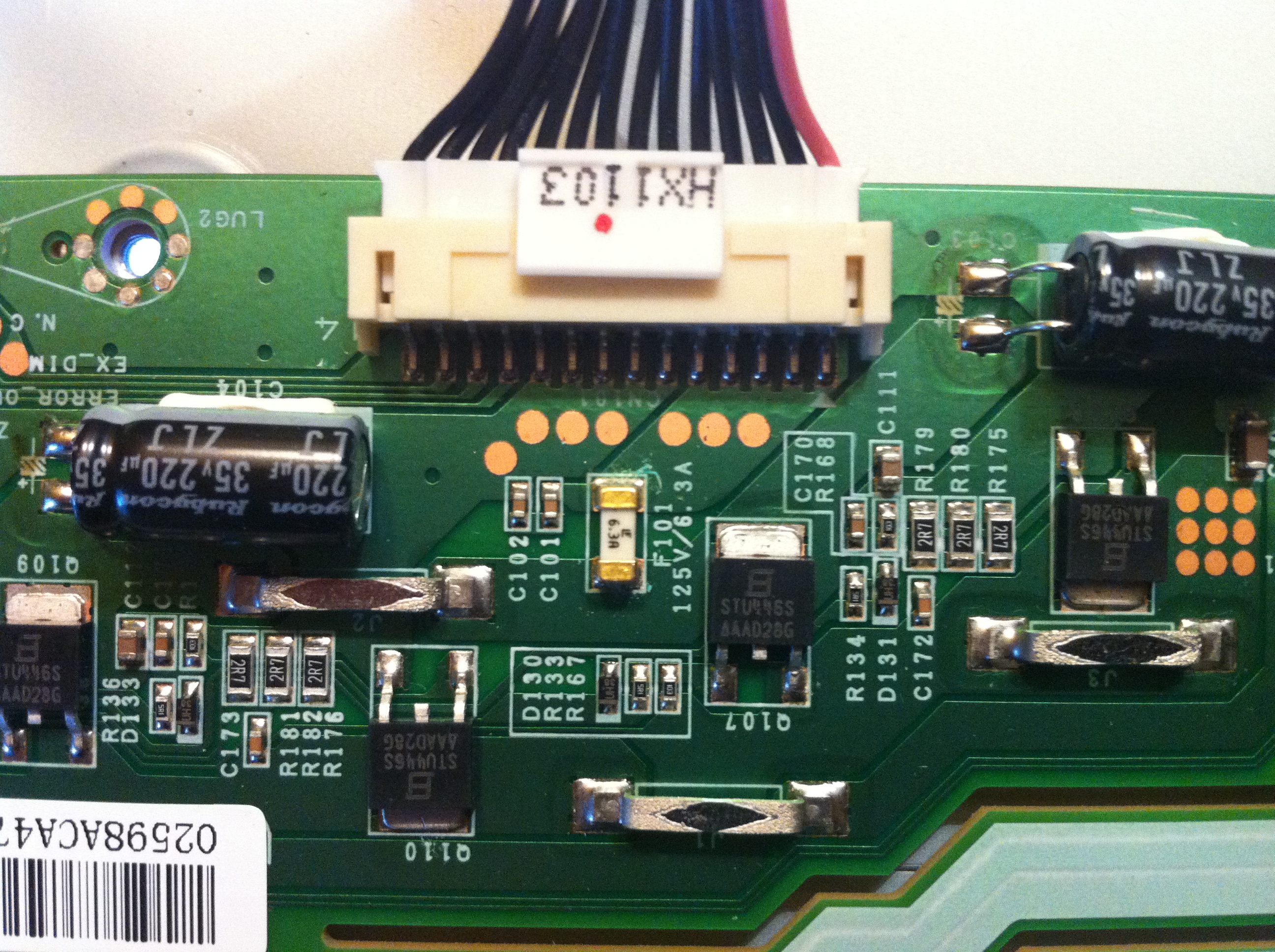

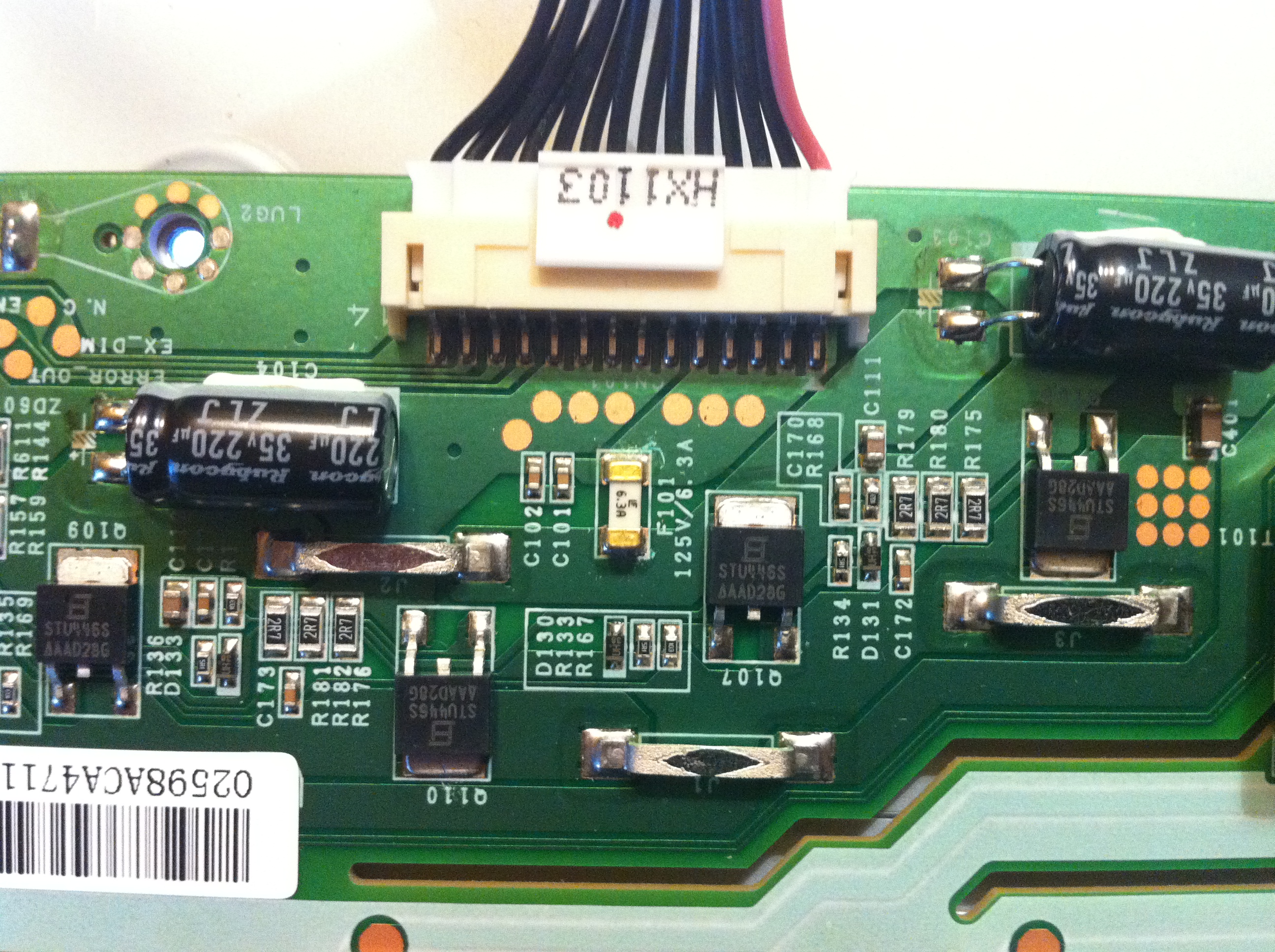

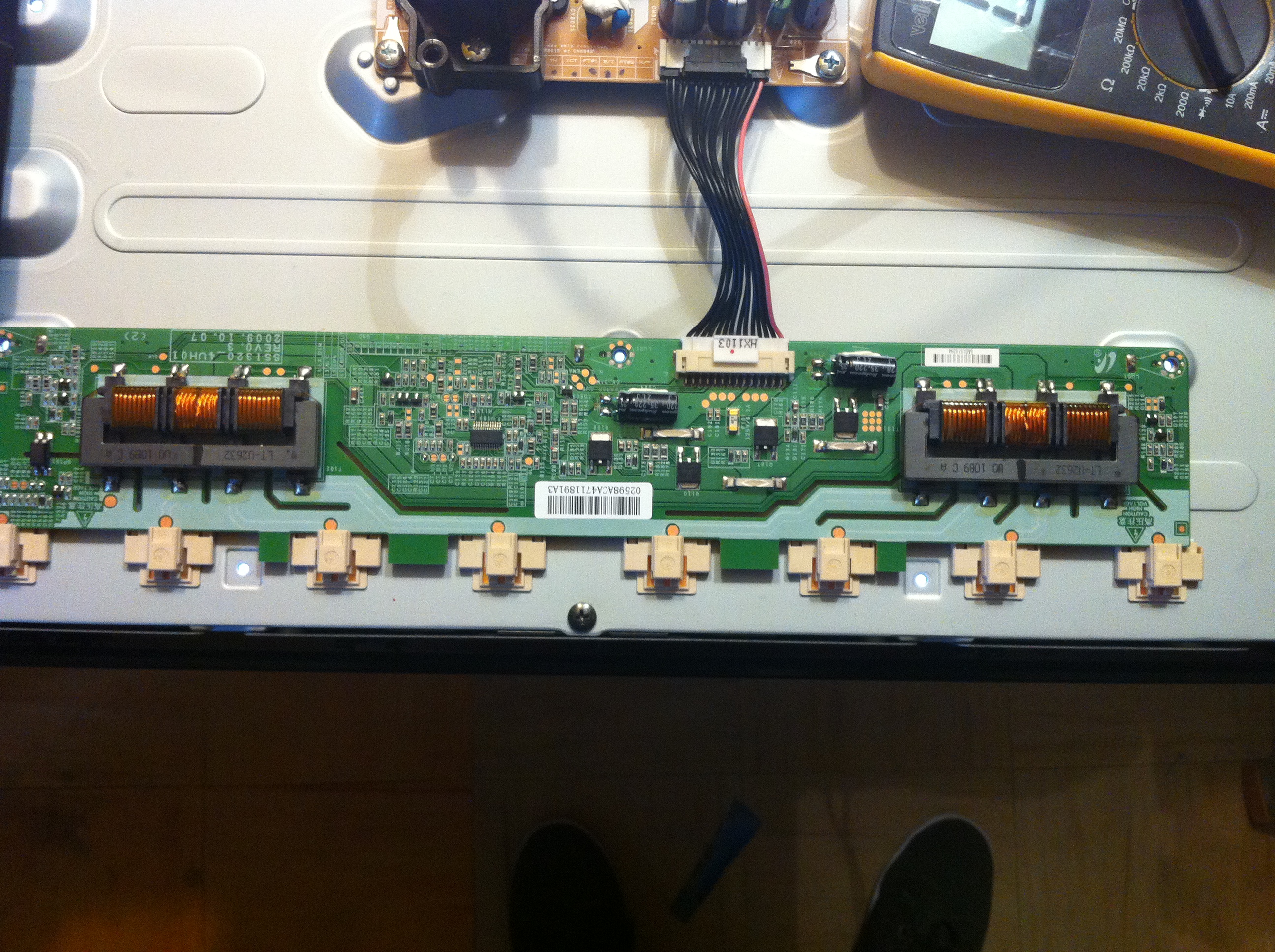

                Picture number 2, 4, 5, 6 ,7 are the picture of the backlights inverter board.

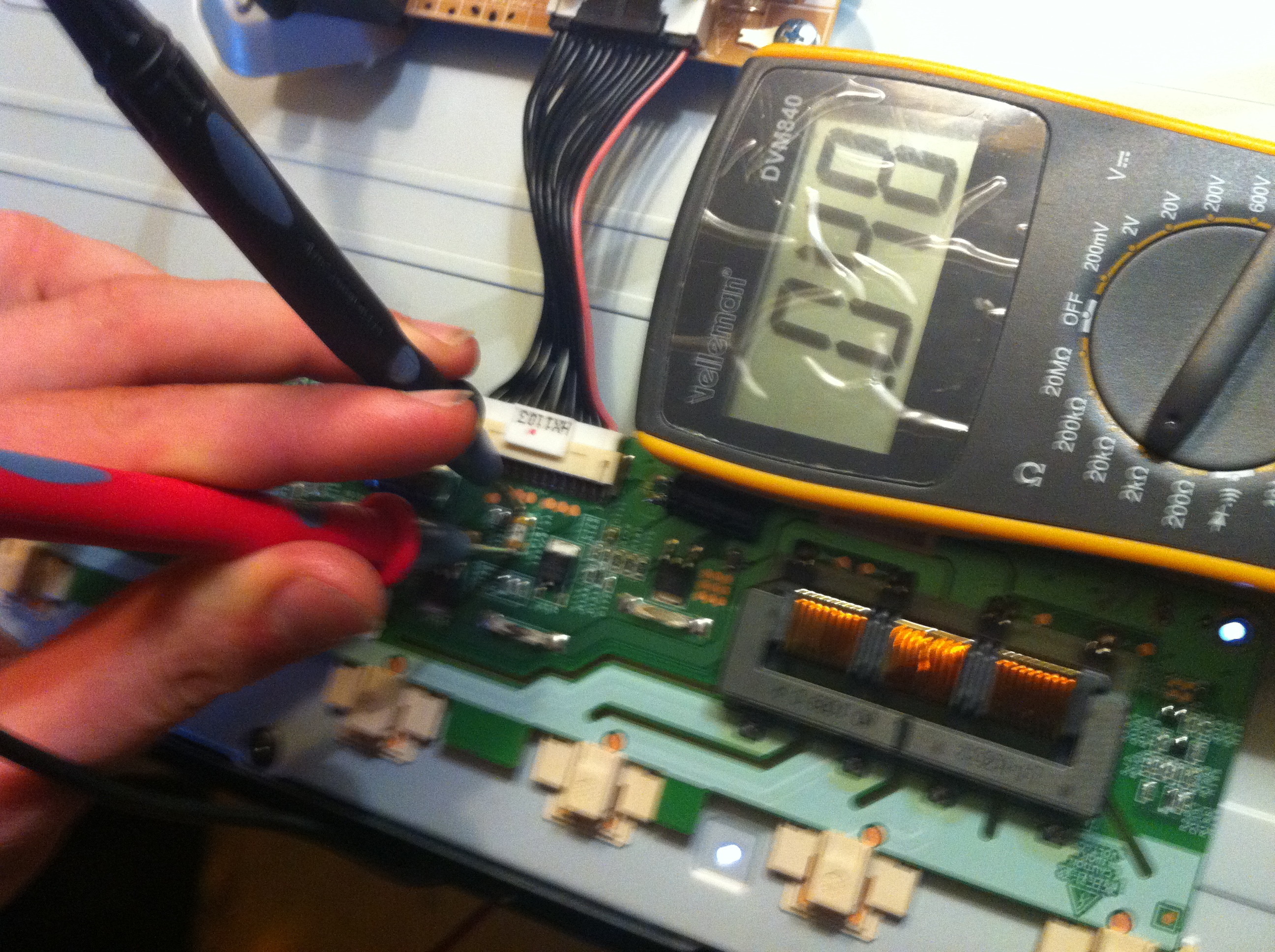

                  i checked, it is getting 12v, so that should be ok. I also can see the f1 fuse, and might be able to troubleshoot that.
                        can you get to the fuse easy if so muti meter on dc volts black probe on metal chasis of the TV and put red lead on 1 side of fuse note voltage then put red probe on the otherside of the fuse note voltage.
                        • st33n
                          • Sep 2012
                          • 22
                          • NL
                          Thanks, Both sides are giving 12.16v.
