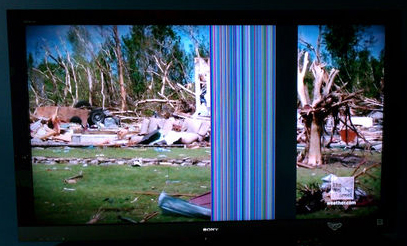

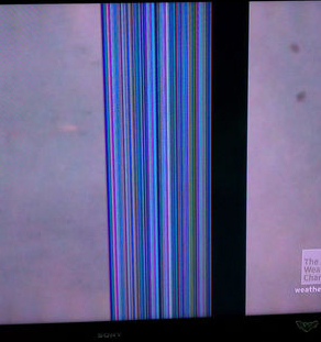

    Sony Bravia KDL-60EX500 verticle lines?
    I do not have this set physically in front of me....just trying to help troubleshoot it. Was told "DUE TO EXCESSIVE SHAKING OF THE TELEVISION BY CHILDREN, A MULTI-COLORED BAND STARTED SHOWING UP IN THE MIDDLE"
    This look like a internal problem or is screen shot?
    Re: Sony Bravia KDL-60EX500 verticle lines?
    Probably bad screen. If lucky, could just be loose/misplaced T-con cable; it looks like it might be as if you look carefully you can see the lines go from half way to three quarters exactly (or so it appears) and there are usually four T-con cables so one loose could explain it.
    Ouch, not a cheap TV to have damaged by kids!
    • Steelhack
      • May 2012
      • 24
      They sold it for parts before I ever got to look at it....oh well
      Hack
        Well, I hope they can save a 60" from the dump rather than just scrapping it for parts.
