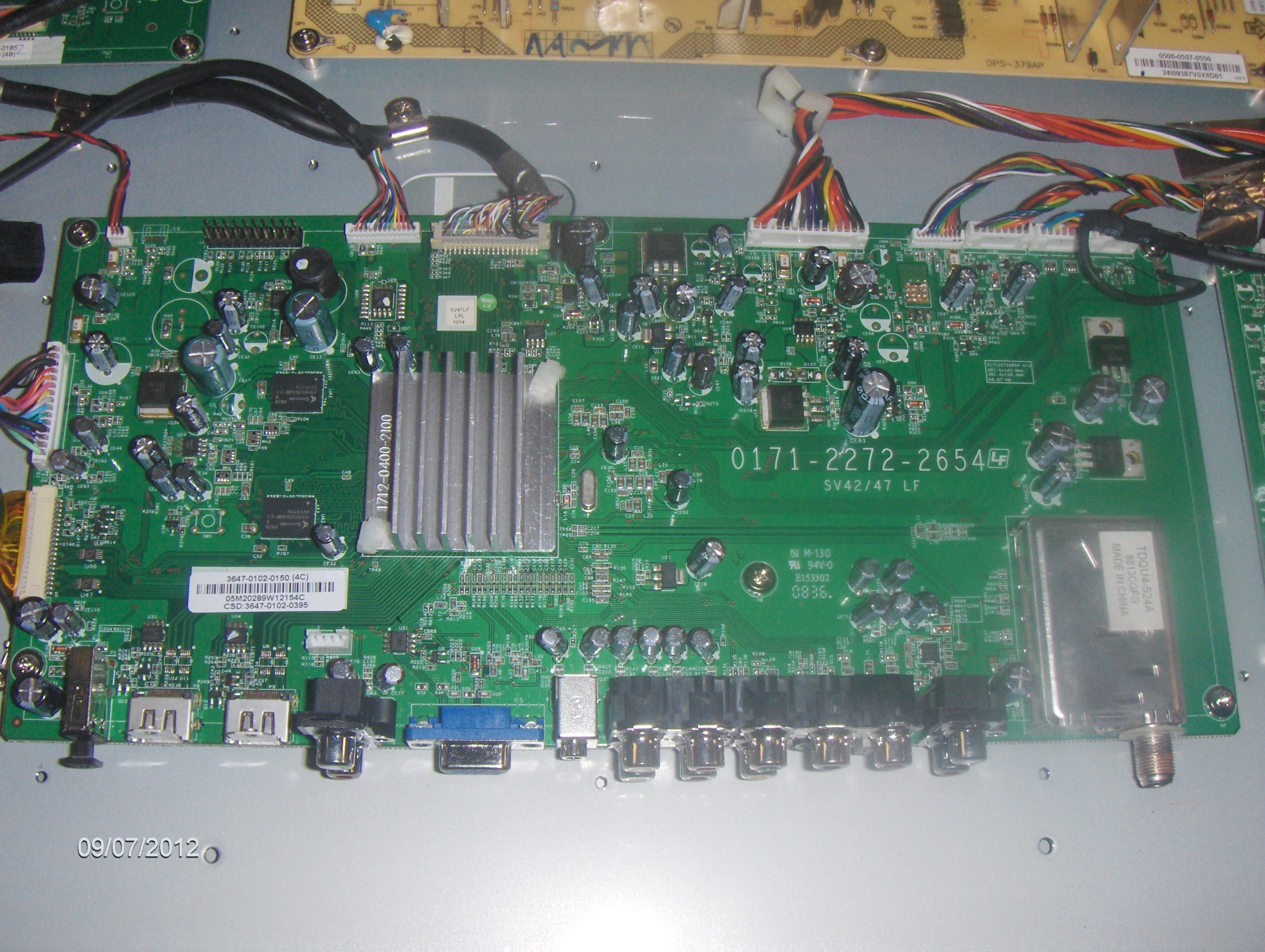

    I have no voltage out of the power supply except for the 5.5Vdc at the stand by. I checked voltages regulators on the AV main board with the following results
    U20 V1, 2.75, VO, 1.25
    U15 VI 2.95 VO 1.25
    U16 nothing in or out
    U21 VI 2.5 VO 1.26
    U19 VI 3.77 VO 1.25

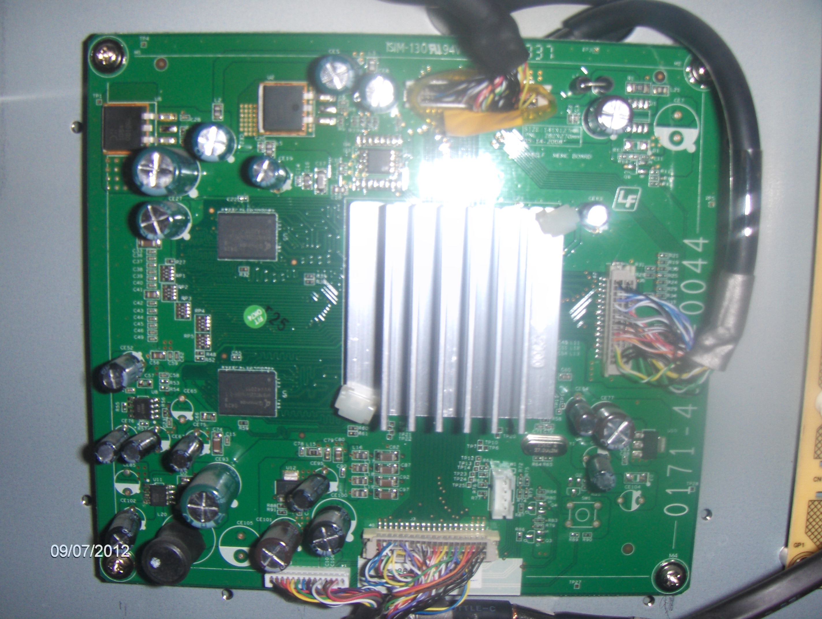

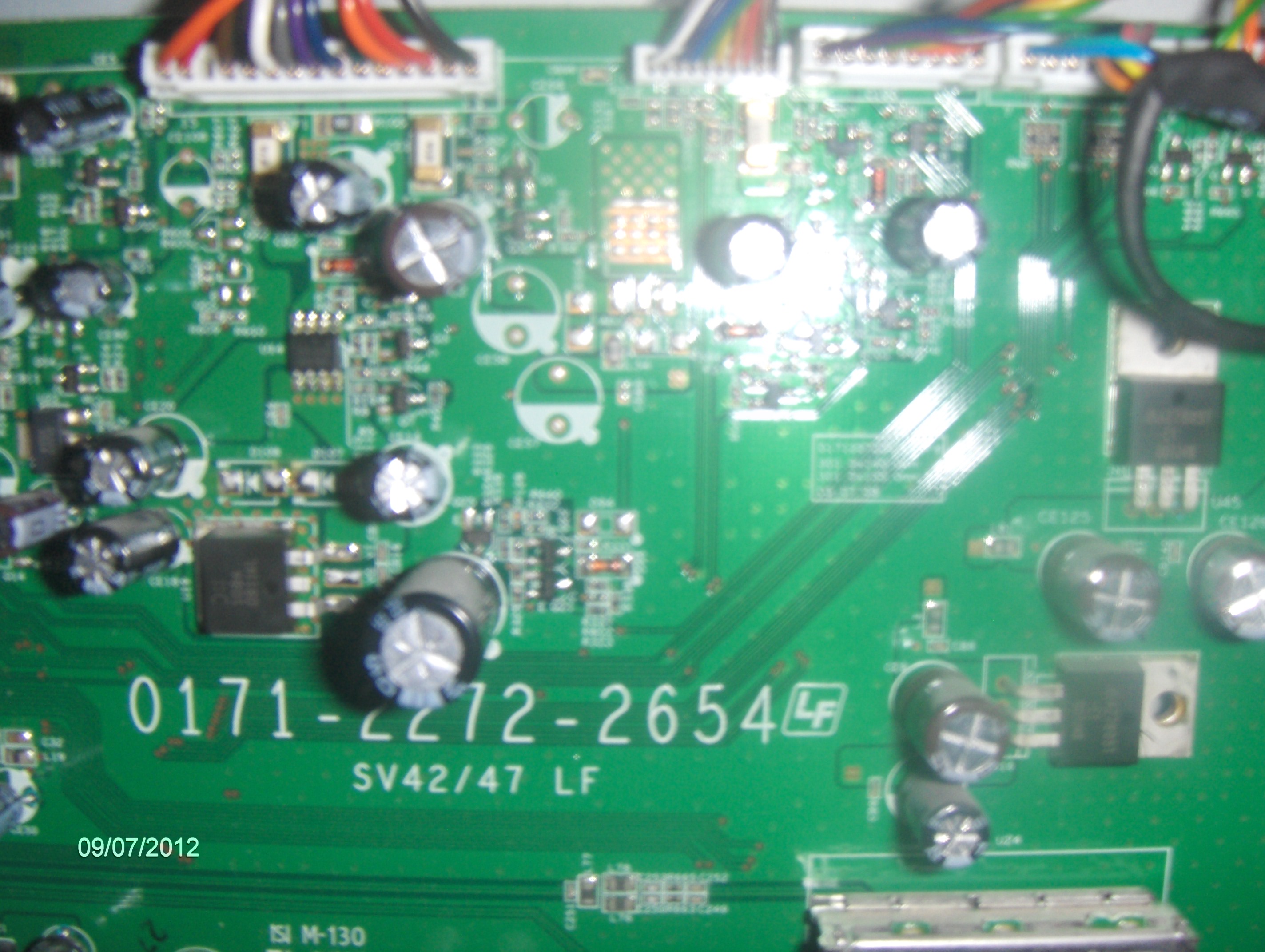

    I have checked all the fuses and they are good.

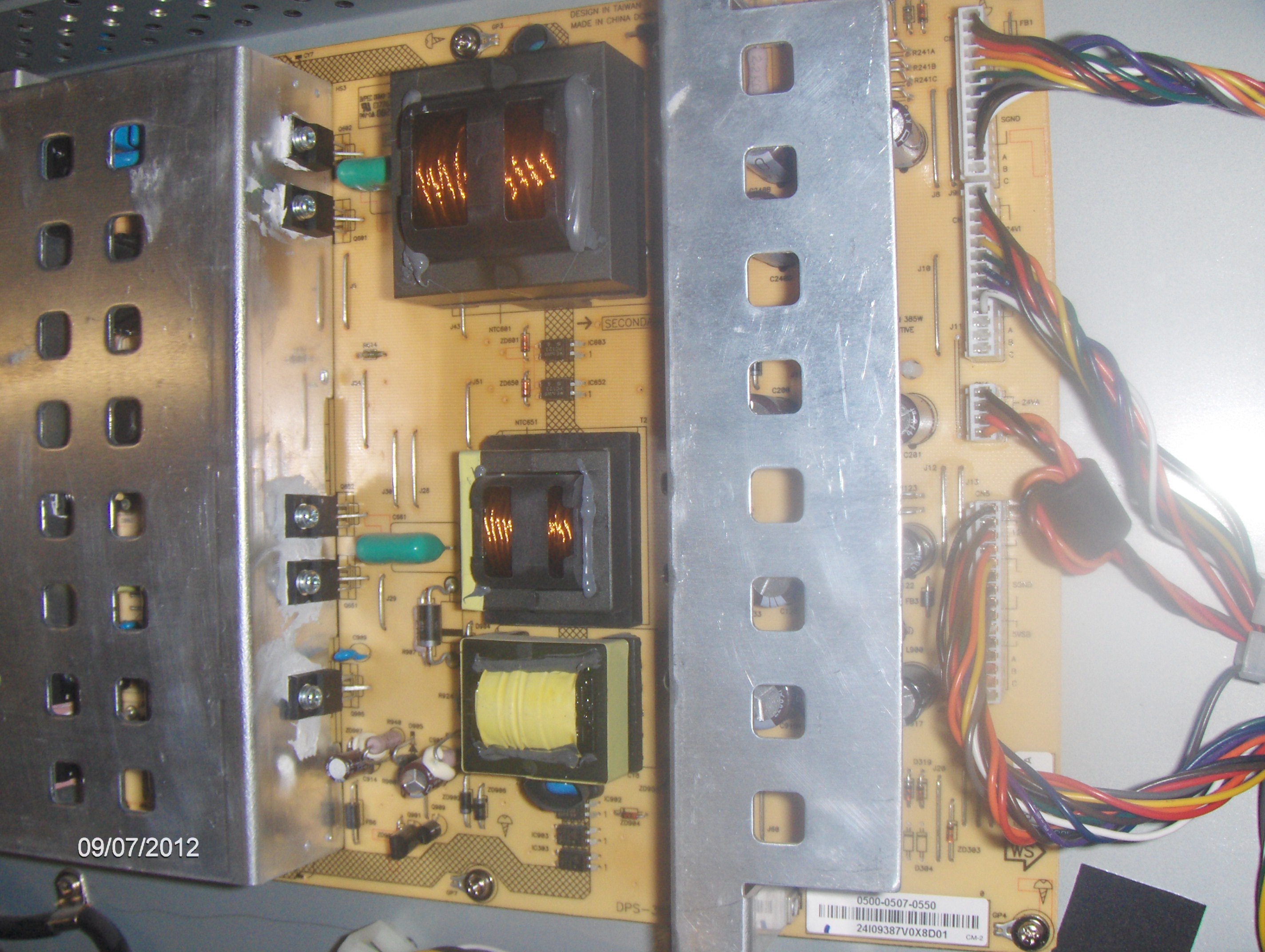

    In the first photo the middle fuse is good but no voltage to it

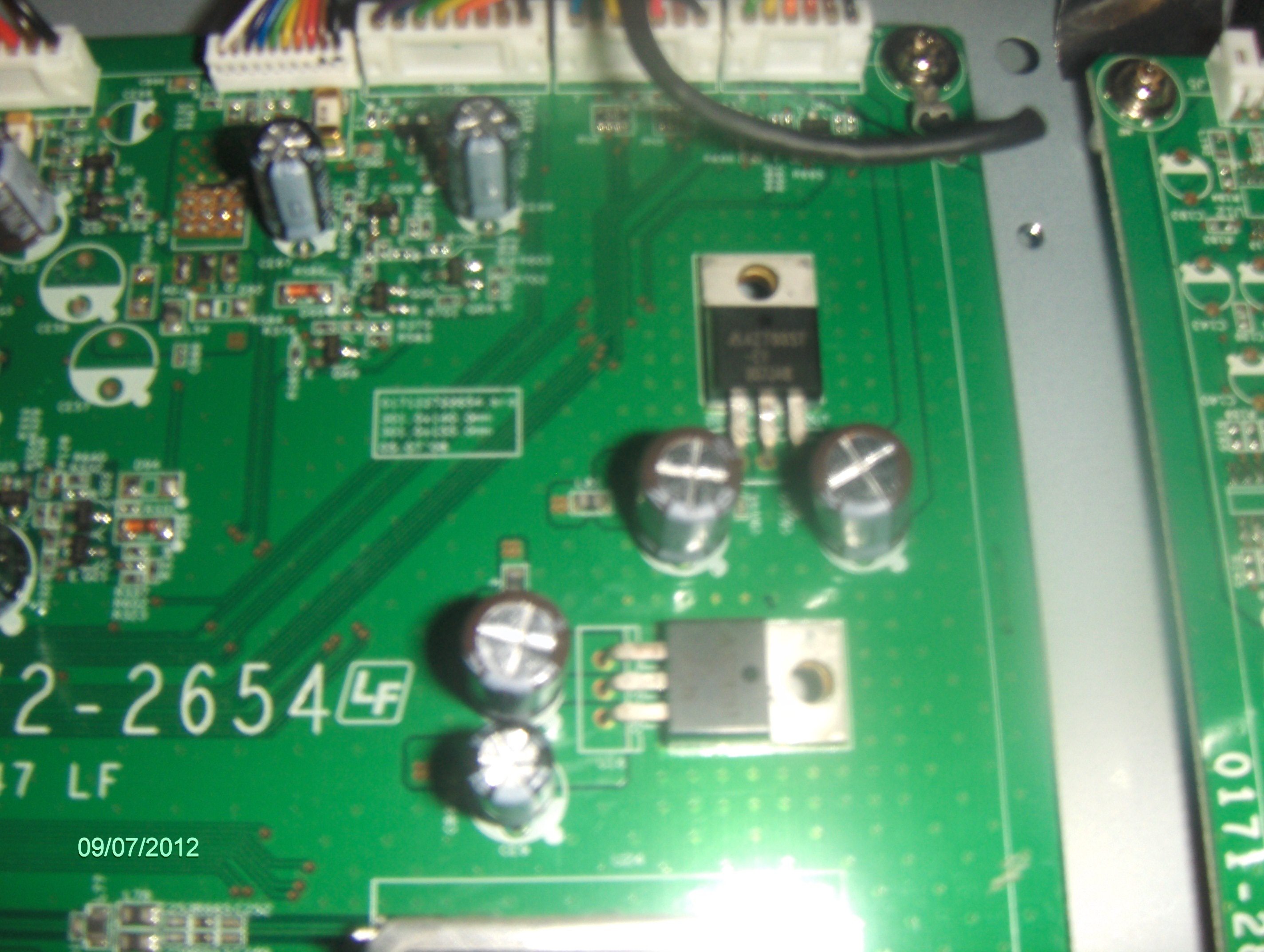

    The second photo I have no voltage in or out of two regulators

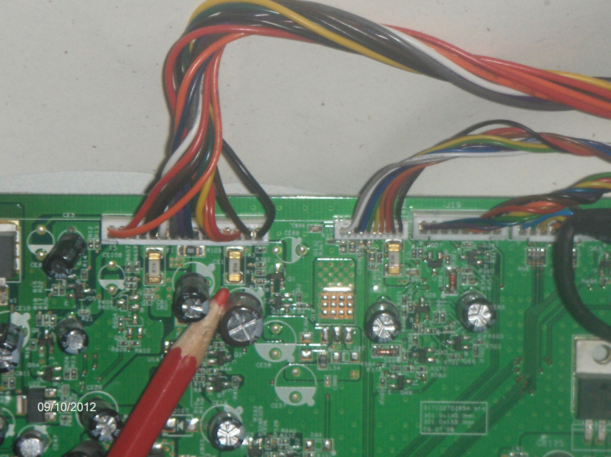

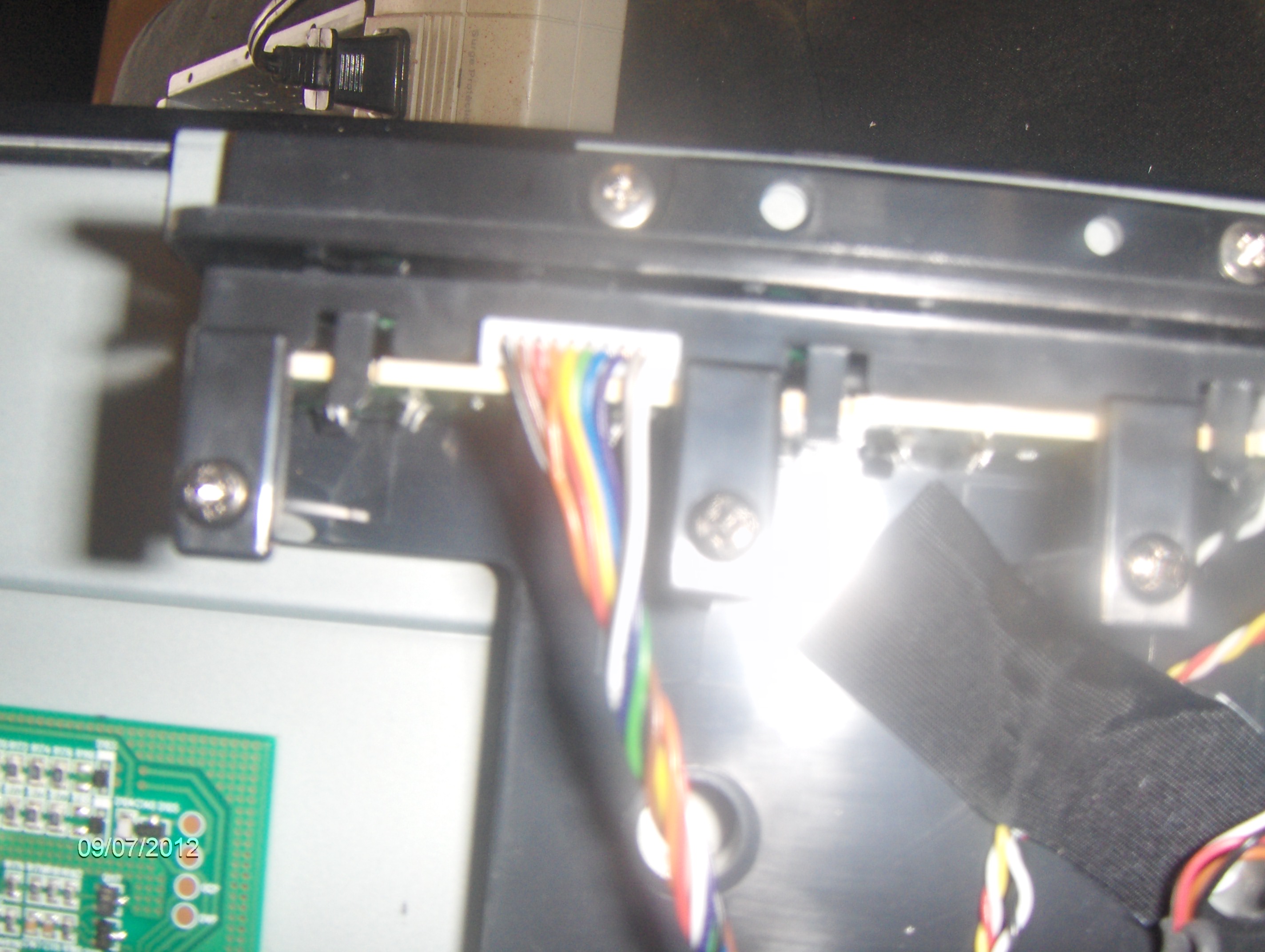

    Photo 3 the connector to the power button, channel and volume control, and input
    Blk Wire 3.26
    Brown 3.8
    Red 5.12
    Orange 5.12
    yellow 1.4
    Green 0
    Blue 0
    Violet 2.2, but only when the power button is pused in and held in
    Gray 0
    White 3.3
    By the syptoms I was first thinking Main AV board but with no power at the outputs of the power supply has me cornfused,,,, does the Main AV board turn on sections of the power supply? All the diodes on the power supply tested good. No bulging caps, dark or burnt spots on the boards.
    Main AV board CSD: 3647-0102-0395
    Power Supply DPS 379AP A

    See my sig file below on how to test and report the voltage regulators. Without part numbers, we can't tell if they are good or bad.
    BTW, I count at least 7 regulators and 5 fuses on the main board.
    The main board is responsible for turning on the secondary power supply outputs via PS_ON pin. It will generally toggle the pin "high" or > 3V.

        I found 6 regulators am I missing one.

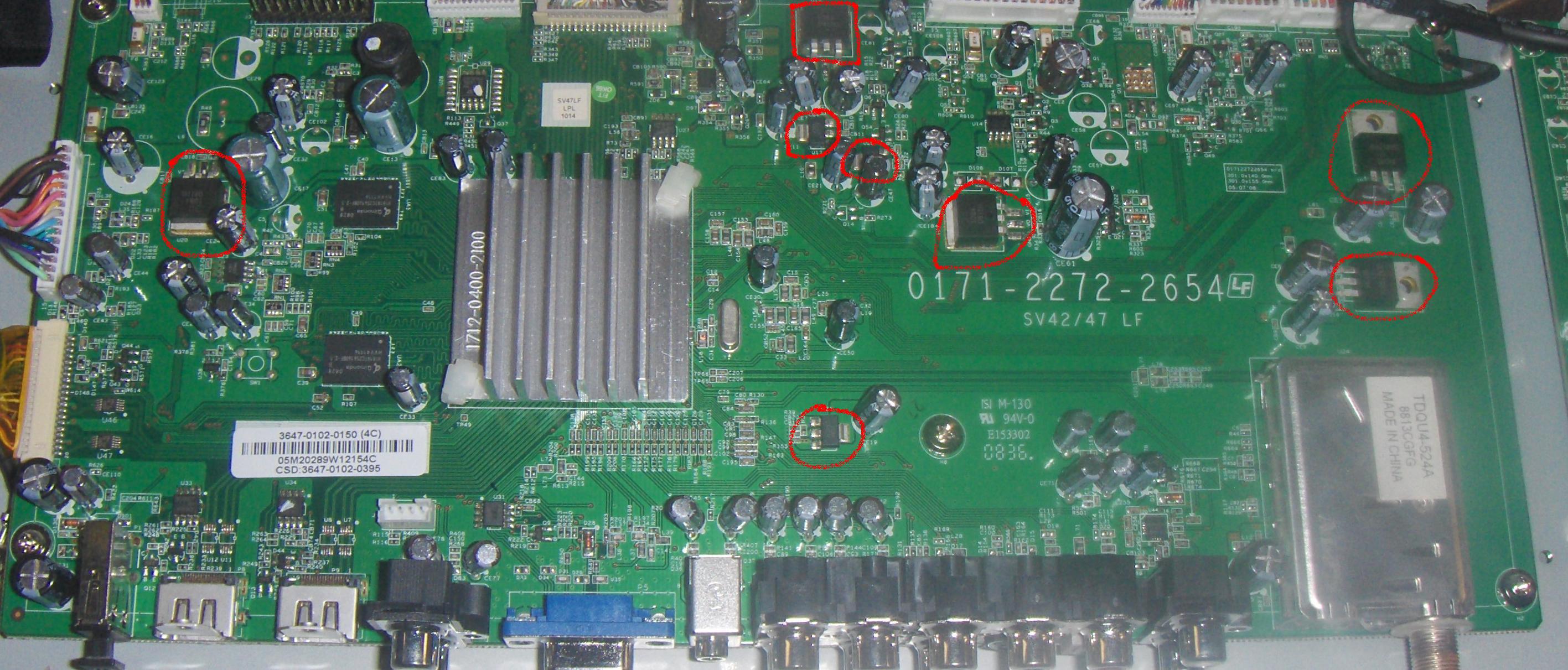

        I circled 8 in red. There may be more, but with the angle of your photo, I can't tell.
        You only reported 5 test results.

          I'll try and get you a better photo in the am. I'll check the others you marked and list them at the same time.

            Q905 pcb designation
            line 1 FQPE
            line 2 3N80C
            Mossfet I beleive it is leaky, when tested with black lead on drain and red lead on source and touching G&D together. Using an analog meter the needle would go to about center, hold for about 1 sec then fade to 0.

                1) So U16 and U45 are both 7805 regulators and both have on input voltage on the main board.
                2) I have no idea where they are on the board because I can't read the pcb designations. Thus, the two above could be working properly since they could be for a USB port or something similar. Or they could be responsible for the sound and dying?
                3) 5.5V standby seems high to me. In your picture with the power board connectors, it not so clearly says 5VSB. At 5.5V SB, it is running 10% out of spec.
                4) Somewhere on the power board connector should be a pin marked PS_ON. This is generated by the main board to tell the power supply to power on the secondary voltages. PS_ON is enabled when voltage is typically > 3V.

                  U45 and U16 are the two to the far right on the AV board.
                  Do you think the mosfet on the power supply is OK.
                  I added the info below. I'll check the PS_ON in the am
                  line 1 FQPE
                  line 2 3N80C

                          1) PS_ON at 0V means the main board isn't generating it. You might want to check the on/off switch panel to make sure there is voltage present?
                          2) See section on mosfets.
                          https://www.badcaps.net/forum/showpo...4&postcount=19
                          3) Please circle in your diagram which black wire and fuse. Post a close up picture of that area.

                                The red pencil is pointing to the fuse that has no power to it. the black wire on the far right goes to the PS_ON pin on the power supply board. Do I have a bad main board?

                                  Can you retest fuse F2 with just ohms and not continuity?
                                  --- begin sig file ---
                                  --- end sig file ---
                                  • shorteddiode
                                    • 221
                                    Re: Vizio SV47OXVT1A Will n0ot power on
                                    The fuse shows 0.7 ohms, and just for giggles I checked the black wire and it is 0.7 ohms also
