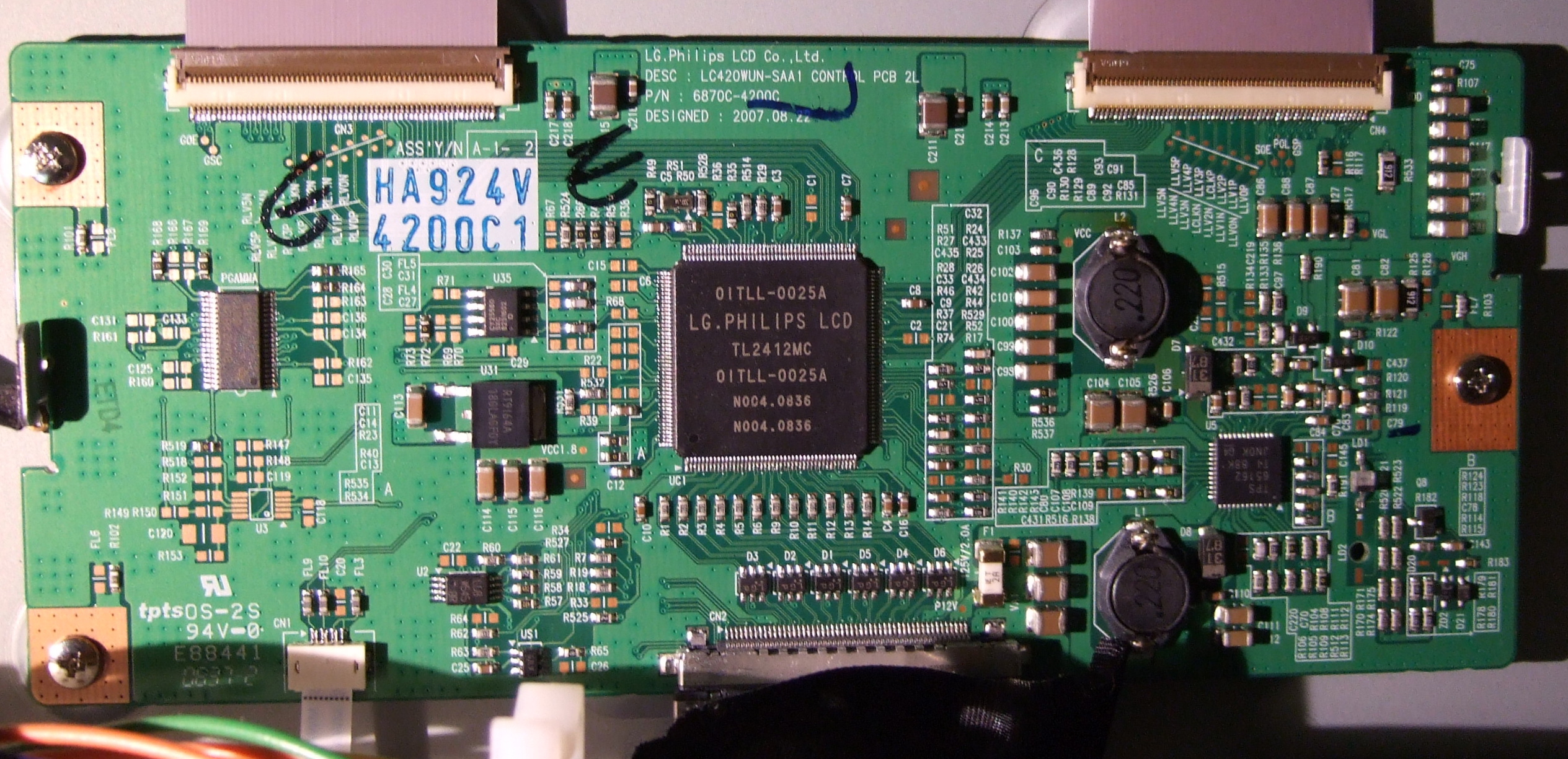

    See my earlier thread: on chasing down a no-video problem with my Vizio 42" LCD. Chased the problem down to some component on the T-Con board that was dragging down the internal 3.3v LDO output (from 12v input to the board). Started removing discretes without finding the problem. Looks like it might be a blown main IC (Philips TL2412MC). At this point I ordered a replacement T-Con board:
    Desc: LC420WUN-SAA1 CONTROL PCB 2L
    P/N: 6870C-4200C

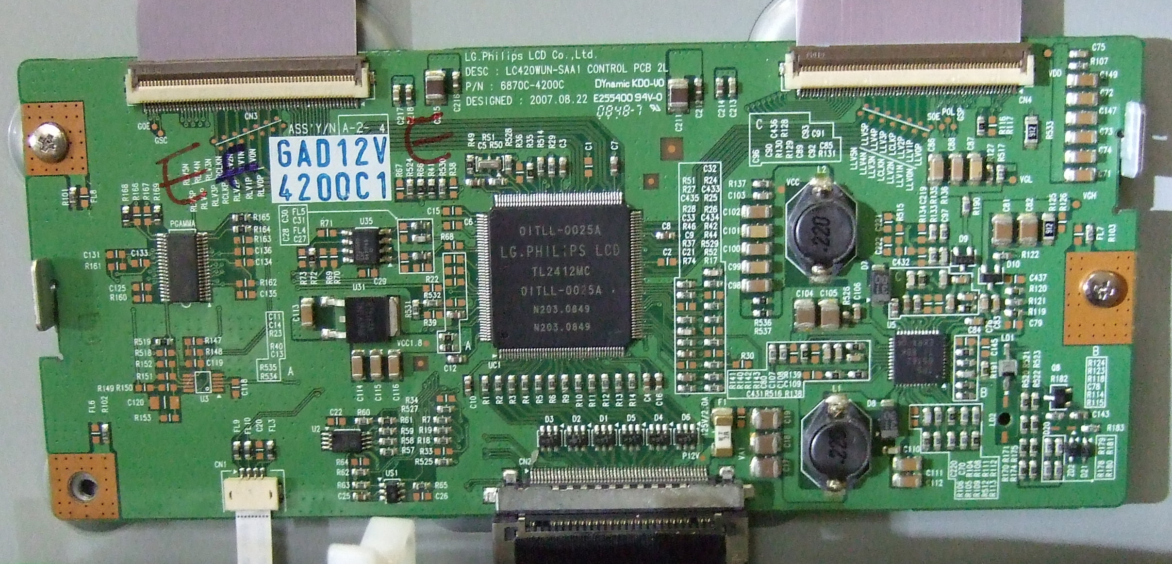

    Being a cheapskate I ordered a used pull from a working set. Just got it. Exactly the same silkscreened white Desc and P/N, same bottom line "4200 C1" rubber-stamped on white block, different top line ("HA924V" on the original). Put in the replacement and tried it out.
    With power-on a blue LED lights after a few seconds on the T-Con PCB and fades out awhile later. Fluorescent backlight works as before. Now I DO get pixels on the screen, but the screen is almost entirely white, with a couple black lines. (Note: I did remove the connector and 3 ribbon cables from the board and put them in again, making sure everything was properly seated and latching bars were set on the two wide ones.)
    A thin (single pixel) horizontal full-width black line at mid height.
    A narrow (4 pixel?) vertical full-height black line at center width.
    Another narrow (4 pixel?) vertical full-height black line about 4" to the right of the first.

      OK, here are pics of the original T-Con PCB and the replacement. No barcodes seen anywhere on them, but the second line of "rubber-stamped" text on the white block is the same, "4200C1" (as is the PCB silkscreen labeling), but not the first line. Is that significant?
      WRT voltages, the replacement measures:
      At the F1 fuse input: 11.94v
      At the VCC test point: 3.35v
      At the VCC1.8 test point: 1.84v
      What now?
      Mike
      PS: Note the browning around the VCC supply on the original, probably by whatever shorted out the VCC1.8 bus (as noted by you in the earlier thread).

          1.94V for the B+ is way too low, panel will use either 5V or 12V to run the T-CON board. Are you sure you are getting 1.94V feeding it?. You need to trace out the wires that are connected to the fuse and then trace them back to the main board, then disconnect the cable and then read the voltage on the main board side to see what voltage you are getting without having the T-CON board connected, we are trying to find out if the voltage source on the main board is bad or the T-CON is loading down the main board.
          What is the LCD panel model number and the Rev number as printed on the sticker?
          Yes, it is real easy to damage the socket/connector.

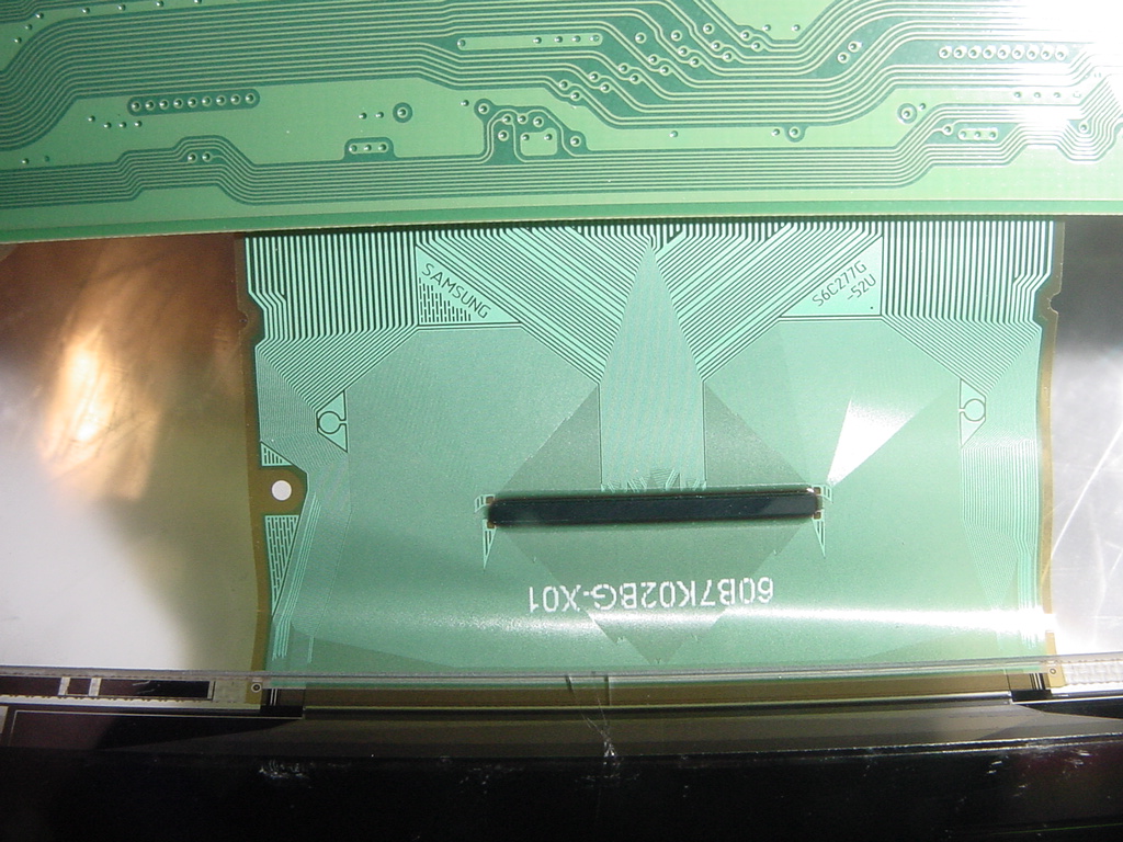

                          It sounds like the you may have bad Row/Column TFT driver IC's which are on the flexible PCB on the top and on the side of the LCD Panel that load down the VGL.
                              Thanks, budm. If that's the case, am I "dead in the water", i.e., beyond a practical repair?

                                OK, did another diagnostic. Remember that Tom66 said that VGL should be around -10v, when it's actually around -3.5v. Budm suggested that a (downstream, on the flex cable) row/column driver IC might be bad.
                                So I measured VGL and VGH again, with both panel flex cables connected (as before), with first one, then the other disconnected, and finally with both disconnected. Here are the results:
                                • VGH stayed at approx. 25v in all cases.
                                • With both flex cables connected, VGL = -3.5v, as noted before.
                                • With left flex disconnected, VGL = -3.346v, about the same as before. Display is now gray on left half, white on right half. The vertical black bars are gone!
                                • With right flex disconnected, VGL = -3.390v, about the same as the last case. Display is now a mirror image of the last case, white on left, gray on right BUT the black vertical bars at the middle and on the right are back.
                                • Final case, both flex cables disconnected, VGL = -5.90v(!) and, of course, the display is blank (black).
                                Result: I'm discounting a bad row/column driver IC and strongly suspecting a bad T-Con card, in particular, where VGL is generated. Without a schematic, looks like I'll have to trace out that section. (Presume it's some sort of diode/cap driven charge pump.)
