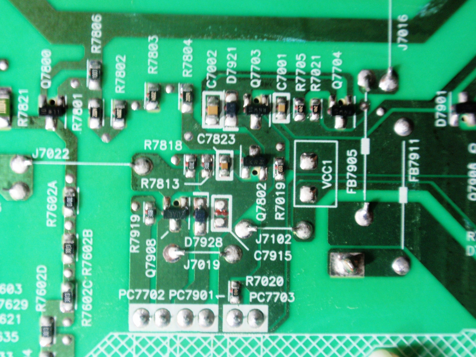

            This is what I come up based on your pictures, I cannot read all the part designators on the board.

                    #49
                    Re: Sharp LC-40LE810UN question

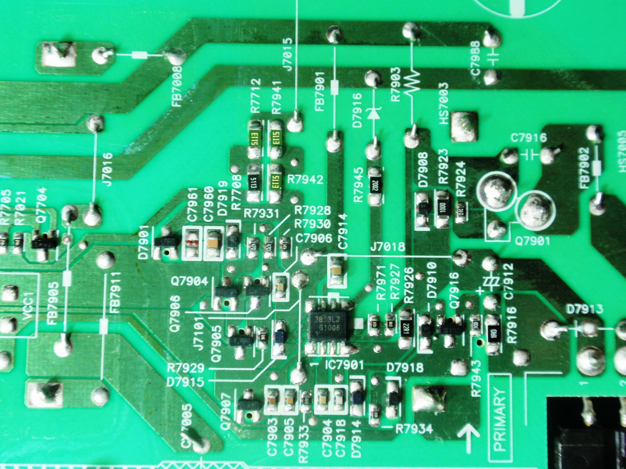

                            I have made some quickly, hopefully they are OK:
                              #54
                              OK, I will look at them tomorrow. We need to get this section running first. What do you use for lighting since it is not day light right now?
                                        OK, this is what I came up with, I cannot see pin1, 2 connections real well for the IC 7901.
