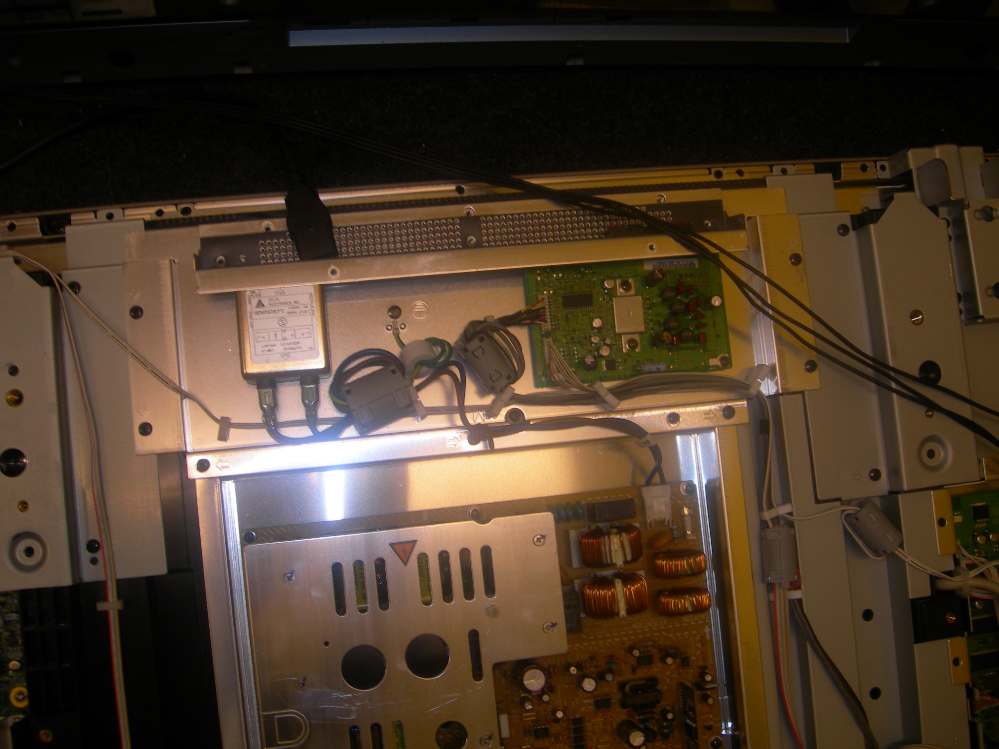

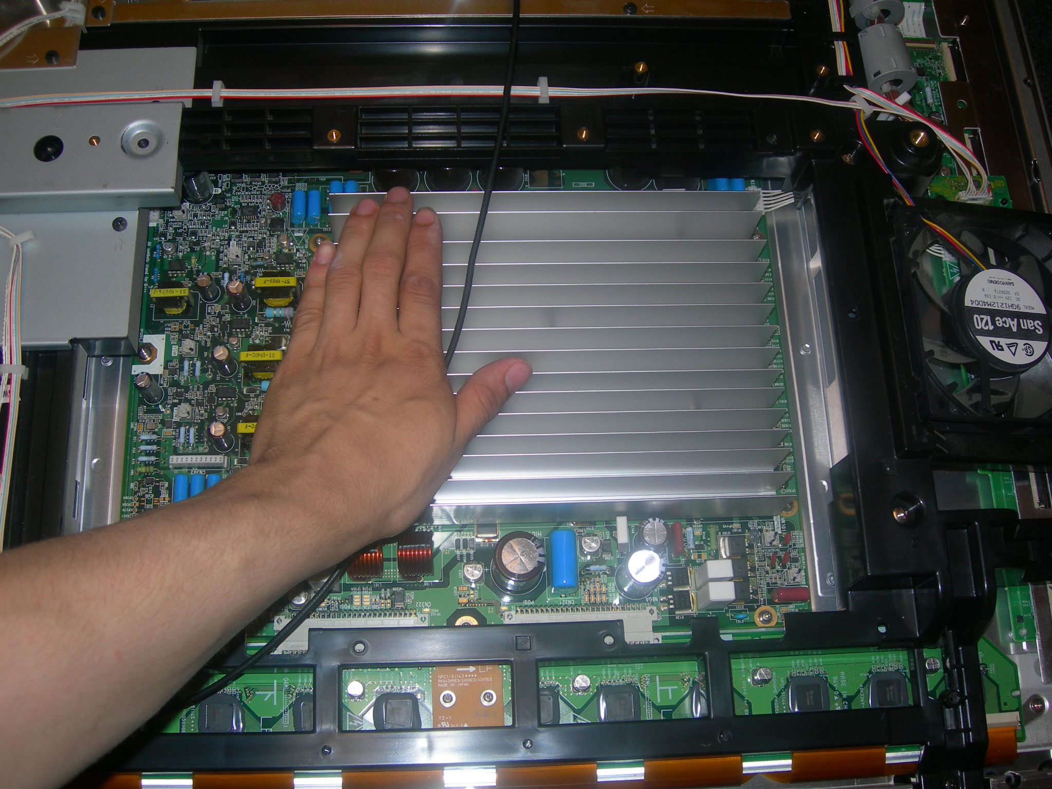

    Got another 50" plasma to repair... NEC PX-50XR5G with Pioneer plasma panel. This is a nice 1365x768 NEC plasma with HDMI. It's about 5 years old.
    This one powers up with a good picture for about 10 seconds, but then shuts down with a blinking red LED, half second interval with endless count.
    Found the service manual for the US version (with DVI) but it should be close enough. http://www.scribd.com/doc/41506648/PlasmaSync-50XM4. If anyone has a Scribd subscription can you please download it as PDF and PM me.
    The particular error code indicates a fan event, so I need to locate the particular source of this fault.

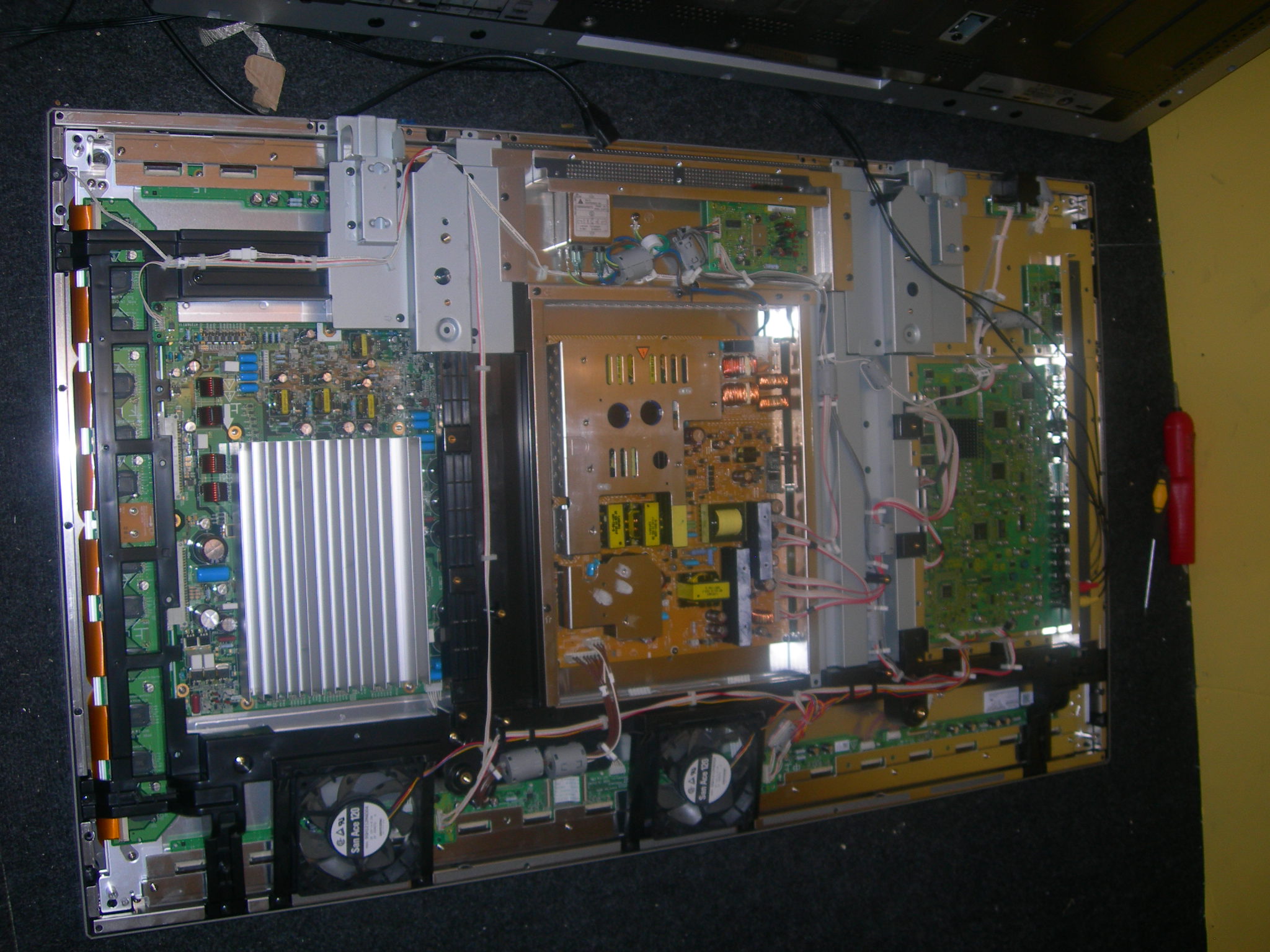

    I don't think I've ever seen a heatsink that big in a plasma TV....... that's for the Y-sustain and it's air cooled. I believe this model is intended to be mounted vertically or horizontally so it's got to have a good heatsink.
    Also, it is full of Chemicon and Hitachi (primary) caps on the PSU, and Nichicon, Panasonic, Rubycon and Chemicon across the rest of the unit. Very nice. RRP - a mere £1,400.

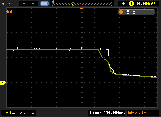

    OK, some tests -

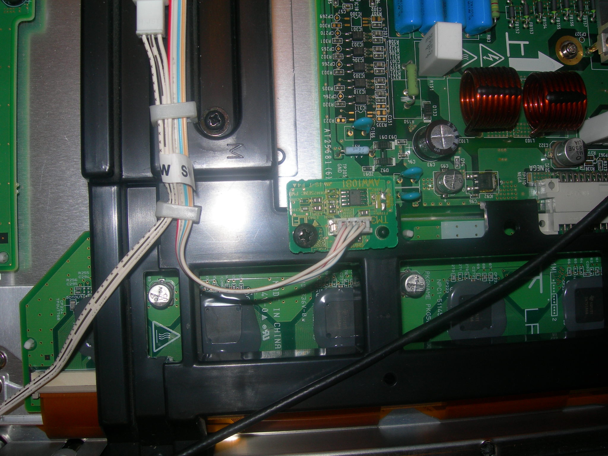

    Each fan has a Vin, GND and ALARM pin. The ALARM goes high when the fan slows down too much (it's some kind of inertial switch, it's not a clock signal.)
    Both fans fail with ALARM at same time, so I doubt a particular fan is giving a problem.

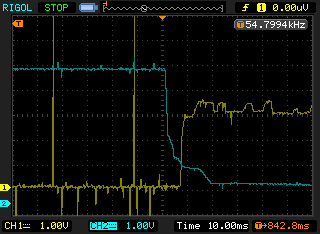

    The supply to the fans drops BEFORE the fan ALARM signal - this is confirmed on the scope... Blue is power, yellow is ALARM (ignore spikes, they seem to be noise due to ground loops, I hope. May be a problem...)

        Correction - blinking GREEN LED, not red.

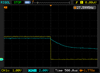

        Some more waveforms - First image shows difference between controlled shutdown (white) and plug removed shutdown. Second image shows control signal to regulator drops out (yellow) THEN regulator voltage falls (blue) - so the question is, why is the regulator control signal dropping out?
        I have a feeling the error code isn't correct because the manual is slightly different.

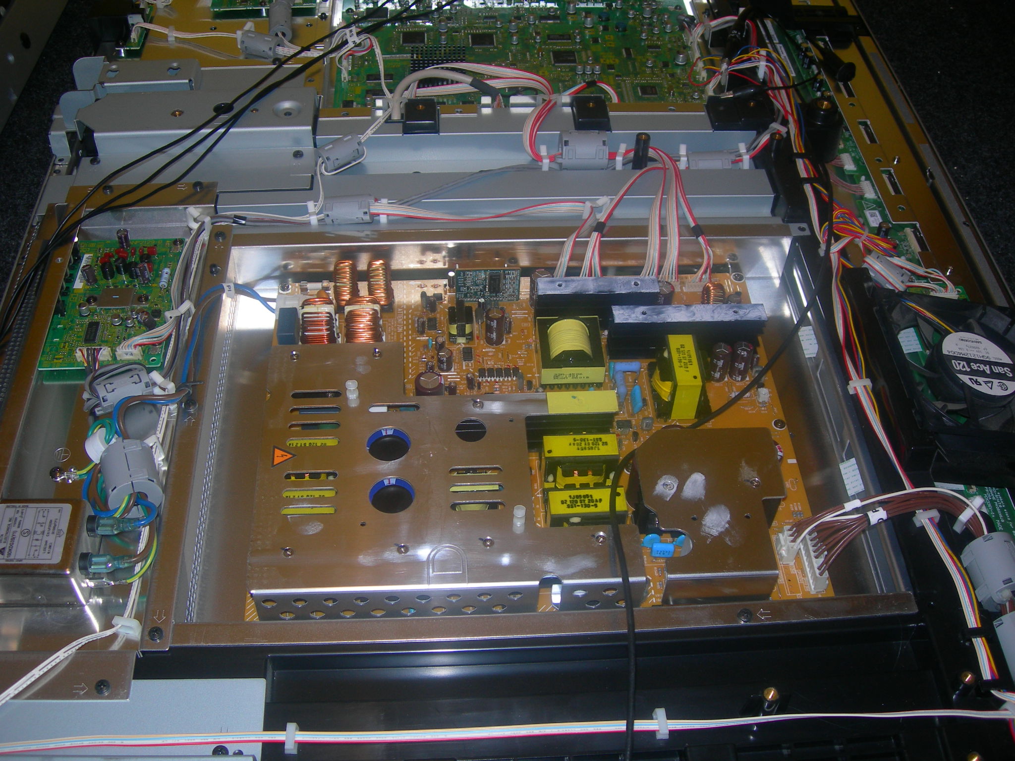

            VERY TENTATIVE - Unplugged the speaker amp board, and it's run for at least 3 minutes now. Fingers crossed that the SP-ALM signal on it was causing difficulties.
              Re: NEC PX-50XR5G - Shuts down after 10 seconds with 4 or 5 blinks
              Well, over an hour running and it's still going. Plugged the speaker amp board in, and it shut down in 10 seconds. So, clearly some fault with the speaker amp. I'm going to either think about leaving it out (and mentioning that you'd need an external amp to use it with sound, as it doesn't have speakers built in anyway) or replacing the amp with a board like this. I favour the second option.

                  OK, so some more tests -
                  The SP-ALM signal going LOW indicates a fault; with the SP-ALM high, there is no shut down. With the speaker amp board unplugged, SP-ALM goes high, and the TV works.
                  I then checked the outputs with a known good audio signal being fed in. The output of one amp is DC with occasional clicks downwards (every few hundred ms). The other channel is completely flat. So, I think the amplifier IC is in itself faulty. I will see if I can replace the amplifier IC by hot-airing it off, if I can get it. It's a M61571AFP by Renesas.
