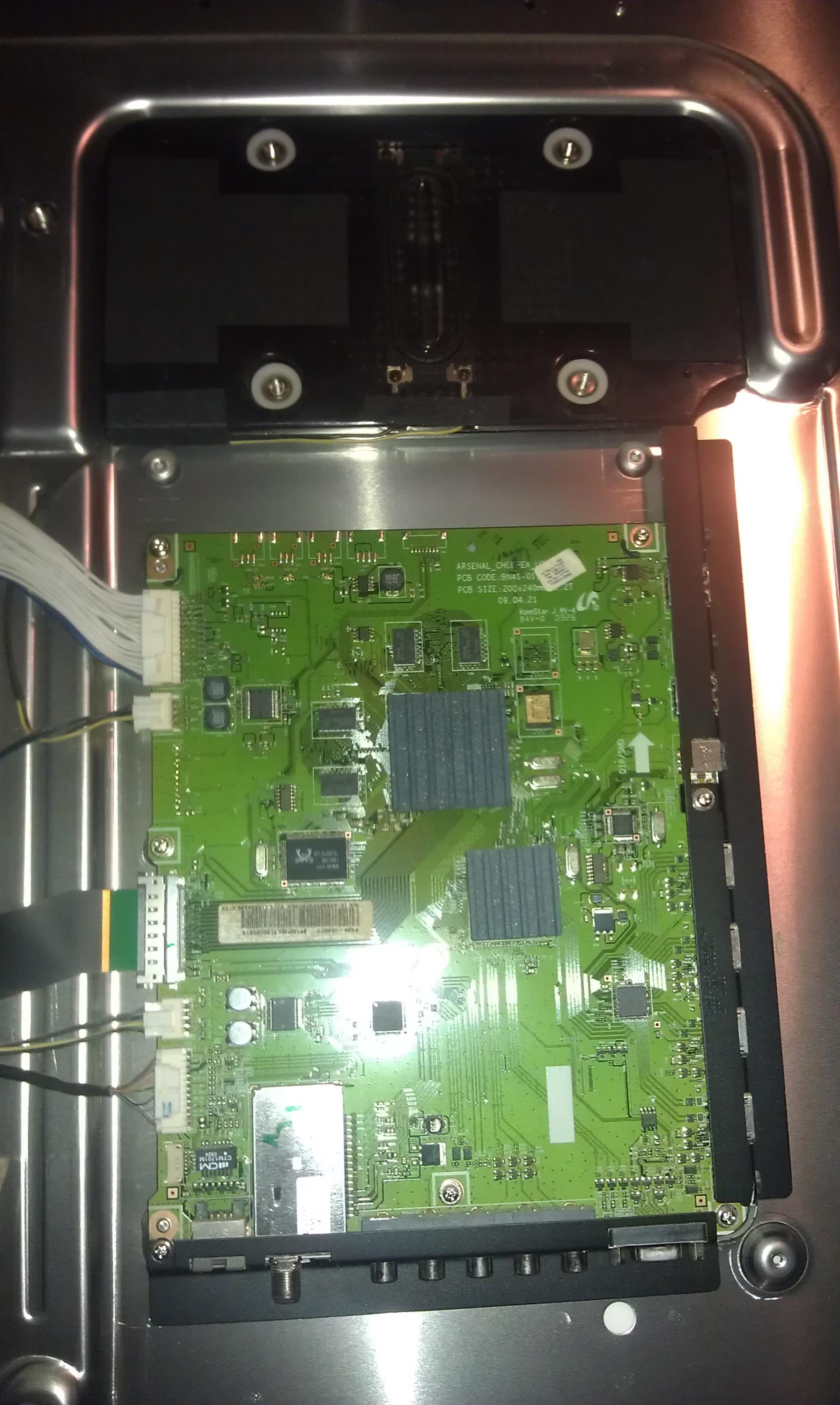

                      Take the back cover off your TV and take pictures of the main board. (The board with inputs on it.)
                      Are there any other functions that aren't working - can you test the digital audio output, VGA and the composite video inputs?

                              Re: Samsung UN46B6000 lightning strike issues

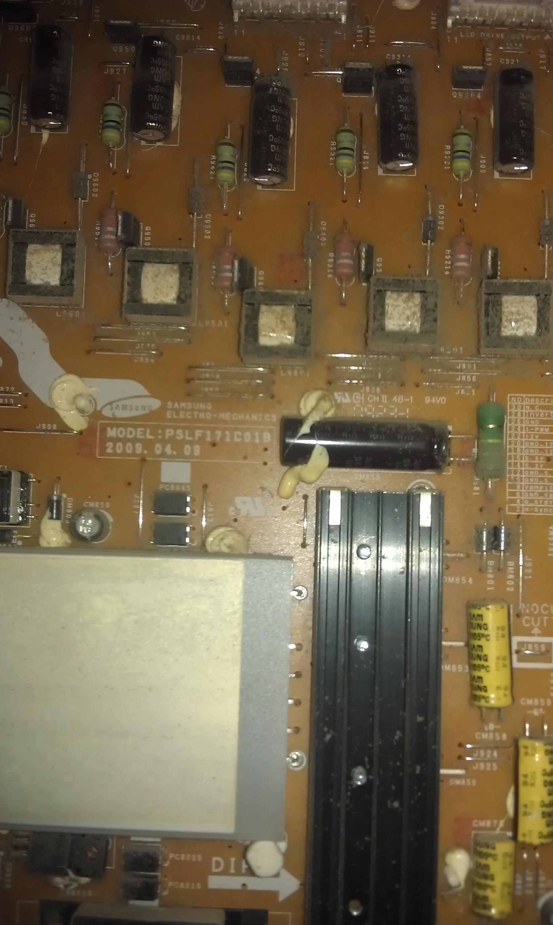

                              We dont get many LED tvs on here (yet?) so it would be good if you could do
                              a picture of the chassis of the tv with the back off then one of each board
                              ( May help others in the future) - this is my usual request, but just the front of the boards will be good unless/until you have to take them off.
                              Please post good clear pictures of the whole chassis, and then pictures of each board, front and back and close up of connectors, (max resolution 2000x2000 and 2MB) using the manage attachments button, which is found by clicking "go advanced" under quick reply.

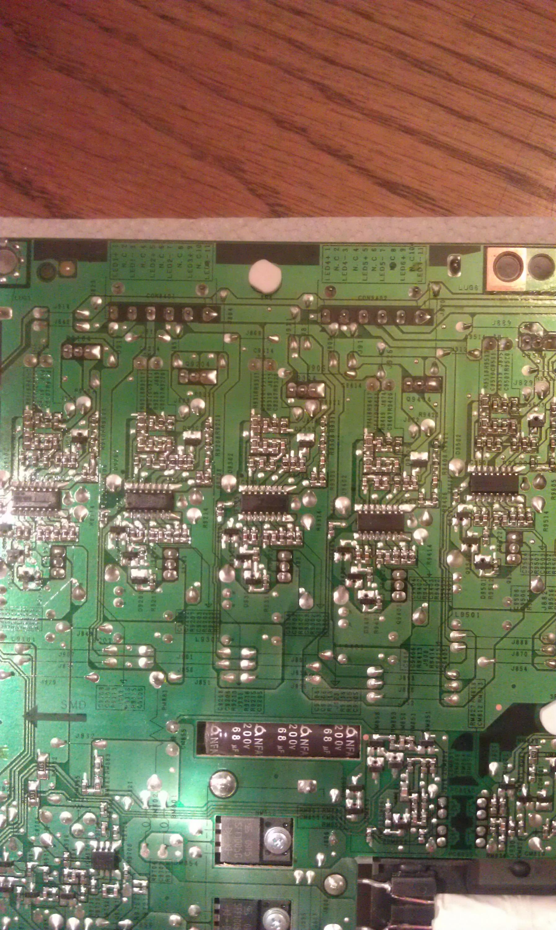

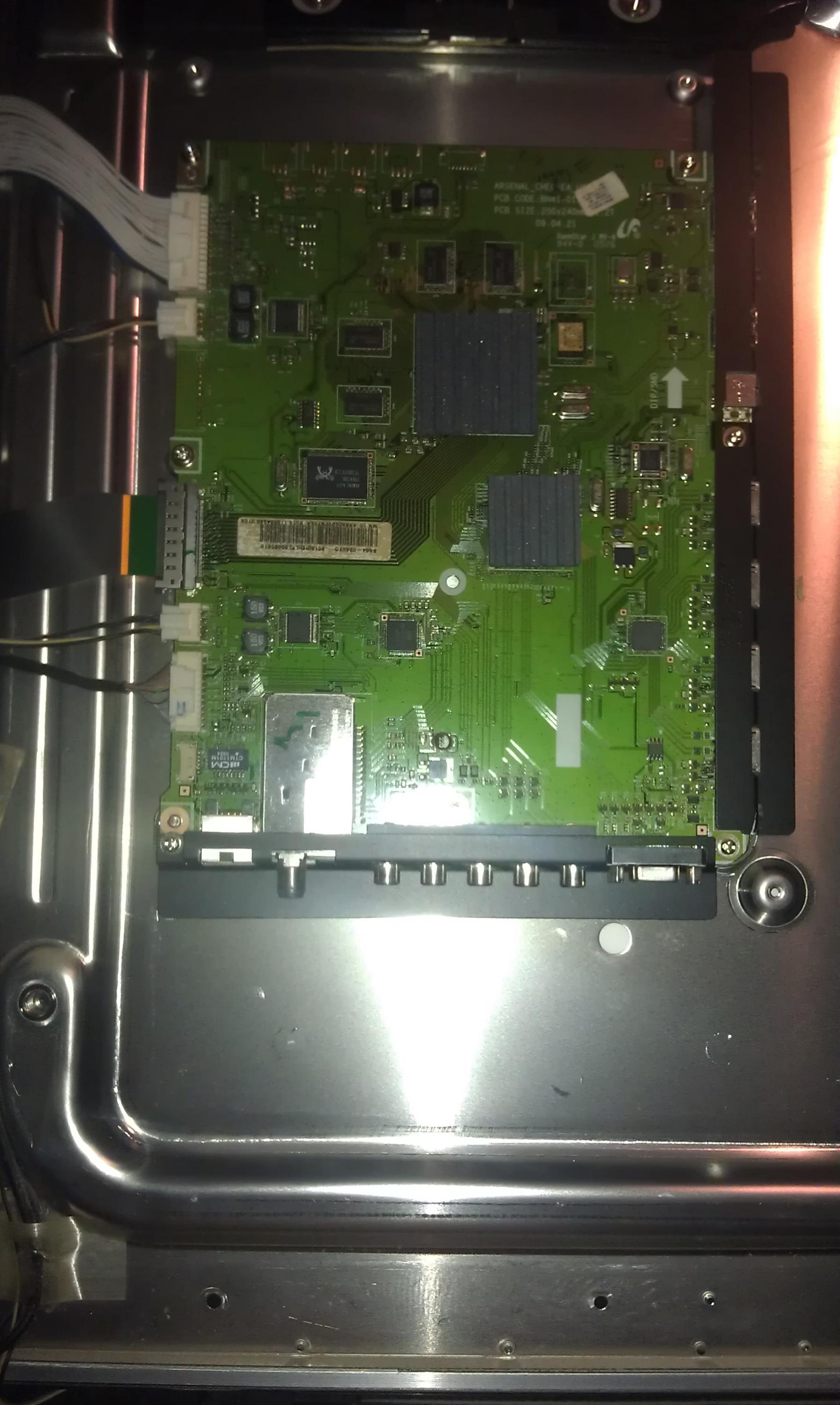

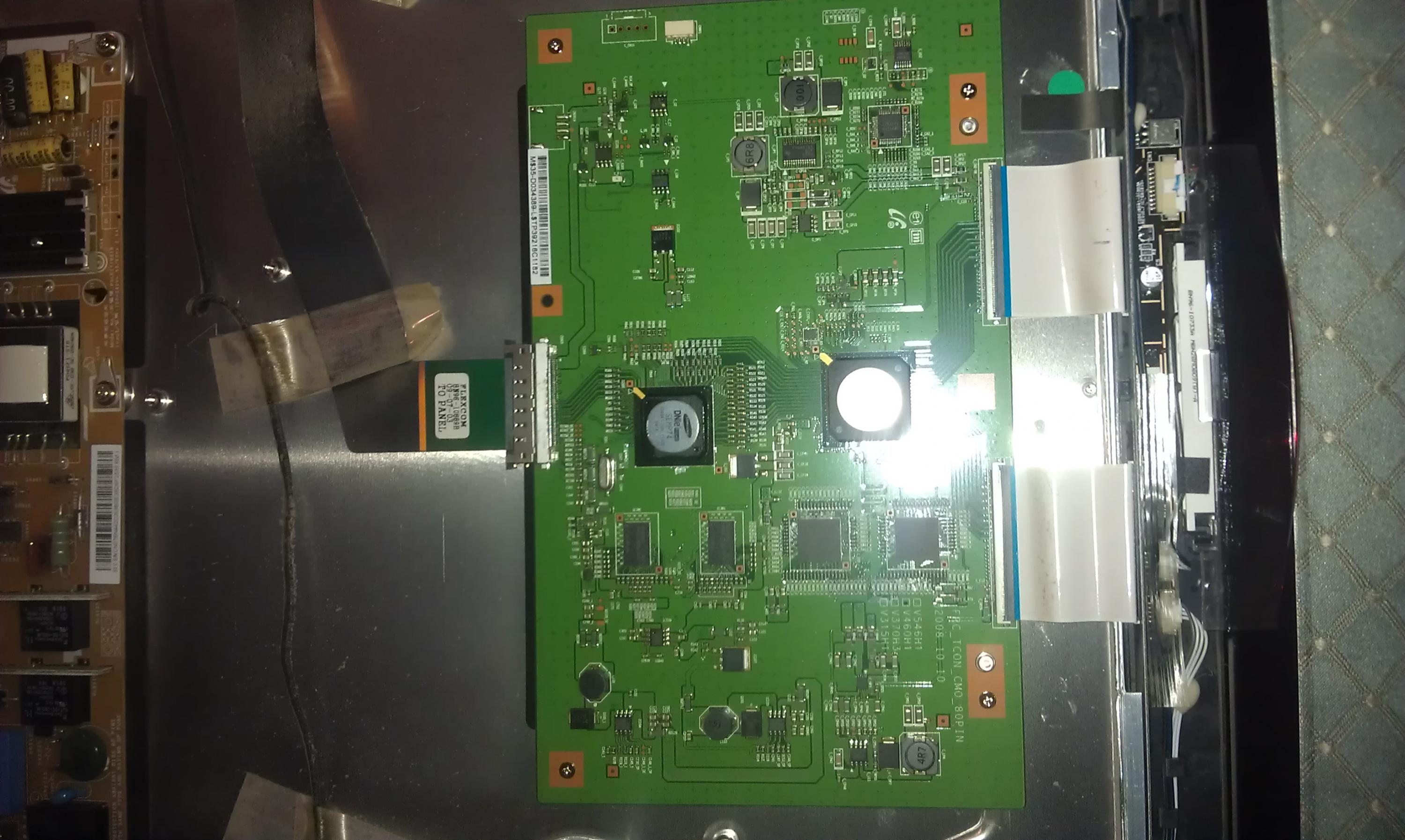

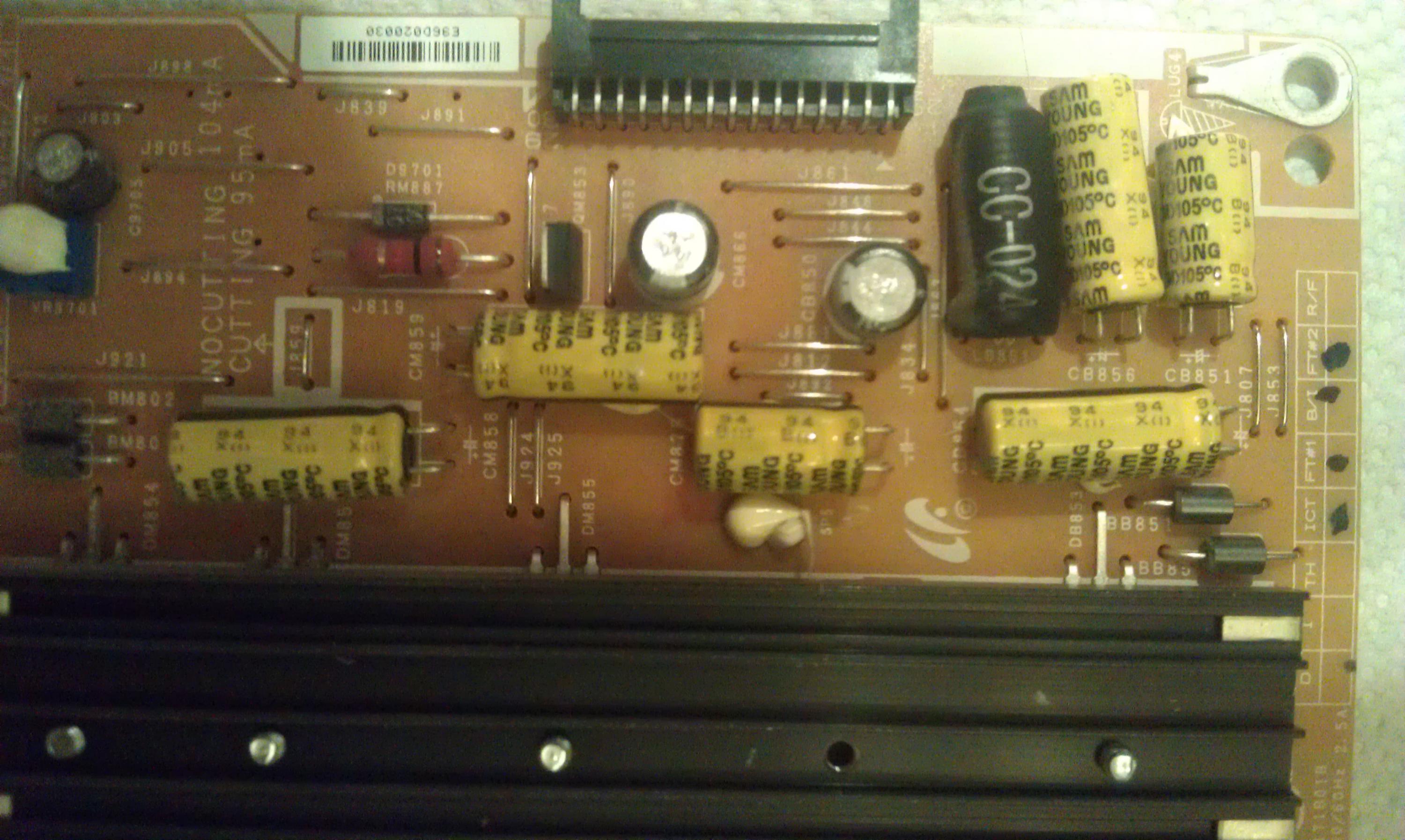

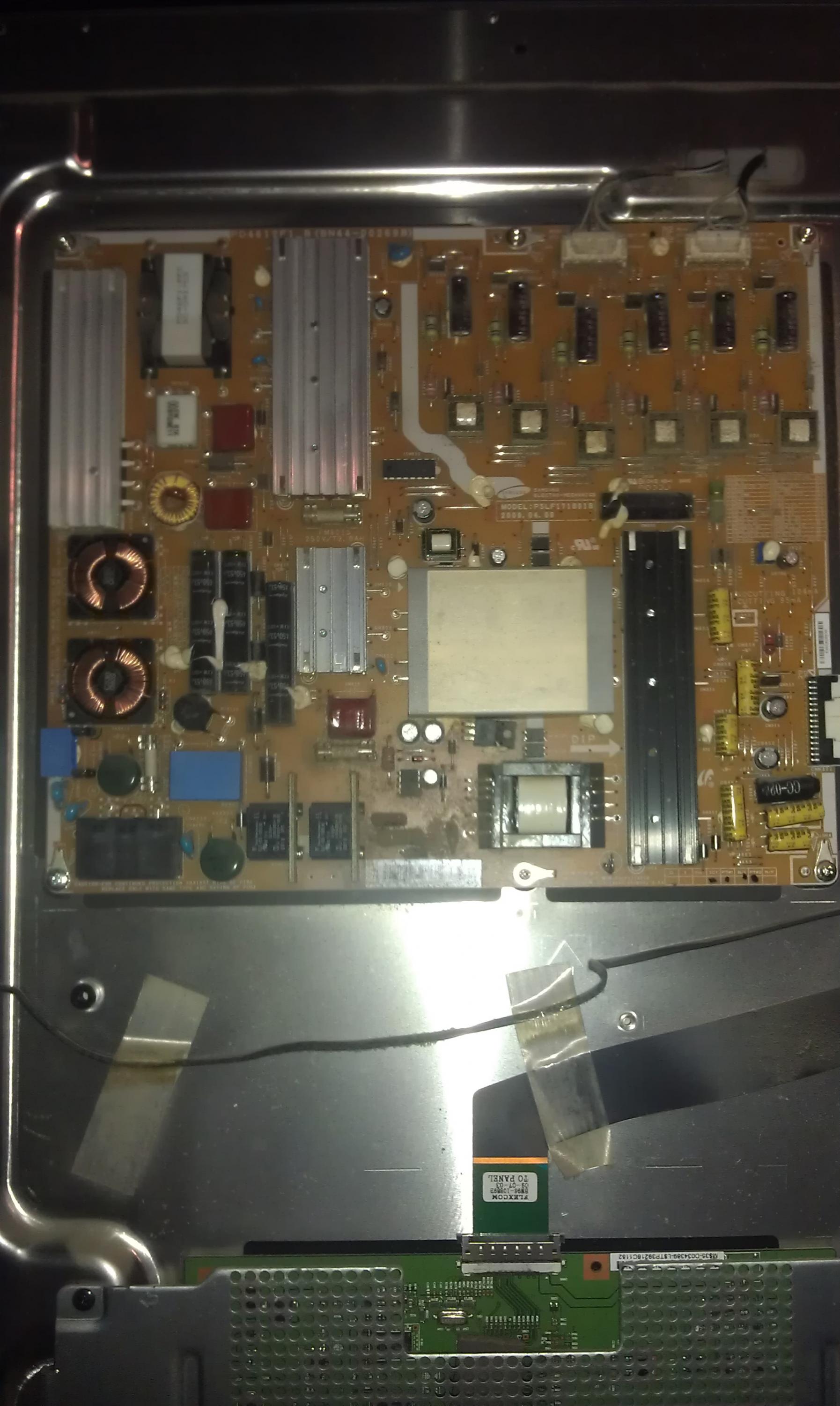

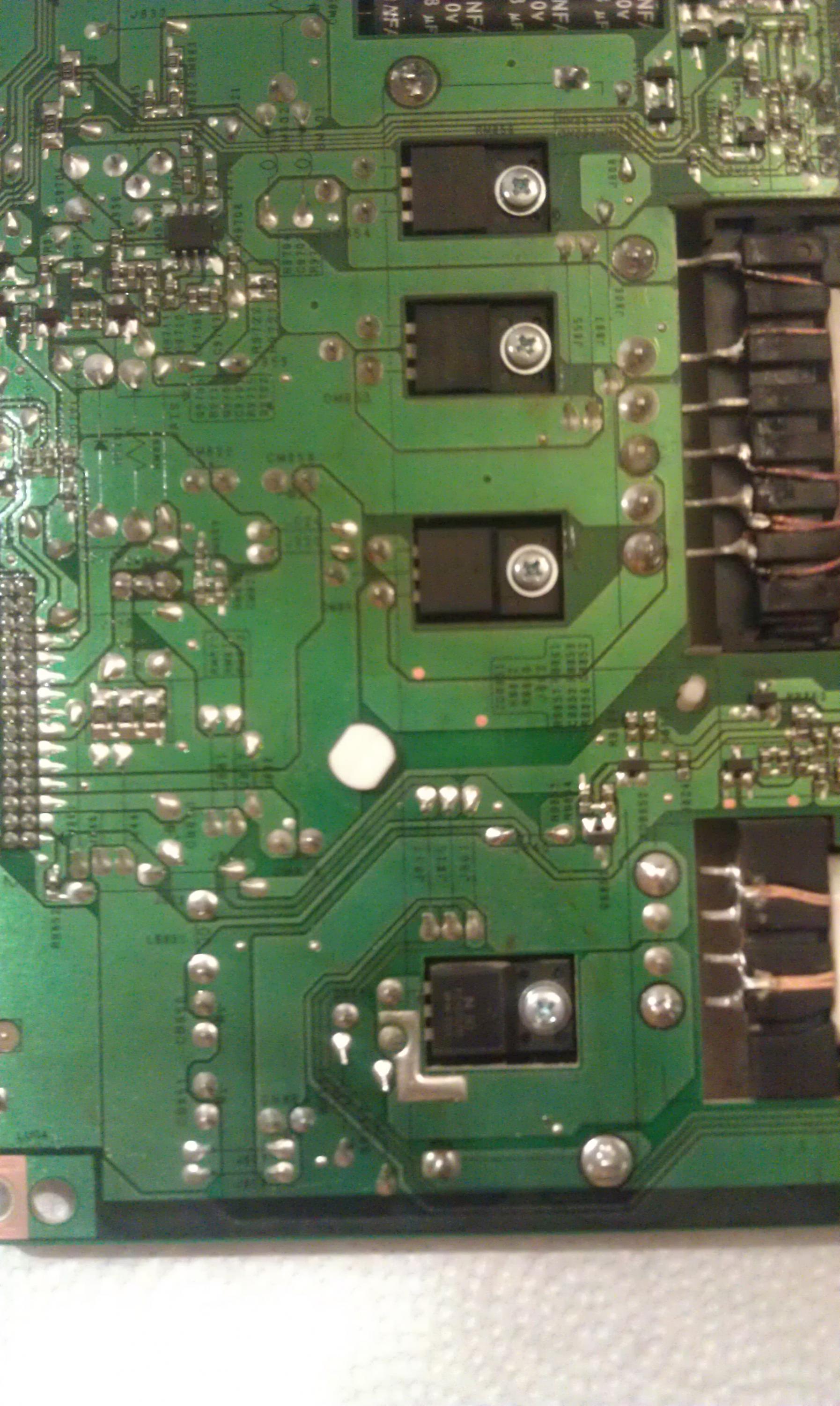

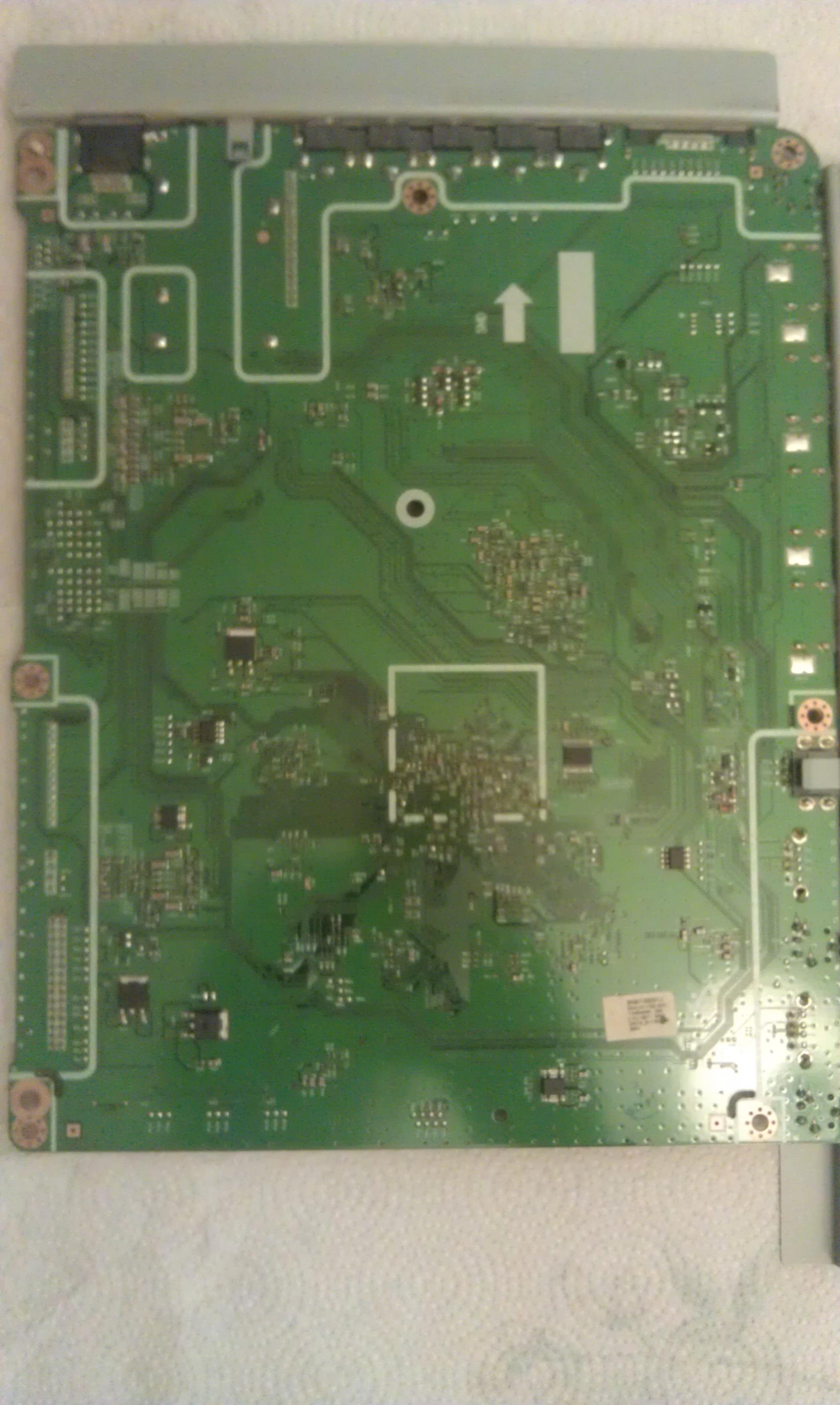

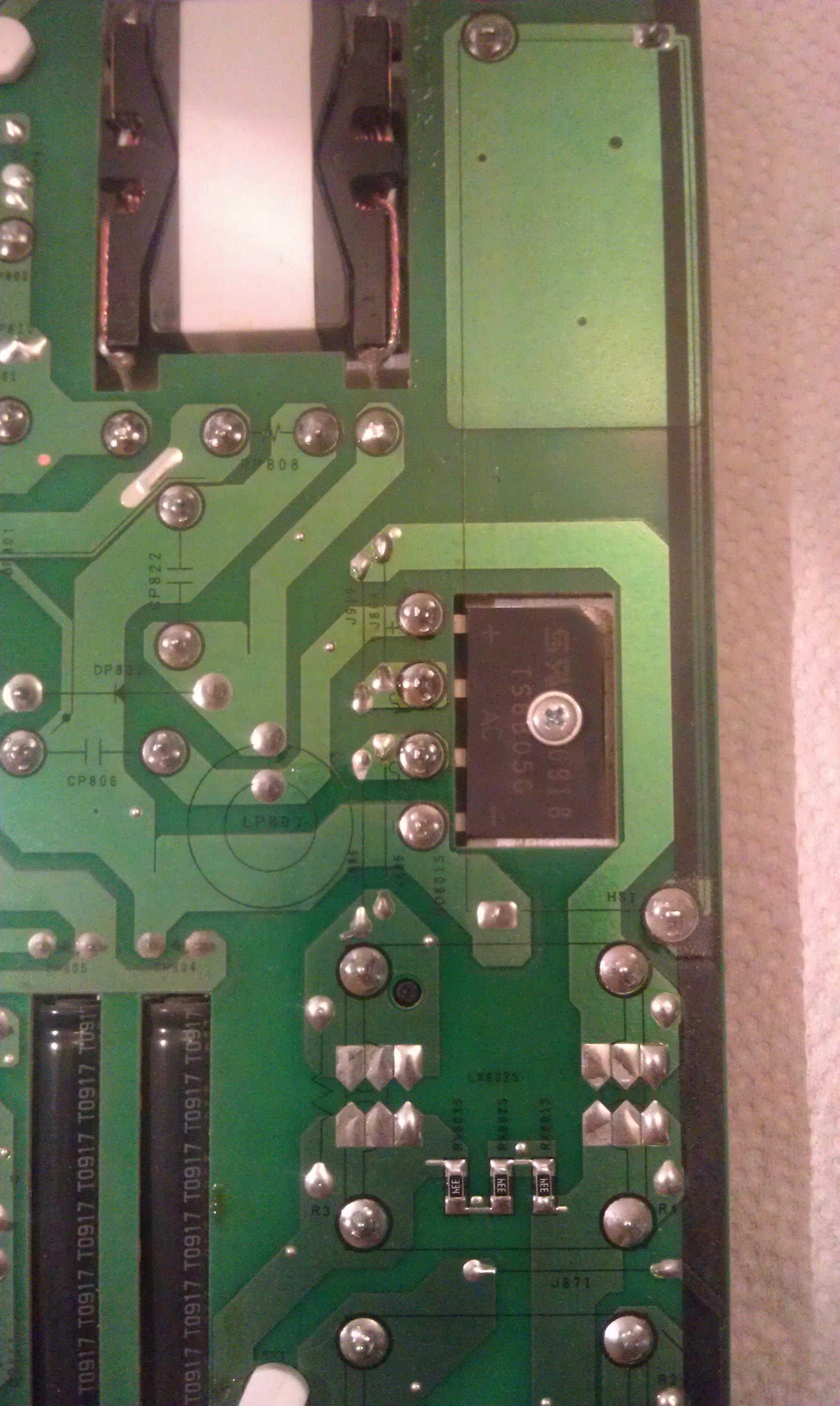

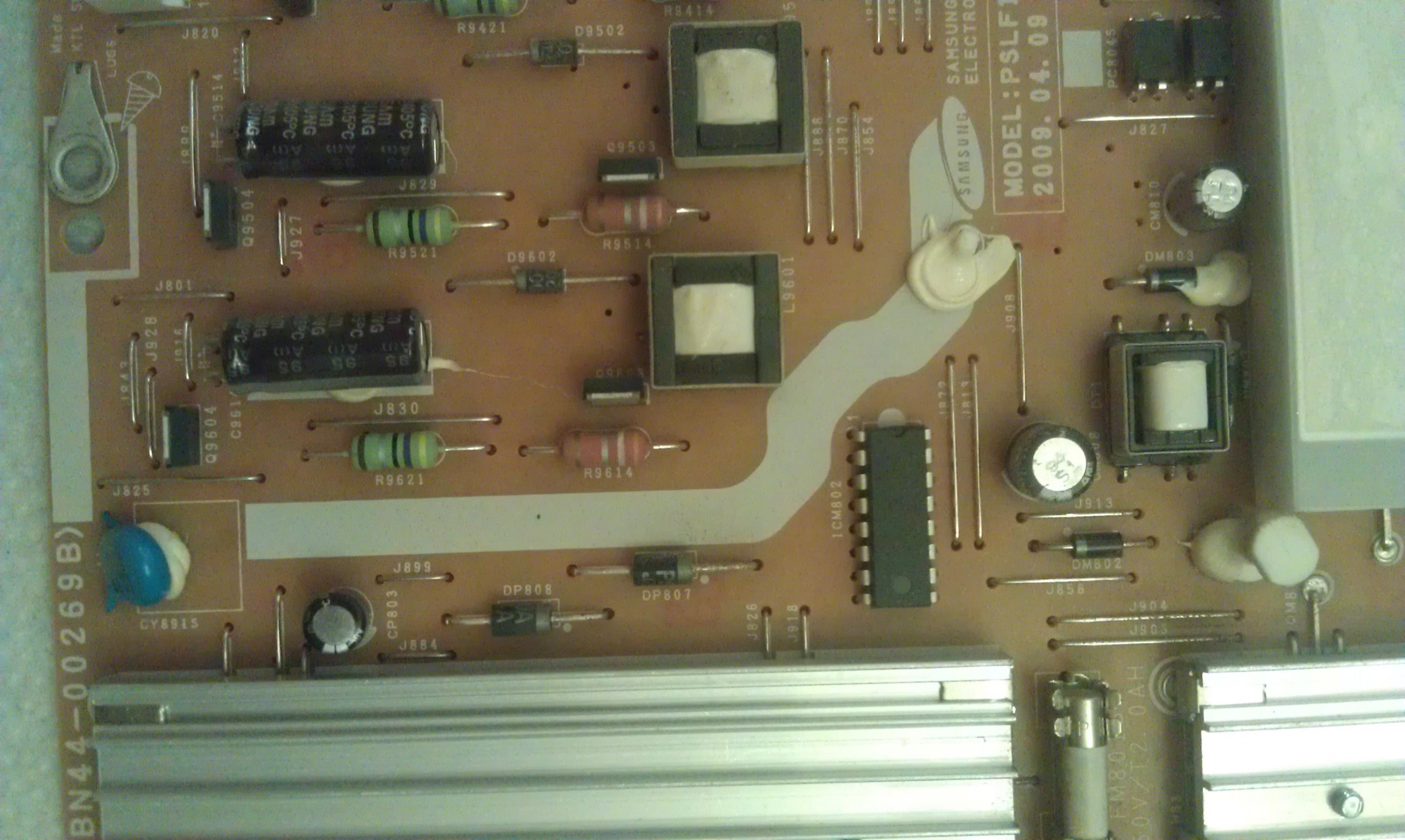

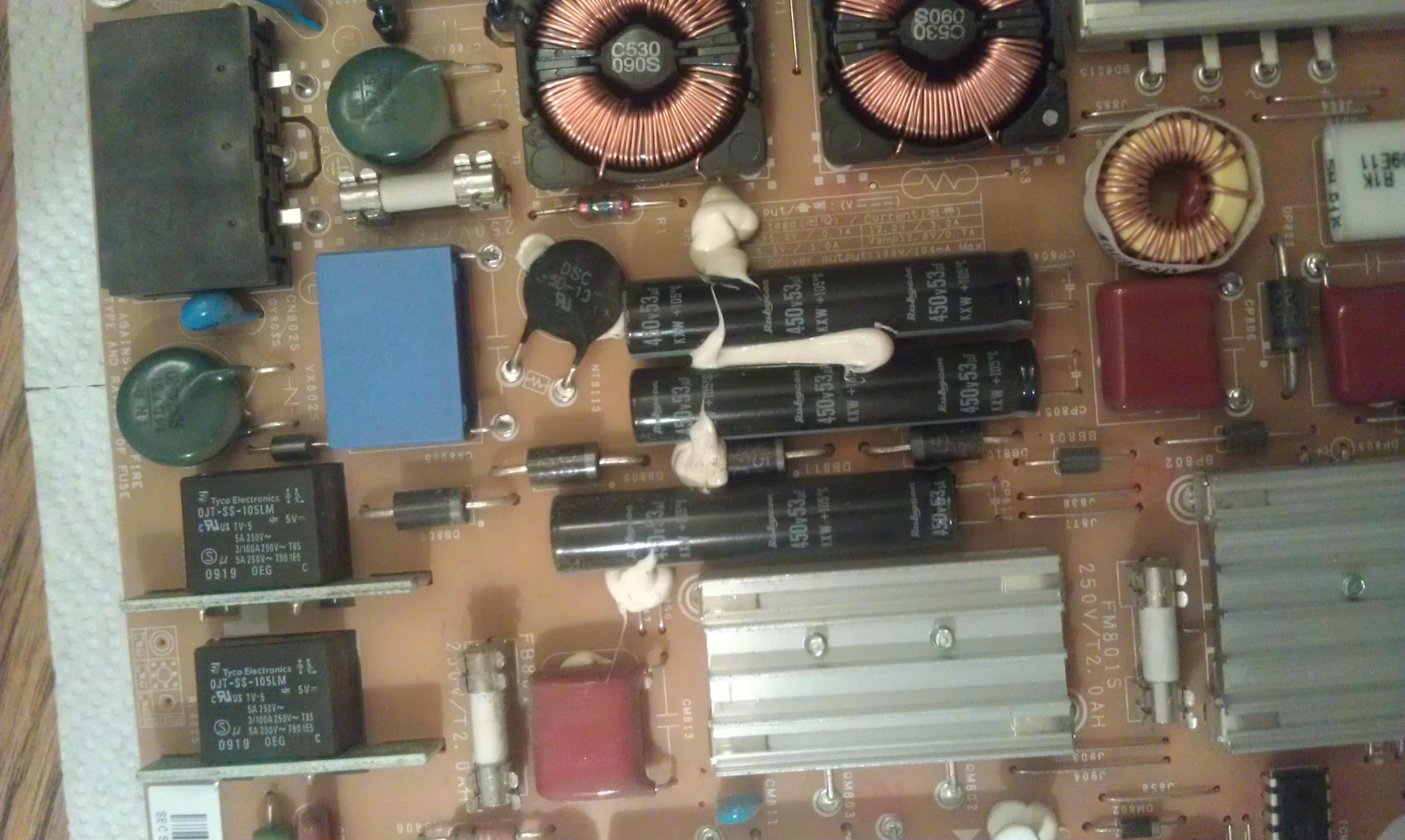

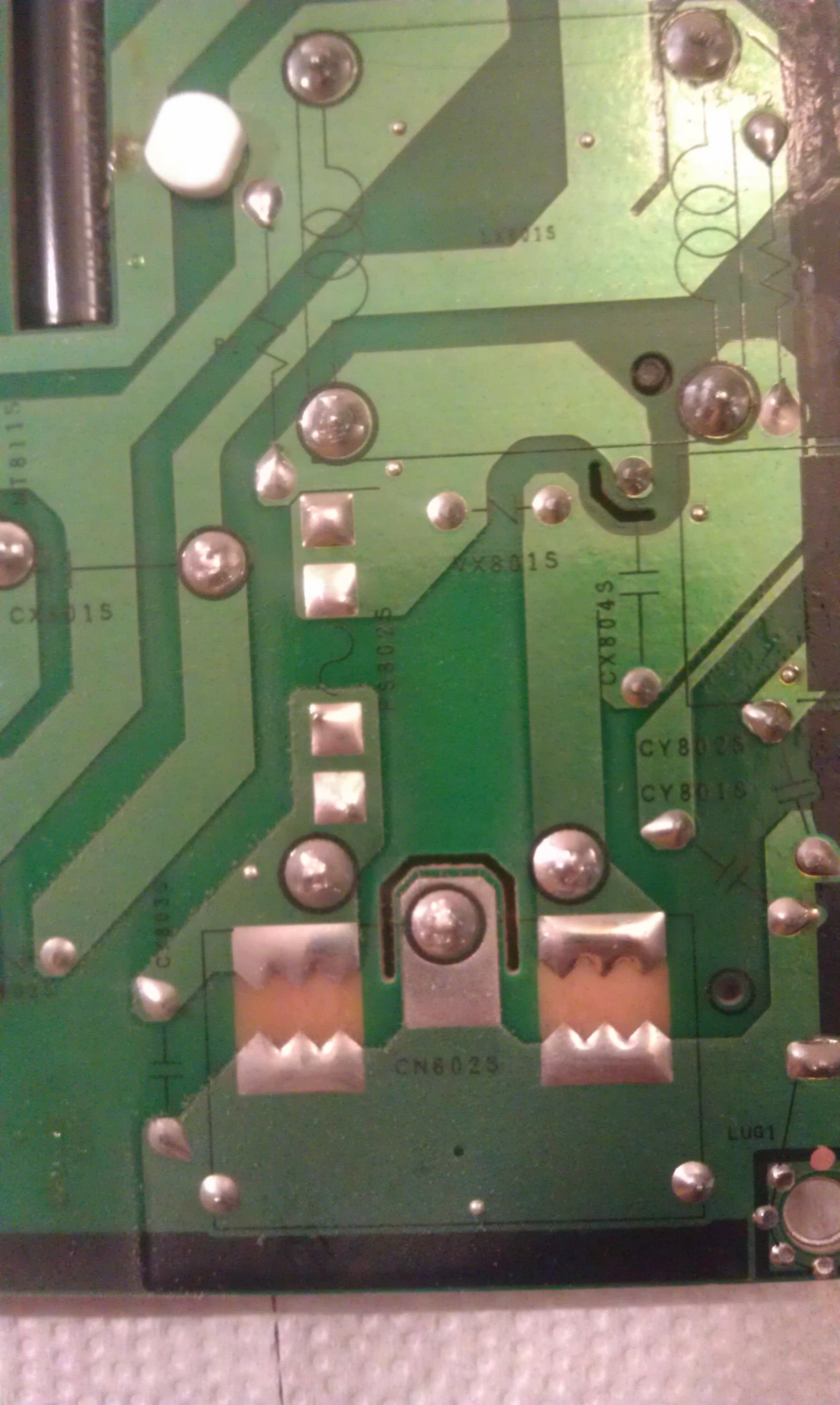

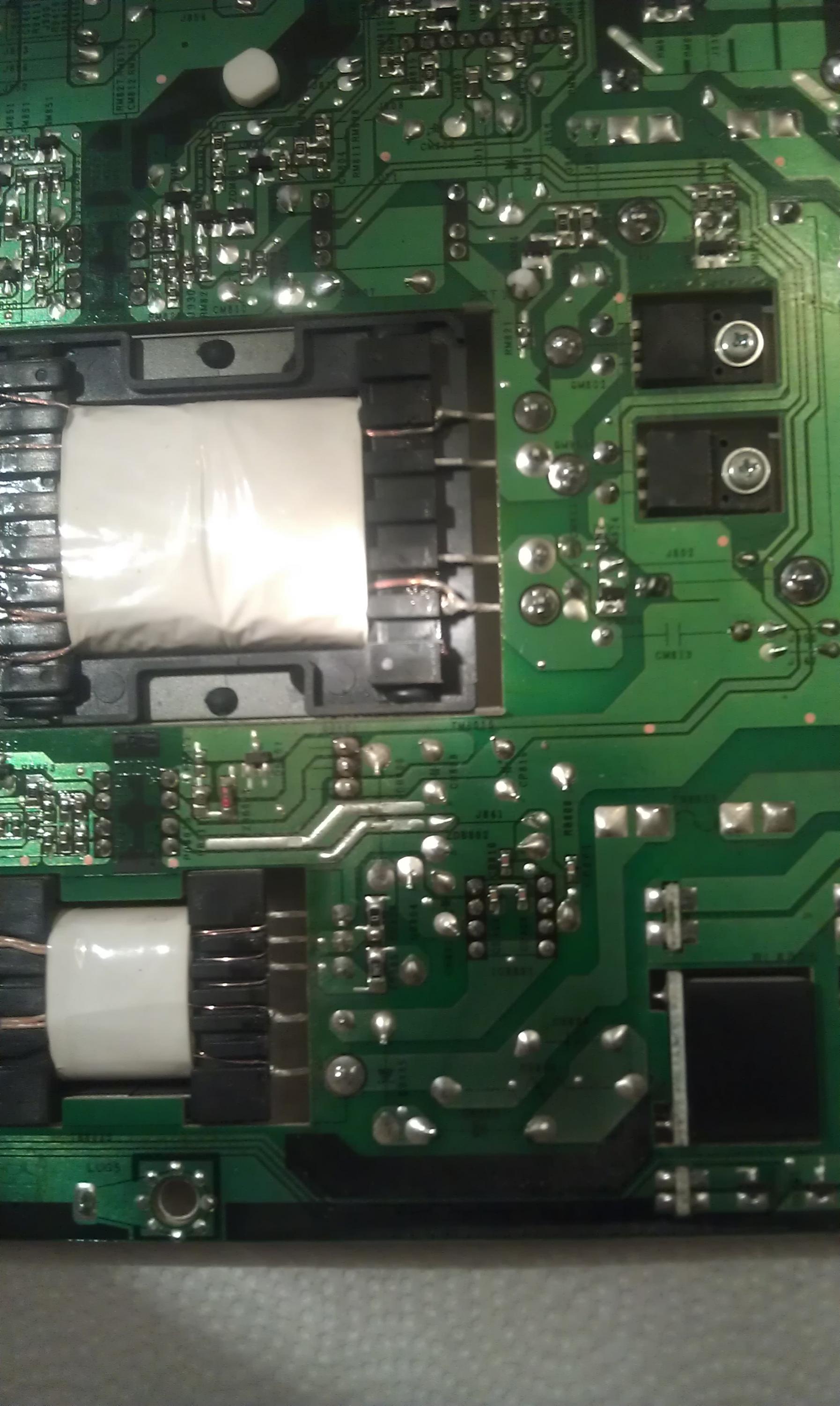

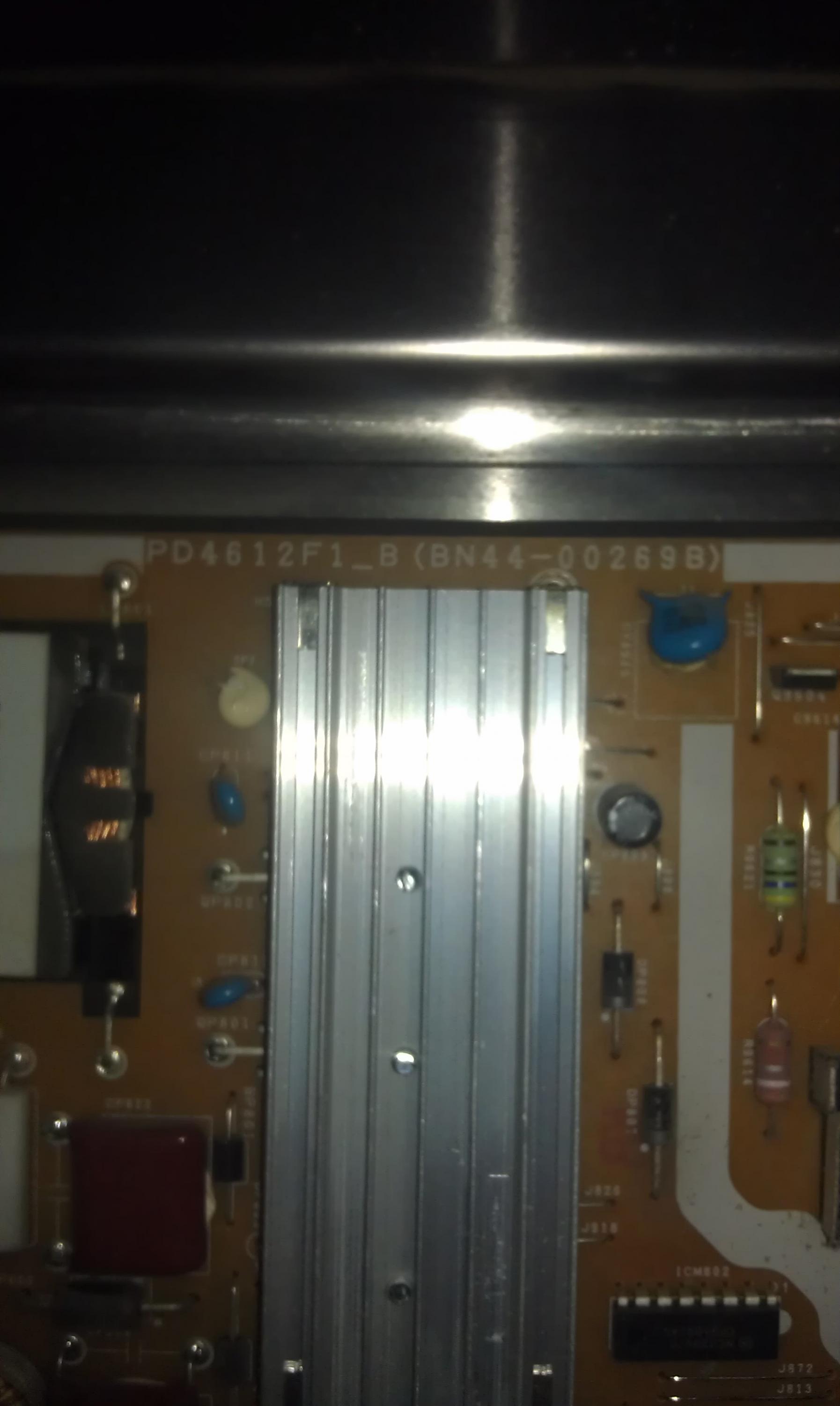

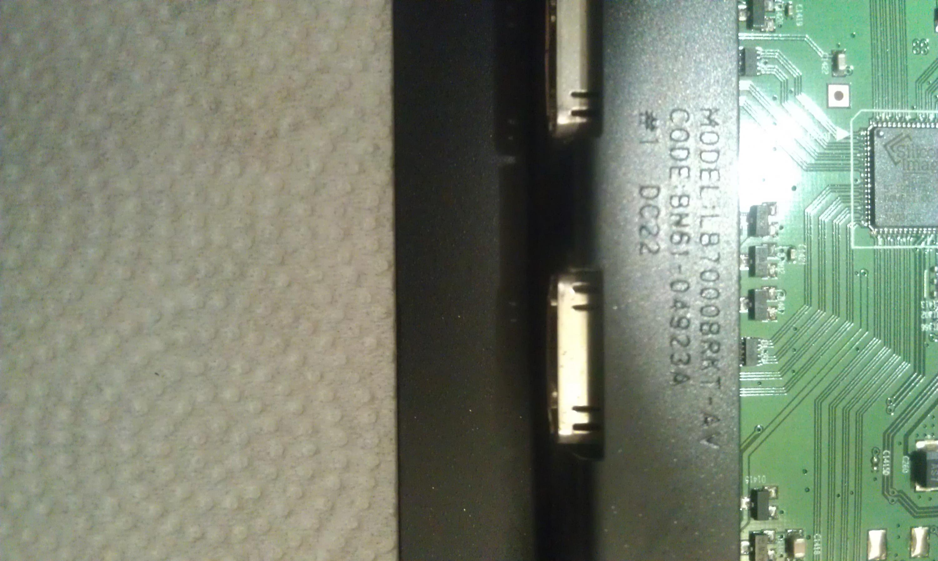

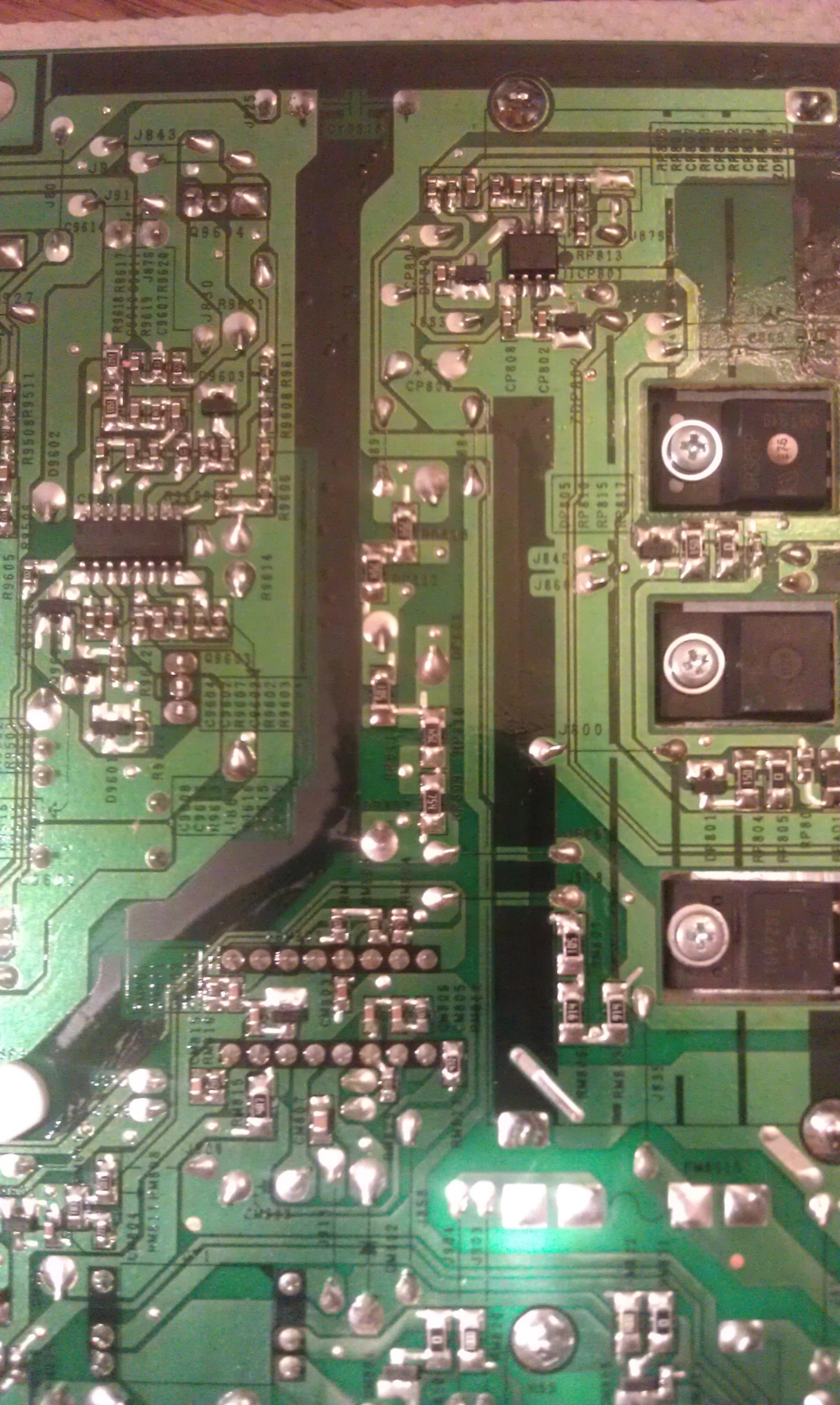

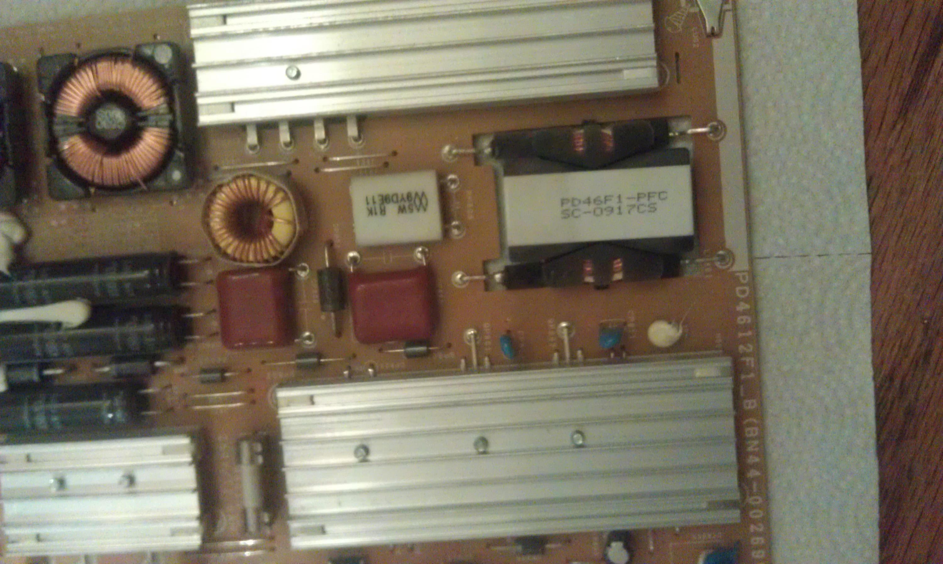

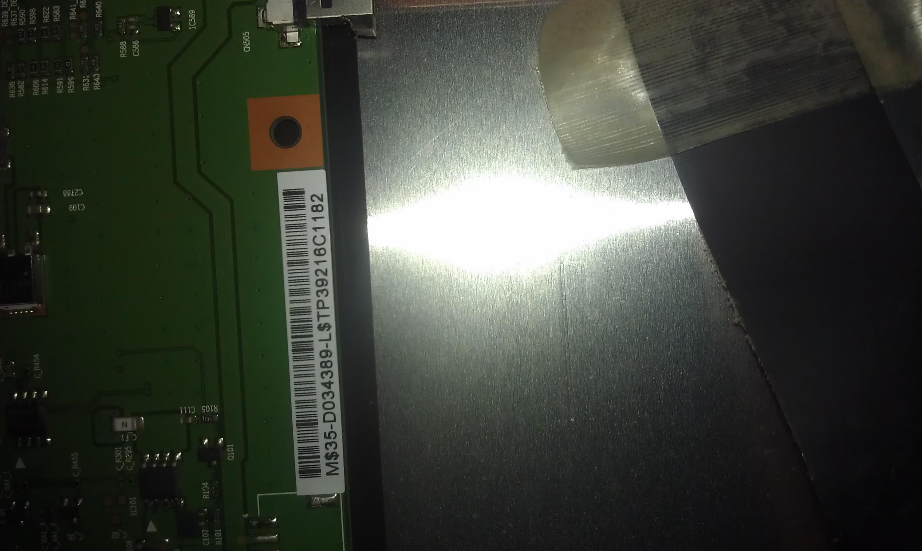

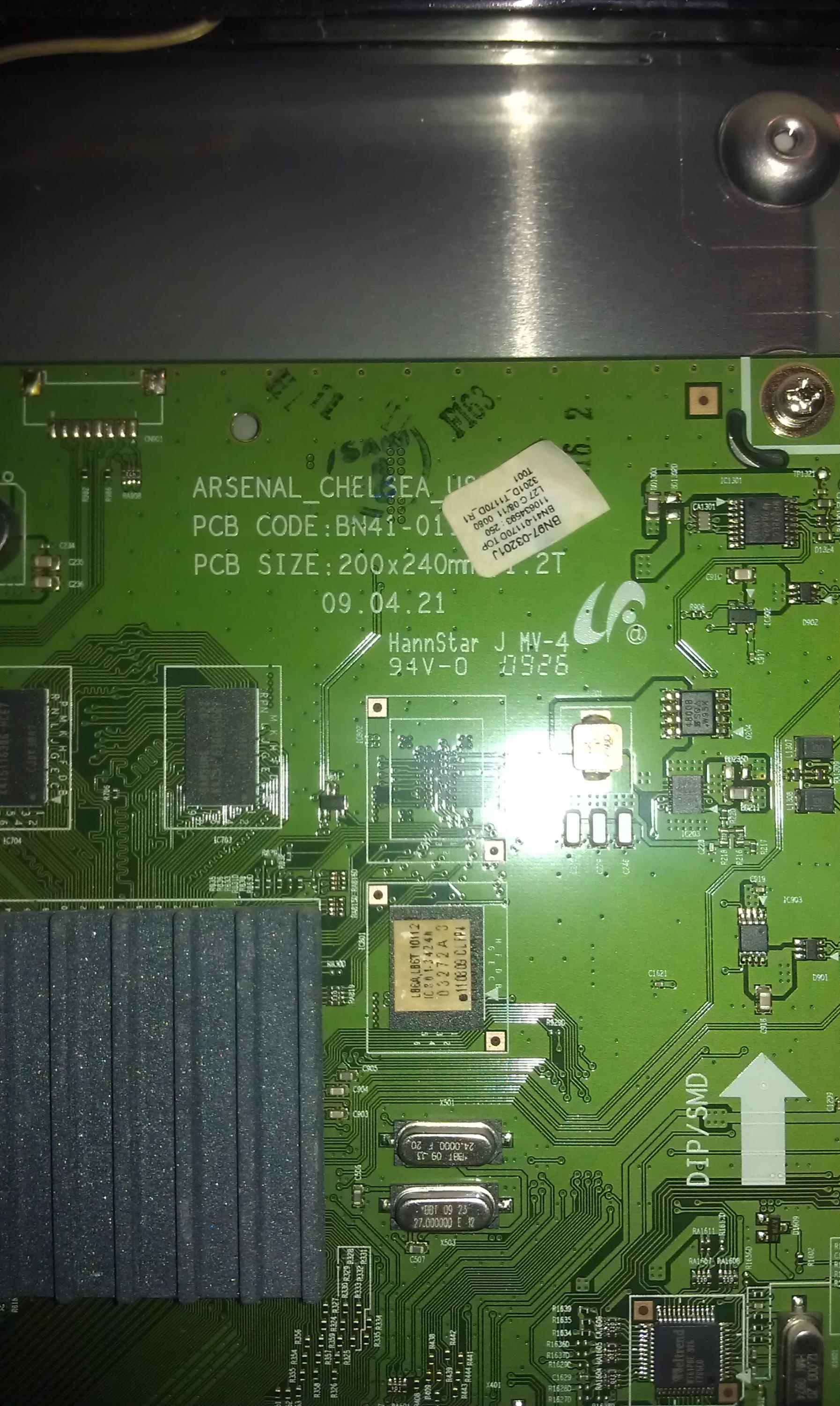

                                  Sorry it took me so long to get the pics. We had a Hurricane down here and had some damage that needed tending to before tackling this TV problem.
                                  Anyway,here's the pics.I searched very closely for any burnt circuitry on the front and back of the Power board and the Digital board and could not find anything.
                                  My set is also starting to power on and off by itself when turning the set on in the morning.It will do this for about 7 minutes before staying on for good.

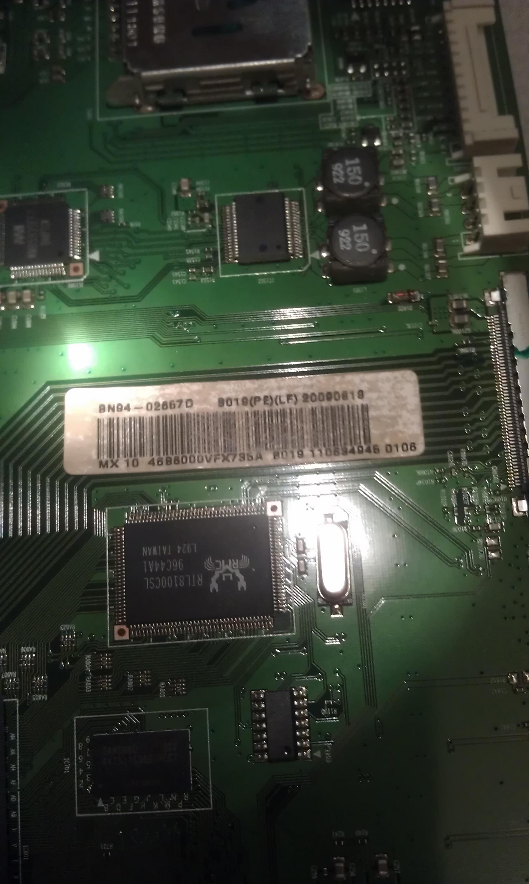

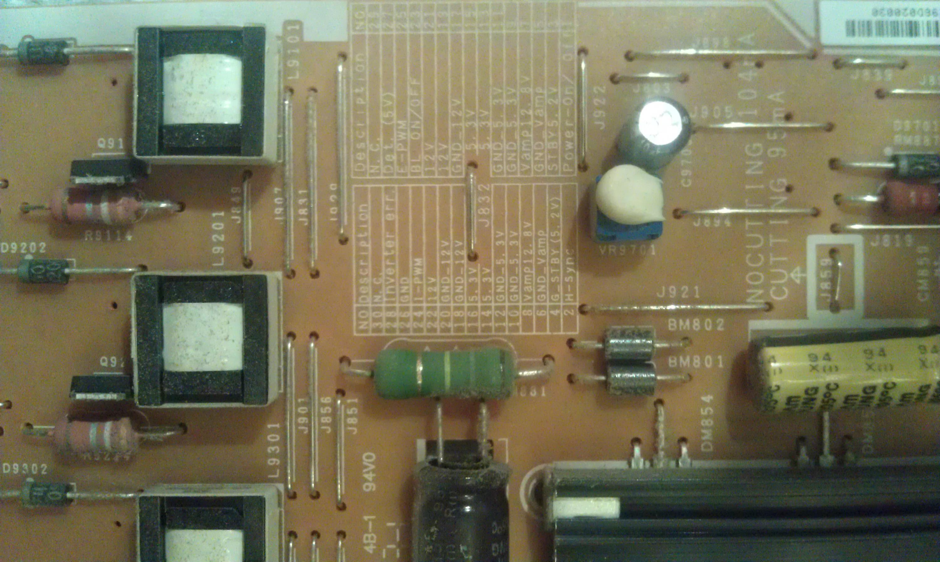

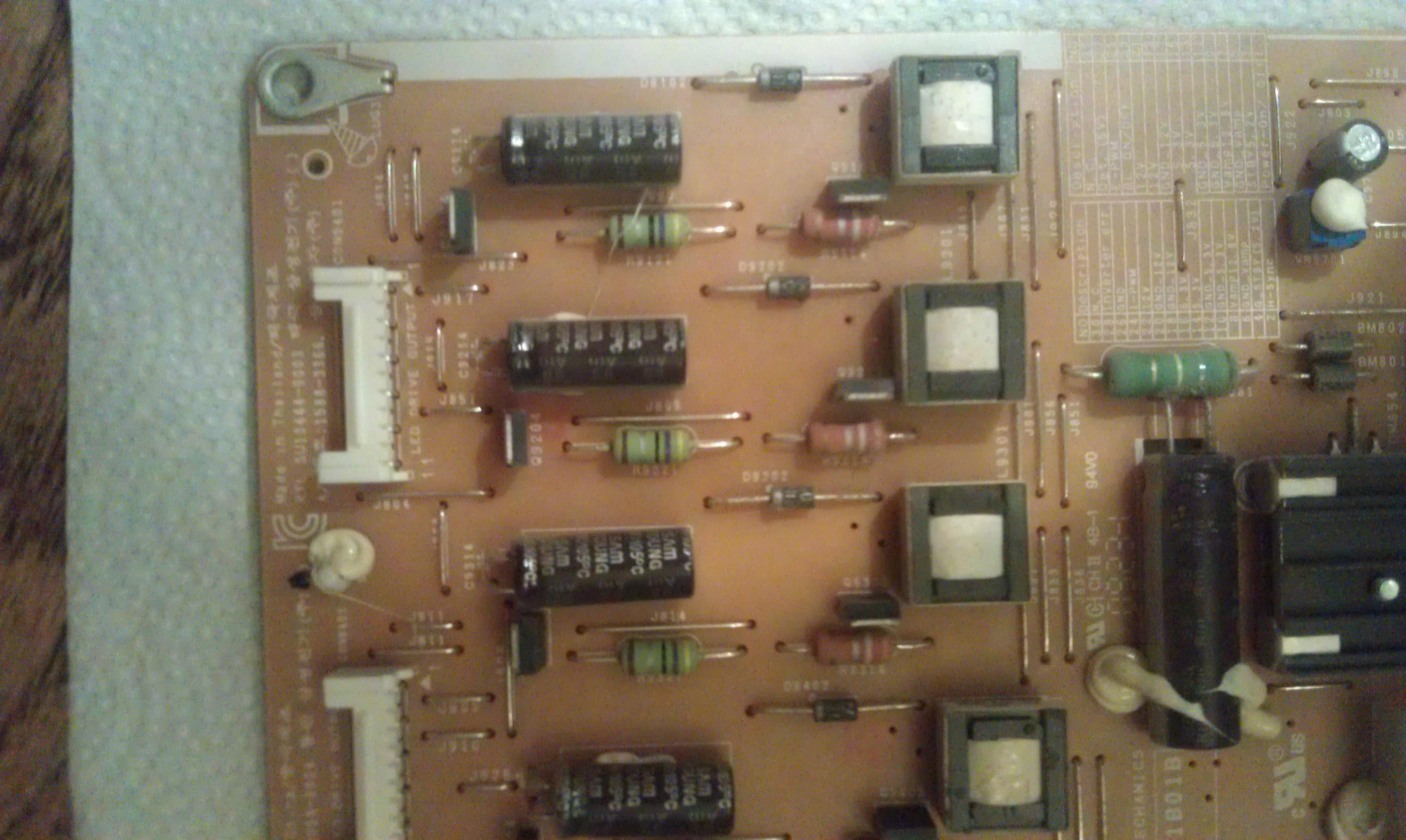

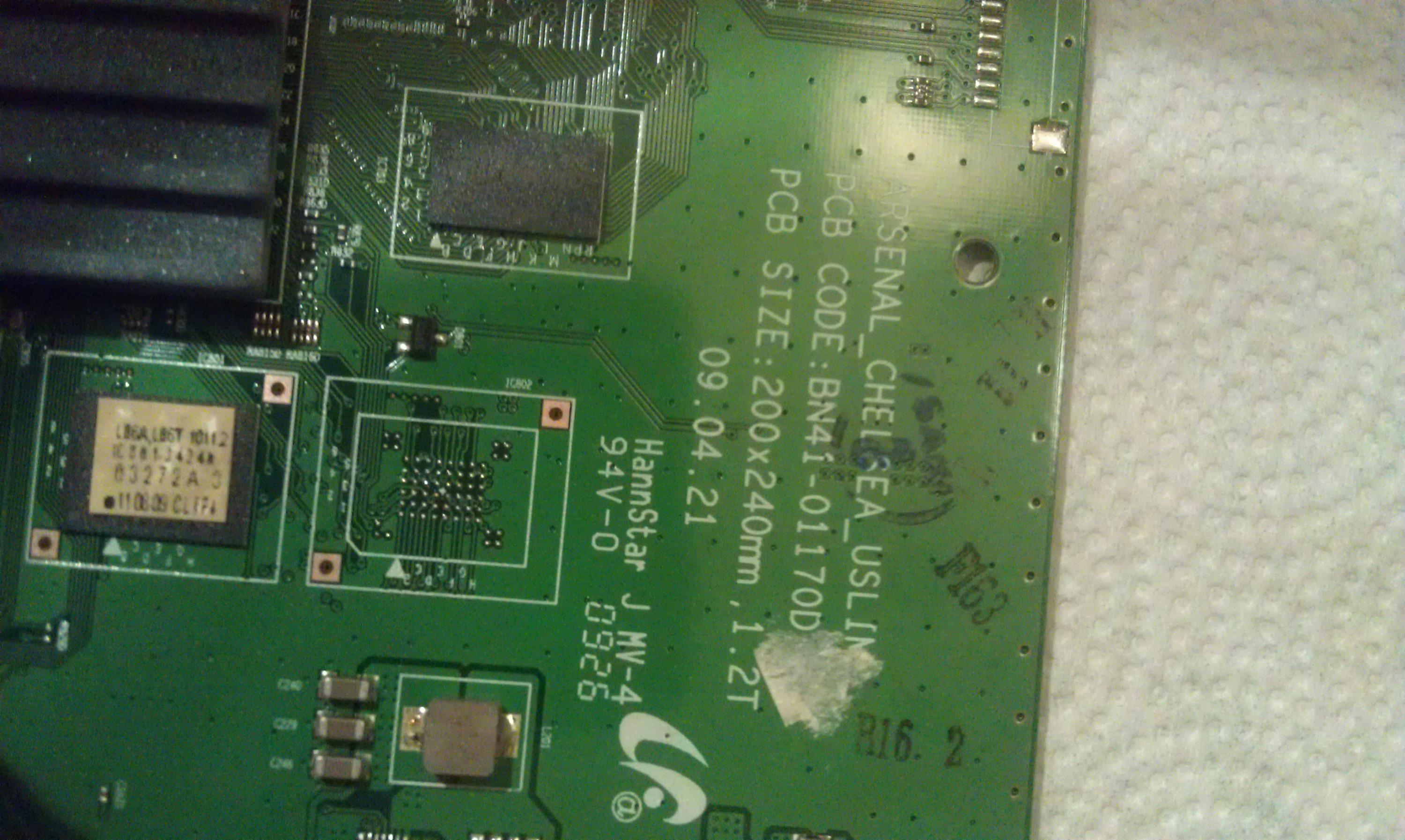

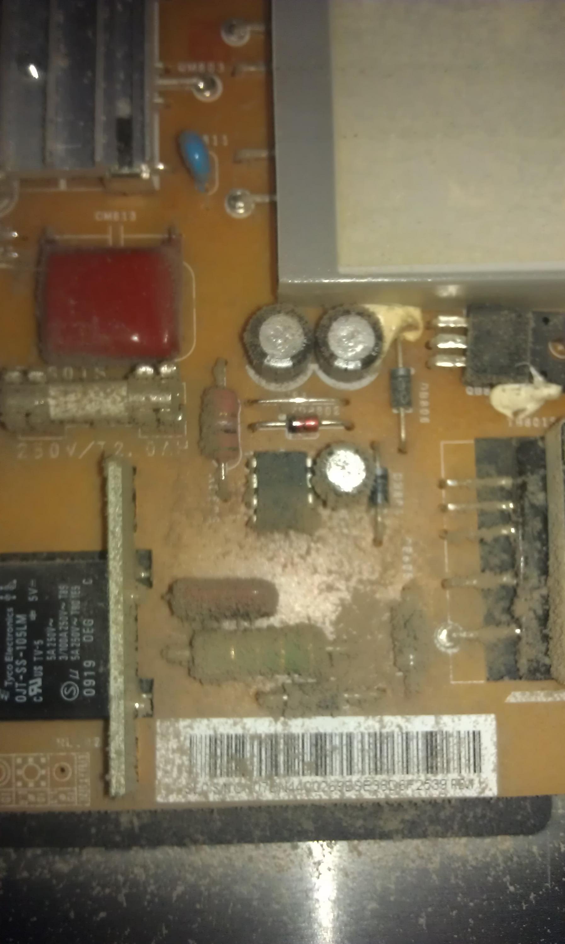

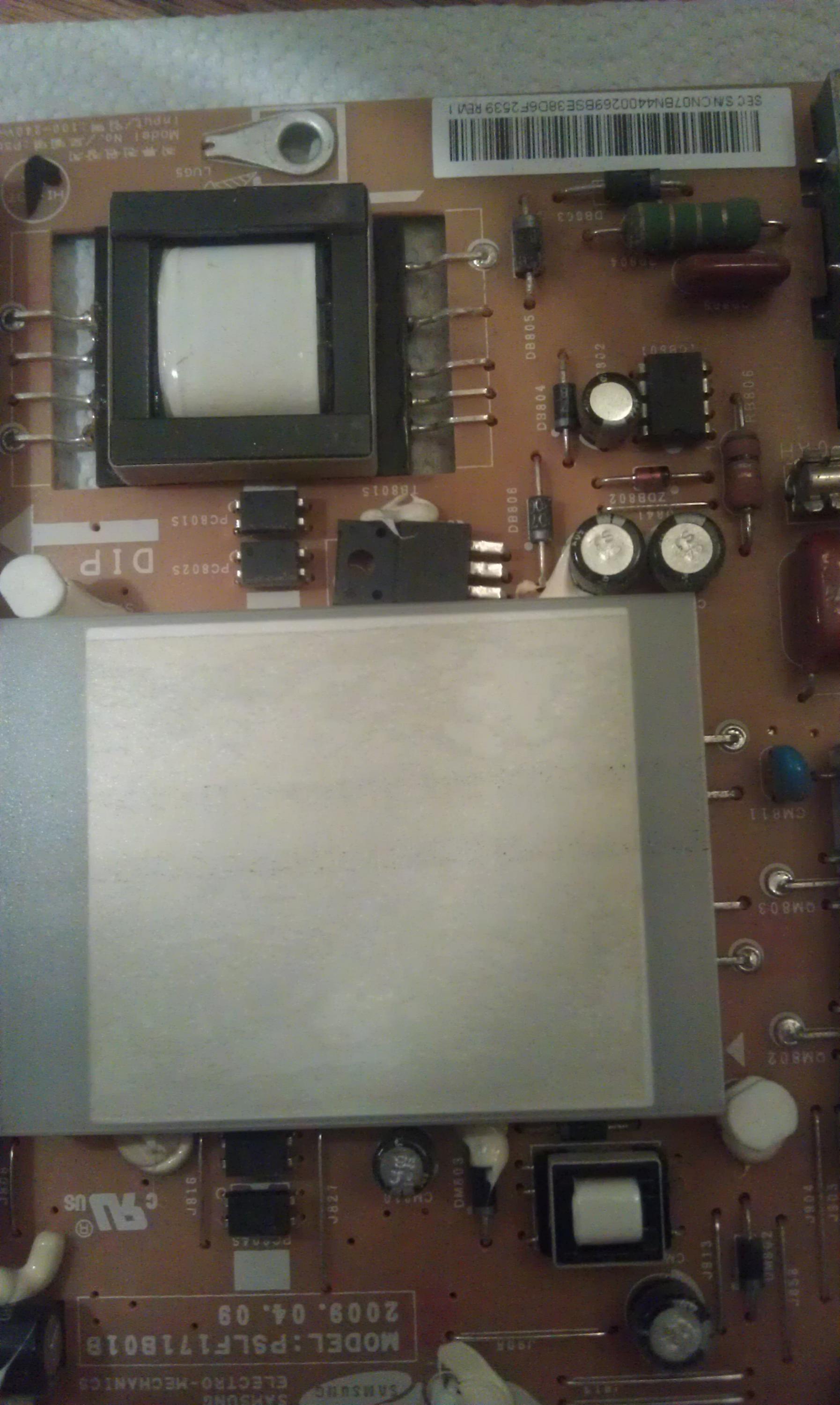

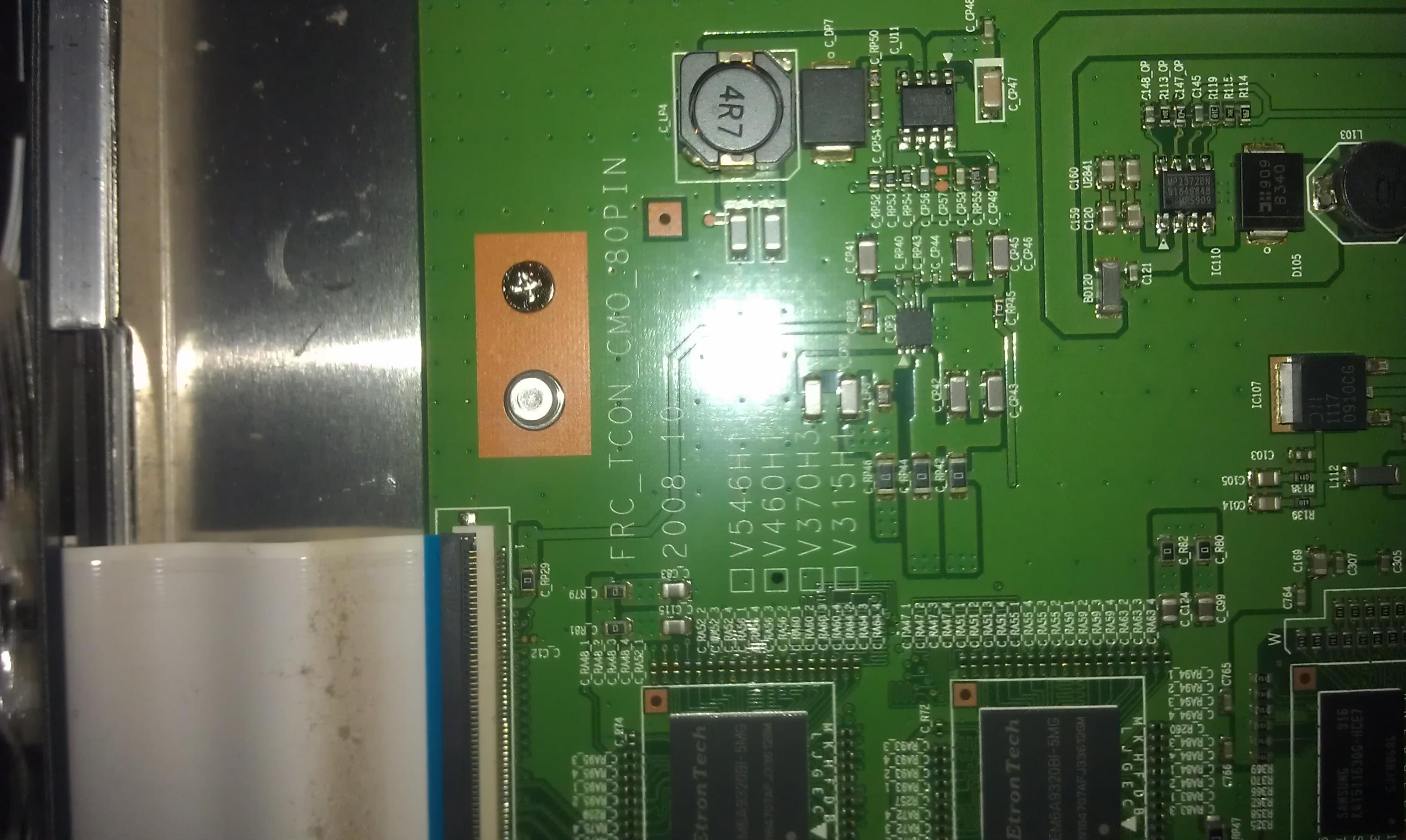

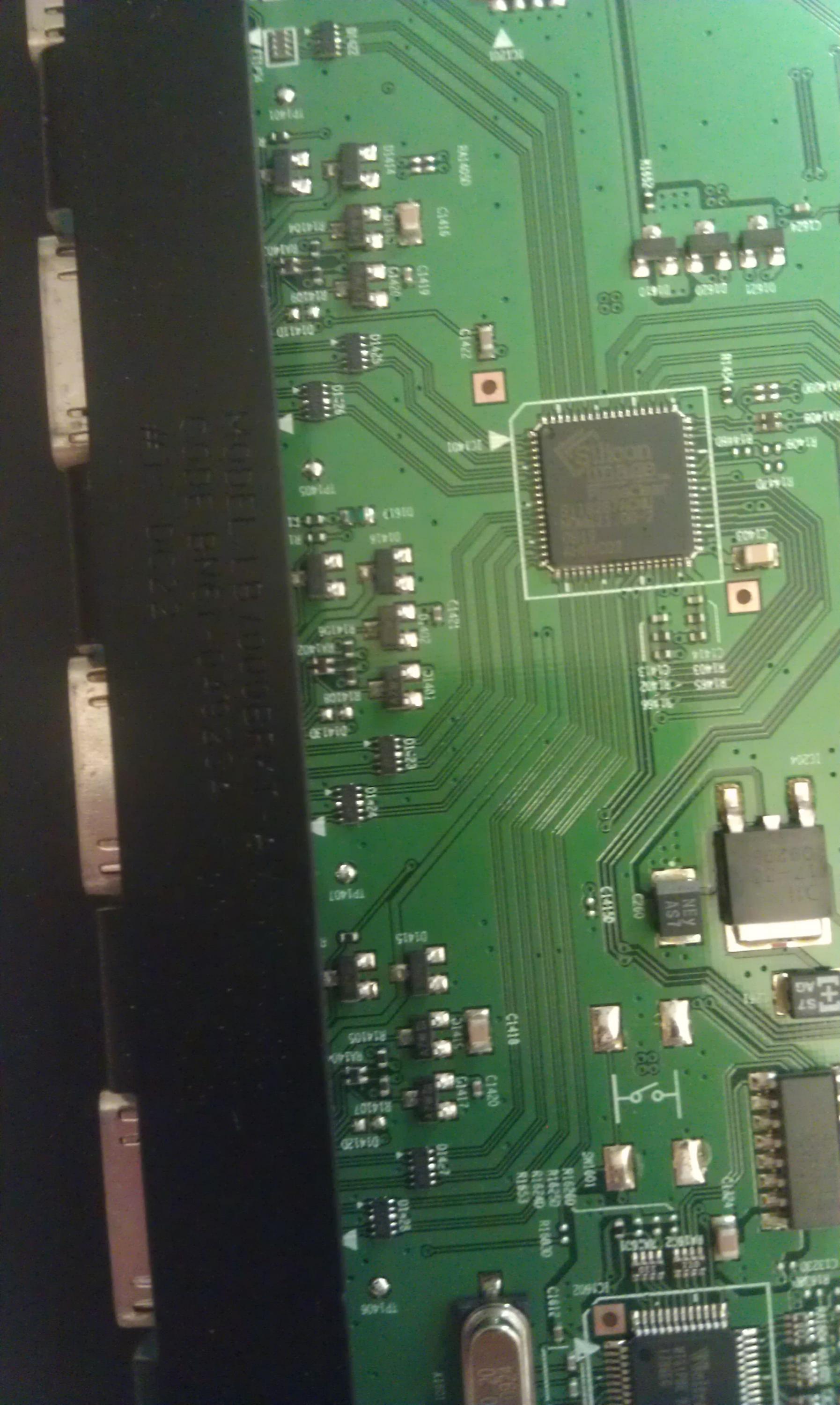

                                    some more pics
