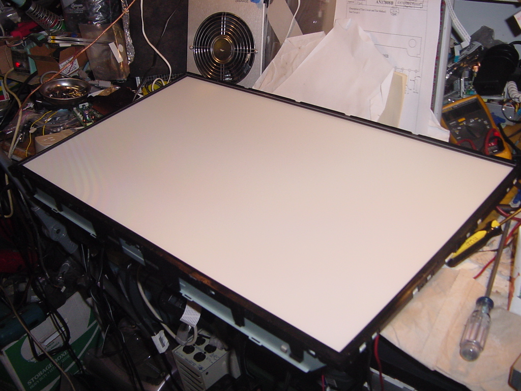

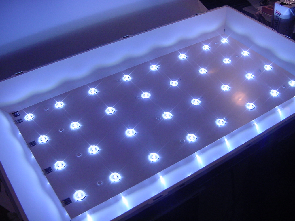

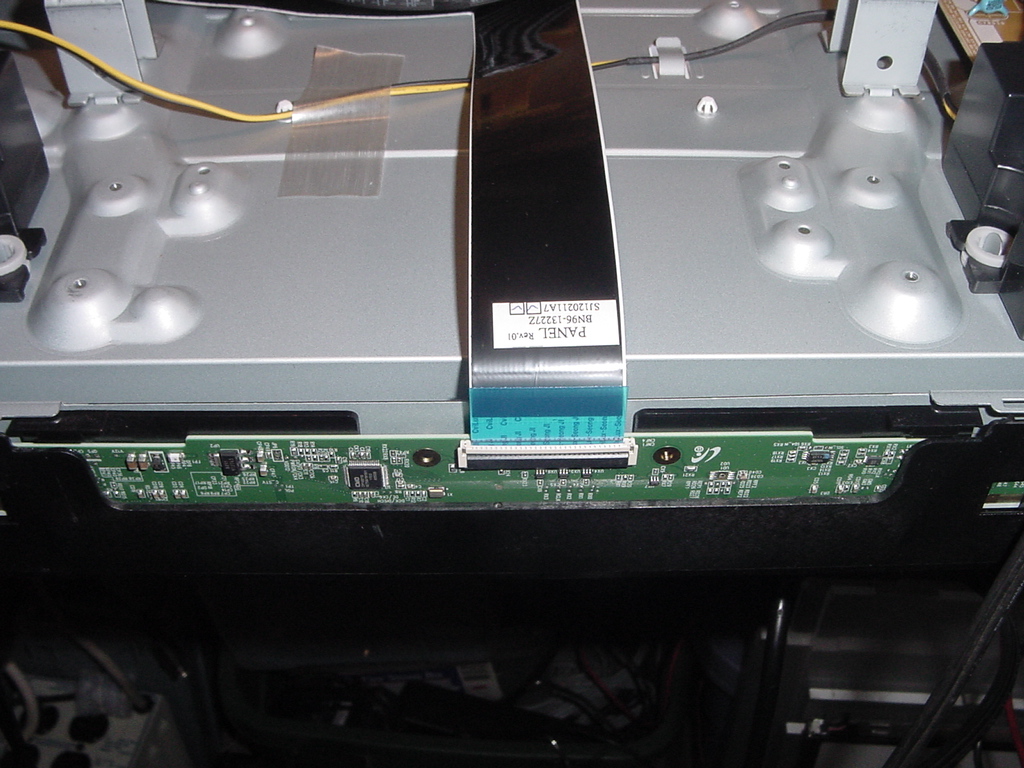

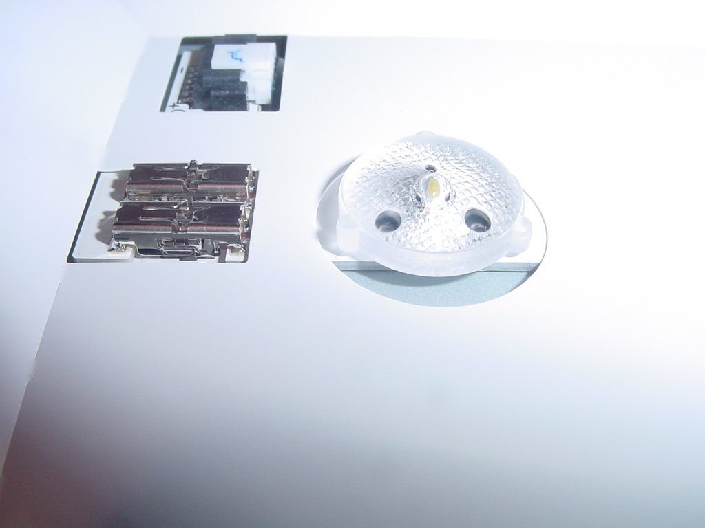

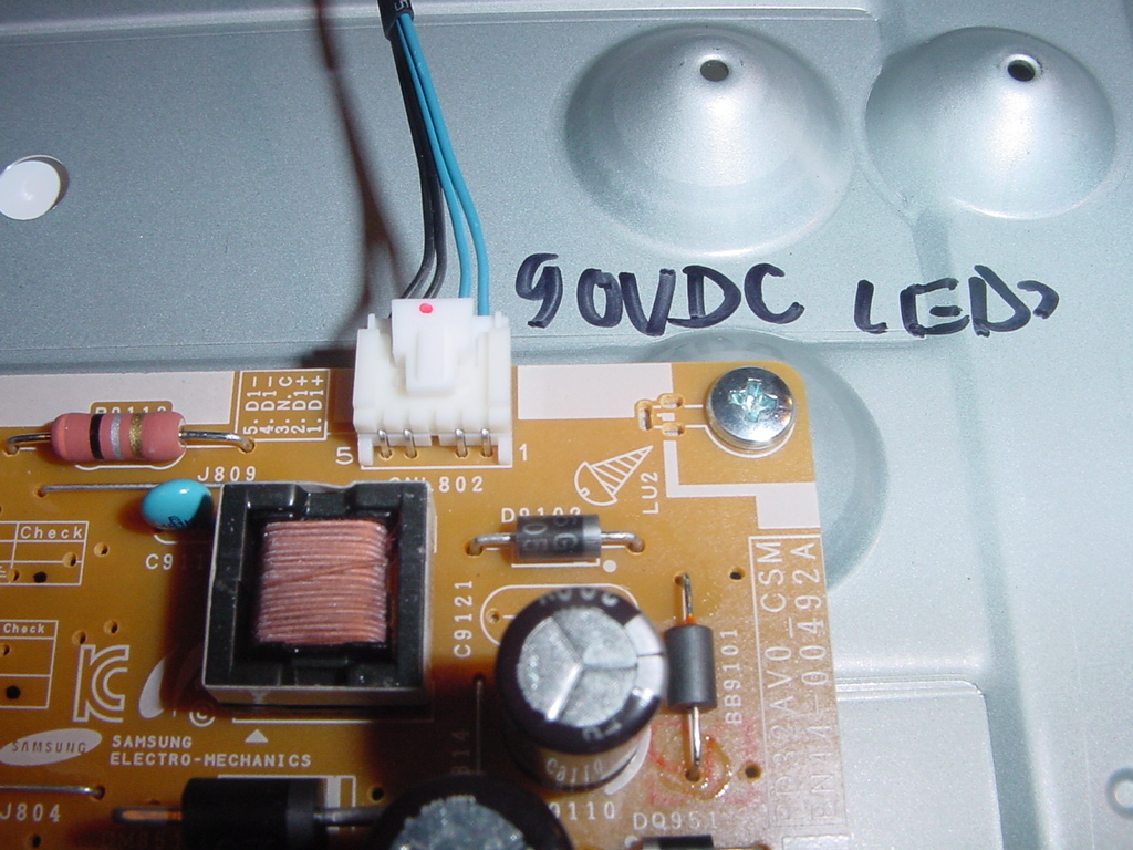

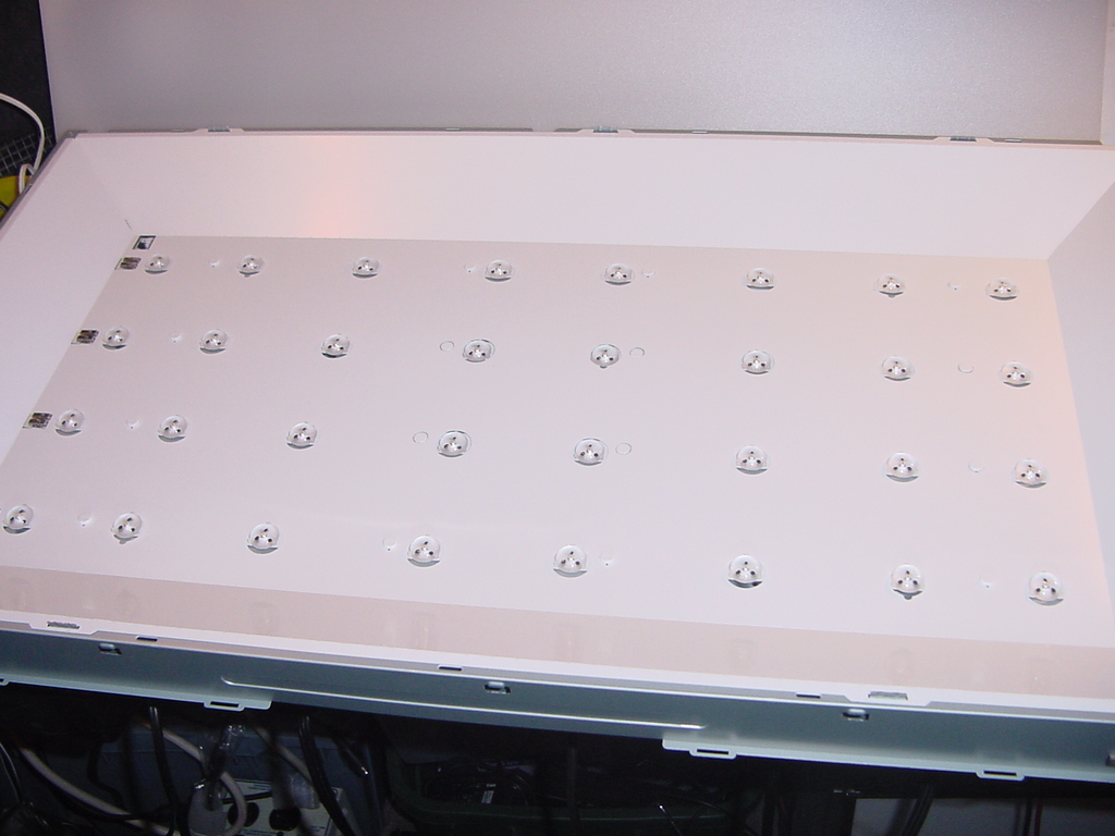

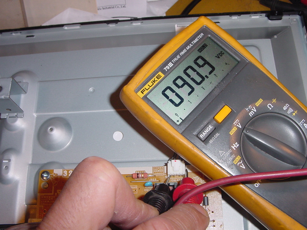

    I just got this one in today, it has broken LCD panel, so I decide to open it up to see how the TV with LED backlights works. It has 32 white LED hooked up in series to 90V DC power supply.
    I will be using as a light table and also as a light source for taking picture.

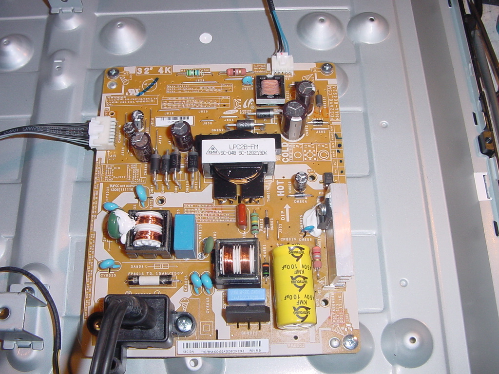

    Not much inside at all, it uses about 50Watts of power but it does not have PFC circuit, the PFC is 0.65 which is very poor.

    As always, lame caps. But, nice find on all the leds, they sure aren't cheap!

      So I guess we can measure the output voltages on the trafs? No high voltage going to the LEDs? I assume that the bigger the TV, the output voltage has to increase too, no?
      Do you think that it's possible to replace individually those LEDs?
      You can make some nice LED strips for you car

        There is no need for PFC anyway. Line losses are about 2% in the UK, and they would only slightly fall from using PFC in all devices. That is easily outweighed by the 5-10% efficiency loss from the PFC boost stage.
        I have seen Toshiba and Sharp 32" LCD TV, both using chokes for PFC.
