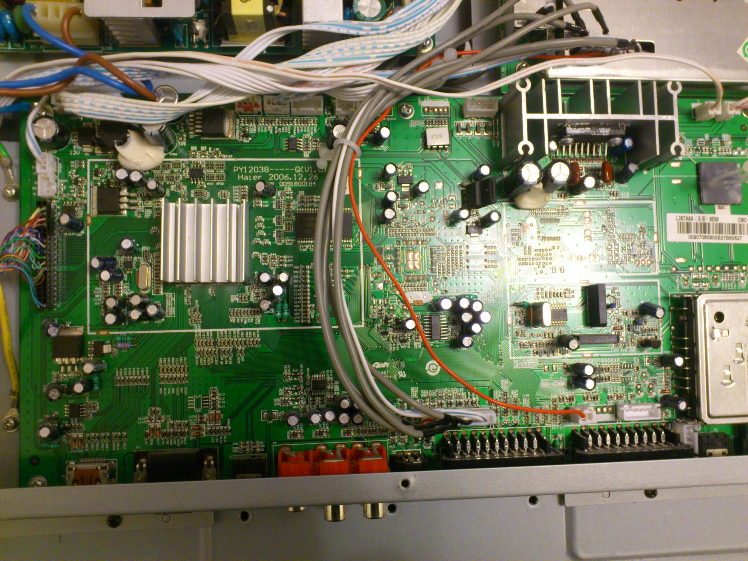

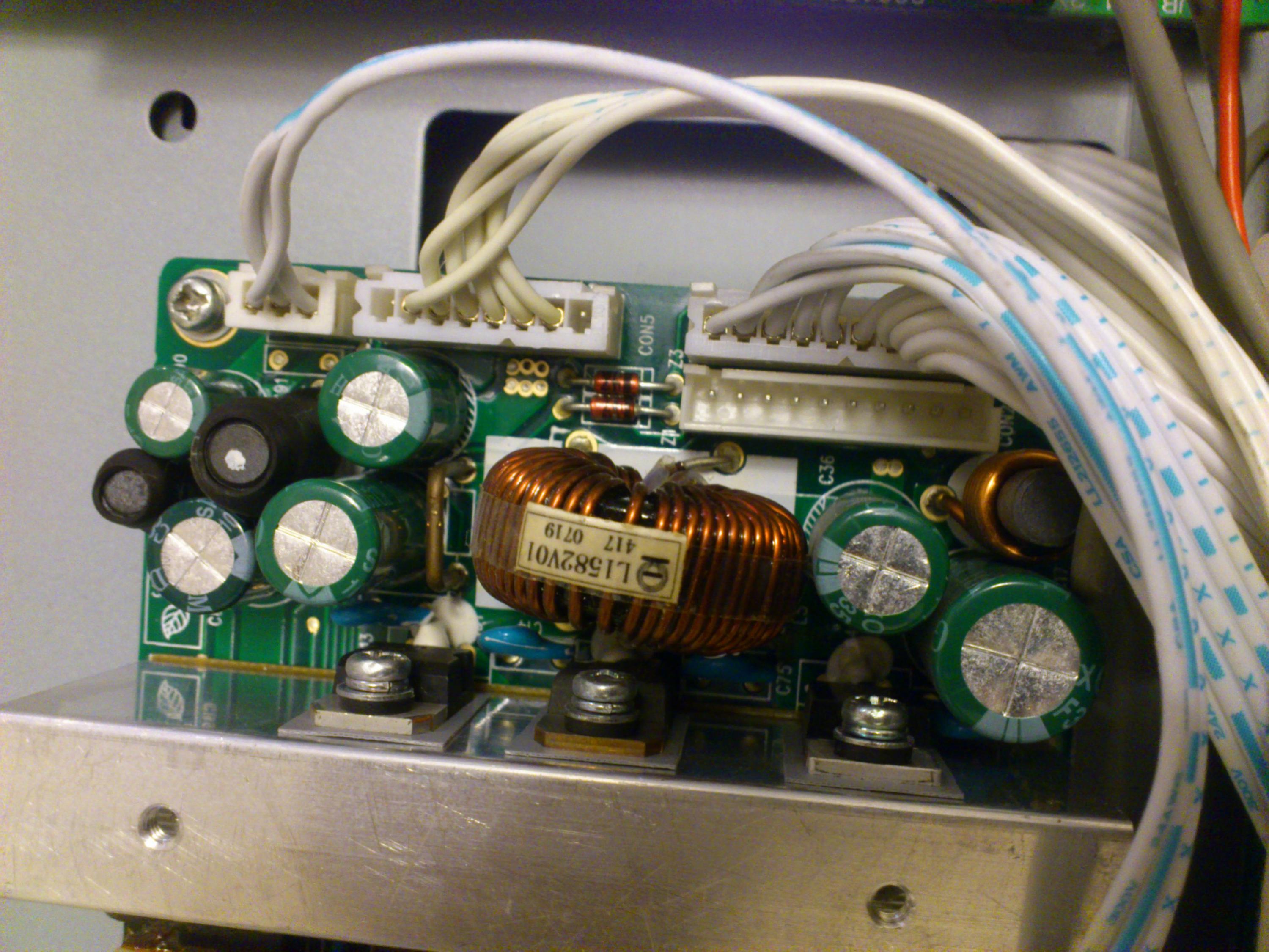

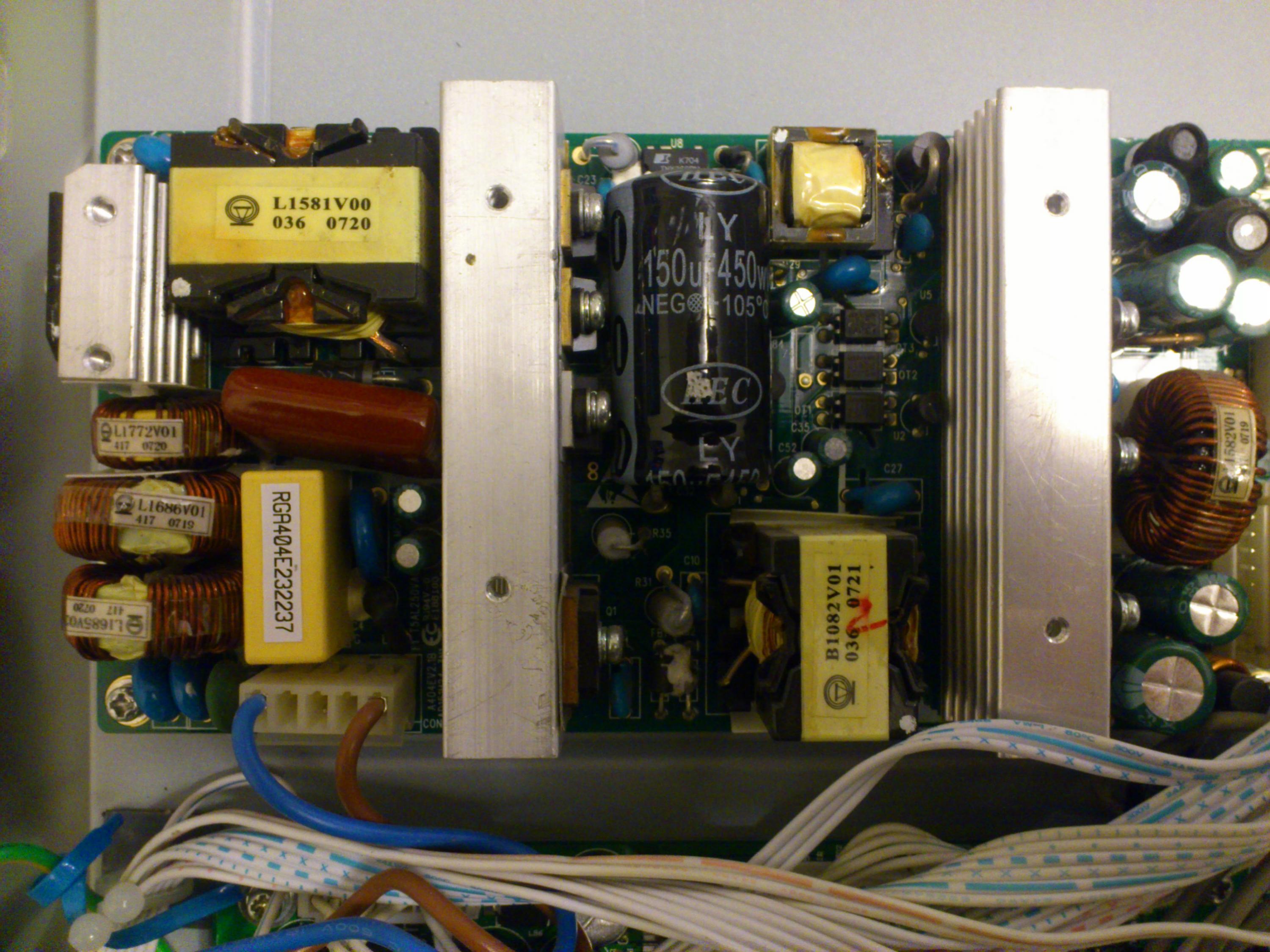

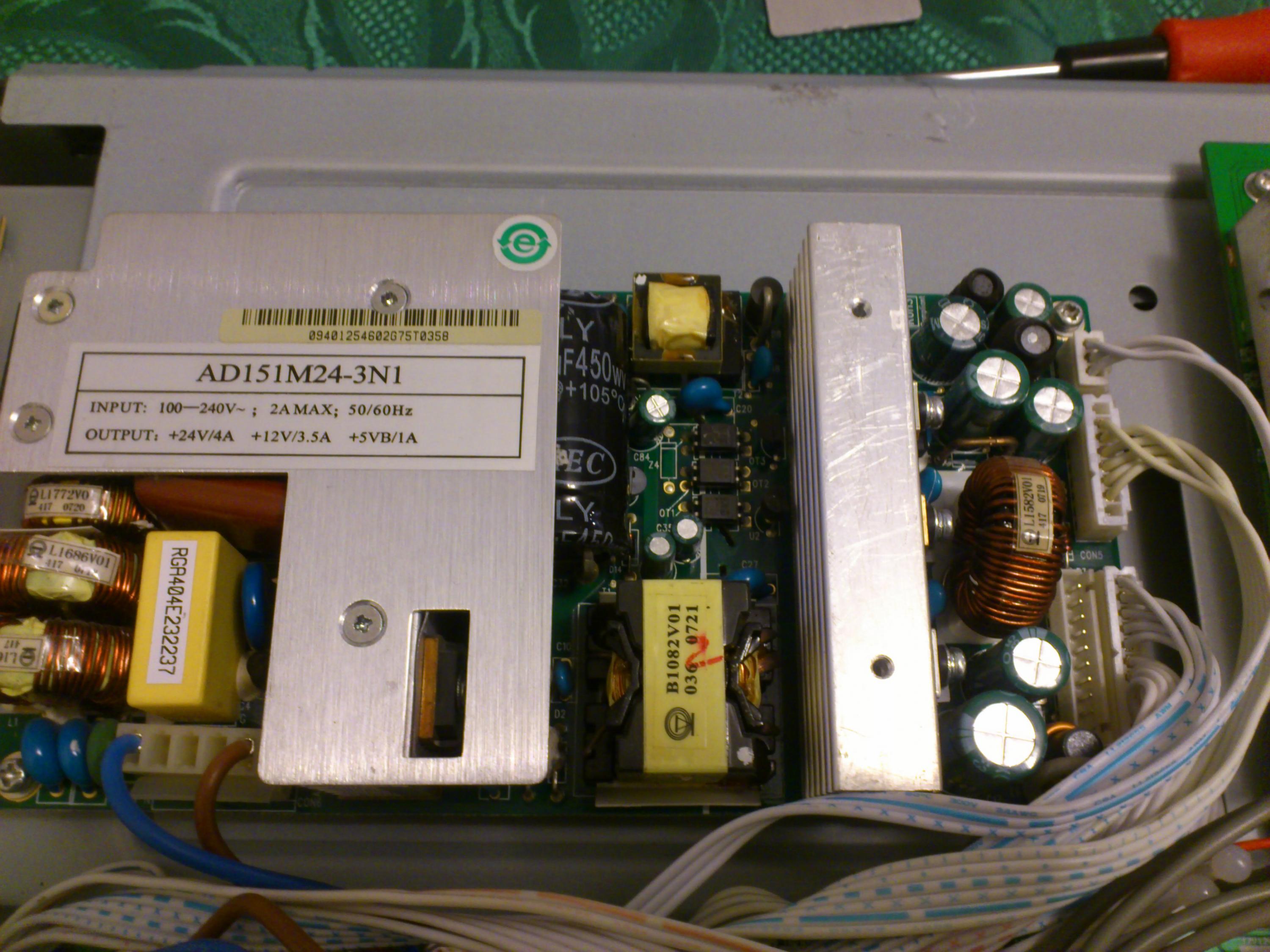

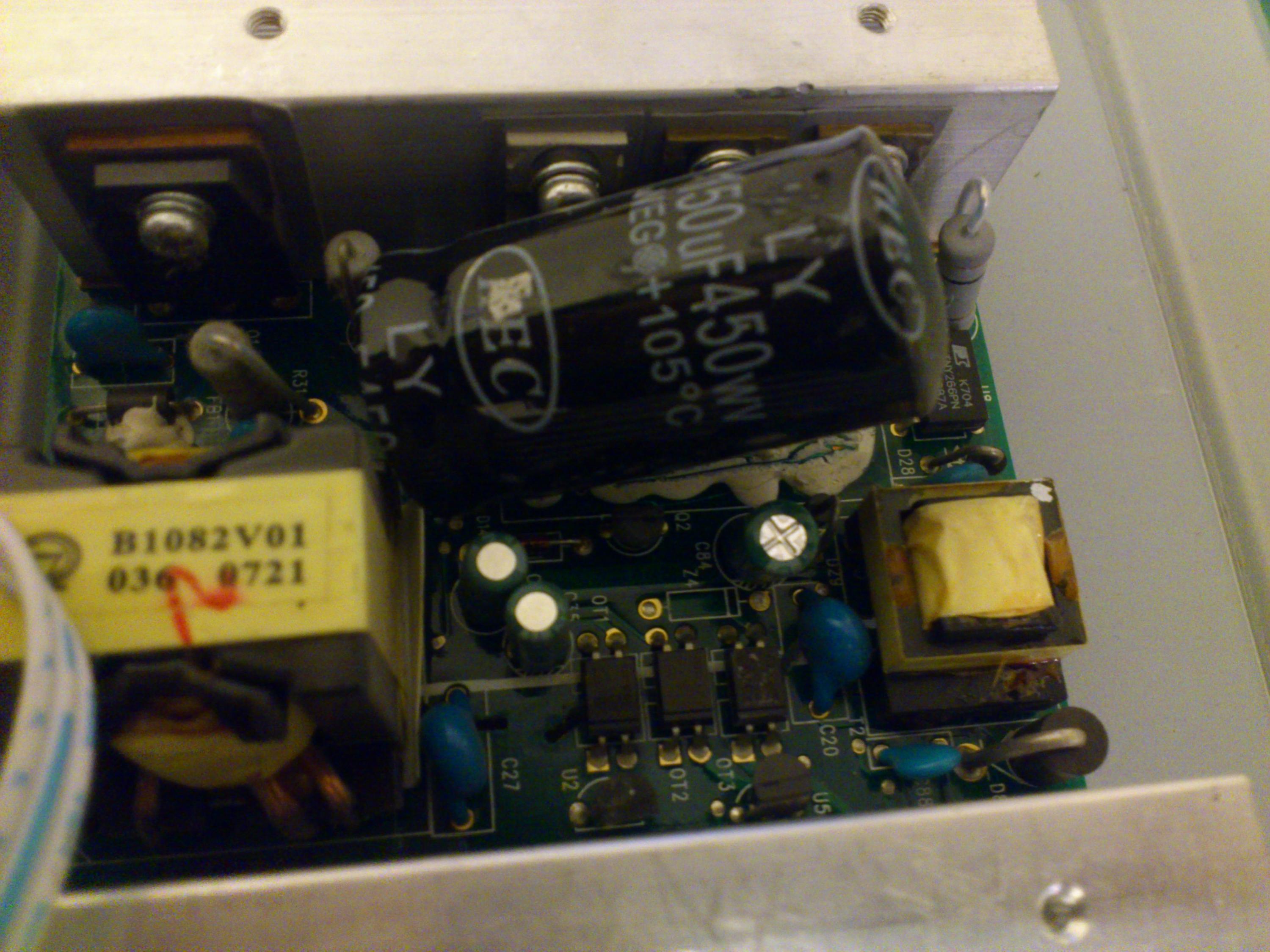

            still no joy....just got the tv back.....ended up giving him a 32" that i fixed,
            so back to square 1 now.... im guessing there is something going on with the PSU though, because ive tried swopping all the other boards the only 1 i havent done is the PSU
            gonna take some pics then upload
              Re: L26ta6a wharfedale lines on screen on warm up fixed
              piccy's
              any ideas would be greatly appreciated
              ive already.....swopped t-con, t-con cable and swopped main board and the fault is still there

                Fault must be with panel then. If it is a Chi-Mei I have seen two similar faults on 26" LCDs.
